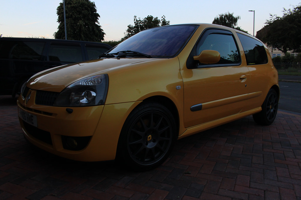

AcidicDavey's Liquid Yellow 182!
Lovely car mate nice to see you giving it the love it deserves and needed! Love the touch with leaving the note i managed to buy my project car doing the same thing! It looks awesome in them pictures you just posted!!
Cheers mate, I was genuinely shocked when I got a response as it pissed down not long after I put the note on his (my) screen.

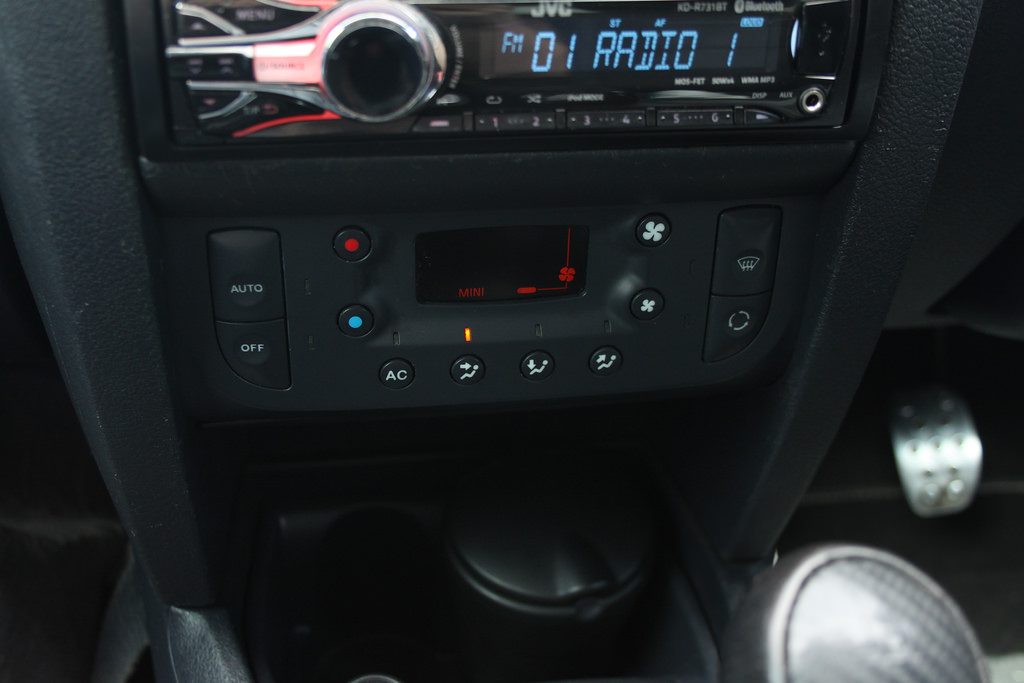

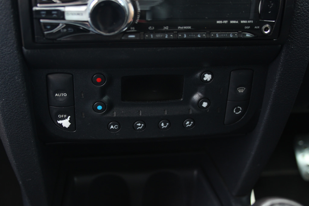

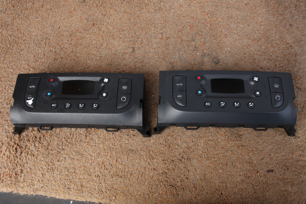

Also, on Saturday I replaced the climate control panel. Got a non textured one as I can't do with the stickiness!
Dead easy to change, just remove the radio and mounting cage, undo 2 T20 screws from behind, pull off trim in between radio and climate panel. Also remove the lower dash panel below the climate controls by just pulling up and sliding it out. Now just push the climate panel towards the bulkhead and try and shimmy it out. Only the 2 large connectors on the back and it's out! Dead easy!
It was letting the interior down a bit I feel :smile:
02-07-16 001 by AcidicDavey, on Flickr
02-07-16 002 by AcidicDavey, on Flickr
Old vs. New, old had a scratched screen and the obvious.
Clio MK2 Climate Control Units by AcidicDavey, on Flickr

Nice touch with the panel, sounds a fiddly job but worth it all the same, big improvement!

Easy to swap really, took less than 30 minutes going carefully. Makes such a difference :smile:

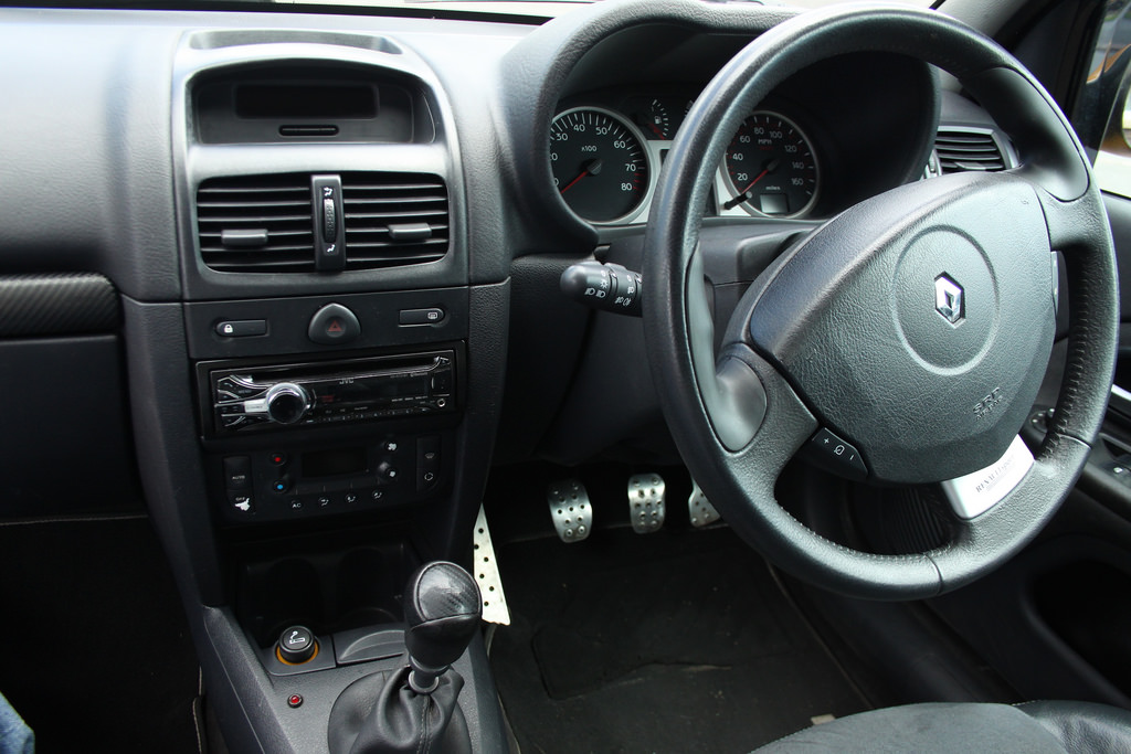

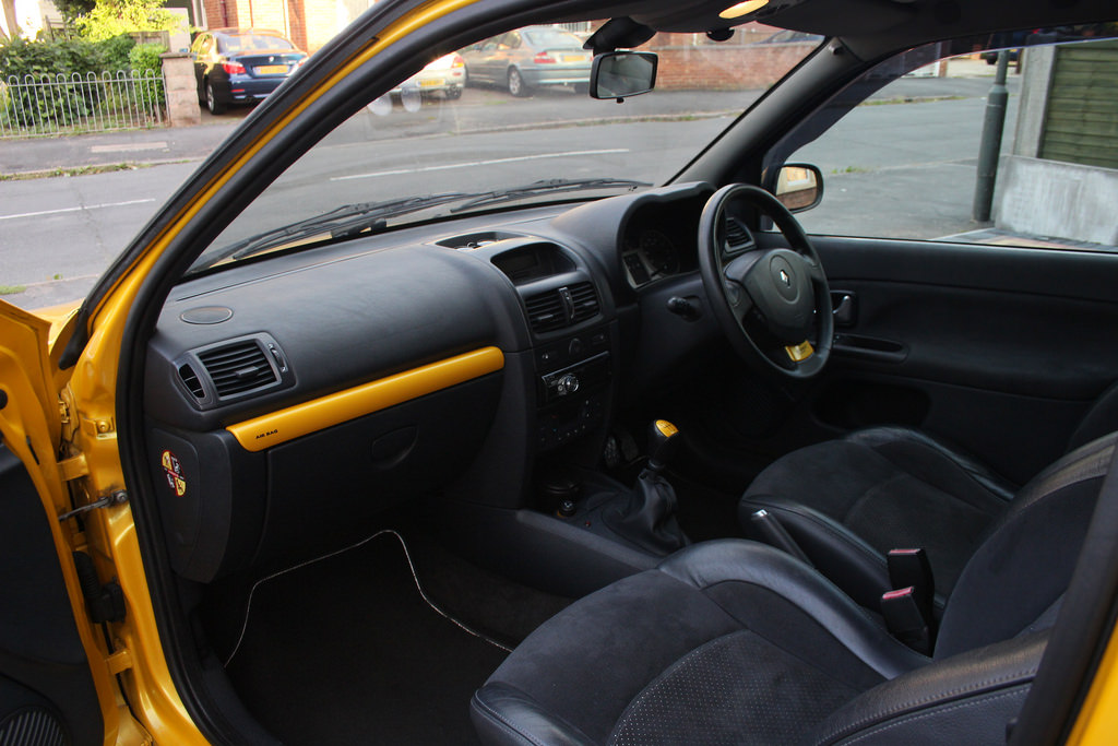

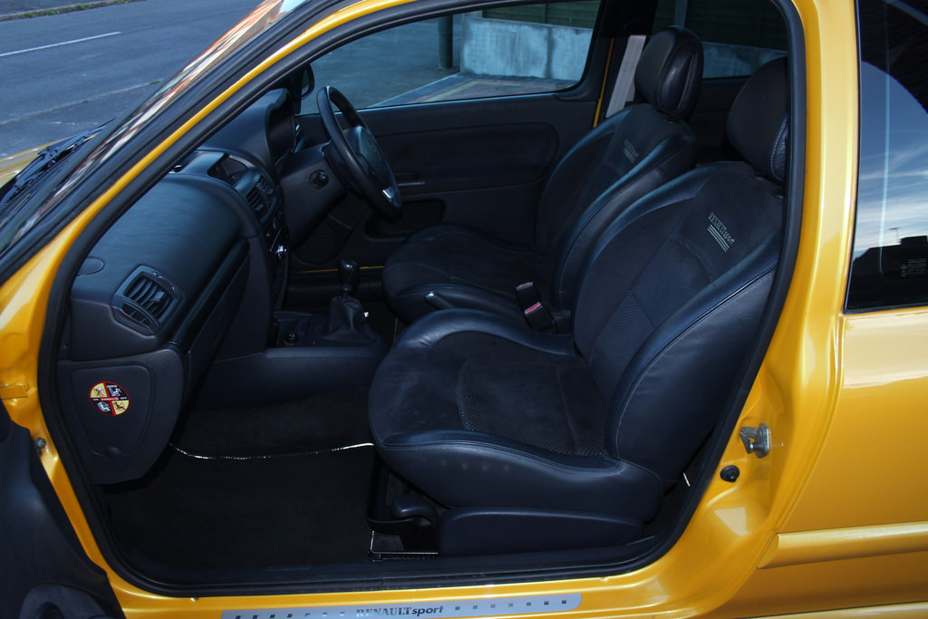

So, since I last wrote an update I tried to clean the interior further using some upholstery cleaner I found in the boot of my 850 R I got (that boot was full of useful tat when I got it, result! See, told you I was a tight arse :smiley: ).
It's getting there but I think the car could do with some new seats really as the alcantara on the bases isn't great. I've sanded away all the bobbles by dragging well erh Sandpaper across them but as said the bases have had too many years of bums shuffling on them and don't feel as plush as they should!

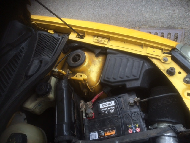

At the auctions last week we took this, I think it is a staff members car.
LY 182 & 106 Rallye 1 by AcidicDavey, on Flickr
LY 182 & 106 Rallye 2 by AcidicDavey, on Flickr

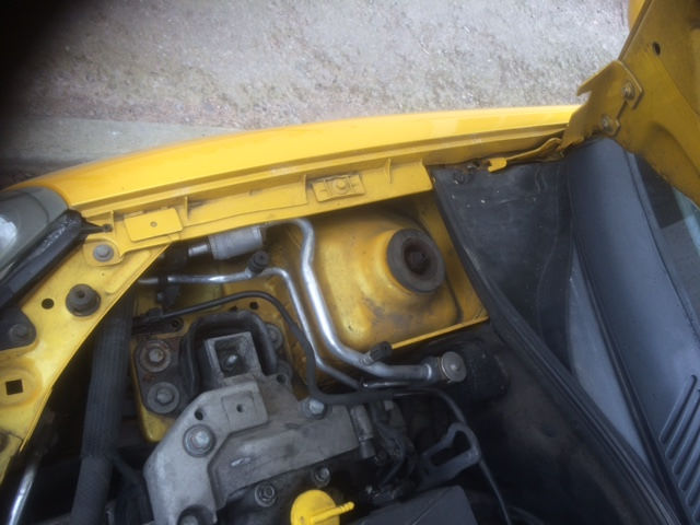

On the same day while waiting for a different auction at another location we did some Clio cleaning to pass the time :smile:
The car was rather filthy under the bonnet, we attacked it with what we had, 4 microfibres and some detailing spray and that was all.
Here are some before and afters.

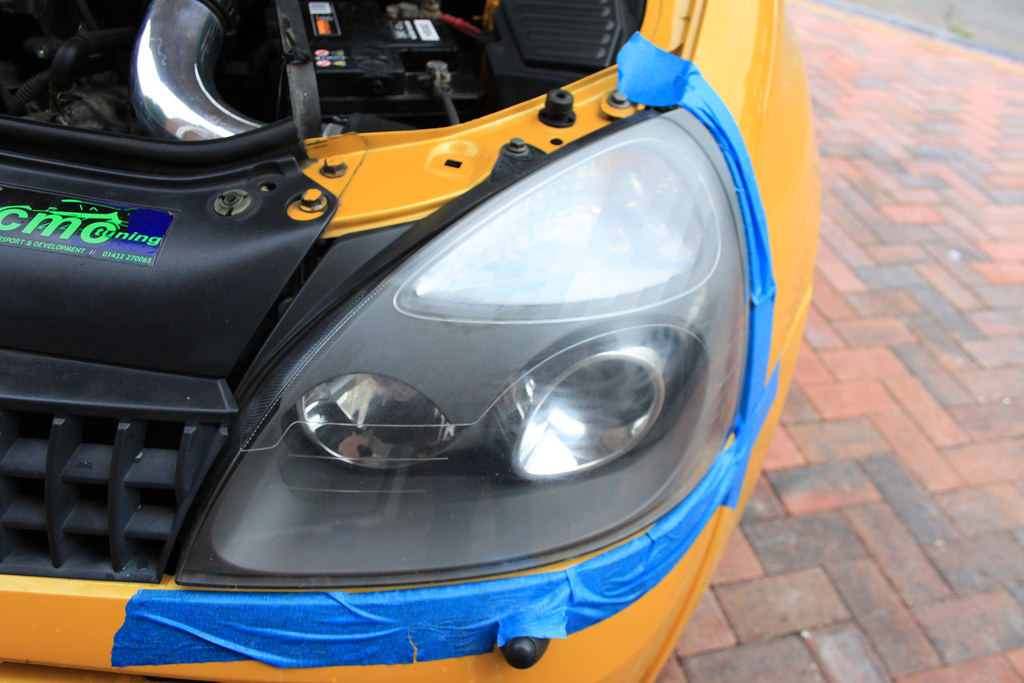

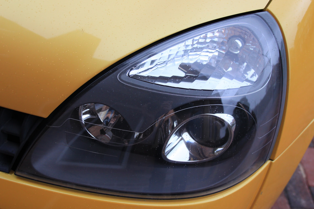

Anyway, I set about sorting out the typical plastic headlight problem last week. They had started to go at the top, they were worse than they photographed here.
Passenger's Headlight Restoration 1 by AcidicDavey, on Flickr
Passenger's Headlight Restoration 2 by AcidicDavey, on Flickr
After sanding back smooth with 2000grit wet and dry ready for polishing.
Passenger's Headlight Restoration 3 by AcidicDavey, on Flickr

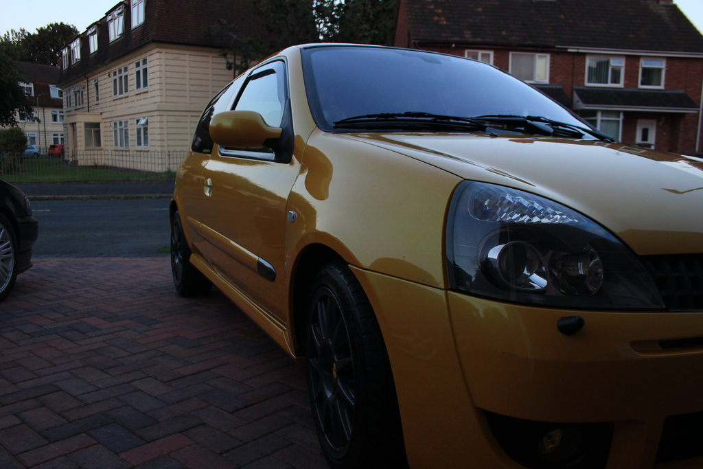

Finished. I used some Sonus SFX applied with a DA, they've turned out great, like jewels!
Passenger's Headlight Restoration 4 by AcidicDavey, on Flickr
Passenger's Headlight Restoration 5 by AcidicDavey, on Flickr
And the driver's headlight before...
Driver's Headlight Before Restoration by AcidicDavey, on Flickr
After...
Driver's Headlight After Restoration by AcidicDavey, on Flickr
Headlights Before Restoration by AcidicDavey, on Flickr
Headlights After Restoration by AcidicDavey, on Flickr
The difference probably doesn't look great in the photos but trust me, in person it is, well impressed. Yes, I need to do the whole car now, ordered loads more detailing 'stock' so I'm ready to go :smile:

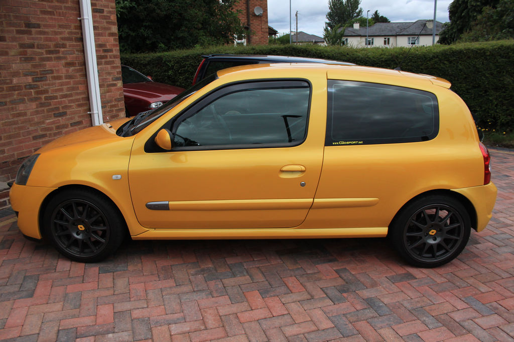

Just because...
LY Clio 182 19-07-16 001 by AcidicDavey, on Flickr
LY Clio 182 19-07-16 002 by AcidicDavey, on Flickr

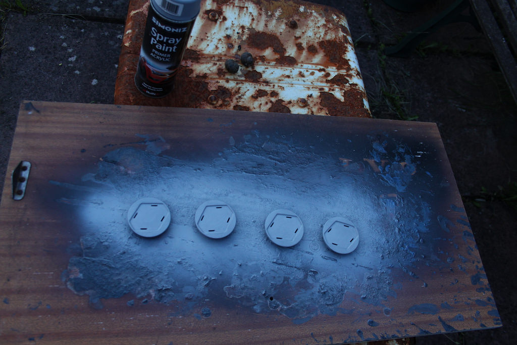

After 3 coats of acrylic primer...
Caps 3 by AcidicDavey, on Flickr
I then went to sand them down with some wet and dry and give them another couple of coats and repeat.

Anyway, decided to represent!
ClioSport Sticker by AcidicDavey, on Flickr
LY 182 29-07-16 by AcidicDavey, on Flickr

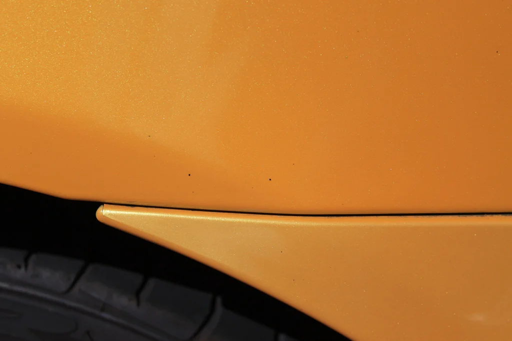

But, the car was littered in tar spots like these. Tardis made light work of them.
Tar Spots 1 by AcidicDavey, on Flickr
Tar Spots 3 by AcidicDavey, on Flickr

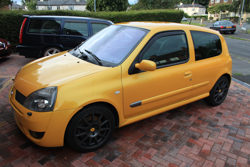

Here's the car in low light (it took a long time!) after completion...
LY 182 08-08-16 001 by AcidicDavey, on Flickr
LY 182 08-08-16 005 by AcidicDavey, on Flickr
