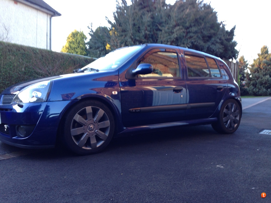

Alright guys, two options, colour code the side bump strips or take them off fill the gap, sand down and spray.
Really stuck on how it would look, it's on my 5 door sport rep.
Any chance of a photoshop?
Cheers

Don't remove them if you're going to do it DIY with rattle tins. Will look absolutely horrendous.
Even colour coding them yourself is going to look s**t unless you've done a lot of spraying.
Spraying the side strips yourself is easy, just takes a lot of time and prep, removed the side strips, sand them right down to remove all the texture, you need to start with a coarse paper and work you way down to fine grit until it's smooth, then plastic primer them and then hit them with normal primer, then wait to fully dry and harden and sand with 2000 wet and dry, then spray even light coats of colour and then finish with a few coats of laquer, then wait to hard and sand with 2000 wet and dry then halfords rubbing compound and then polish up
