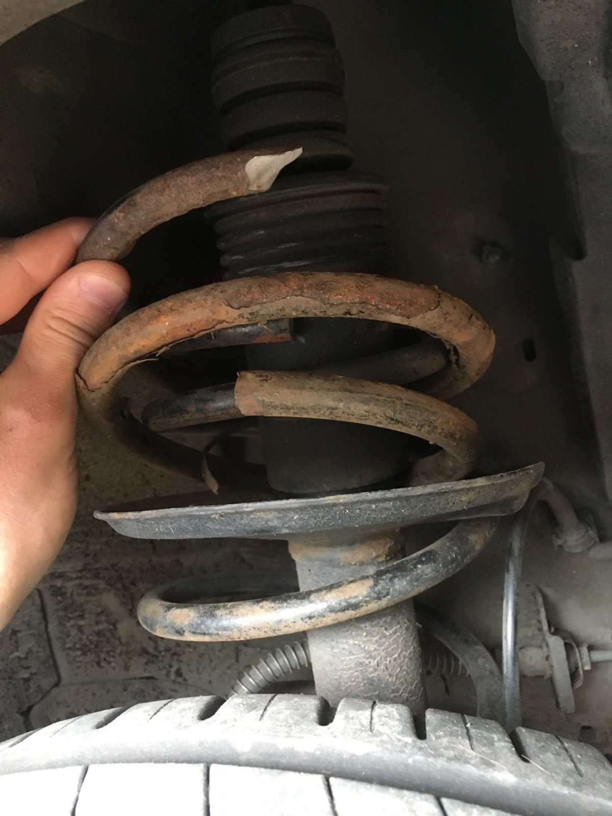

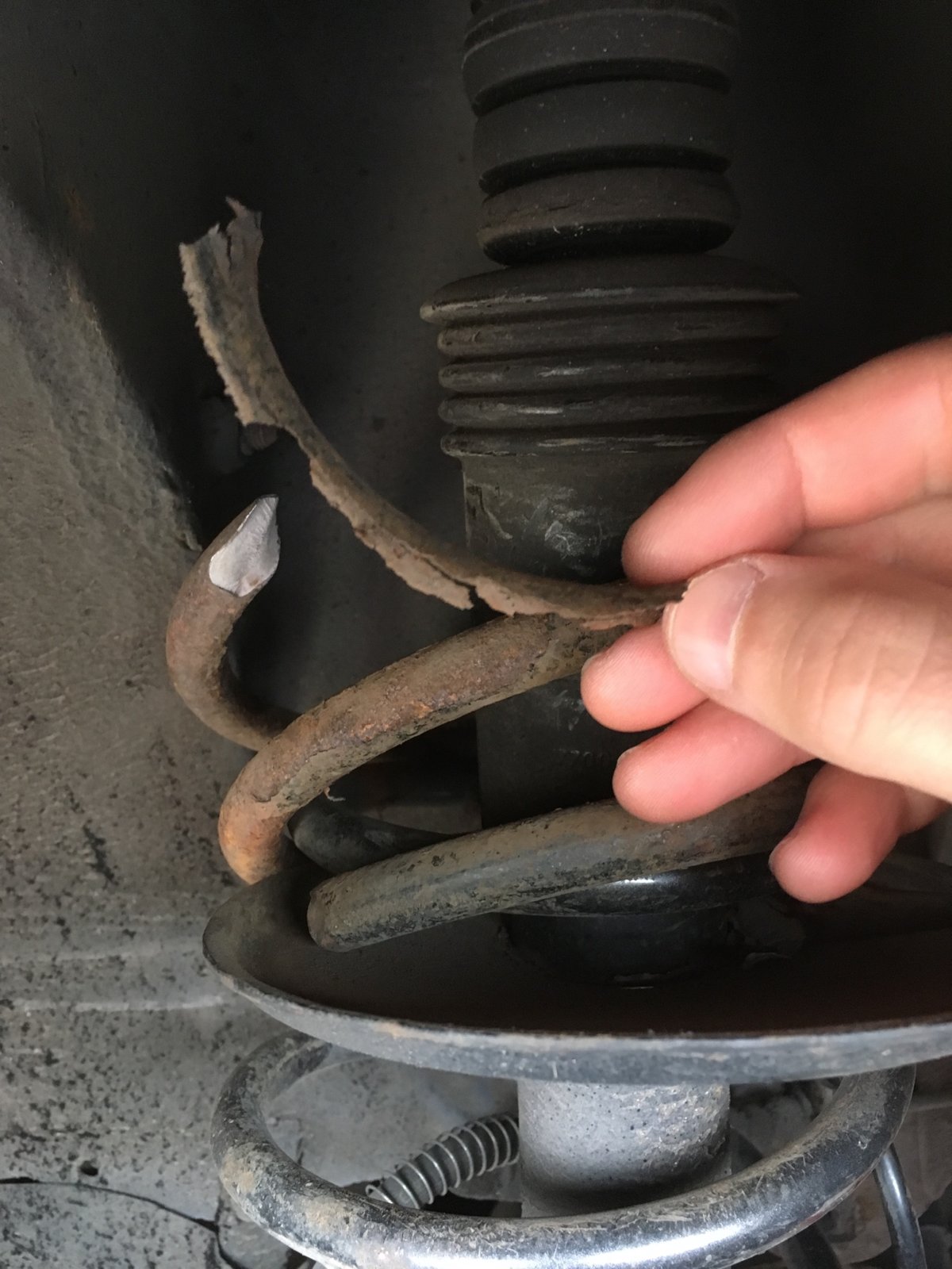

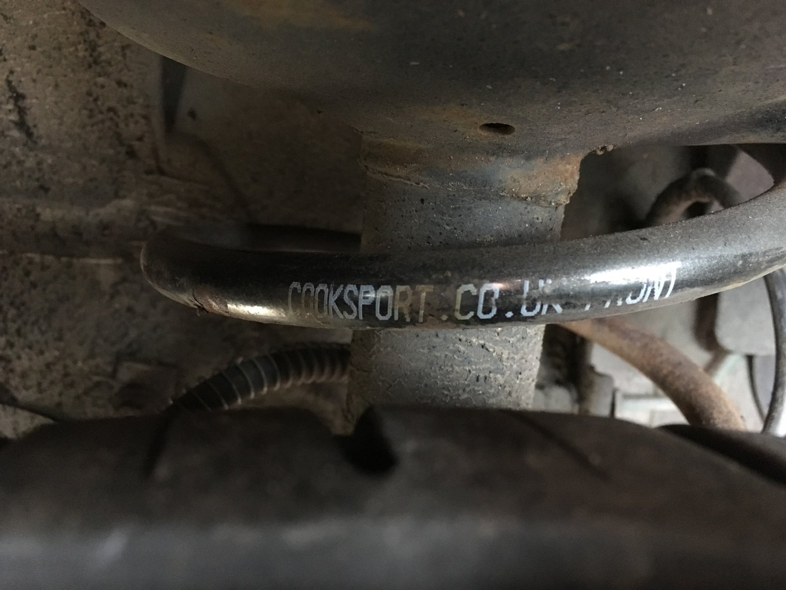

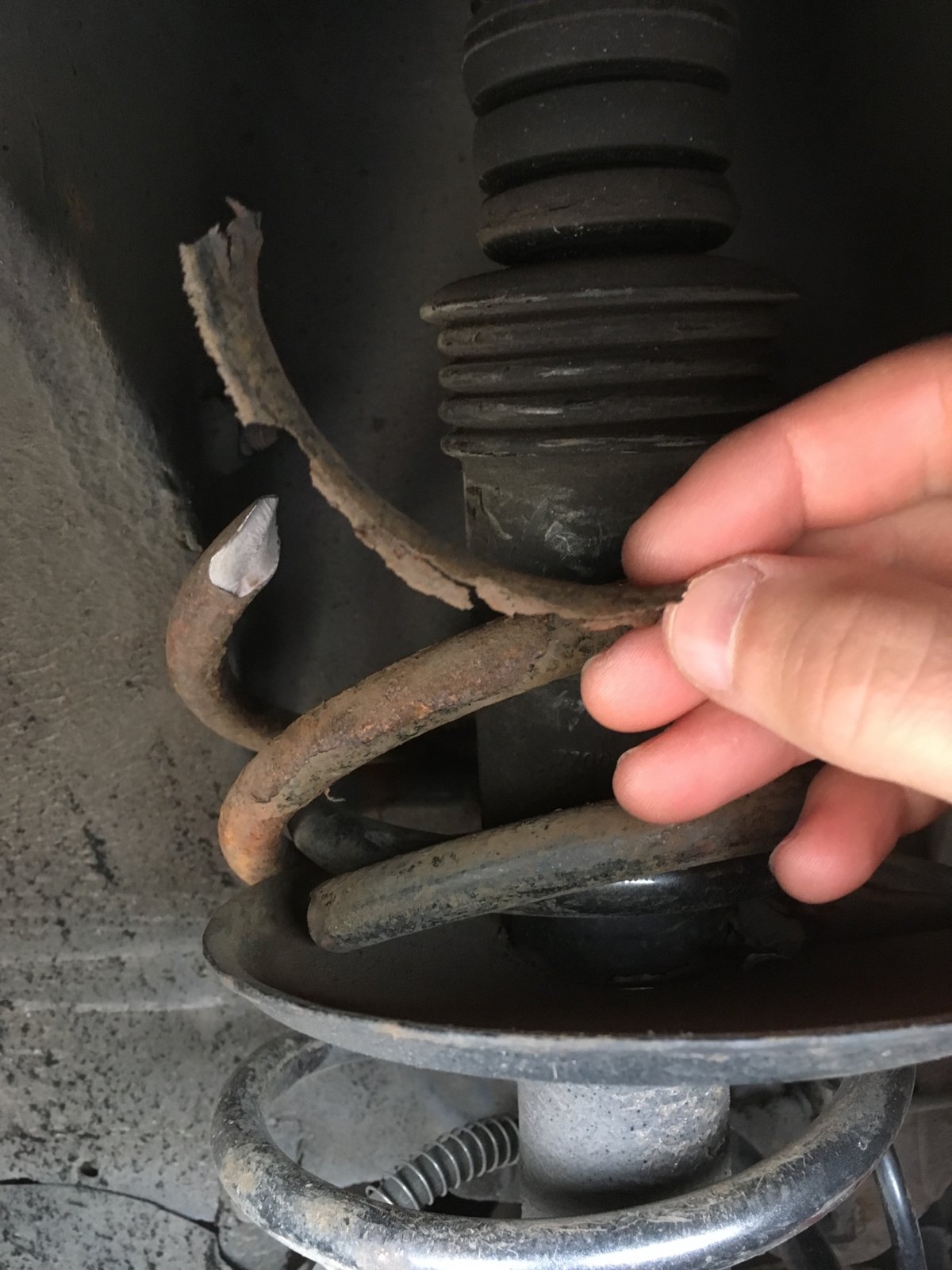

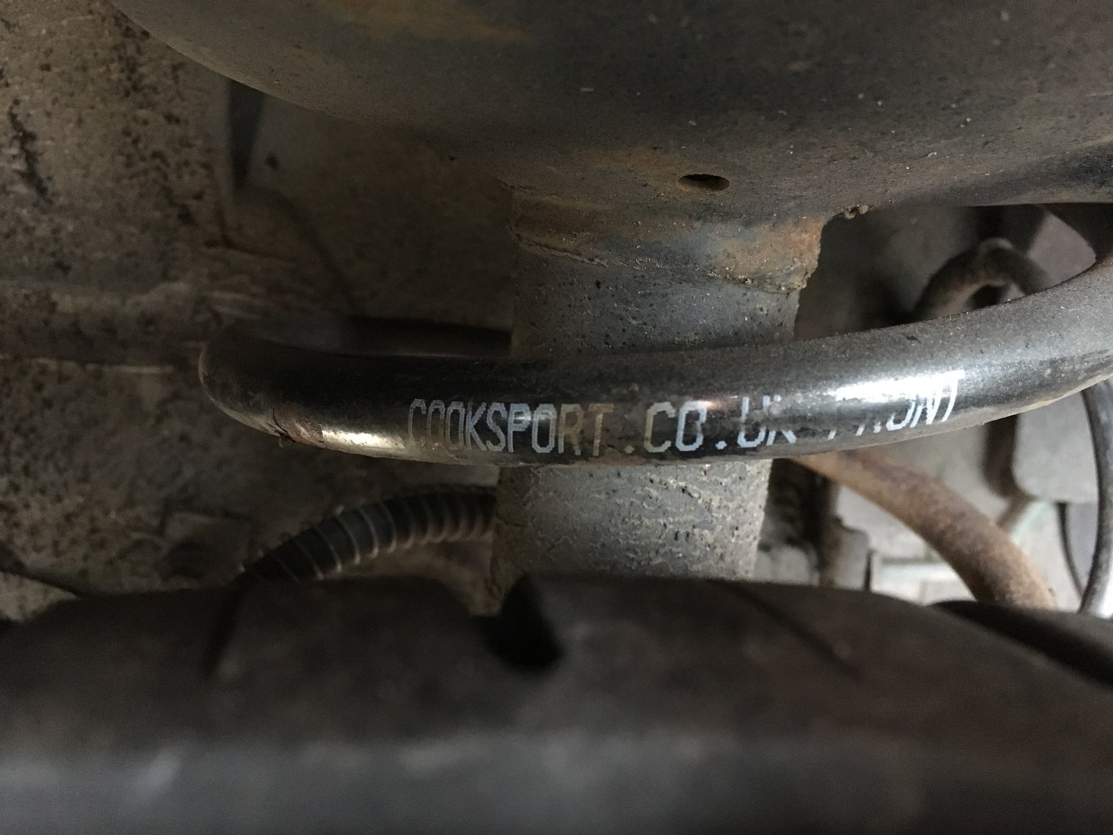

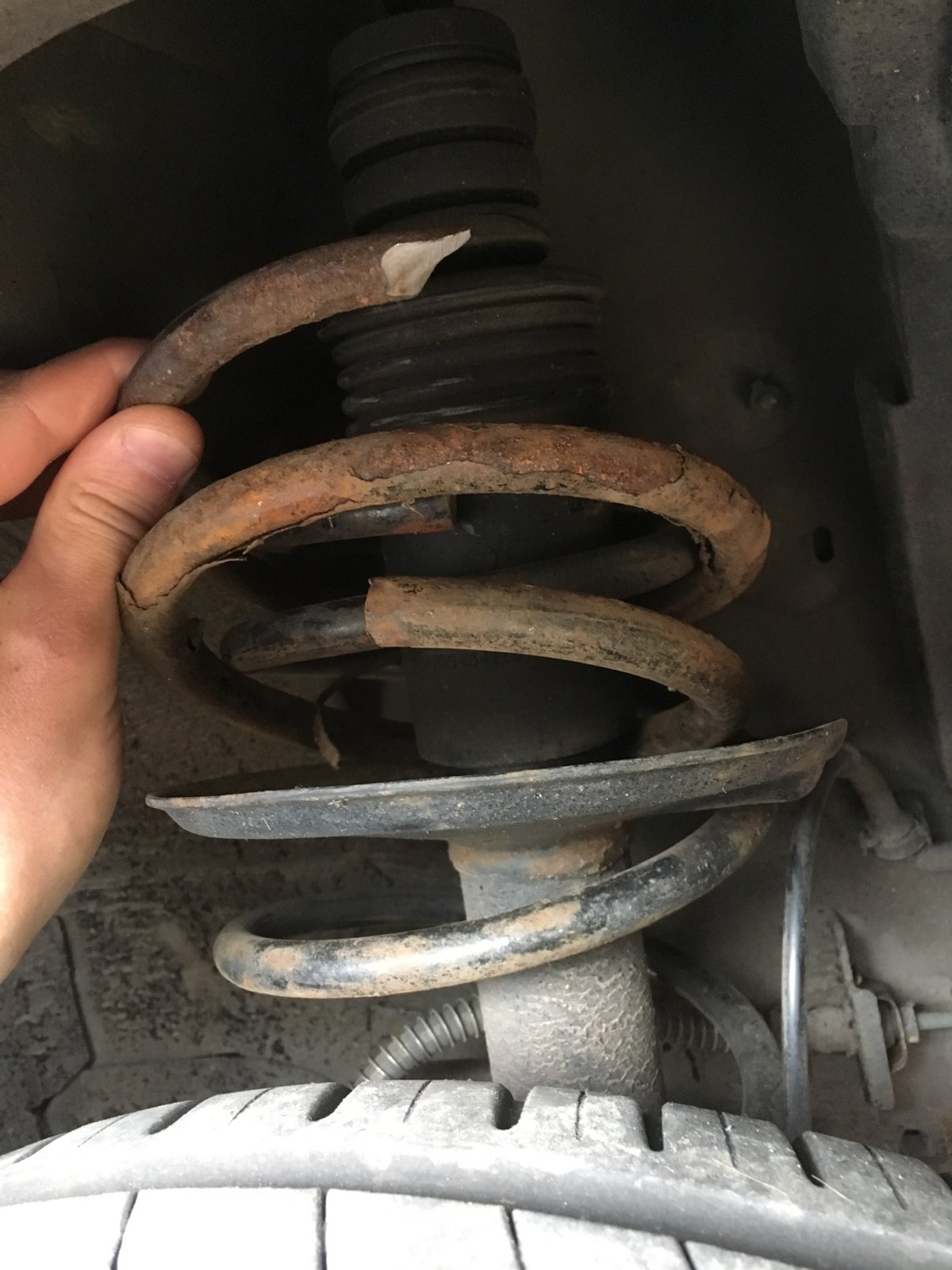

Whilst I was out driving a few days ago my front nearside Cooksport spring snapped. I’ve tried to get in contact with Cooksport to see what they have to say but they haven’t got back to me. I’ve had these springs on my 182 for 6 years and 20,000 miles. In the last picture you can see the anti corrosion coating has peeled off and most of it was sitting on the damper.

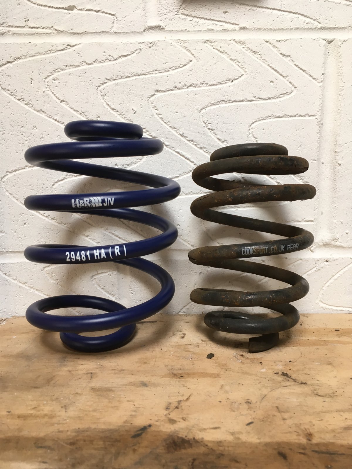

Just look at the spring dia and compare it to eibach or H&R when you get them you will see why cooks are cheaper!

Its nothing to do with spring diameter really. Theres multiple ways to make a spring to a given spring rate. You can use a thinner wire and more coilovers, or thicker and less coils. This gives different characteristics to the spring behaviour.
Its metal, when the powdercoating eventually fails due to the flex of the spring, water will get in and eventually you will get a failure on any spring
With the effects of low profile tyres and stiff modern chassis the springs get much more abuse than years gone by. Then depending on how its used also will have an effect.

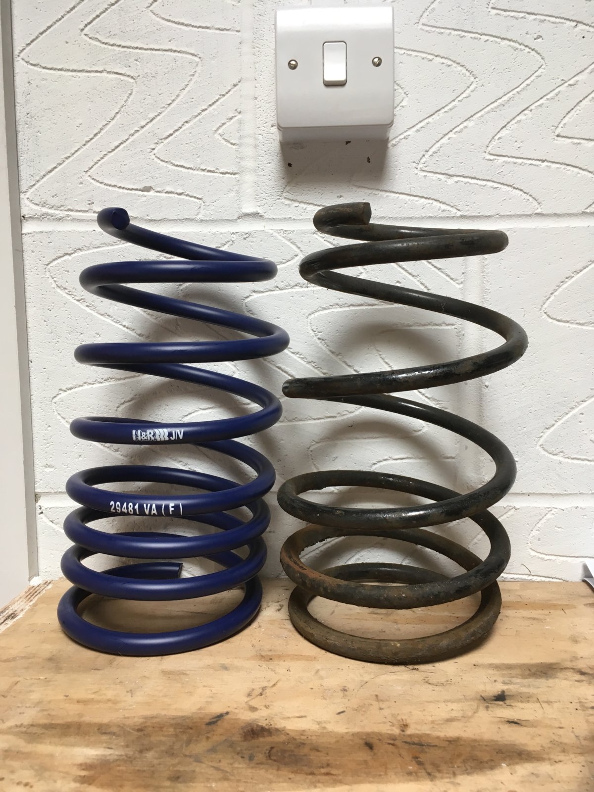

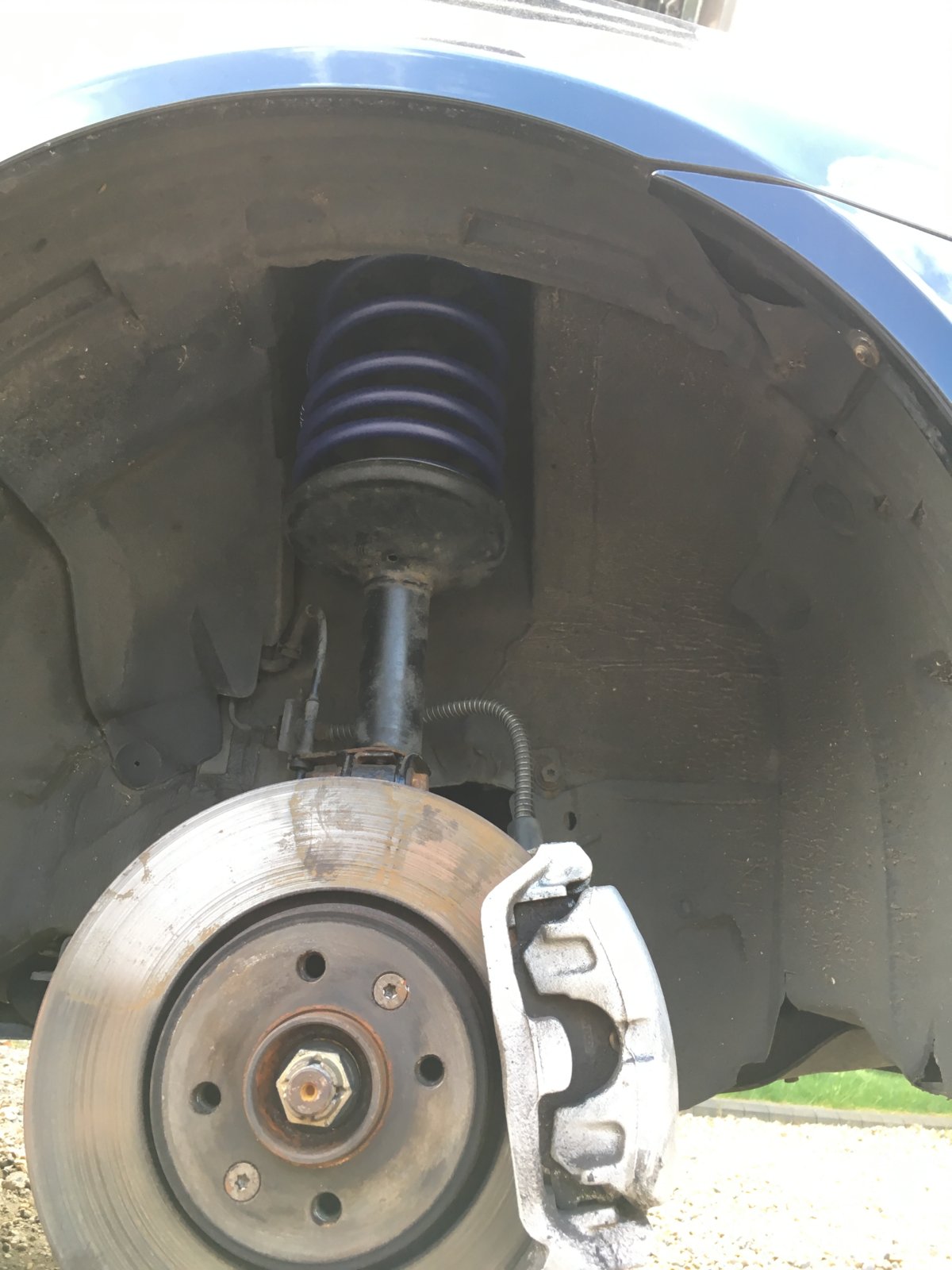

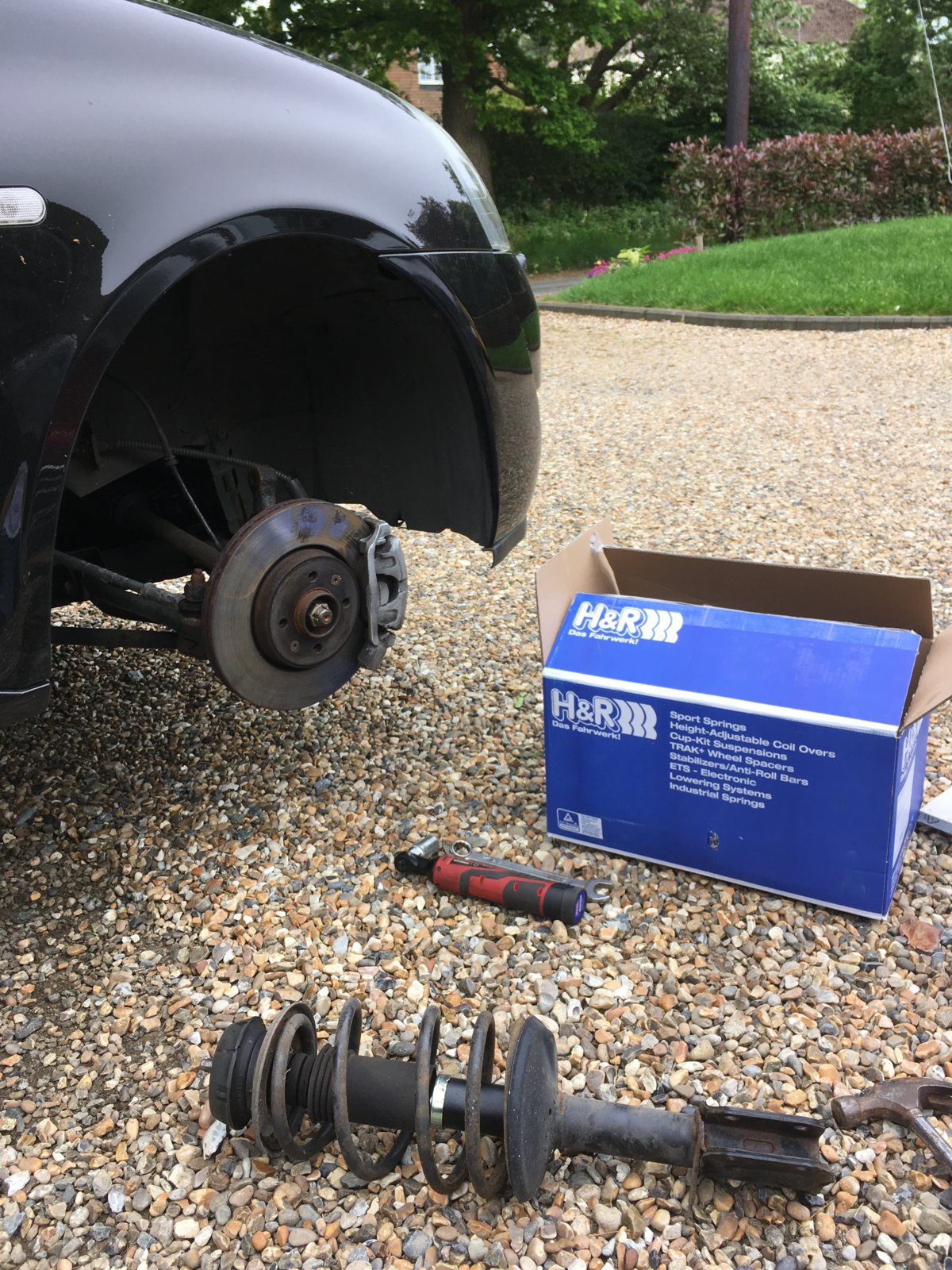

So making good use of the bank holiday weekend I had some spare time to swap my Cooksport springs over to the new H&R ones. Last year I had a full suspension refresh so everything was easily removed and the car was a pleasure to work on.
First impressions of the new H&R springs after a short drive are very good, the ride is smoother and more forgiving than the previous Cooksports which is something I am very pleased about. The ride height is similar to Cooksports maybe a fraction higher but nothing too noticeable.

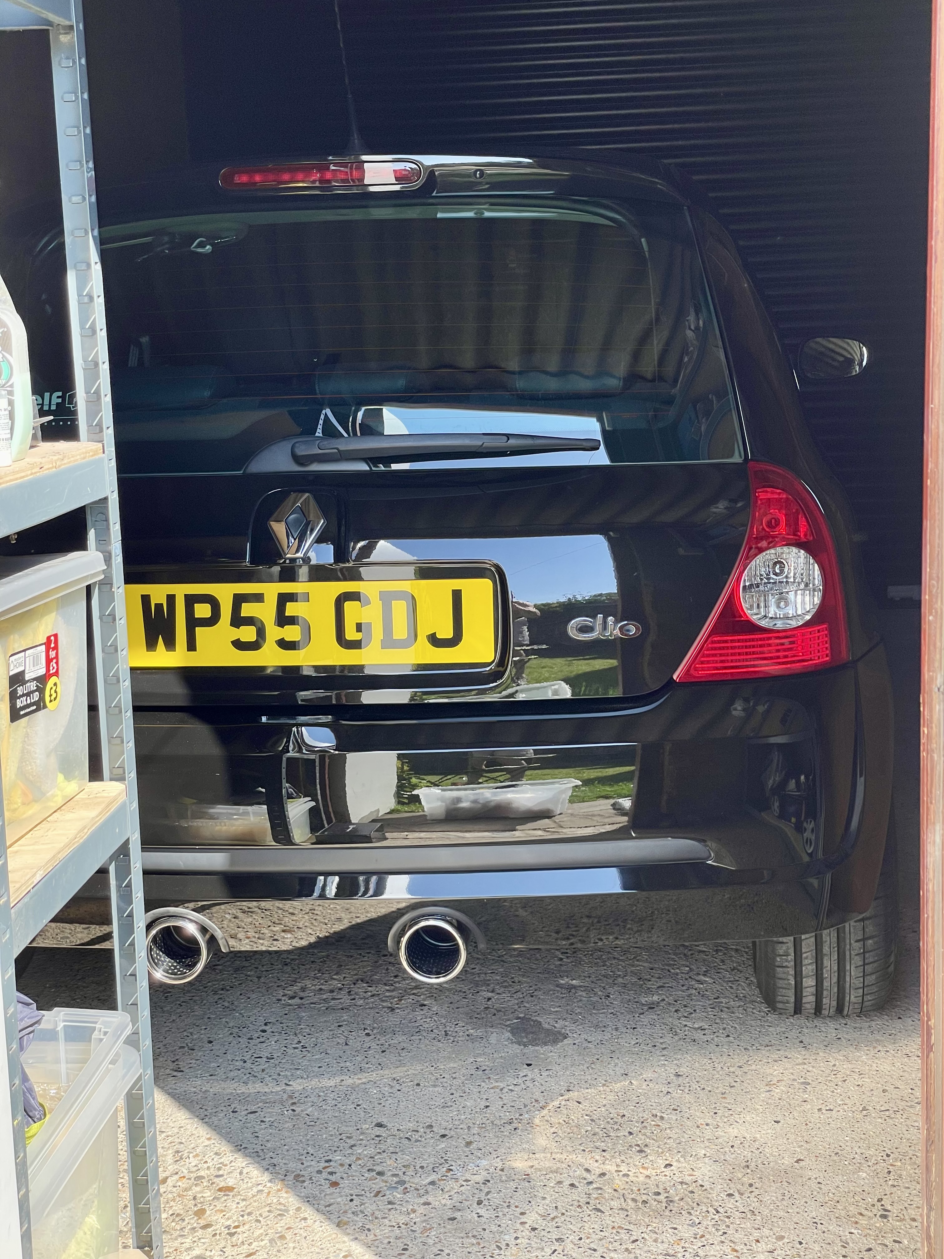

Just came across your post in the 'let's see your BG' thread. Have to say it's the cleanest BG I've seen personally well done man! How do you get your exhaust tips to sit so snug under the bumper? sorry to hijack your spring thread haha
@Tin.tin
Appreciate the kind words! The Piper exhaust I have fits really well with Powerflex exhaust mounts so it didn’t take much adjustment to get it sitting how I wanted. I’ve had this system on the car for over 10 years now and it’s a quality item.
