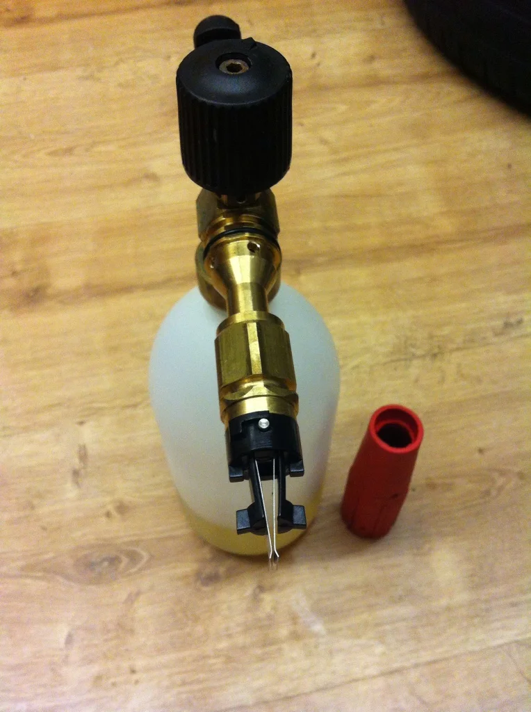

Why did i try to do it!!
ive broke it, the metal fins no longer move, they are stuck in one position, what an idiot! And i couldn't even free the metal fin part off.
  182
Don't think iv broke it, its held on by 2 pins also, different to the one in the video. However i cant take the main bit apart to get to the filter as i need to have it in a vice or the whole thing spins.

If your struggling Autobrite direct offer a 'service' option iirc, give them a ring and they will take it apart, clean it up and fir new seals and gauzes.

I wonder how much it all costs though, i had a look for a spare filter and even those are around £10.
  182
£15 Austin pal for the service, I need to send mine away as its doing the same thing
Read that thread above mate, im going to do it myself. When you get them they should say about servicing etc, even running the hot water through after each use would of probably helped like the video says.

But then they don't tell you to empty out your spray heads for harsh chemicals like tar removers, APC's etc to stop them working / sticking, but it's good practice to. I only rinse my lance through maybe after 6months, probably once a year. Depends how much you use it.

Mine did the same until I serviced it now its fine

I was retarded, all taken apart and cleaned up, quite a bit of s**t came out of the metal gauze and other parts of the gun, hopefully it will foam nicely once put back together! :)

Took my metal gauze out yesterday and it's a completely different piece of kit. It dribbled out before and wasn't that think. Now it comes out like I always wanted it to and blasts out.

Have just taken my AB lance apart and left it soaking as I was experiencing poor spraying and crap foam age :-/
