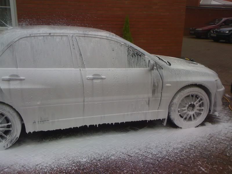

I have the magifoam it it went on like this...This was after 10 mins....
Couldnt get it off my drive for about 5 days FFS! Was done in the middle of winter though.
