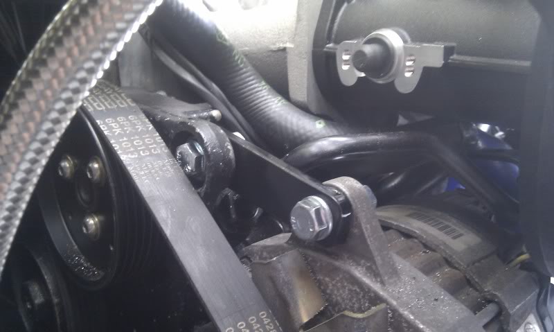

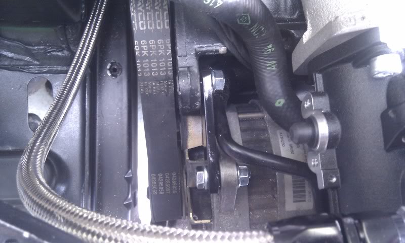

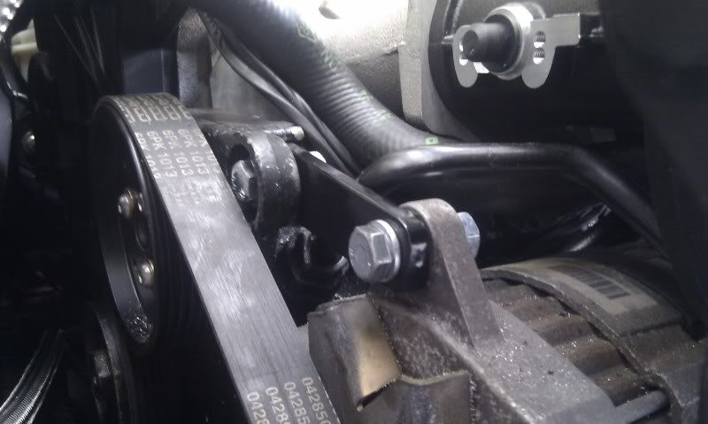

and had to remake the top alternator bracket as this was what I was presented with...
So....simple but effective

I've been playing around with my air filter back plate position and the filter.
Do you have a close up picture showing the back plate position seen from the front - mayby showing how the plate clears the alternator.
I had to trim my back plate a bit.
