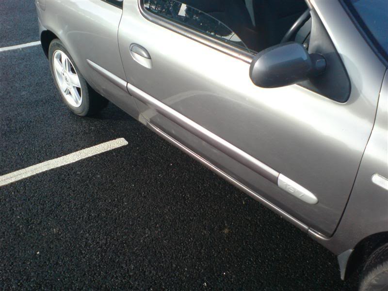

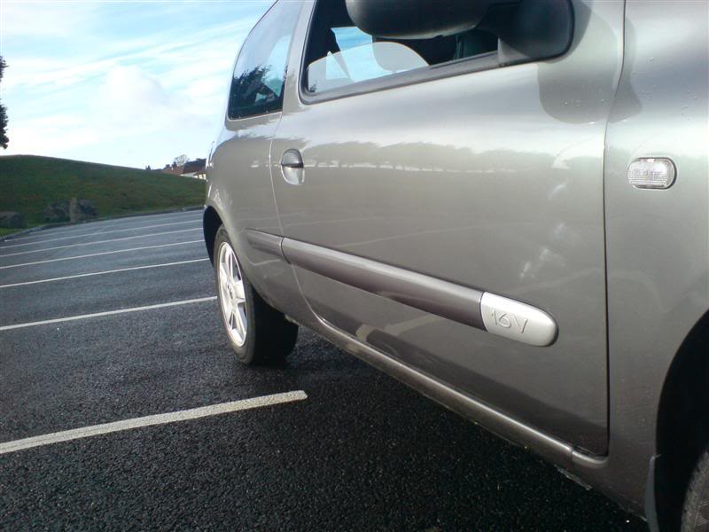

well i was happy untill my car broke today with how these turned out, quite a good colour match if i do say so,
16v meant to be silver :lolup: nah i first thought they were but close up its near enough exact, the colour of my car changes with the light sometimes see a tint of brown or purple in it depending on the light WEIRD
looks good against the rest of the car, but when you compare the two parts of the strip against each other in the last pic, they look different.
could this be down to the laquer??? found it hard trying to keep count of layers on each part so they were the same :o
looking good, another thing to remember when painting that sort of plastics you'll never get an exact match of colour in it. it's just the difference between painting metal and plastic. it doesn't shine up the same
what did you use? just 2 coat primer, 2 coat colour then 2 coat clear laquor??
2 primer about 3 base coats and a tin of lacquer really used alot of lacquer as with about 3 coats it still wasn't as shiney as it could be strongly suggest putting it on really wet but beware of the dreaded runs, little bit of cutting compound then Autoglym super resin and extra gloss protection,
