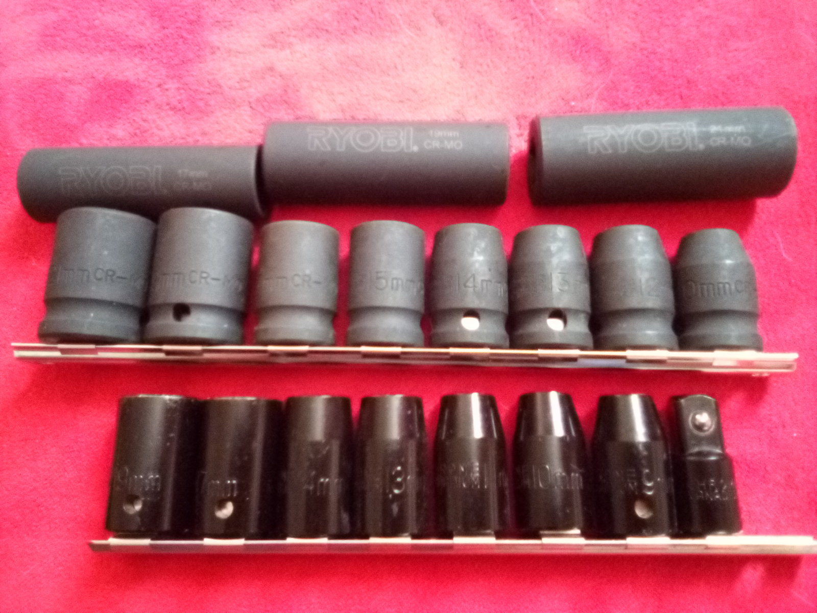

I forgot I had these knocking about, the 3 deep sockets came with the gun 17, 19, & 21mm.
The two rails between them have 9, 10, 11, 12, 13, 14, 15, 17, 19 & 21mm.
1417996
That should be enough for most jobs on a car right, or am I best getting a set of deep sockets too?
  997, e208, I.D. Buzz
Very few bolts on a car that can be accessed with an impact gun & deep socket combined IME.
  Rusty Cup
Use any combination of adapters and extensions you like. I would advise against using universal joint adapters! from experience you dont want one of those hitting you in the face with 400nm of torque behind it.
Impact sockets are black and are a softer material than chrome sockets. The idea is the socket takes the shock and deforms over time. A chrome socket will transfer the shock through the drill to the gear set. That being said dont let it stop you using them i do and will continue to do so.

I’ve found you’re better off with deep sockets. 9/10 times my impact gun won’t fit in to the spaces I need it to so having a couple of extra inches is always good.
