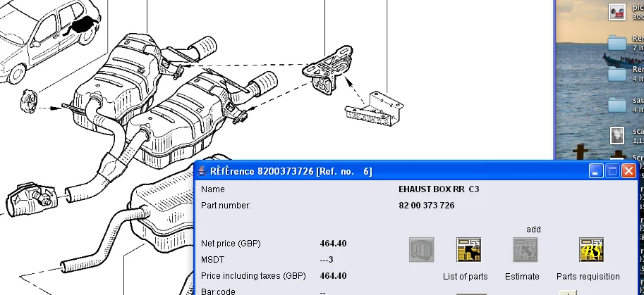

I was told 'the rear boxes have collapsed'... I said 'oh I saw they looked a rusted and old' and he said 'yeah, if you hit them with something you can hear the chunks of stuff inside rattling around like glass, they honeycomb structure has collapsed'... 'probably won't pass next MOT so get it replaced before then'
I just got hold of Dialogys to show you what he showed me on the screen... I'm talking about this bit:
