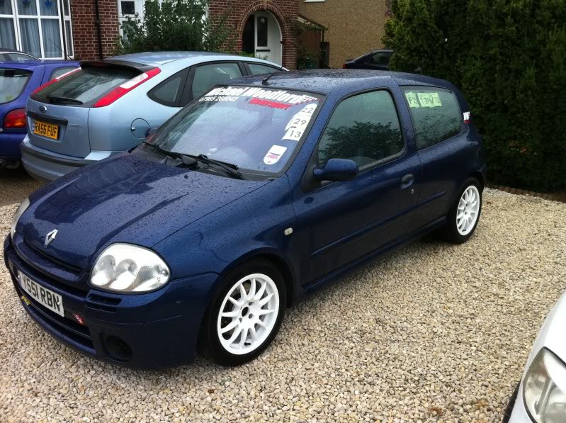

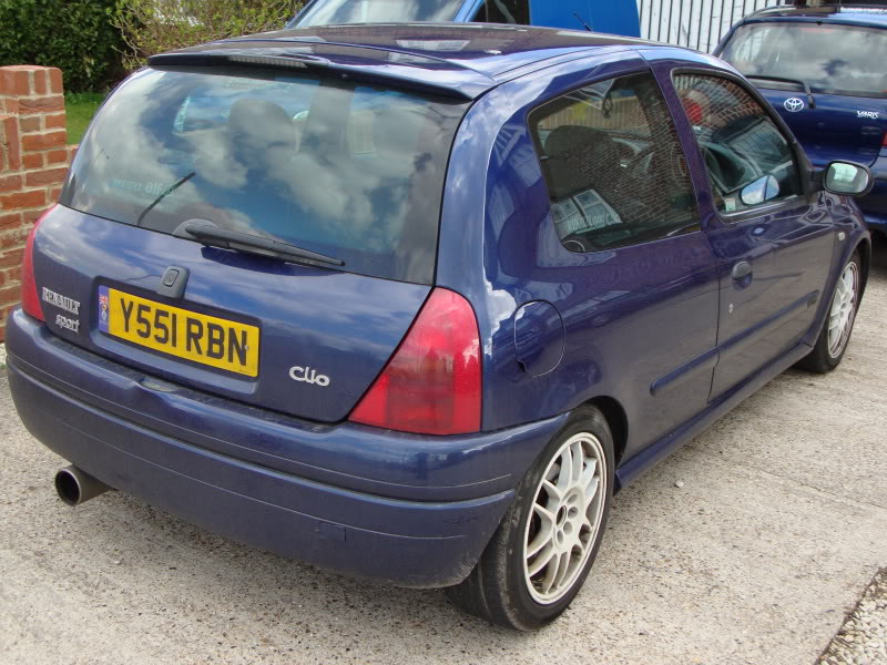

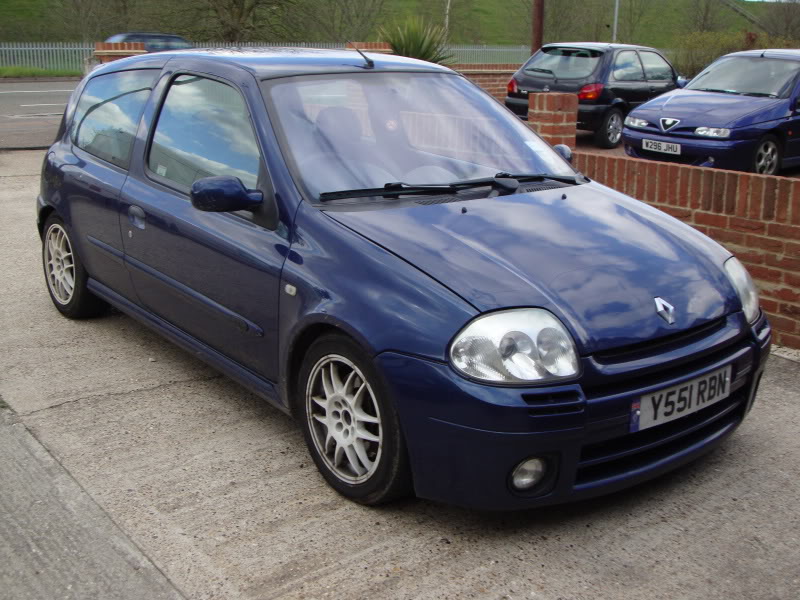

This is what it looked like when I brought it.
So the Clio was staying. I decided to use it as a track car as i wanted to get into track days. My theroy was that if I binned it, it didn't really matter as it would be cheap to fix or replace (turth be told now, Id be gutted if something happend to it!) So the track prepping begun.

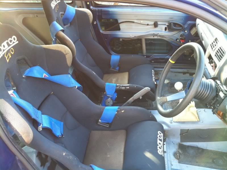

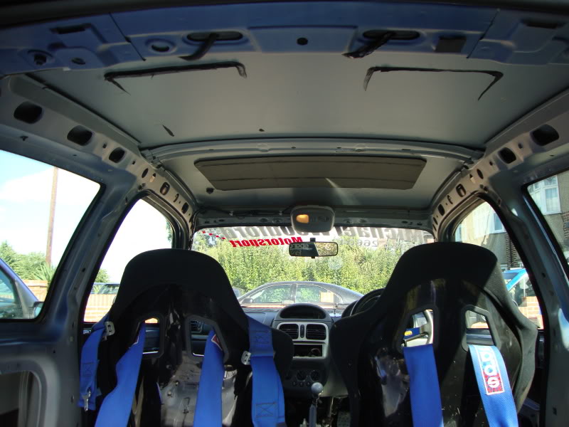

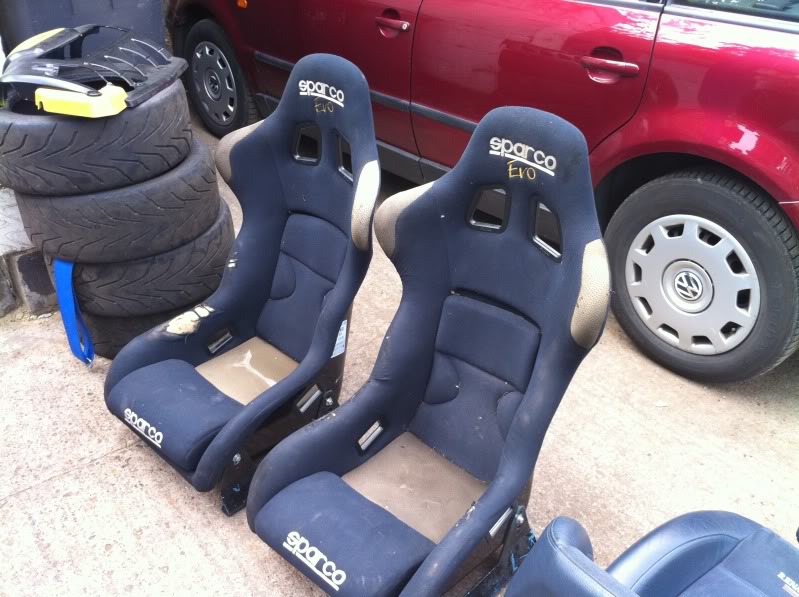

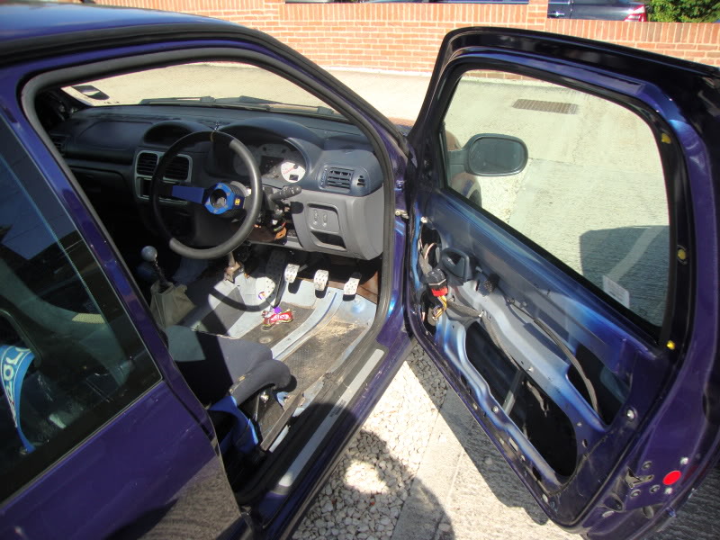

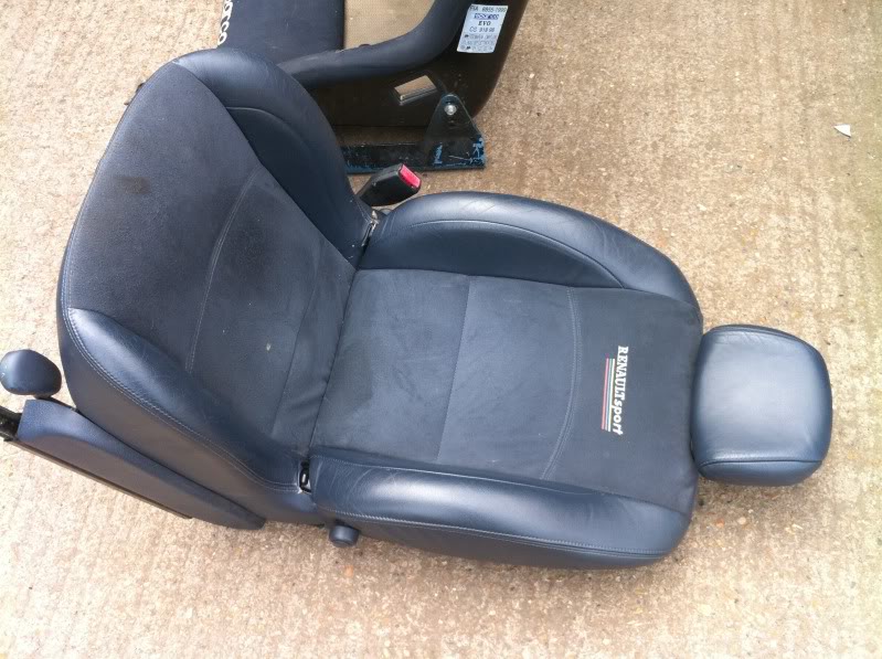

The first thing to do was to fit the bucket seats from my old Focus RS powered Transit Connect Van, Strip out the interior and fit a better steering wheel.

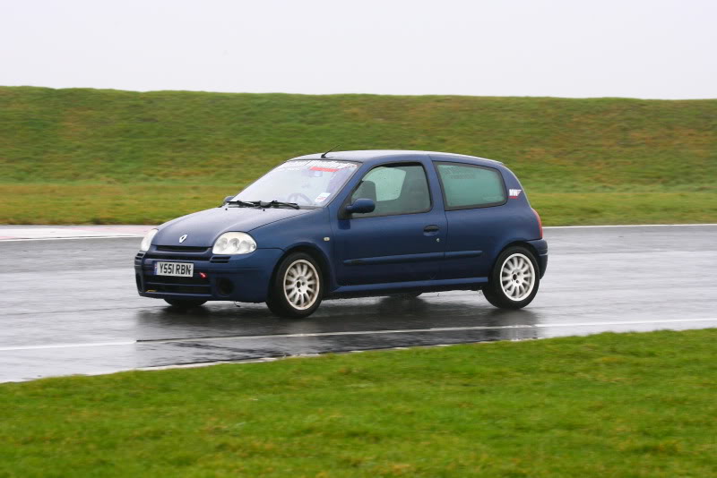

Here she is on track at silverstone. Thats my mum in the passanger seats and the brake discs are just starting to glow :twisted: :twisted:

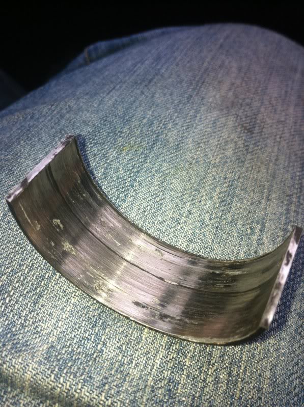

When we got to lakeside I checked all the levels witch were all fine and set off home. Sadly on the way home it started to knock :| :cry:

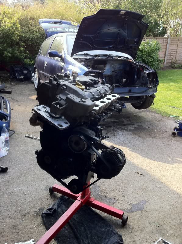

After 140,000 miles the engine had finally taken all the abuse it could and had spun a big end shell.
The damage

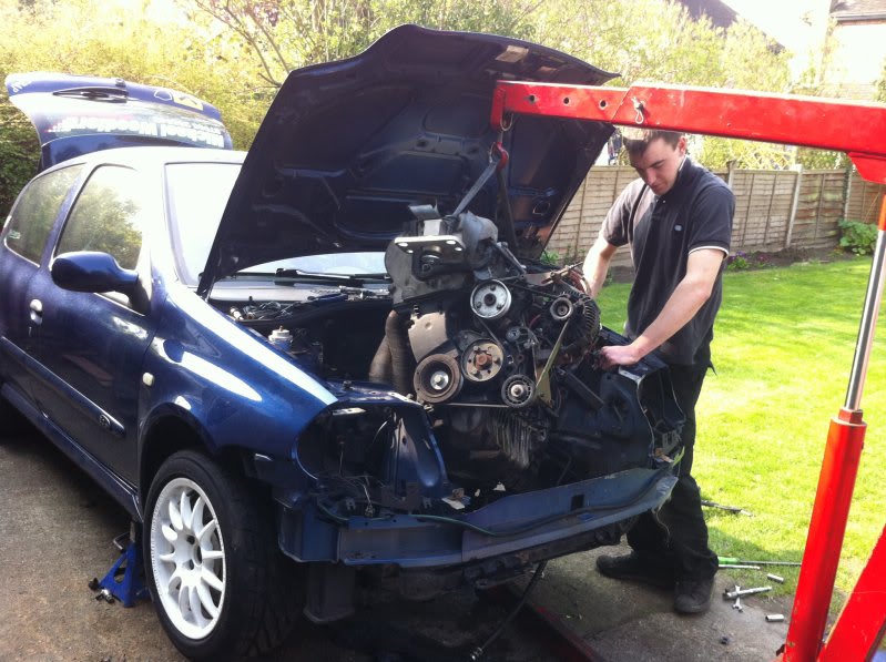

I wasnt't gunna let this be the end of my awesome little track car. As a matter of fact, this was a perfect excuse to put some plans I had into action.

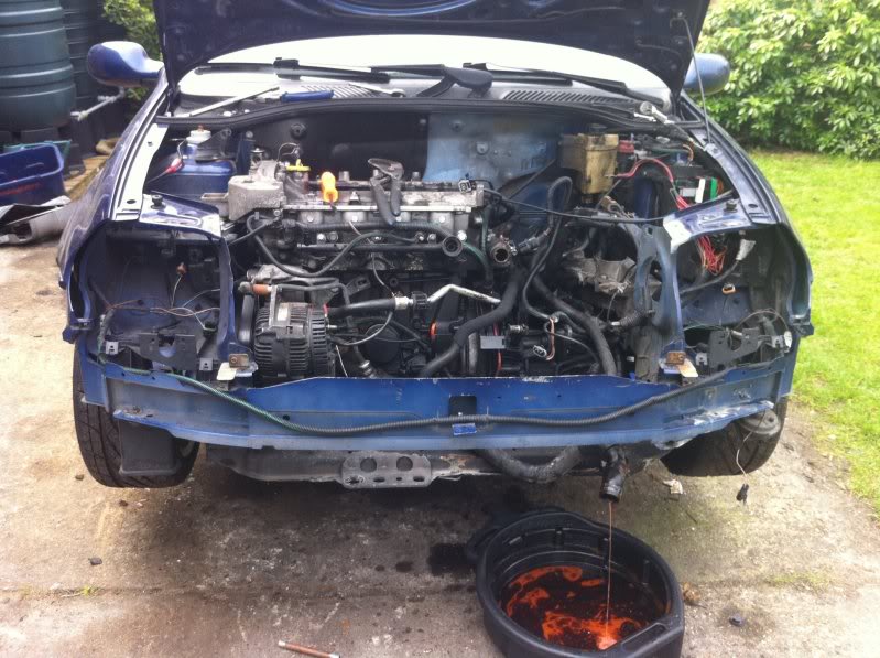

Im now half way through rebuilding the engine, fully forged, low comp ready for a supercharger. The figure im going for it anywhere between 300bhp-350bhp. No more No less. Im also going to be fully rebuilding the gearbox and fitting some 4 pot brakes. :)

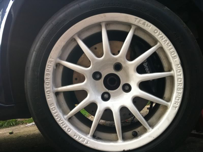

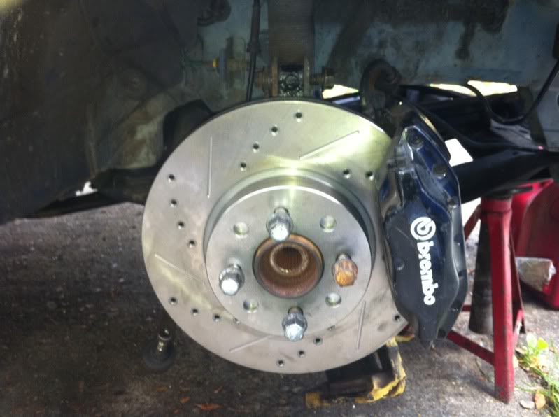

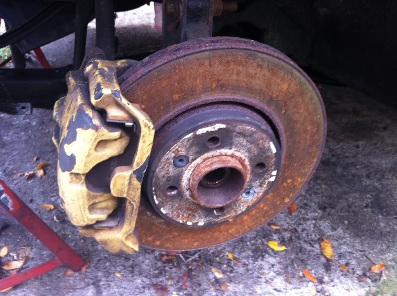

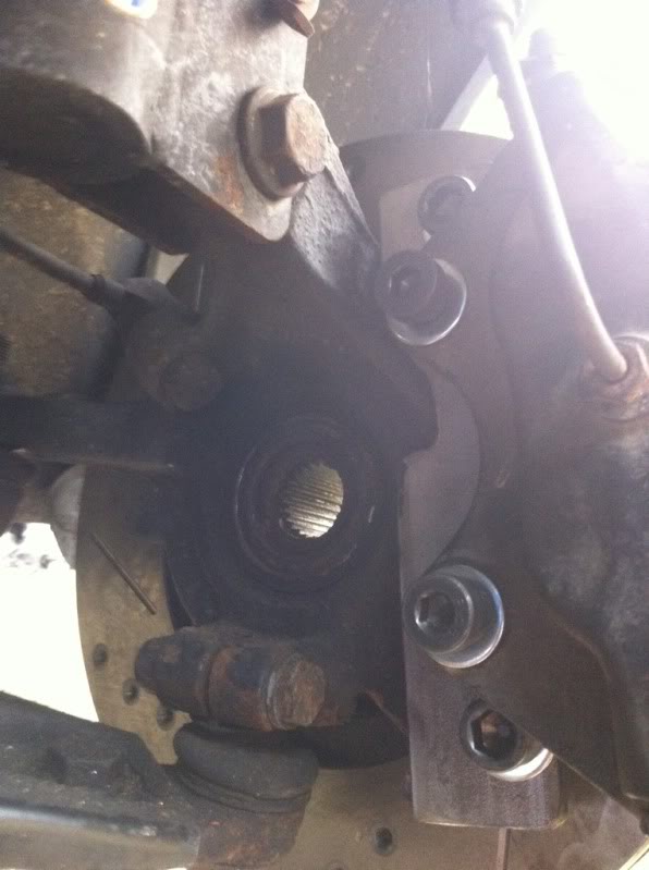

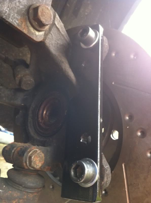

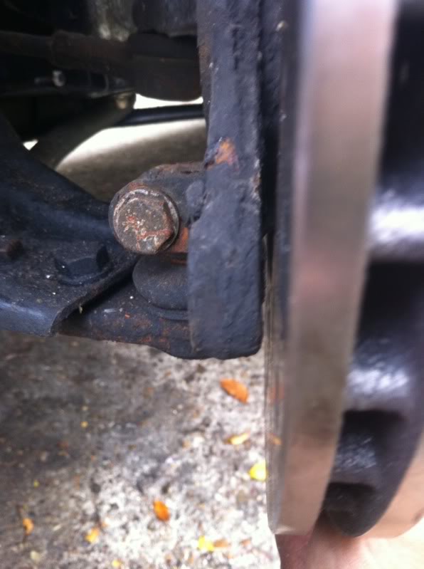

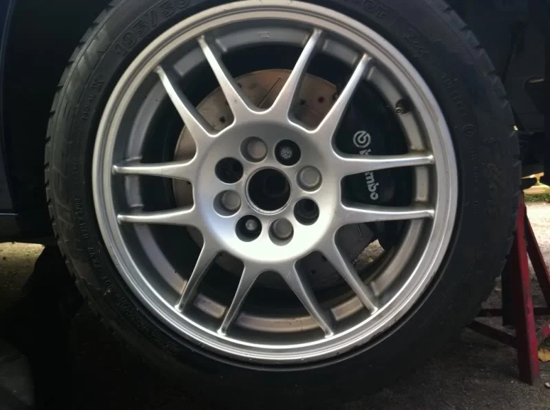

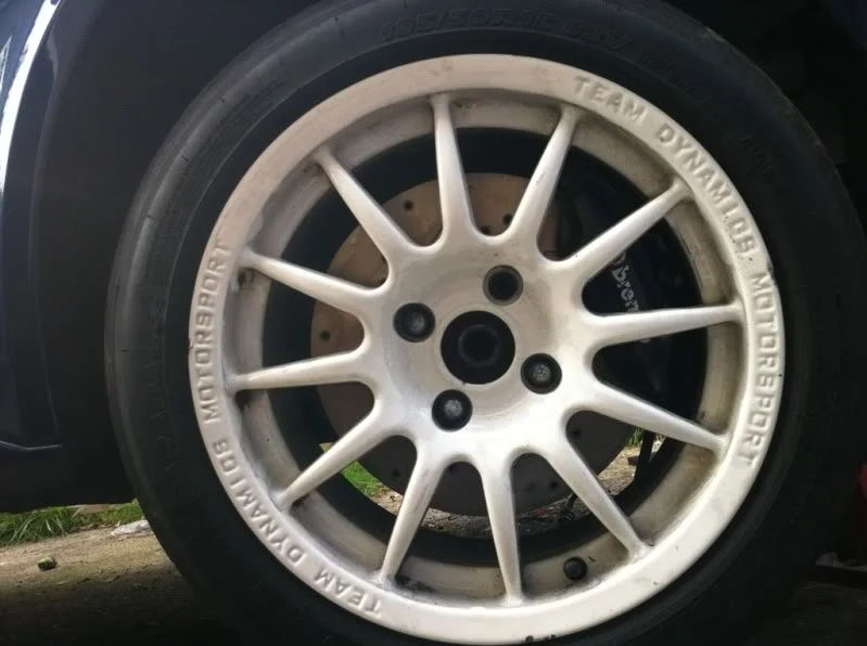

Small Update:- The Brembo's Are On :)

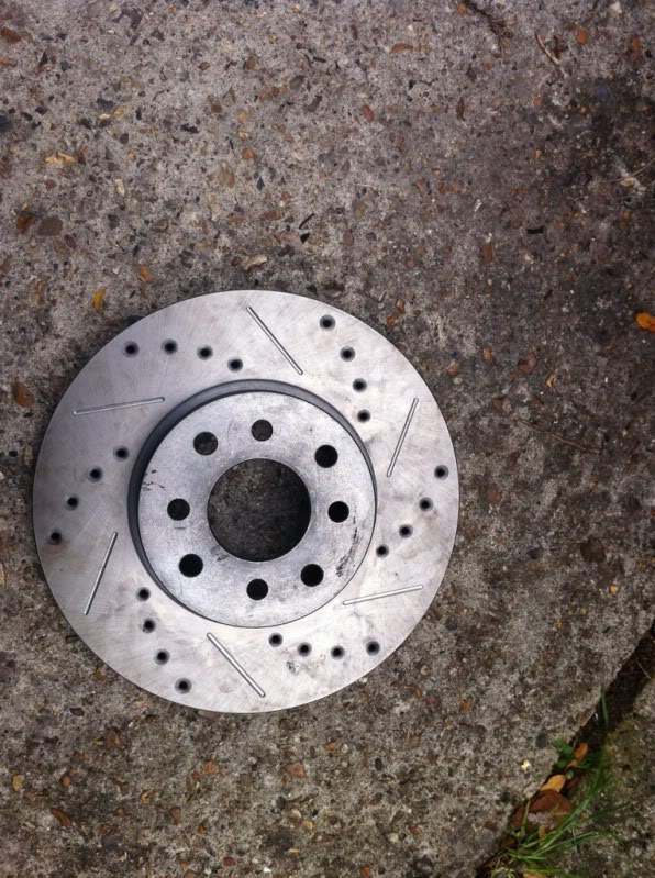

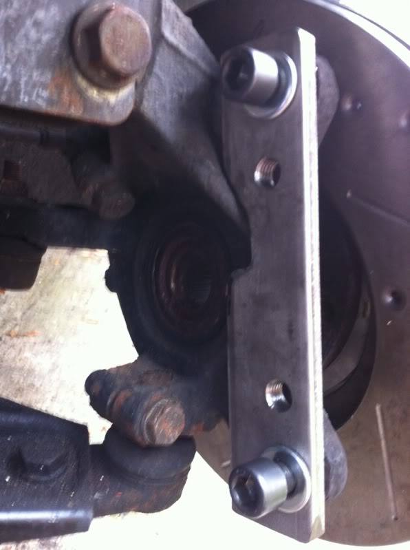

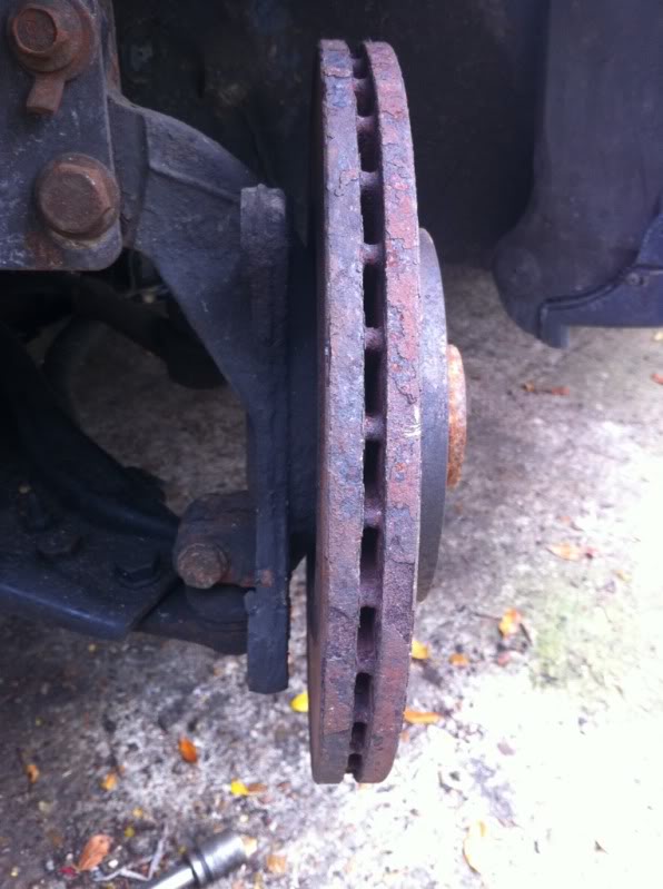

I wanted to upgrate the brakes on the clio without moving to bigger wheels (size 15inch) and I didn't want to use wheel spacers either. I found a cheap set of 406 Coupe Brembo 4 pot calipers and I came up with this..........
Normal brakes, Forgive the rust, the car has been sitting in the garden for 8months now.
Note how far out the standard disc offset is
I needed to move the caliper more inboard so's not to need wheel spacers. I decided to run a different offset disc to move it all in. These are Ford disc's im guessing due to the 4x108 holes in them but they were easily re drilled to 4x100
Note how much more these discs are tucked in by

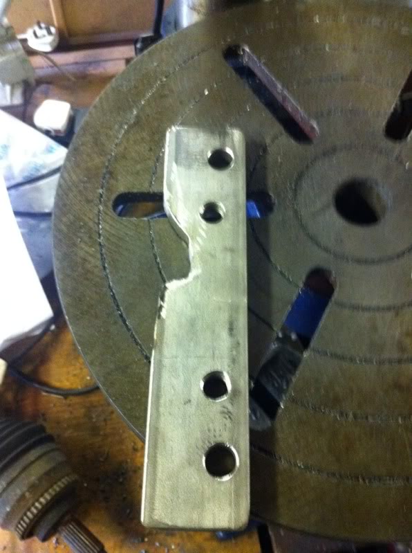

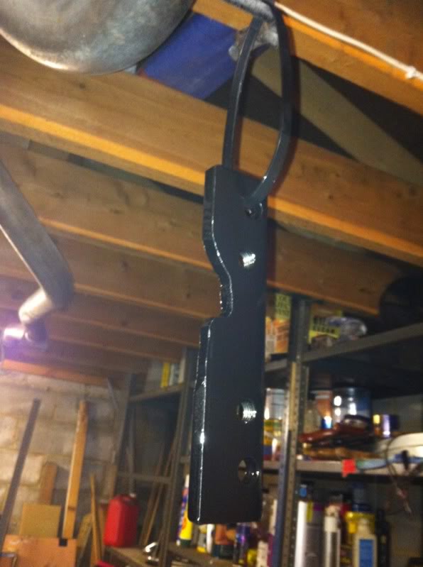

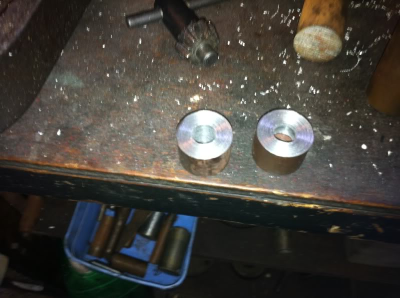

Once I knew where the disc was in refrerance to the caliper mounting bolts I was able to fab up some new mounting brackets in the correct thickness to alow everything to run inline. I used stainless steel witch was proberly overkill but its what I had laying about.

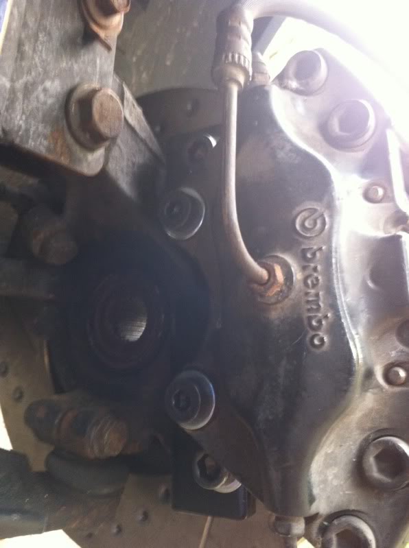

Once I was happy with the bracket I'd made, I gave it a quick paint. Im not one for shiney bits everywhere.
Annoyingly the caliper needed to sit right over the top of the bracket mounting bolts so I had to shave away some of the caliper but luckly is wasn't that much so didn't affect the strenght of the mounting.
And there we are done! I use the Team Dynamics everyday and the standard wheels of track use and both if with about 5mm of clearance. :)
Scrooge
  E55 AMG
It doesn't look like the caliper is sitting far enough on to the disk. Excellent baragin on the calipers.
  Ph1 172 & Clio DCi
I don't know why the pictures look like that. I think its the angle they've been taken. When you see them on the car they look fine. The tops of the pad are over the top of the disc by about 1-2mm

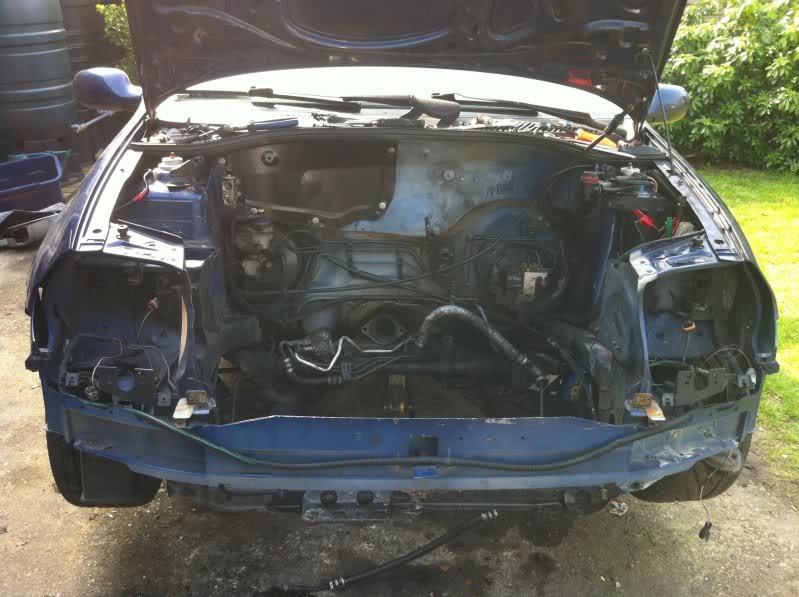

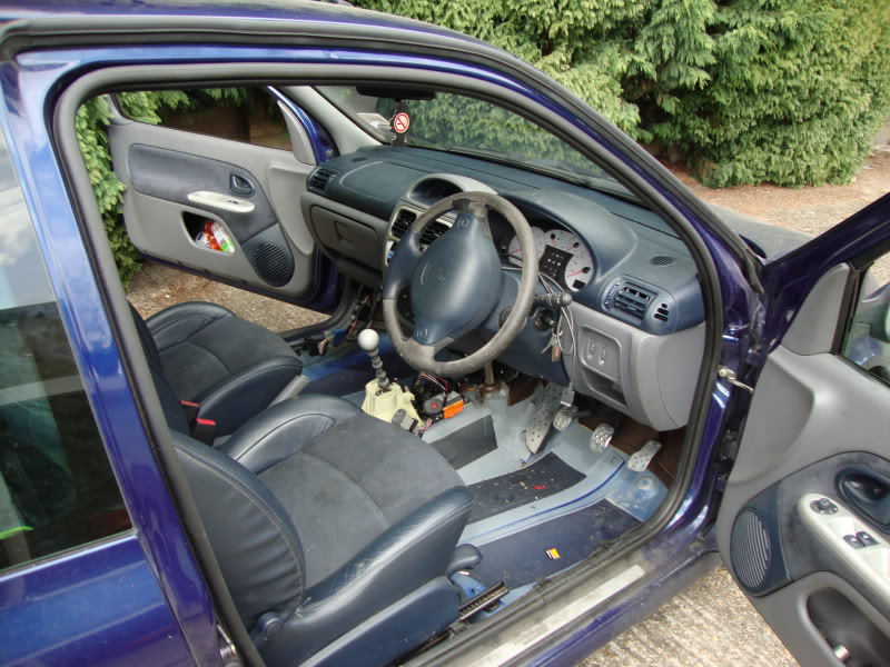

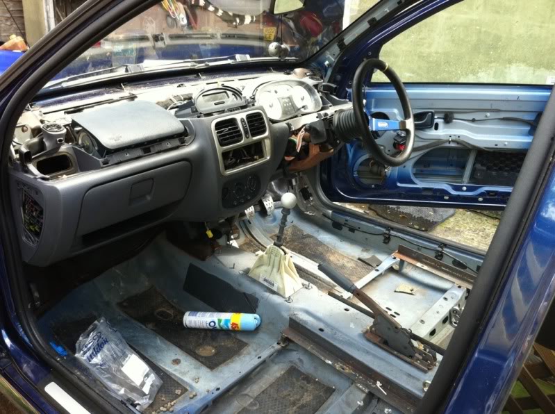

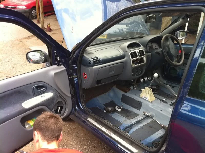

Small update today.

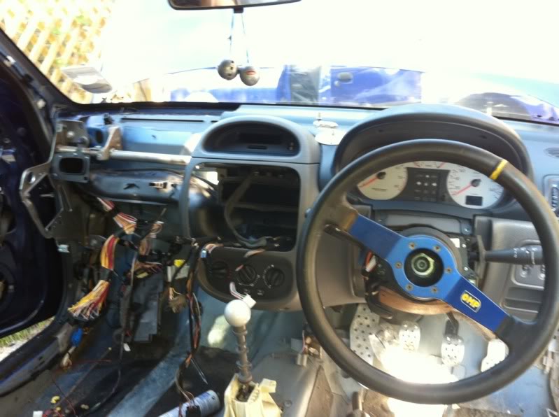

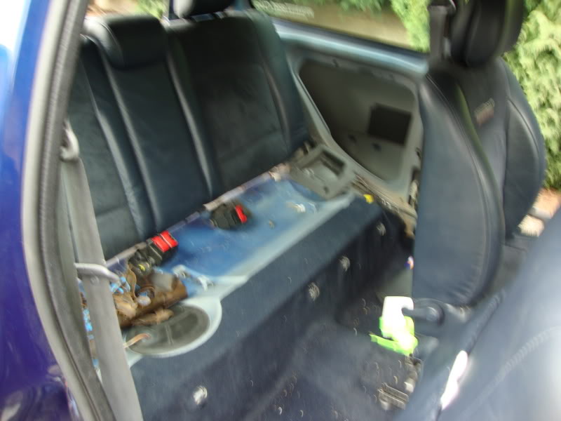

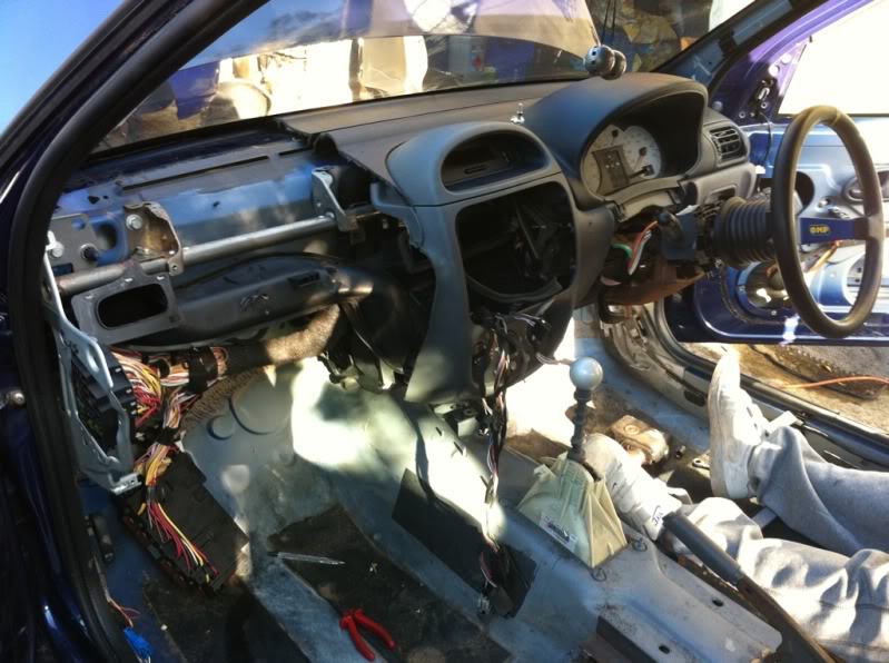

Ive decidied I want the car too be 1000kg with me in it. That gave me too options. Lighten me or Lighten the car!

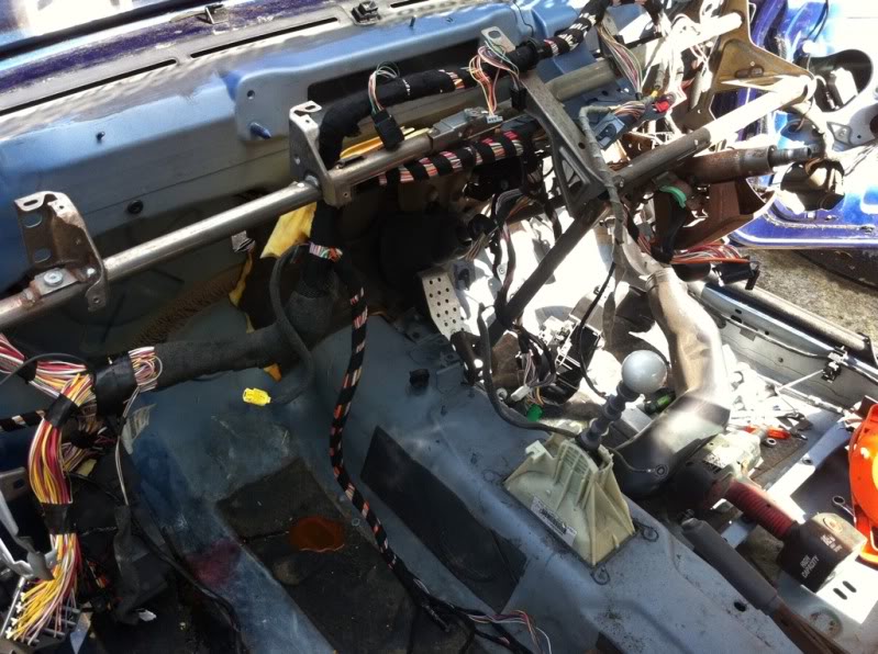

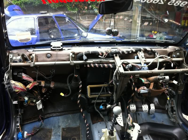

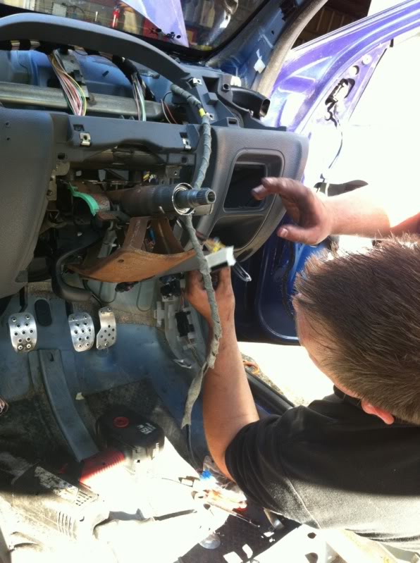

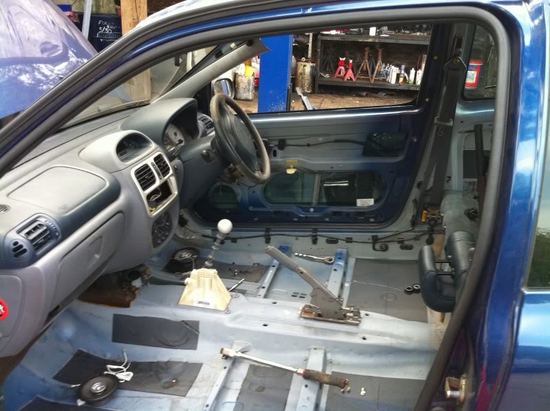

So today I started by taking out the dash and removing the sound deading from behind it and removing anything elce I felt I could live without.

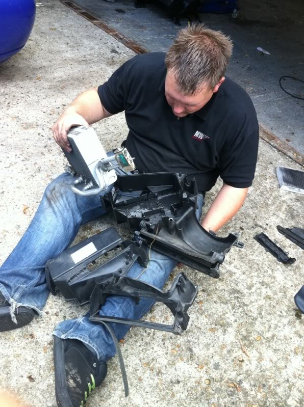

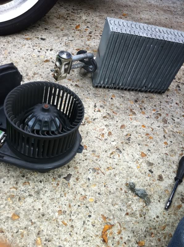

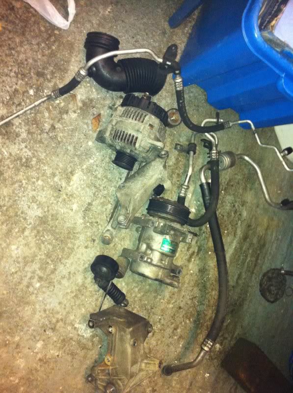

As it was all apart, I decided to remove the heater box and get rid of the air-con matrix too

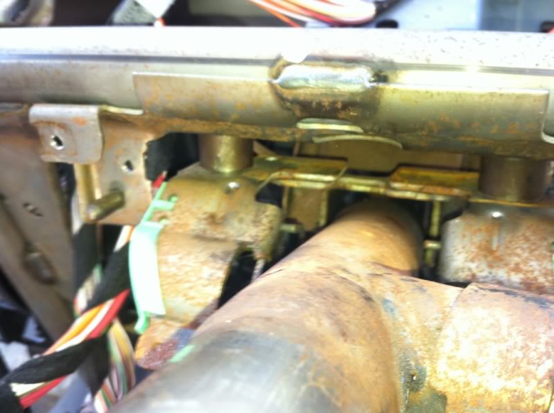

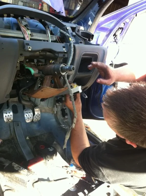

Also as everything was out, I decided to try and find a way to lower my steering coloum. As my bucket seats are mounted very low to keep my weight low, even with the colum on its lowest setting, the steering wheel was still a bit high for me. So I got to work on the lathe with some round bar and made these spacers.
Next I got a bit carried away and cut the dash in half. It actully fits very nicely.

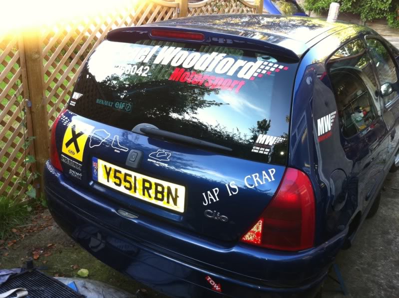

Then to finnish the day off i fitted my Cup spoiler and suck on a couple of track stickers. Yes I have driven every track that I've stuck on lol.
Next week im going to rip the ABS pump out and the brake lines ready for full braiding and install all the cables to put the battery in the boot.

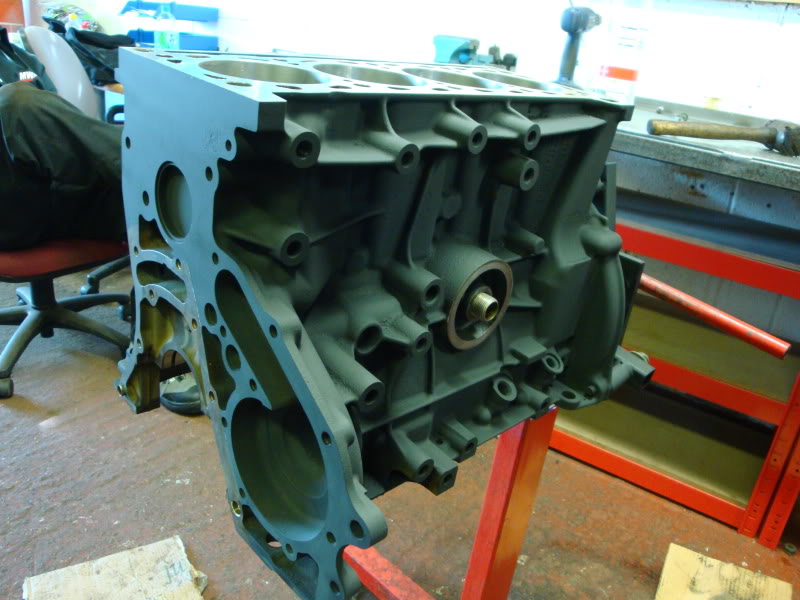

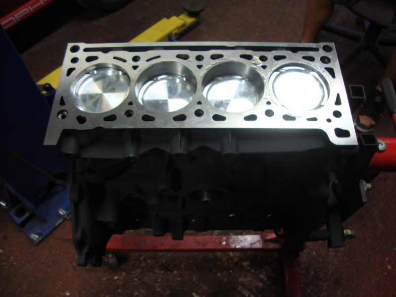

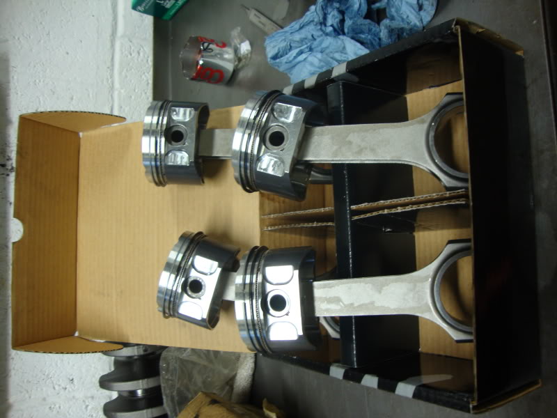

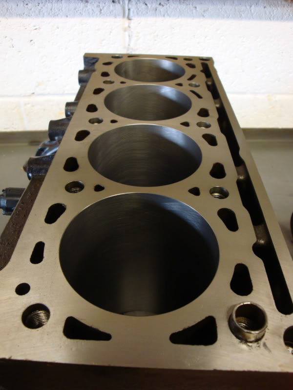

The engine parts have finally arrived back from the machine shop!- Engine part p**n inside this post!

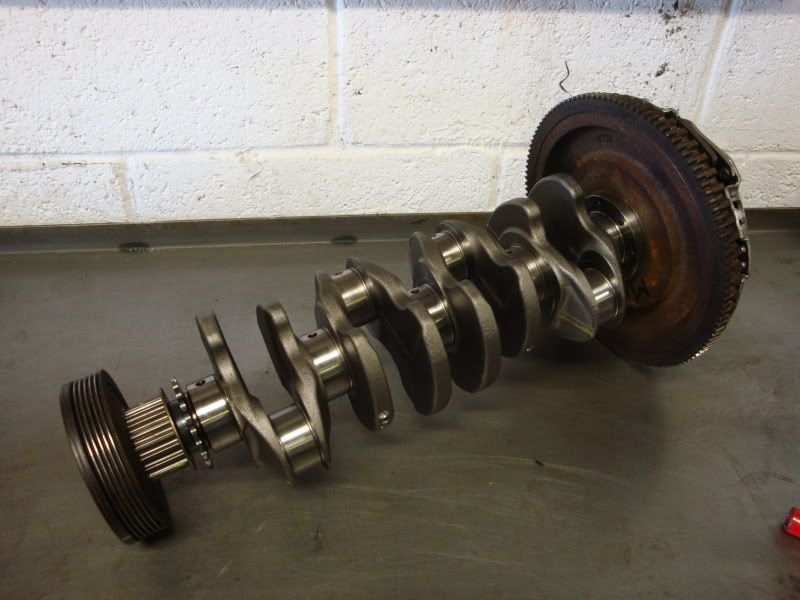

After shite service from a local machine shop, they have finally delivered the goods and appart from there crap customer service, there work is as always TOP!

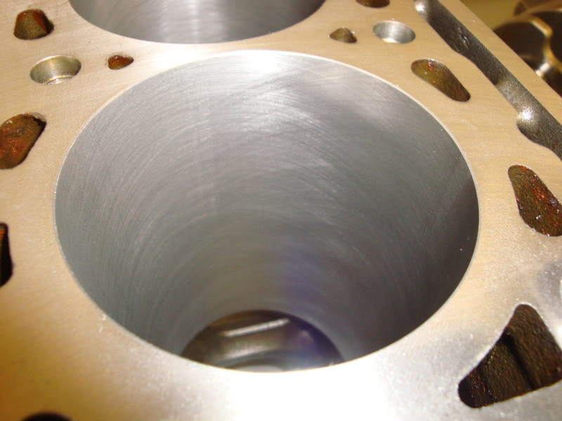

Work I had done:-
Pistons weight matched
Rods end to end balcenced and weight matched
Flywheel skimed
Block Faced
Block Bored
Block Honed
Crank chain gear and cambelt gear keys
Full rotating assembley balanced.

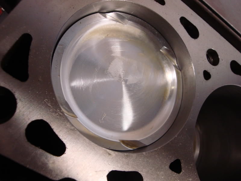

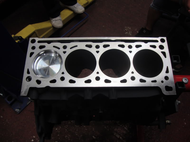

First job was to repaint the sad looking block to smarten it up a bit :)

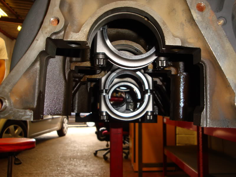

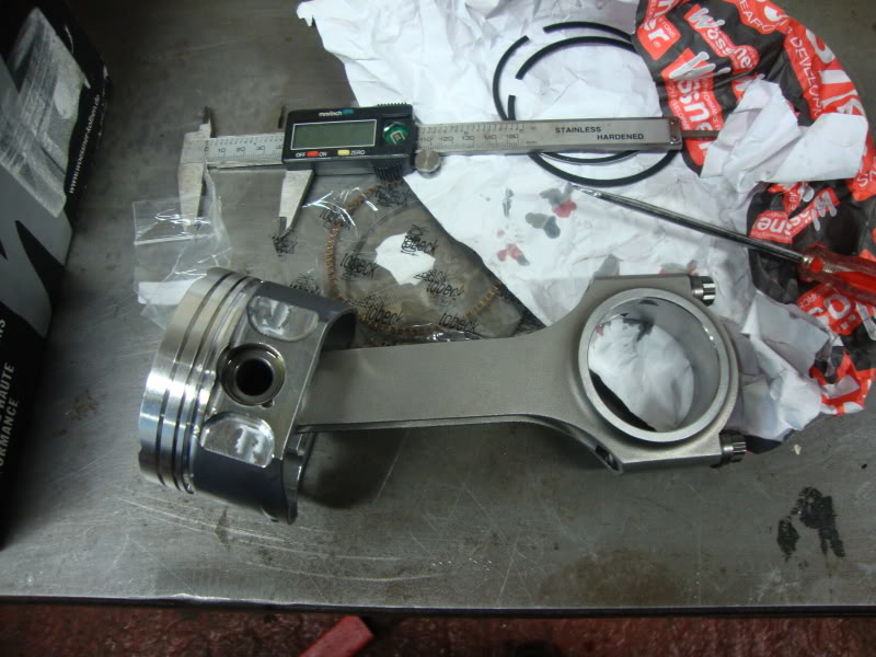

Then I had to measure all the ring gaps to make sure they're all correct for aplication.
Once I was satified with the ring gaps, the rings could go on the pistons, and the pistons onto the rods.
Next it was time to full clean the pistons and rods after putting them together and totally cover them in oil before putting them into the block.
Next is a big order from renault, Bearings, Gaskets, Seals to finnish off the bottom end. Then I can start work on the head :)
