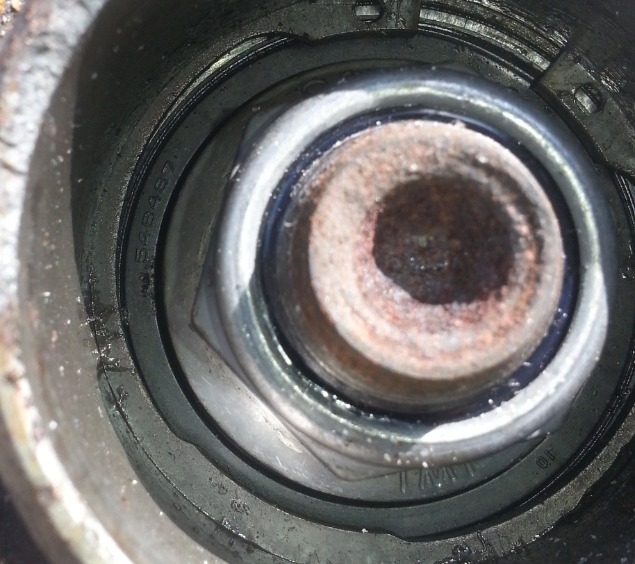

My nsr has got through 3 bearings in 12 months and now I'm wondering if the spacer wasn't replaced by the guy who last did my disks. I had a look at the guide you linked here but it doesn't even mention the spacer, unless I'm being thick (quite possible).
Am I missing the point?
Is it possible to check for the spacer's existence without removing the disk completely?
Ta!
  172 PH2
Take a photo of the rear hub nut and post it up.
Not sure what I should be looking for, hope you can see it :)
