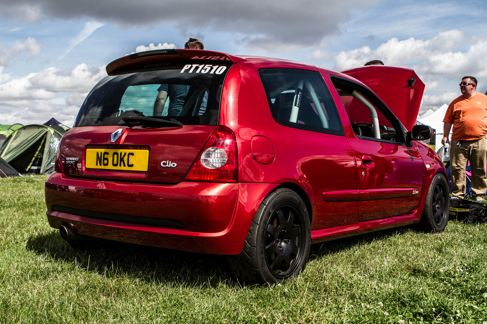

I have 25mm fronts and 8mm rear spacers.

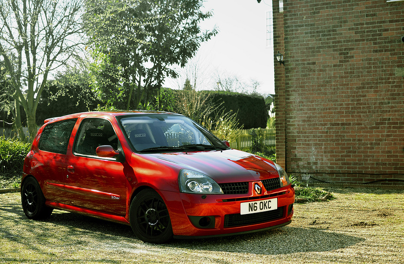

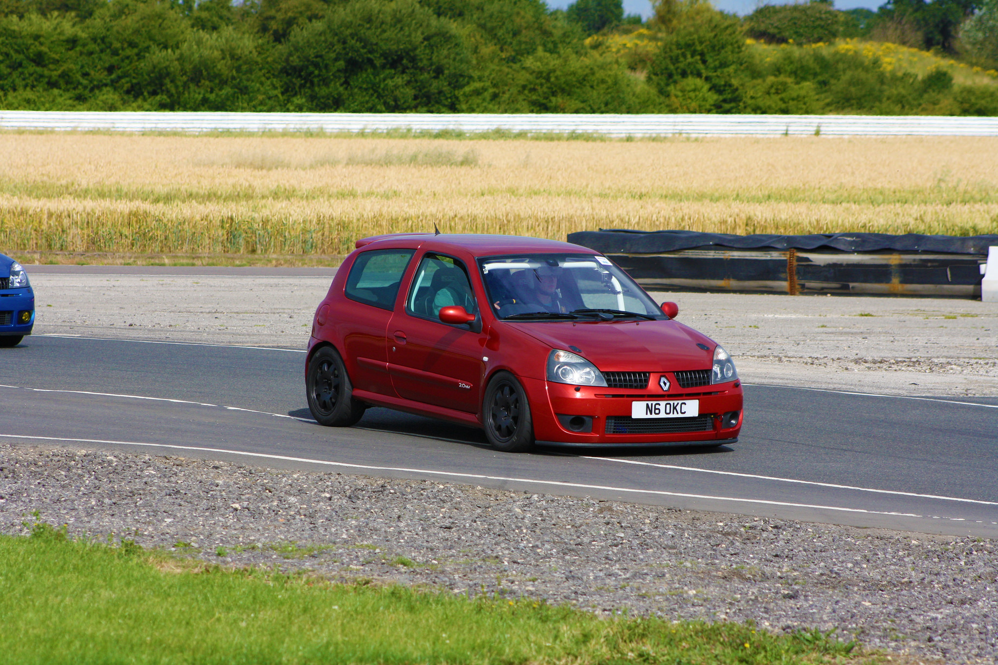

Car looks great Rich, what suspension are you running? Any rubbing?

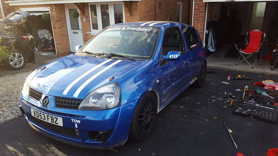

Cheers mate, no rubbing although but I run Gaz GHA full coilover all round 650lb rear springs and 500lb front so there's very little movement I just use it as a Hillclimb car so doesn't see alot of road use (I don't think my spine could take it for very long now, I used to drive it to and from events but I have a motorhome and trailer now)
The first photo is the most resent that was after an event at Loton Park, as you can see it gained another 1.5 neg camber on the rear from the last two photos, from the aid of some shims.

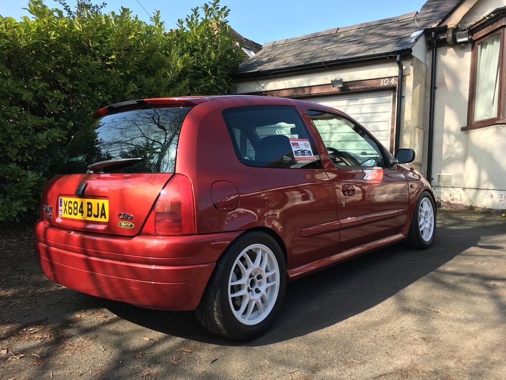

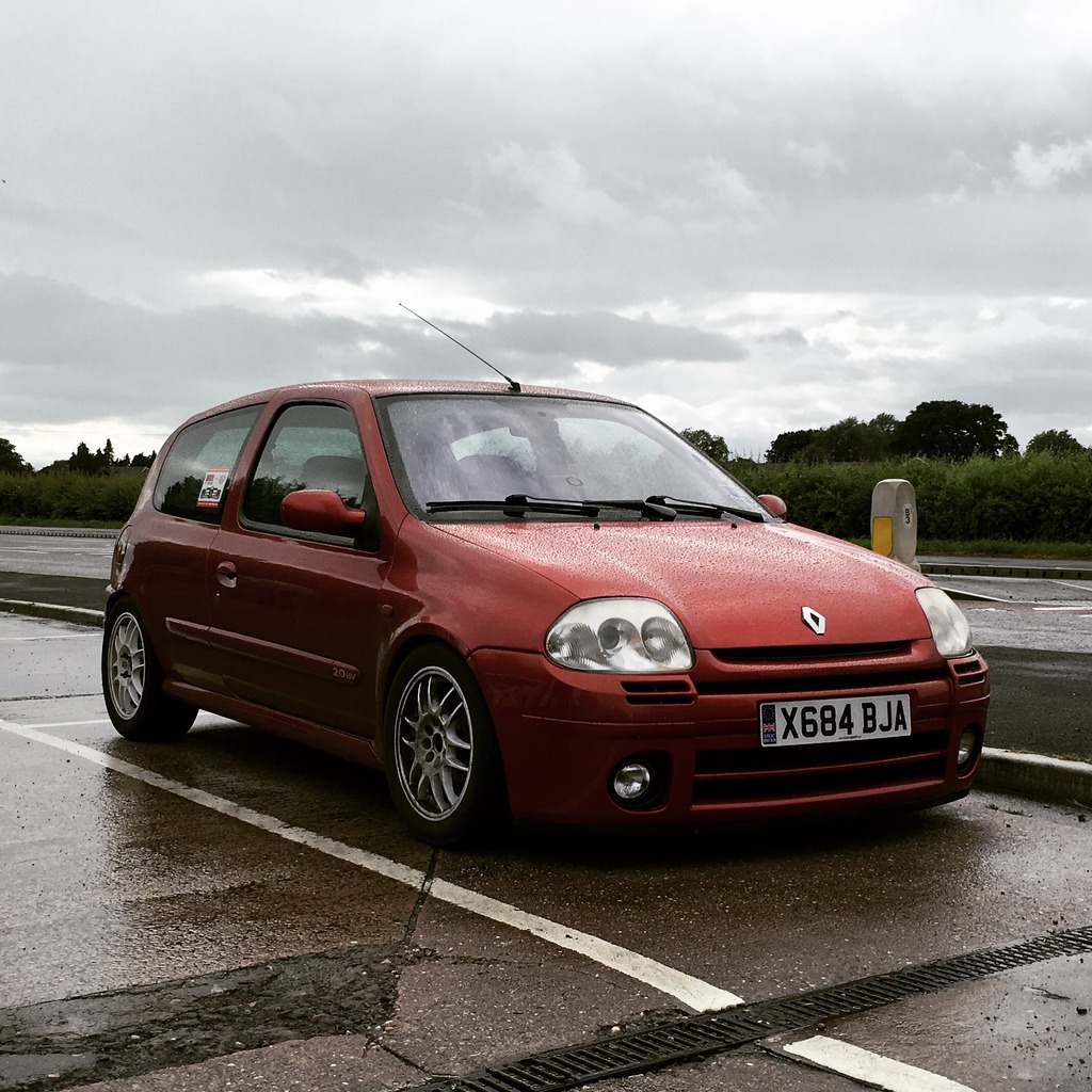

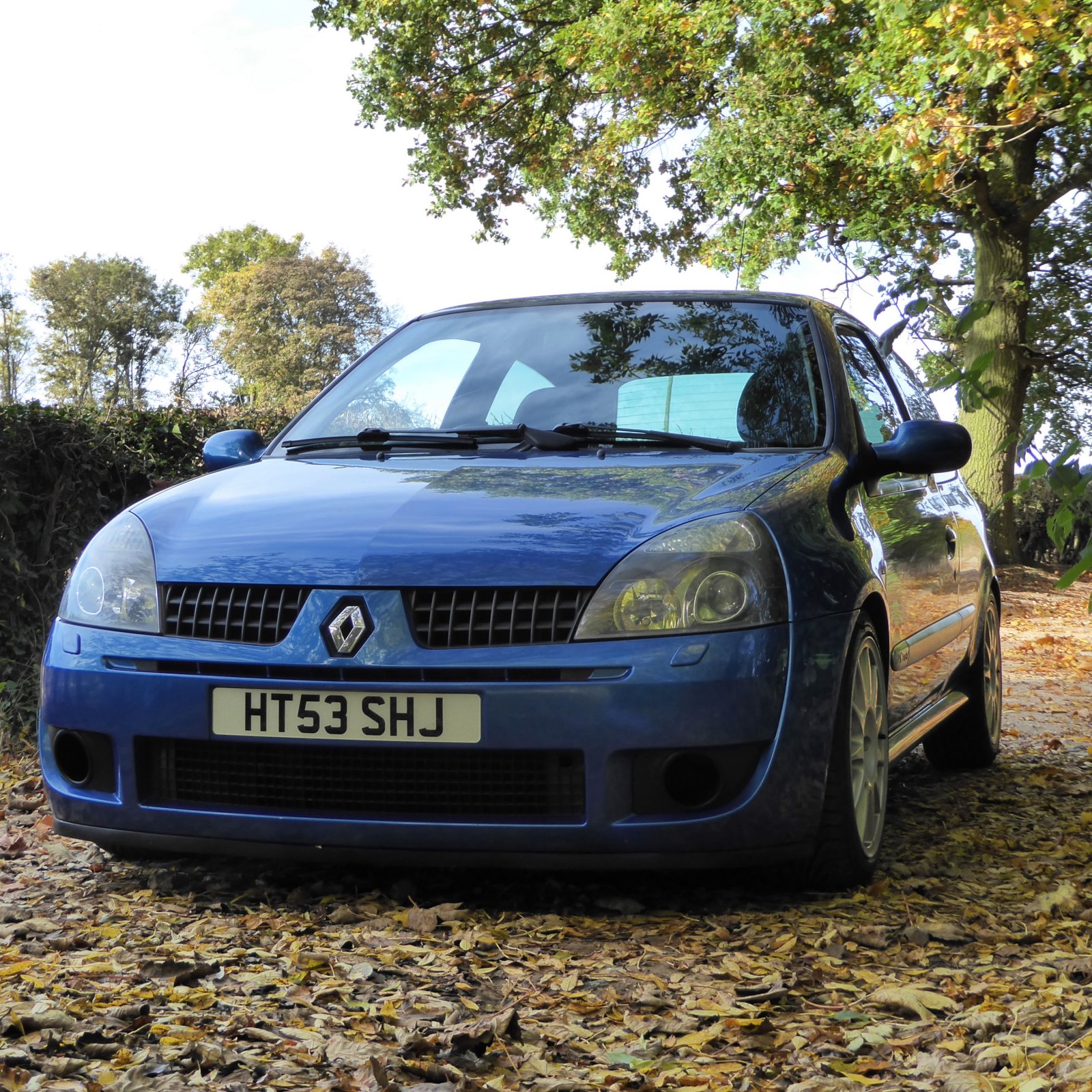

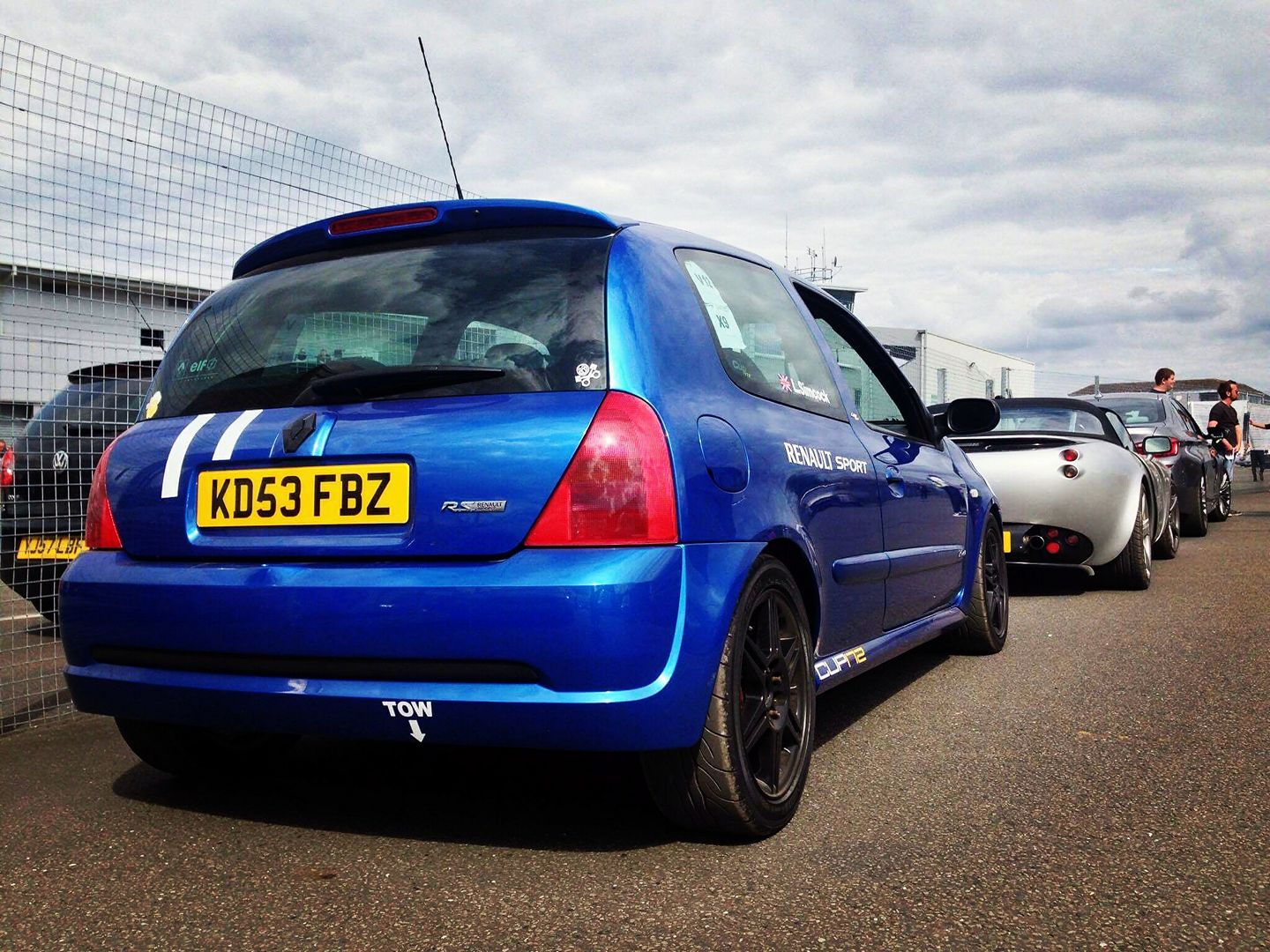

On mine I run a 20mm spacer on the front (although not currently because I snapped the bolts on one of them as they were bolt to hub) and a 10mm stub axle spacer on the back. 1st pic is with the front spacers but no rear spacers.

  Clio 172

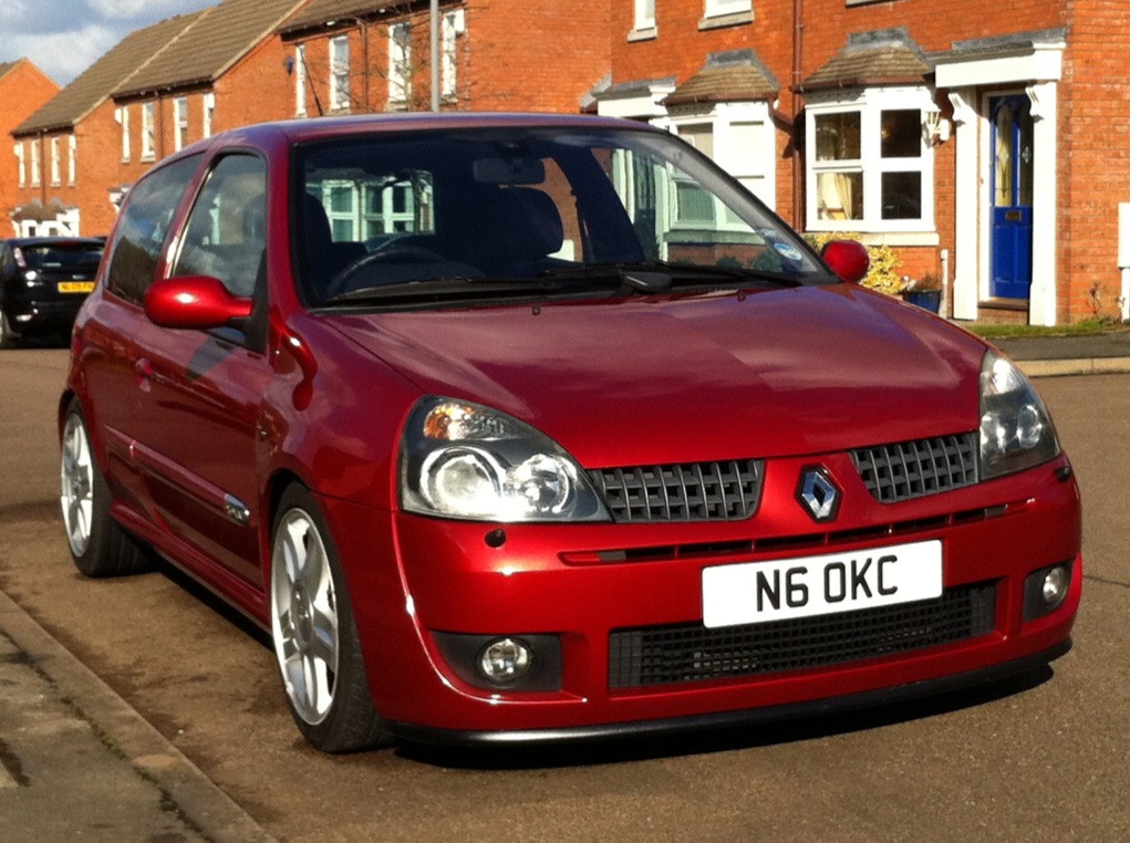

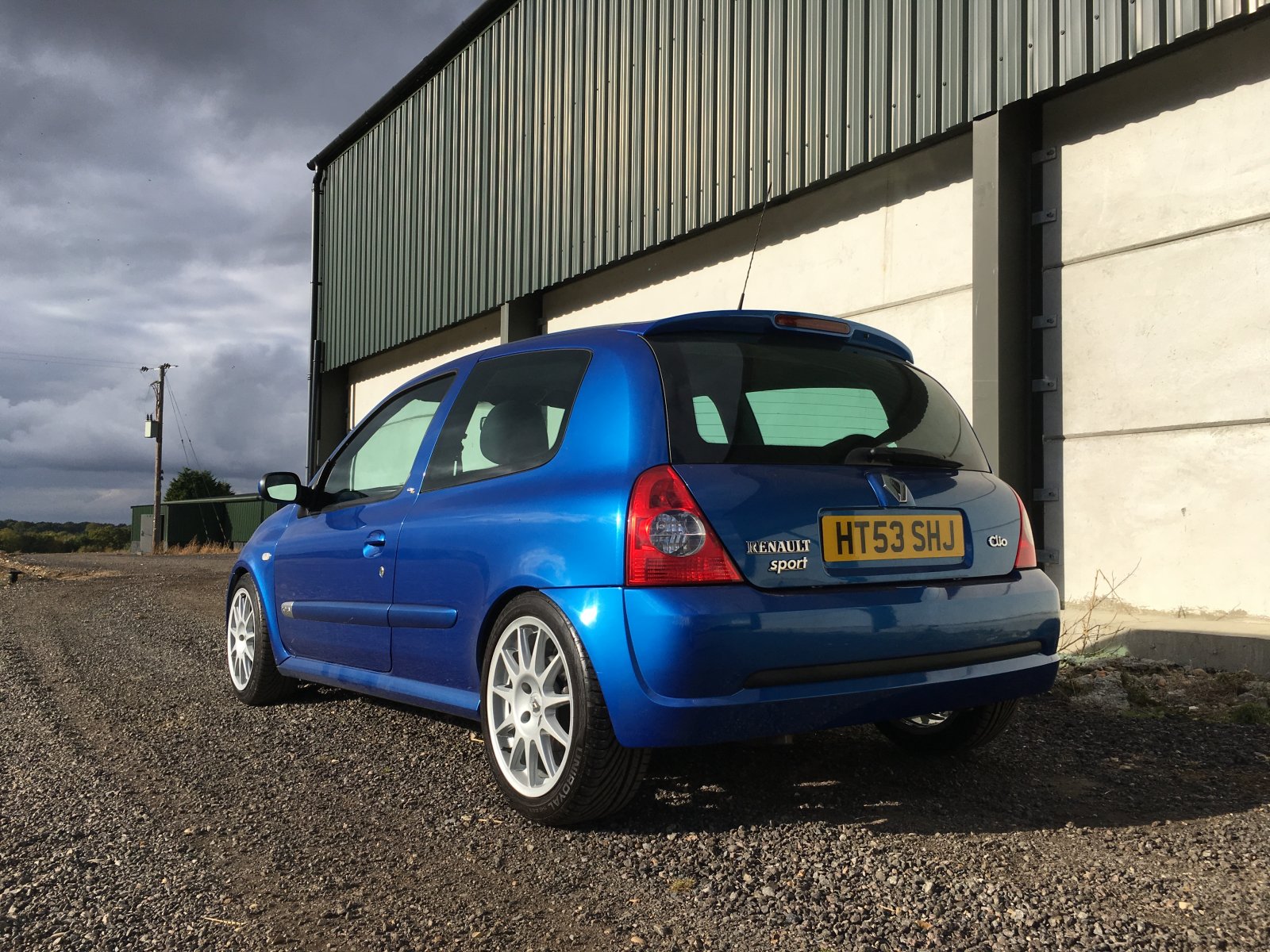

These were all on 16mm at the front, 10 mm on the back.
This is on 16mm at the front, 5 mm on the back and it is worth noting they have @NorthloopCup Rollcentre kit which also increases the track width iirc.
Hmm, that looks great. Handle okay on that? What ET are the wheels?
