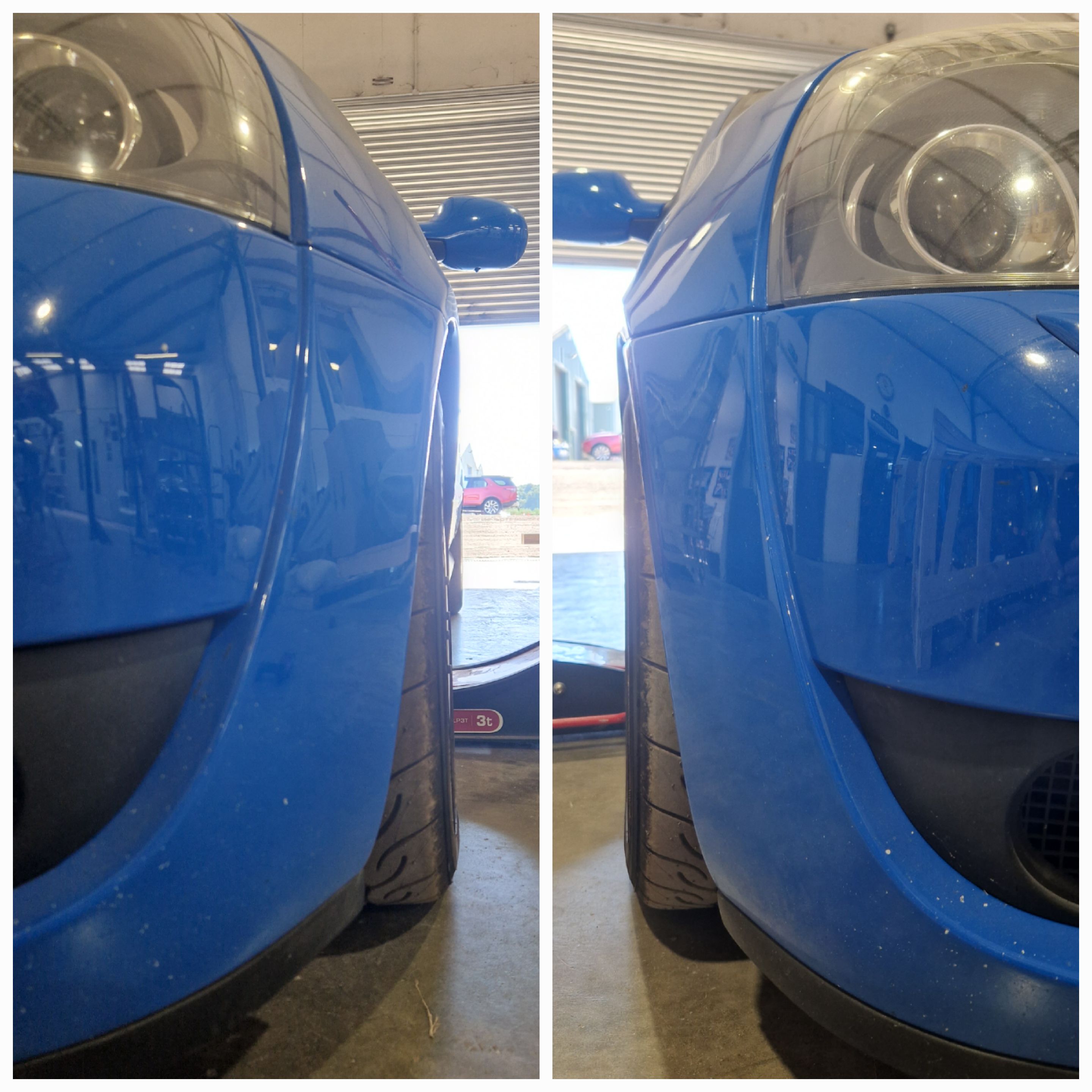

This is ET35 with 15mm on the front and 5mm on the rear lowered on B14’s with 1.28/1.29 degree of camber on the front.
Can’t remember what make of spacers the 15mm are but they’re hubcentric and the 5mm on the back are axel ones.
I did have 20mm on the front and 10mm on the back but it scraped like a b*****d 😂
I’m thinking maybe 10’s upfront?. I can’t imagine the 18s are doing the handling any favours 🥴

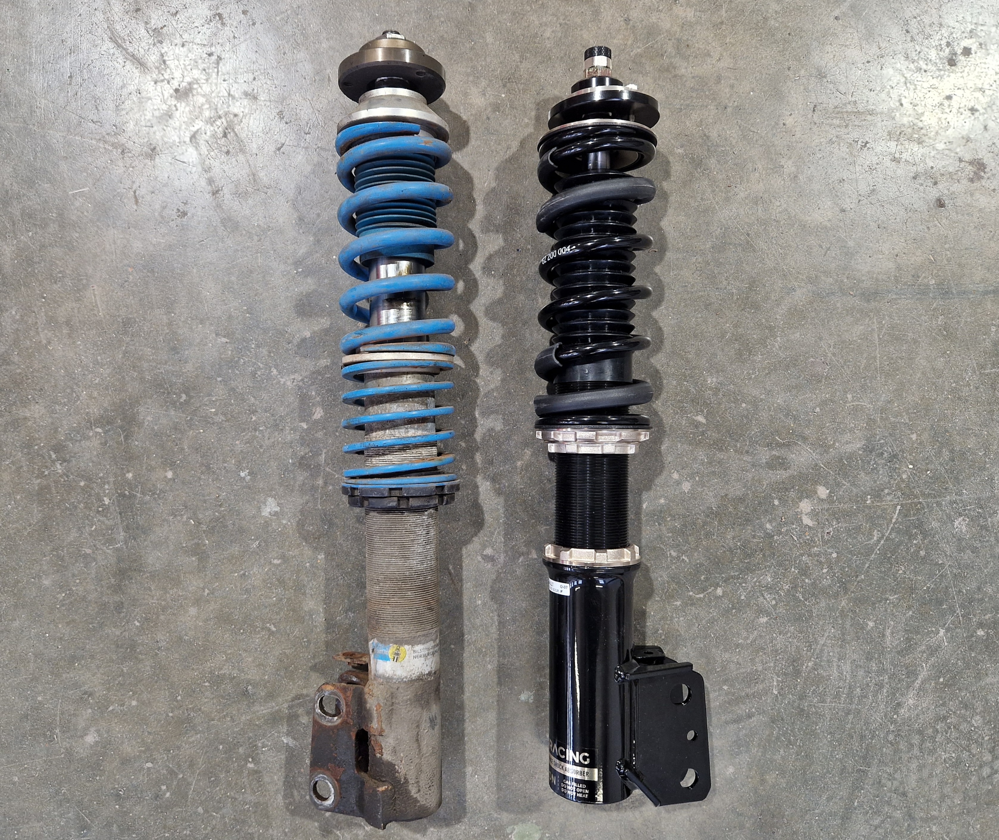

@leeds2592 I will say I had 16mm front spacers on et38 2118s and it sat fine, but when I swapped to BCs, the same wheel and spacer setup was too wide. I think this was due to the bolt spacing on the BCs being further away or closer (can't remember which) to the shock body so I think this plays a part too.
Edit, found pics. You can see the BCs have a wider mounting flange than the shorter Bilsteins so this is what I think pushed the wheels out further.
(Bilsteins on left, BCs on right)
View attachment 1677072View attachment 1677073
different camber adjustment between left and right photo. I guess the advantage is that the wheel runs a bit further away from the BC strut, but if you run spacers that doesn't matter actually as there's no chance of rubbing
