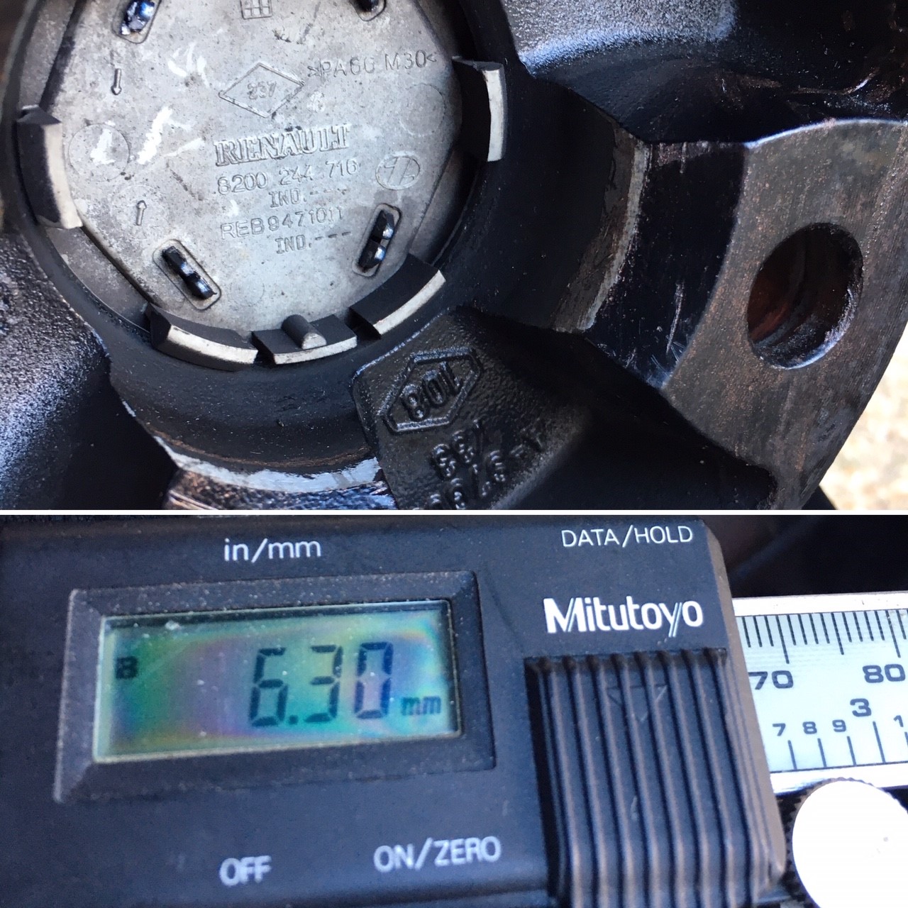

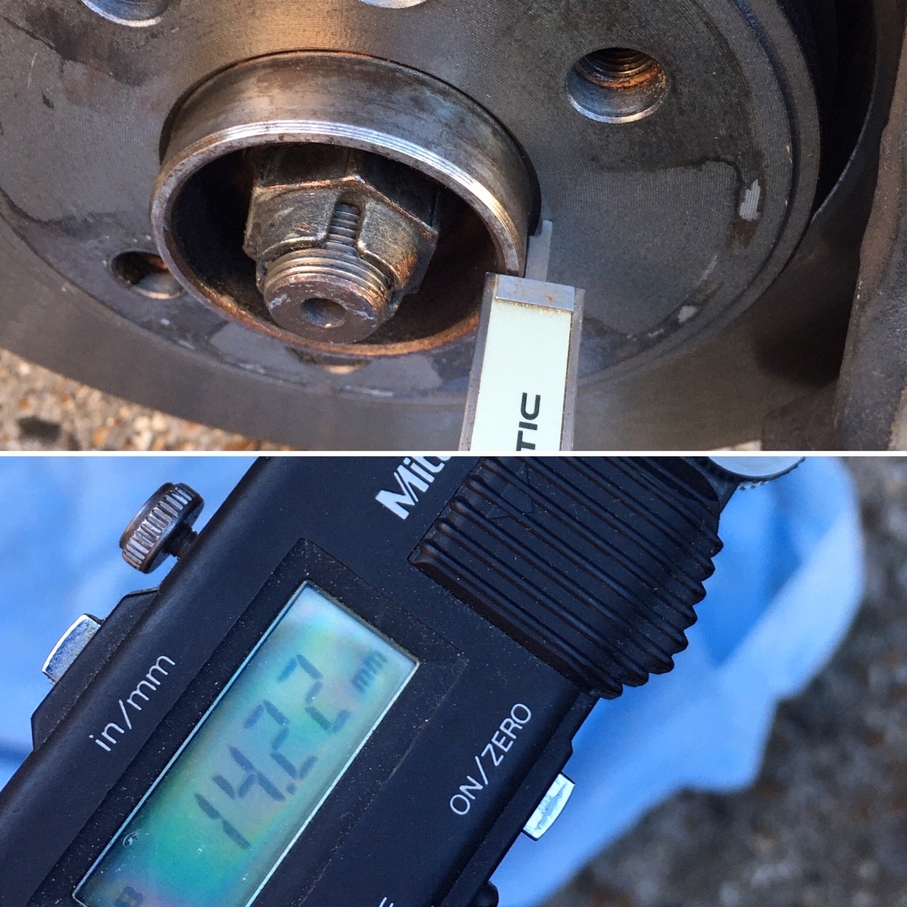

Just to add some info i measured on my 2005 Cup chassis 182.
Standard hub protrusion 14.2mm
Speedline Turini 16" (Cup fitment ET38.5mm)
Speedline 2118 15" (ET43)

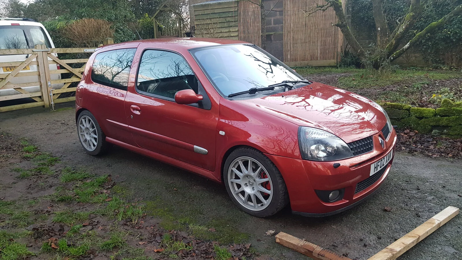

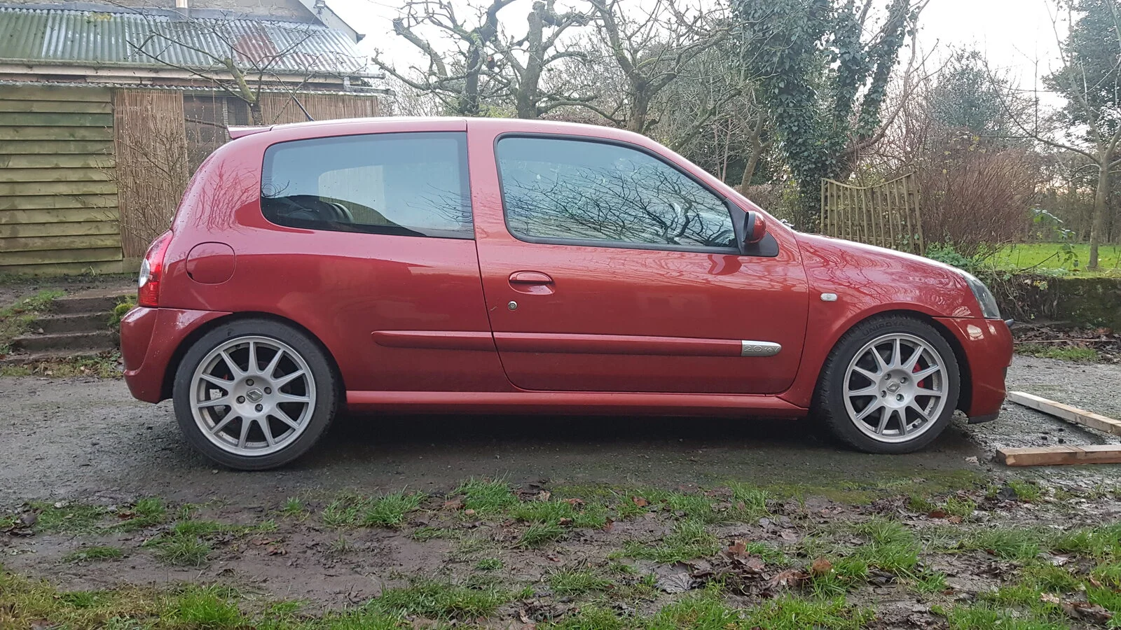

Cup offset Turinis on Cup shocks and Grams springs, 16mm hubcentric front, 10mm PMS stub axle spacers.
