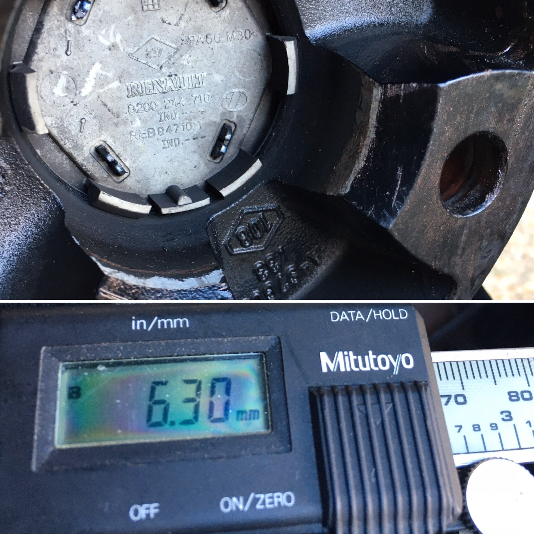

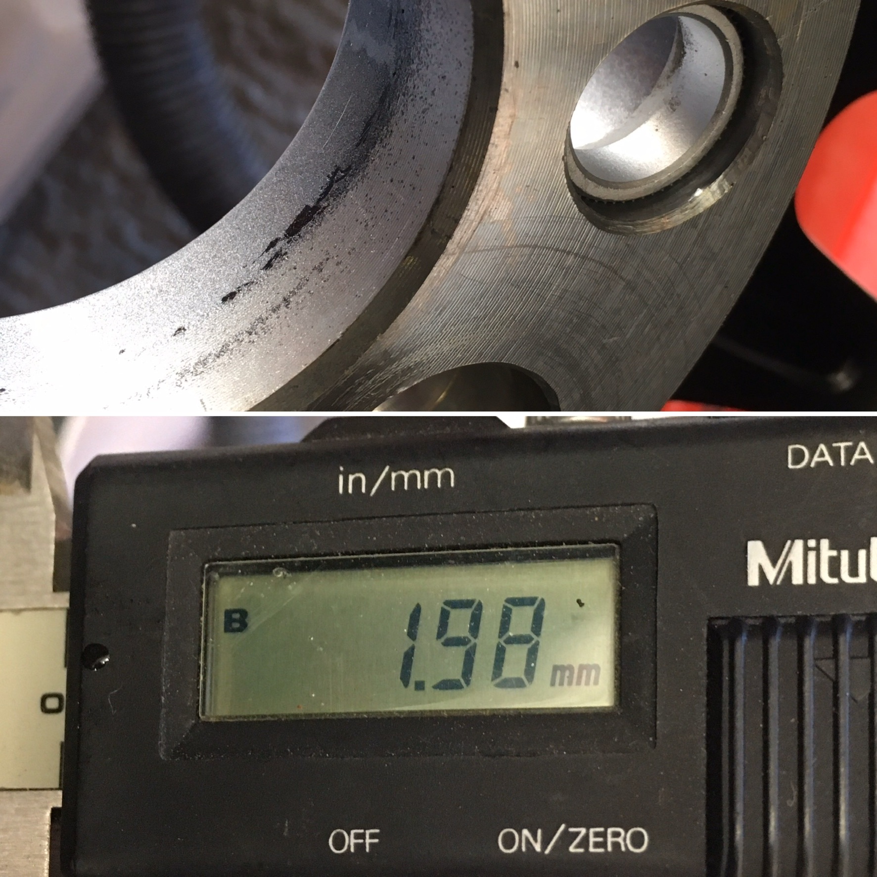

No you cannot safely use a 10mm slip on with a Turini. The Turini has a 6mm chamfer on the rear bore which means there isnt enough material left on the hub to safely centre the wheel.
HaveaCuppa
I did think this was the case. Cheers for confirming (y)
5mm slip on spacers for the front will do for now then.

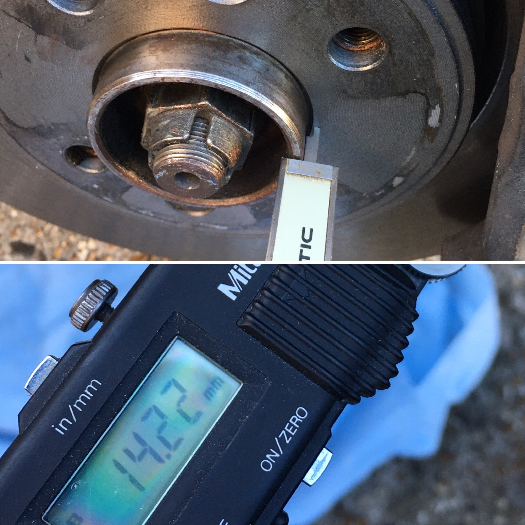

frayz
6mm chamfer on Turinis
2mm chamfer on 2118s
14mm hub protrusion on cup hubs.

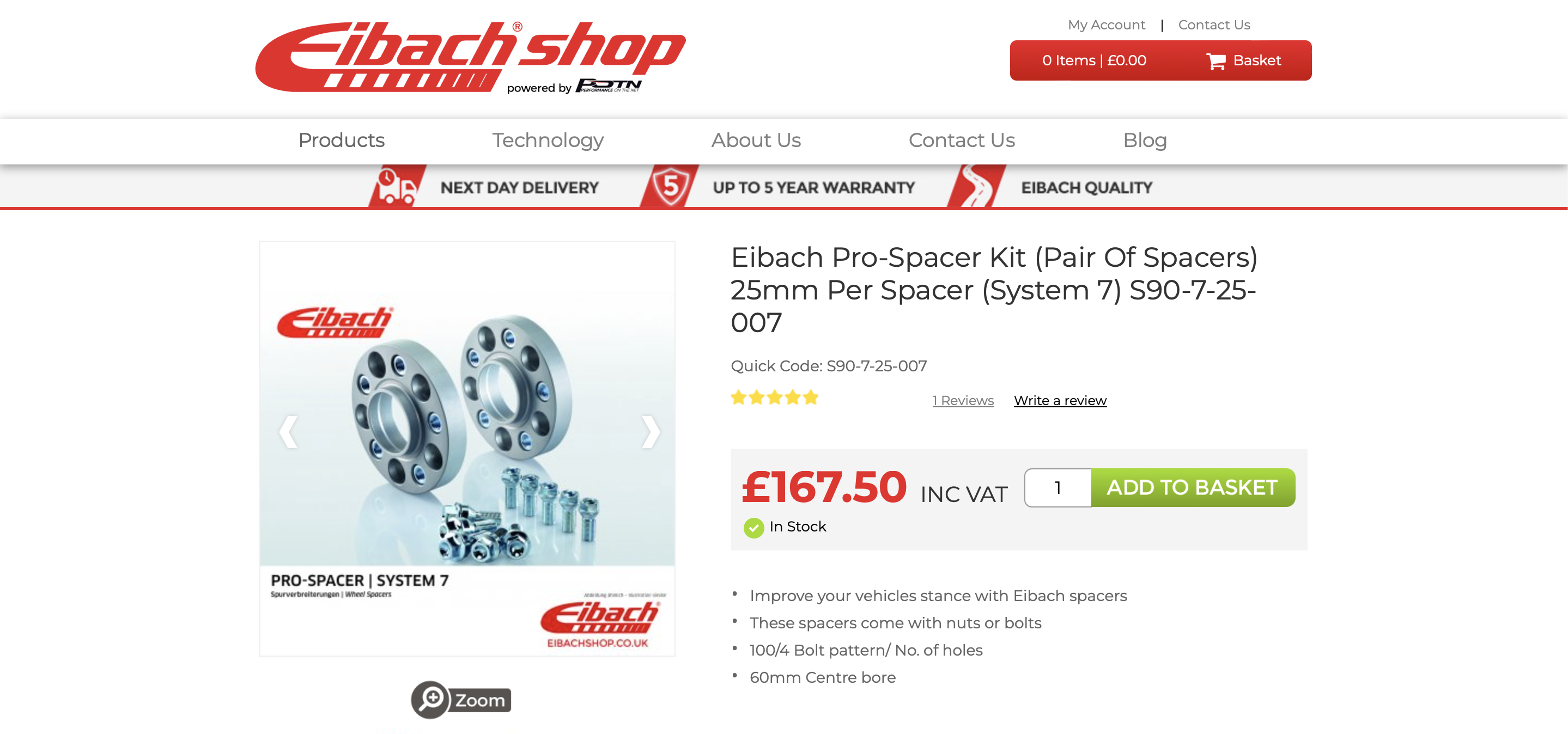

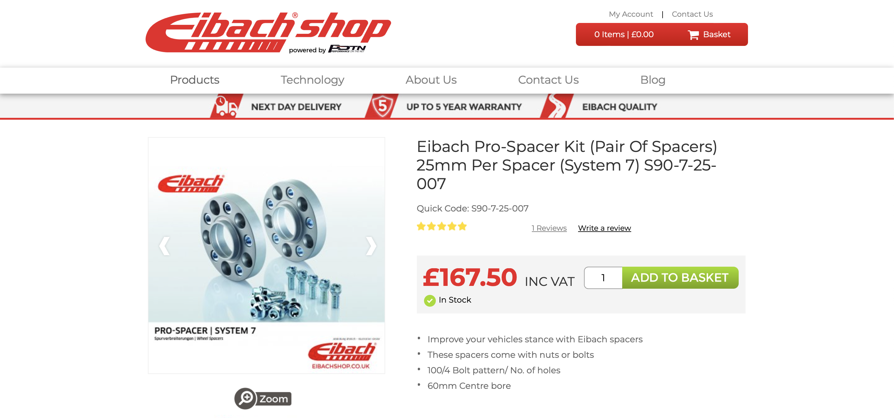

Has anyone ever fitted these to there car.
I don't fancy running longer wheel bolts but would like to run some spacers on the front.
Thoughts ?
Kiffle
Thoughts ?
I decided to run a stud and nut kit and just use normal spacers. Running 100mm front studs with 30mm spacers at the moment.
I'd be too worried about the inner bolts holding the spacer to the hub coming loose running the above style.

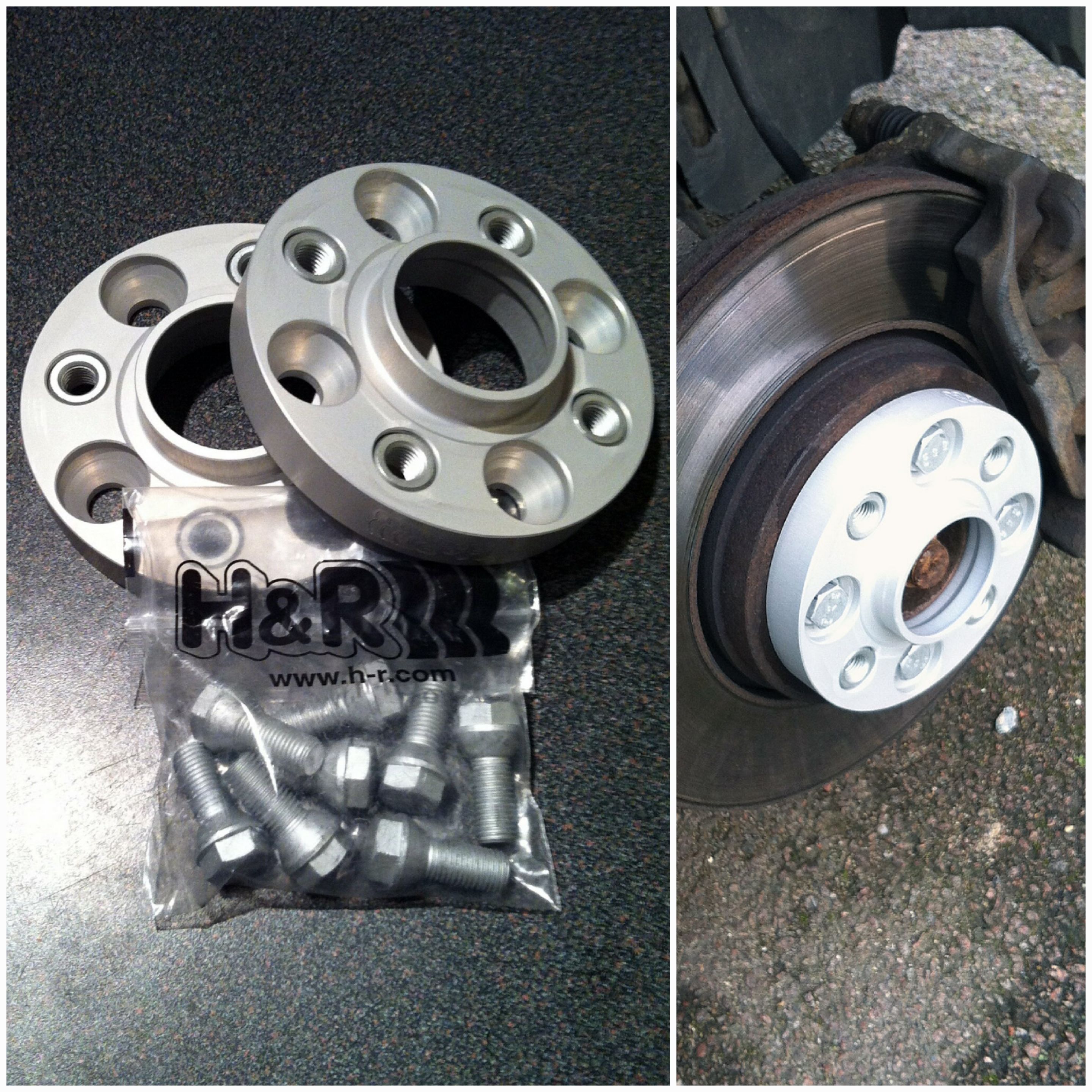

Jekyll
Thoughts ?
Not these ones, but I did have H&R ones which were the exact same for the same reasons, keeping the standard bolts. I had 20mm ones, but still the same design, with the insert.
Never had an issue throughout the time I had them.

Jekyll
@Jekyll
You got a link / Part number for the H&R Ones ?
Did you use some lock tight ?
These are for the trophy so its not like im tracking the car and driving like a loon.
It was a while back and that was from Larkspeed. It was the DRA ones.
It was these, but not sure if there's cheaper places online.
