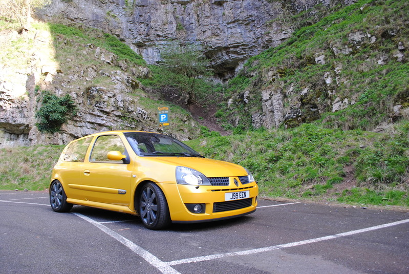

Any pics of 182s on standard wheels that are spaced out a bit?
This doesn't answer your question as such, but I have a non-sport with 195/40 r16s spaced out 25mm all round, lowered around 70mm on coilovers and it drives sweet without any rubbing and the wheels are all legal within the arches :)
For reference, my tyres catch on the rear arch lip with 15mm spacers and hard cornering.
Coilovers with 205/45s on standard rims.
I can either replace with 10mm spacers (but can't get hub-centric) or roll the arch lips.
Fronts are 15mm too and they're fine. They do catch on full lock but then they did without the spacers on too.

I had 5mm on my 182 and that was quite low on coilovers and standard wheels and they scrubbed if I had weight in the back.. Swear every car is different. I'll try find a pic..
that was 5mm FK spacers on the rear.
