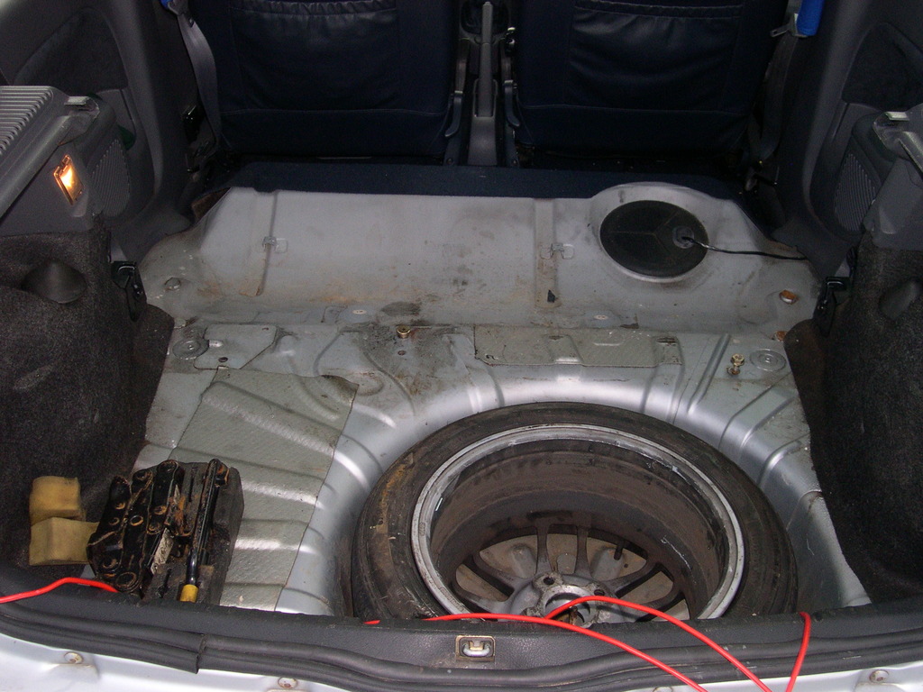

Just removed my rear seats on my Phase 1 172, , and realise that the spare full size wheel isnt secured
There is a 4 inch bolt rising upwards centrally with a thread - anyone know what the thread size is so i can get a nut to fit?
Also- how do spares get secured? (Phot helpful)
I have a polysyrene holder with a jack, brace and tow eye on, but that sits underneath the wheel at the mo, but no nut or anything to hold the wheel down
Anyone tell me how OEM the wheel is held in place- or shall i fabricate some flat steel to hold it there for daily driving use?

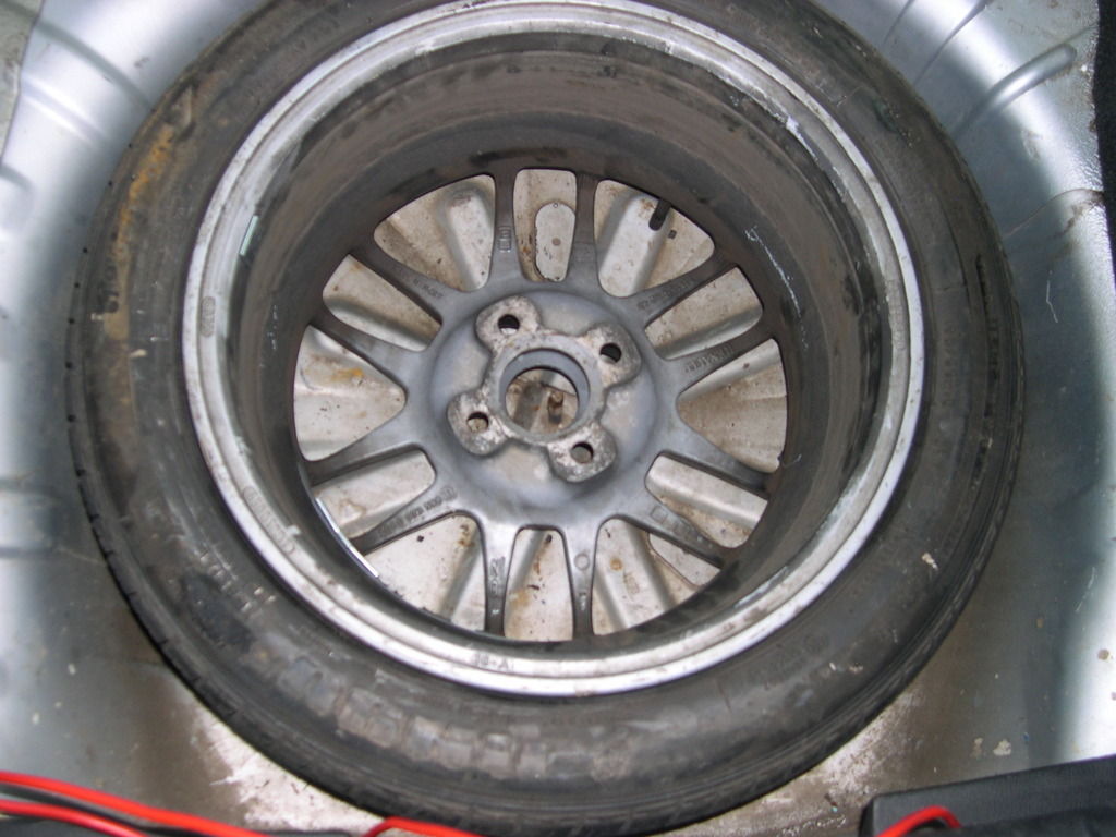

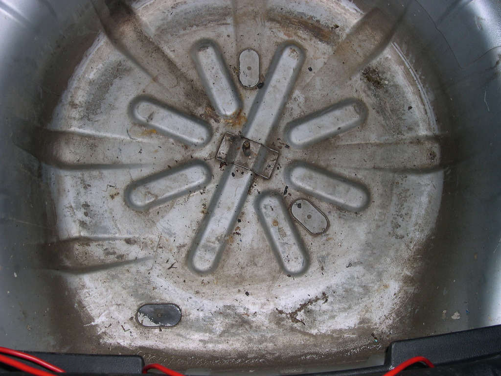

Pic above is empty wheel space with threaded spindle central

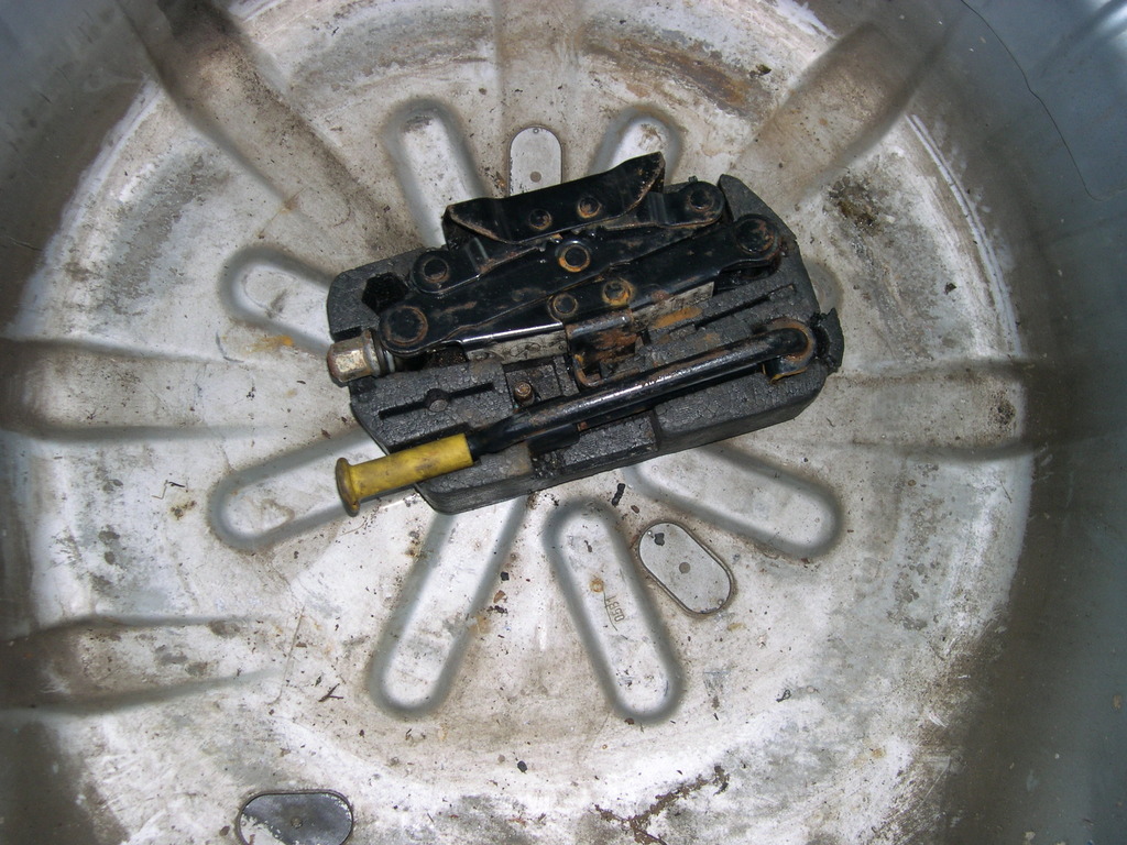

Pic above is empty wheel space with jack, tow eye, and brace polystyrene thingy with hole that goes over spindle

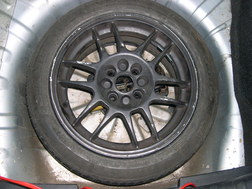

Pic above is wheel face up with kit underneath
Pic above is wheel face down- assume this is where you put that plastic round thing

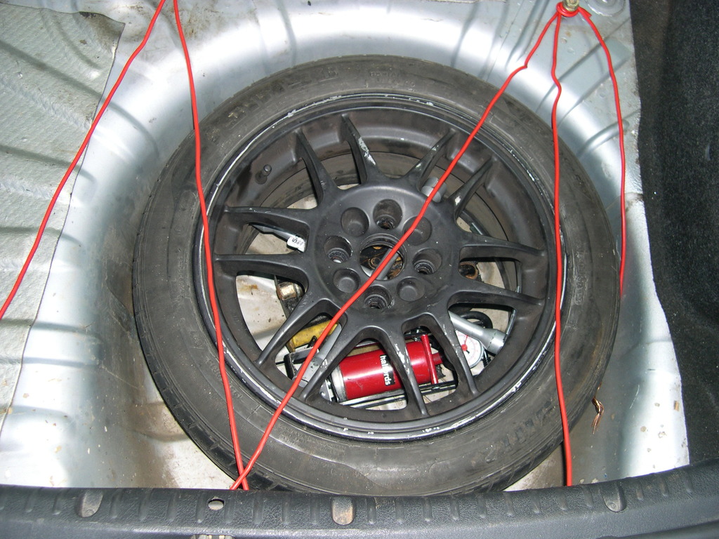

Pic above is a reaaaaaaally temporary thing
Pic above is wheel face down with jack thingy to the left

Looks like flat iron secured straight across to hold it in place, unless the twisty centrak thingy will hold a full sized wheel?
