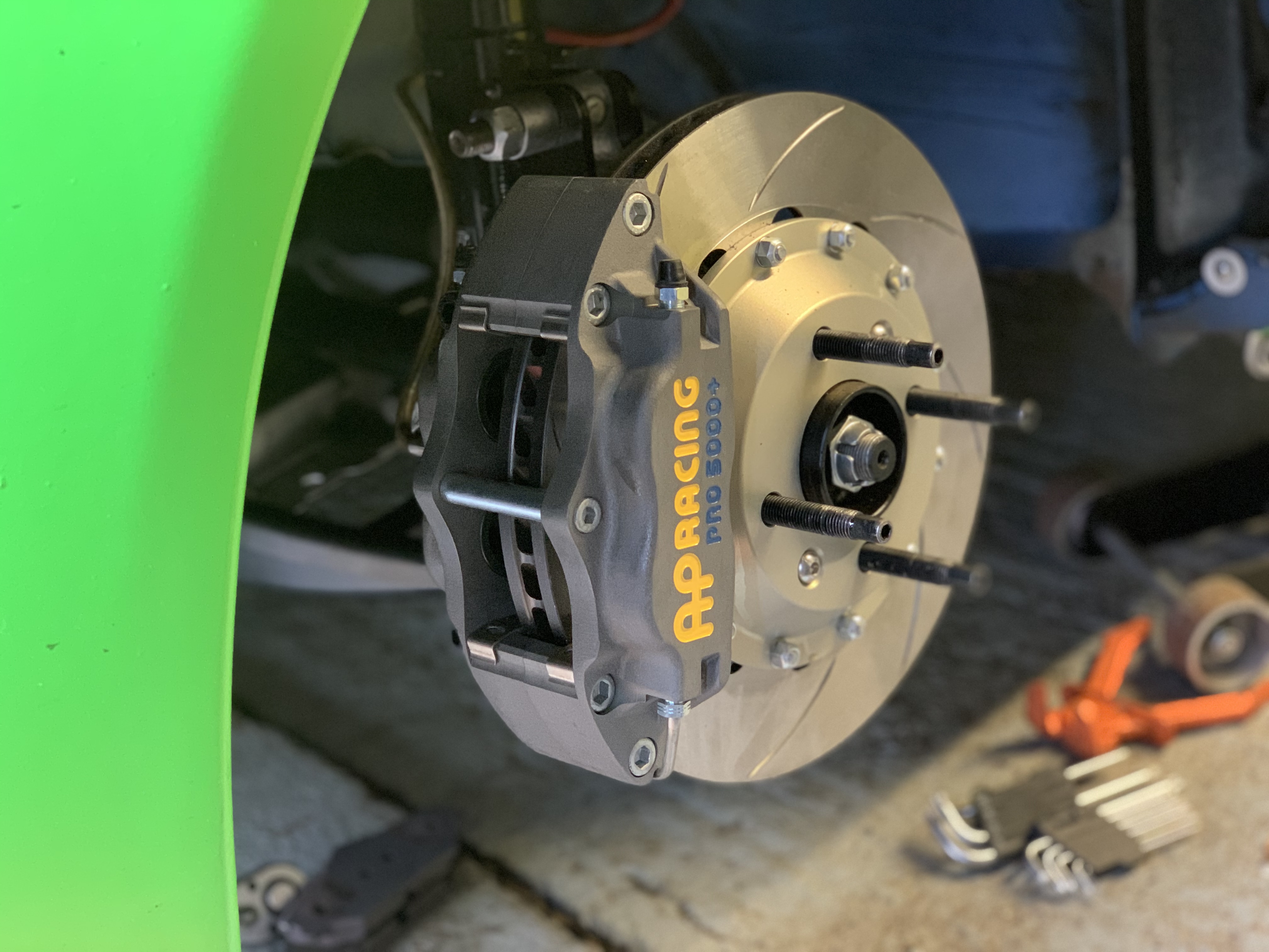

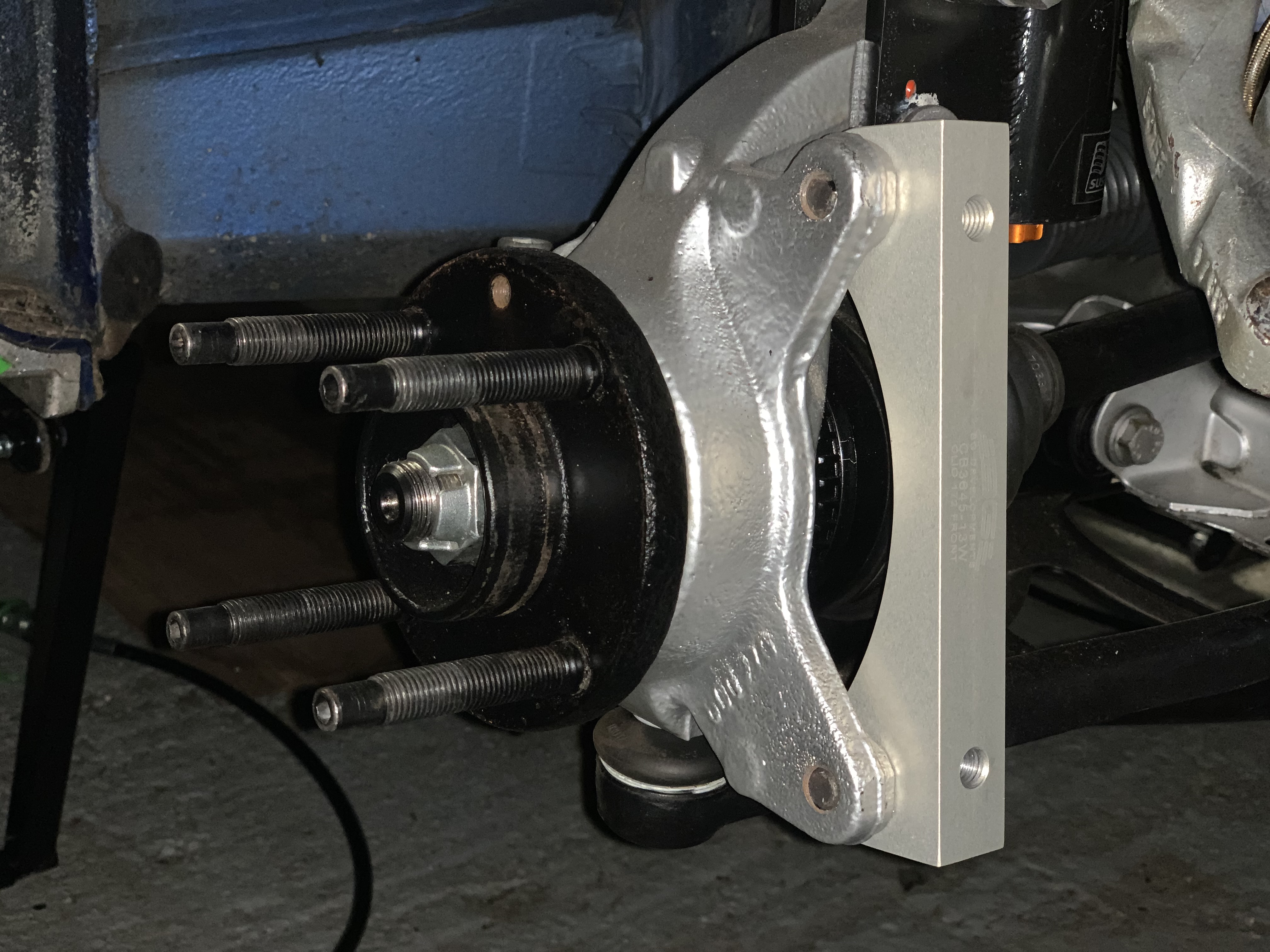

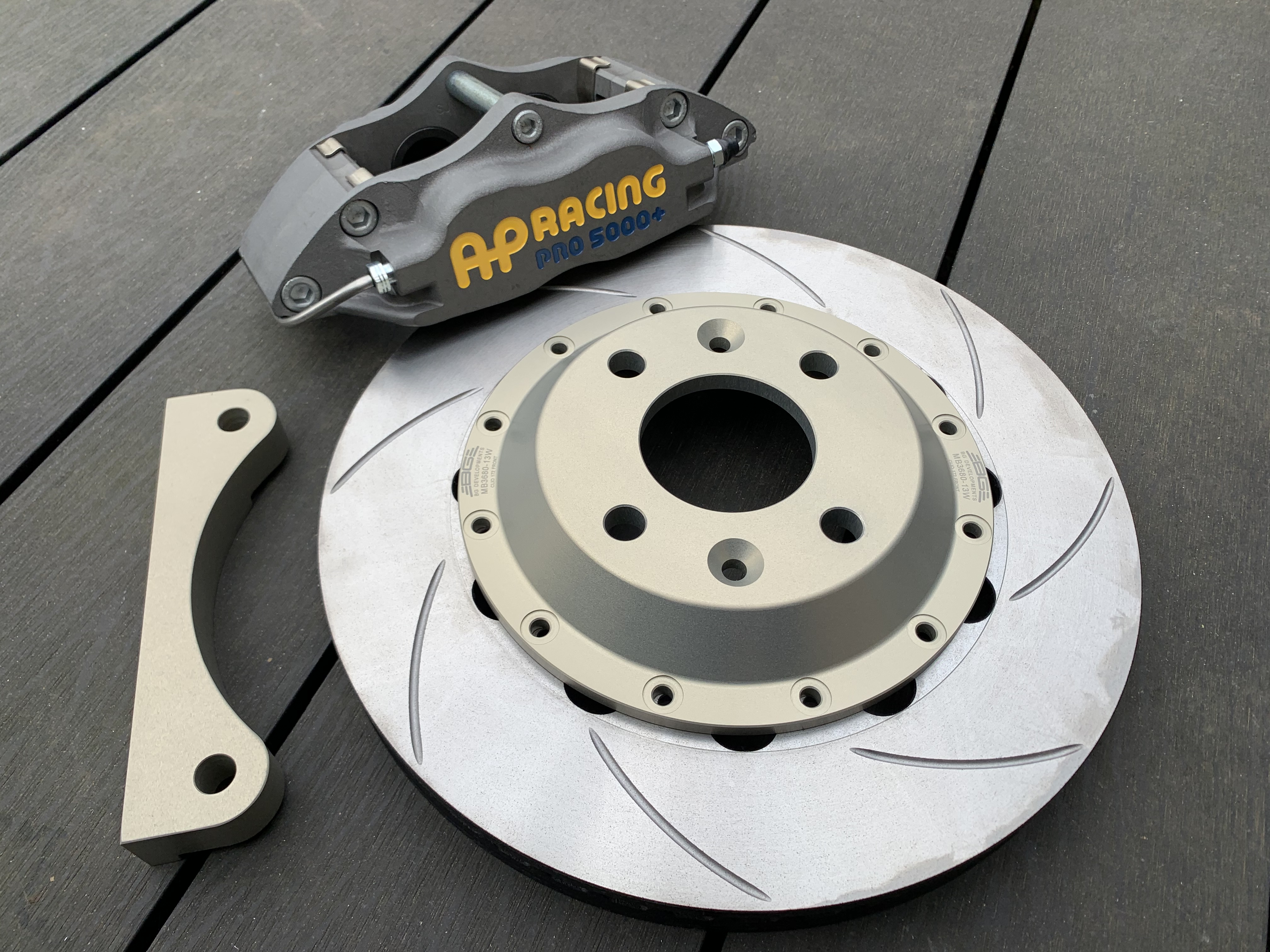

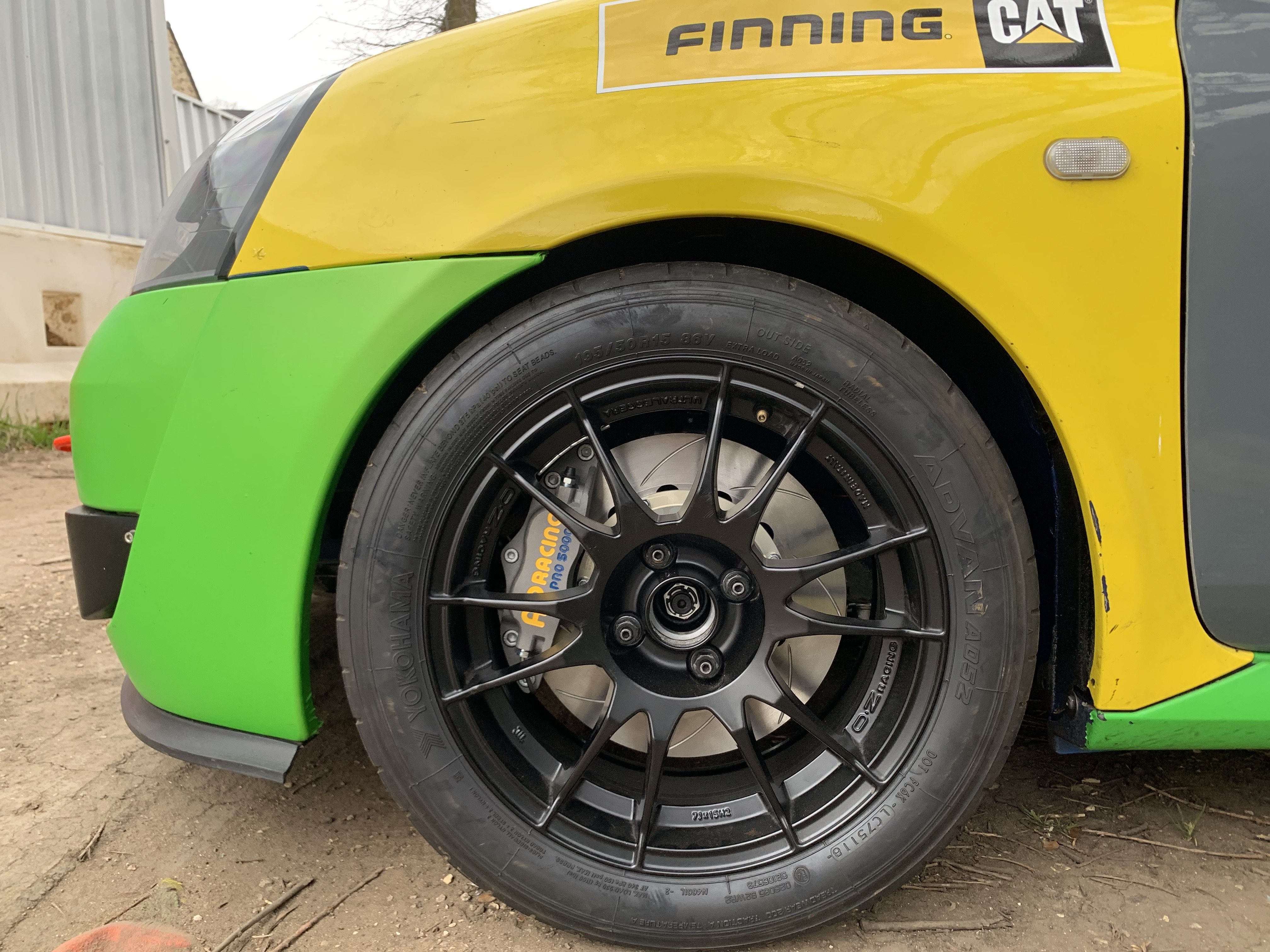

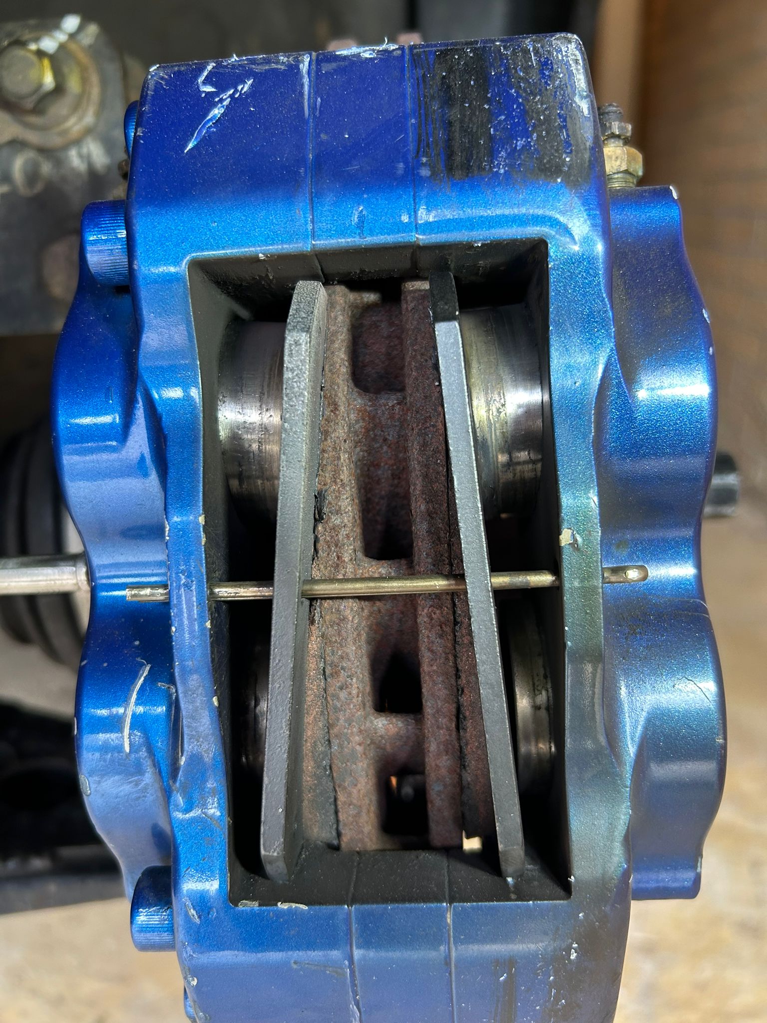

BG developments will make you a kit with a 295mm bell and rotor with AP calipers. I have the template for them I could email you
Must be due an update by now? I’ve just placed an order for some doors so keen to see how you got on with fitting of the other side with regards to hinges and then how good the windows are and if you did trim the aperture back?

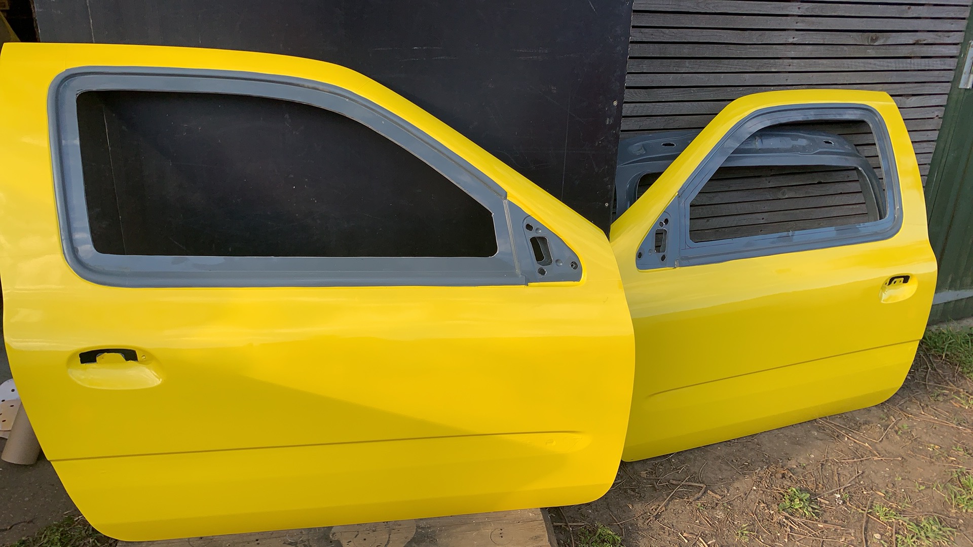

Yes, update overdue! The other door went on fine with a set of hinges I found on EBay and the brakes finally arrived last week. Windows not fitted yet as I'm about to mould the carbon roof which is priority before our first race at Thruxton 2nd May. Windscreen comes out next week and once all that's done there will be a big update, I promise!
Brakes thanks to BG Developments via @scotiamr2t
So Brakes are all on. 15" Ultraleggeras fit with room to spare over them which is a relief! Only hitch is the brake lines are not long enough so I've had to order a new set.

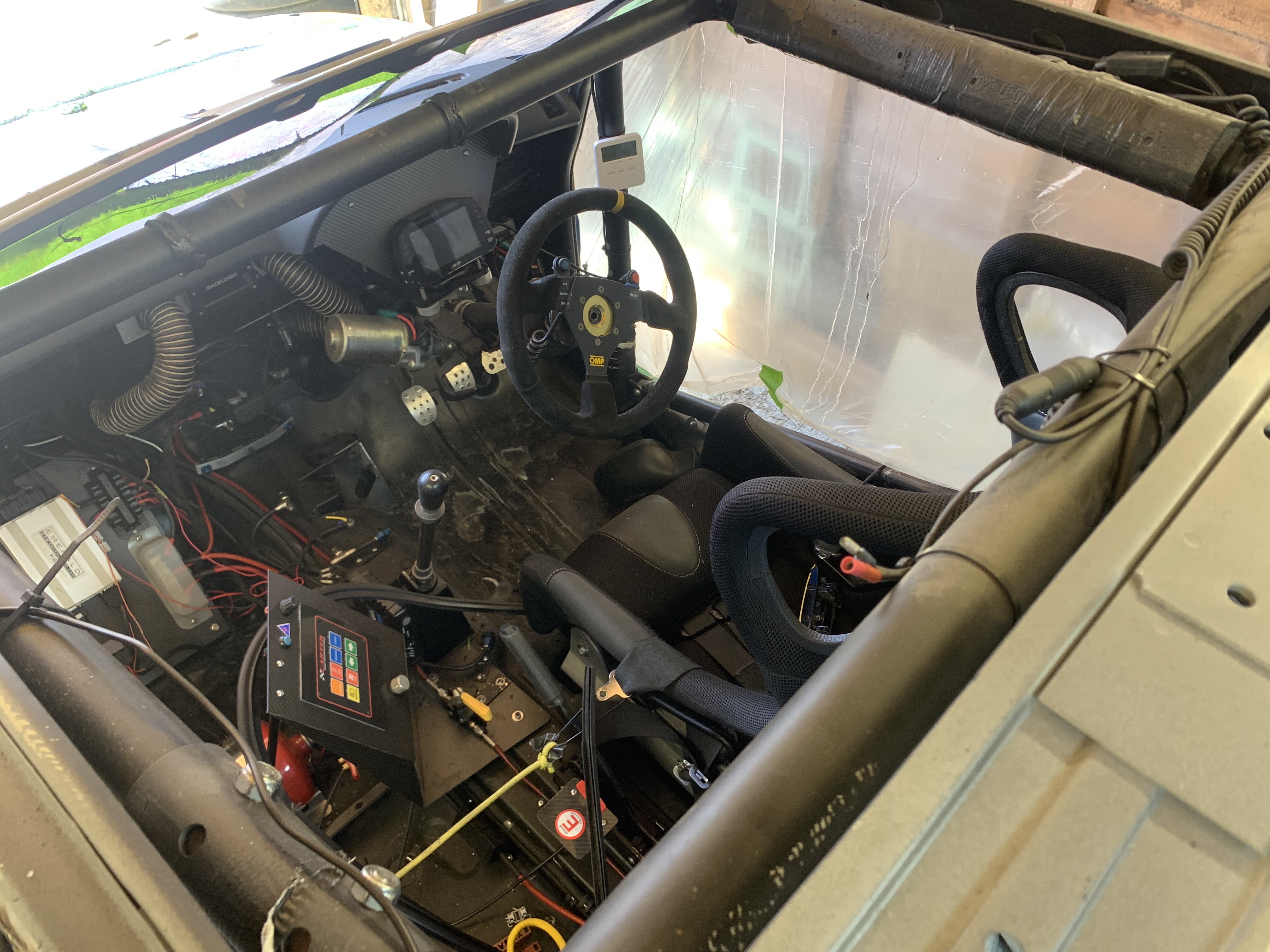

In other news, the screen is now out ready to mould the new roof and I've also had a chance to try out the new Quickjack which, frankly is a game changer. So much time saved and far better access.

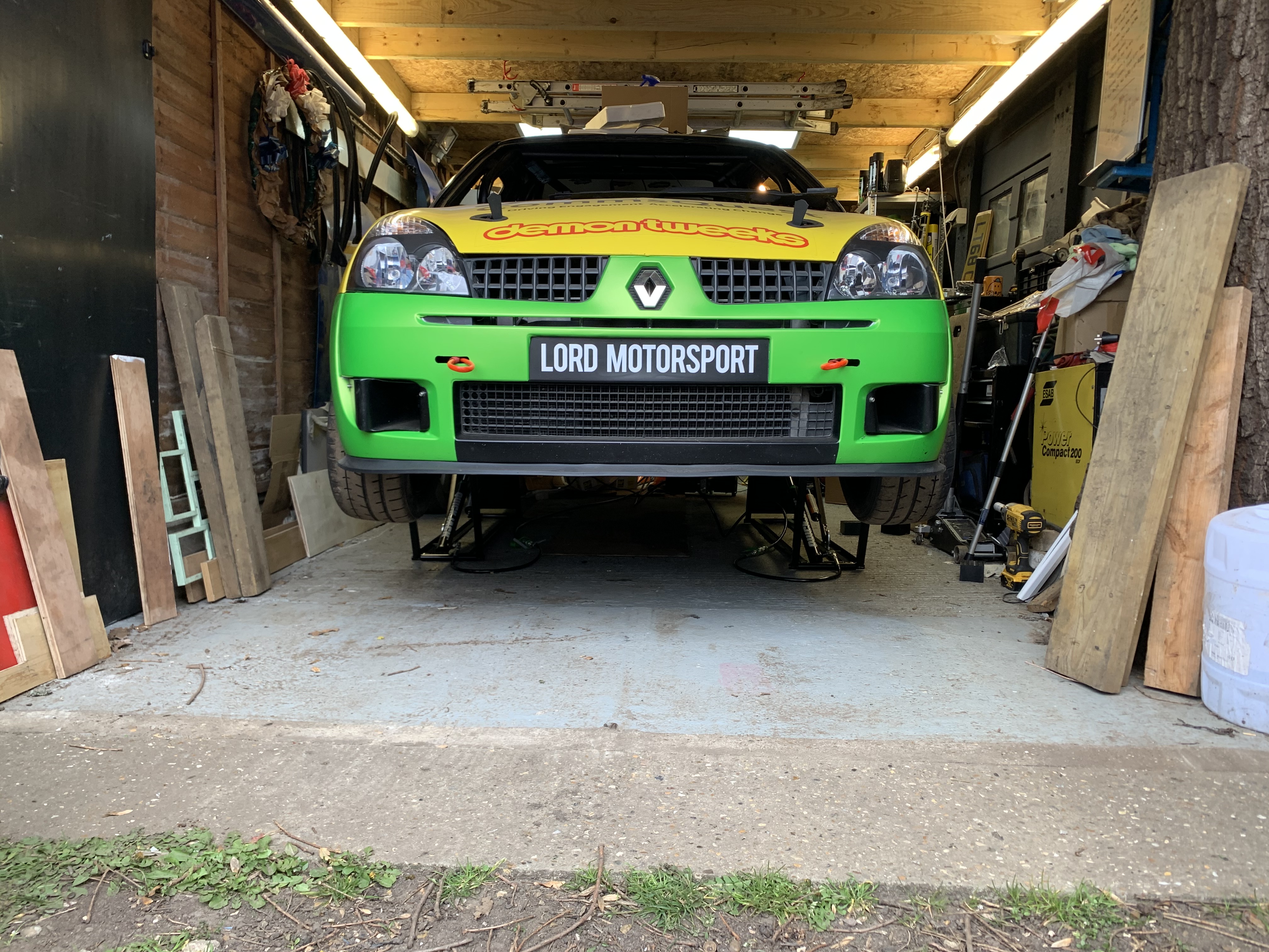

It's a solid piece of kit to be honest. It locks out at 2 heights and once locked there's no way it's going to come down and the car is rock solid on it. One reason for buying this was the ability of taking it to the track. I should just about be able to fit it in with all my gear.
Also, until I build a new "proper" garage/workshop I don't have the height for a 2 post lift (yet).

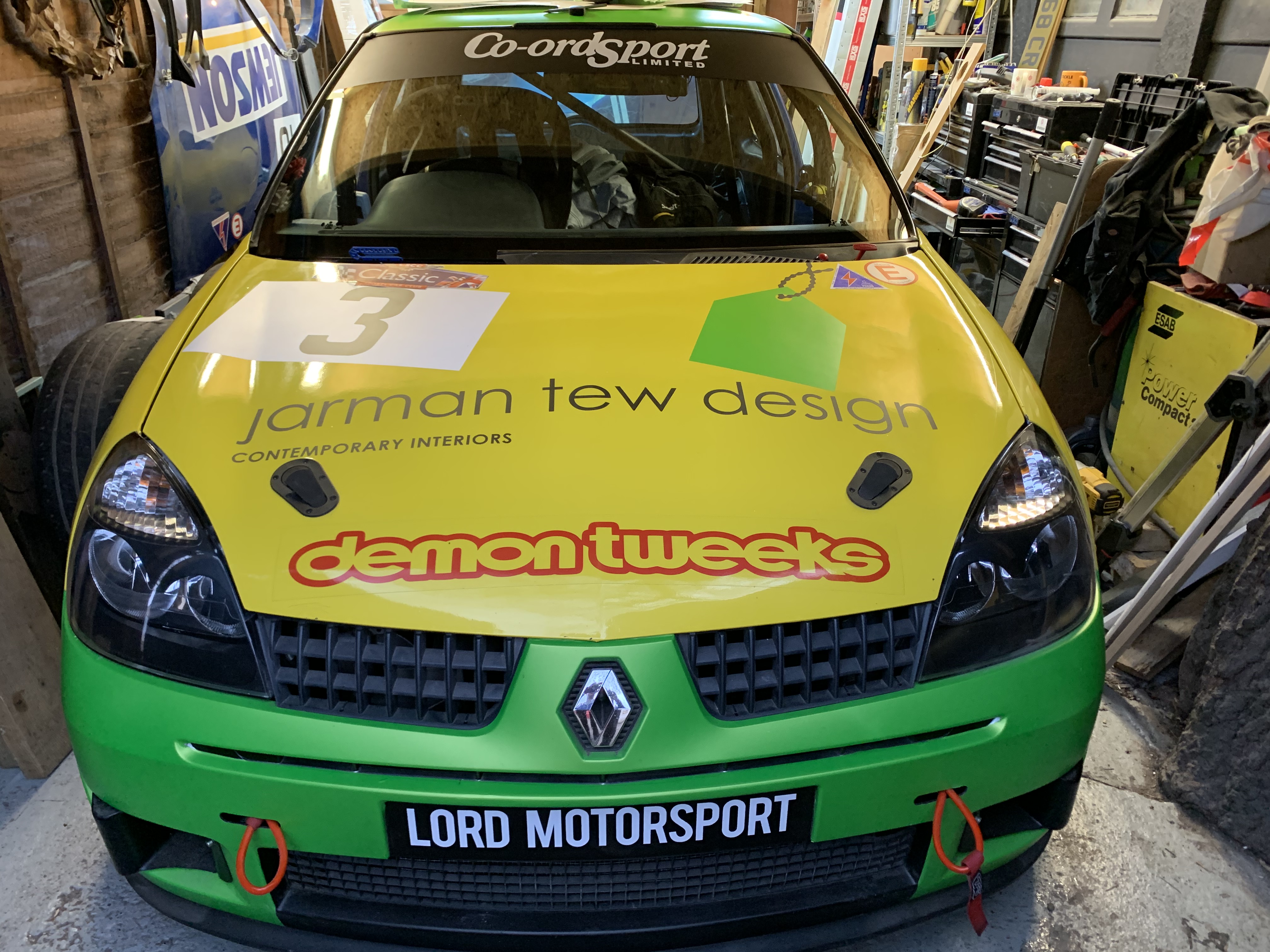

Last night I "de-sponsored" the car ready for my own company sponsor livery to go on. And today my new rods arrived from Pure Motorsport which, along with a new set of JE pistons that arrived from the States last week can now go off with the rest of my new bottom end to be dynamically balanced and assembled.

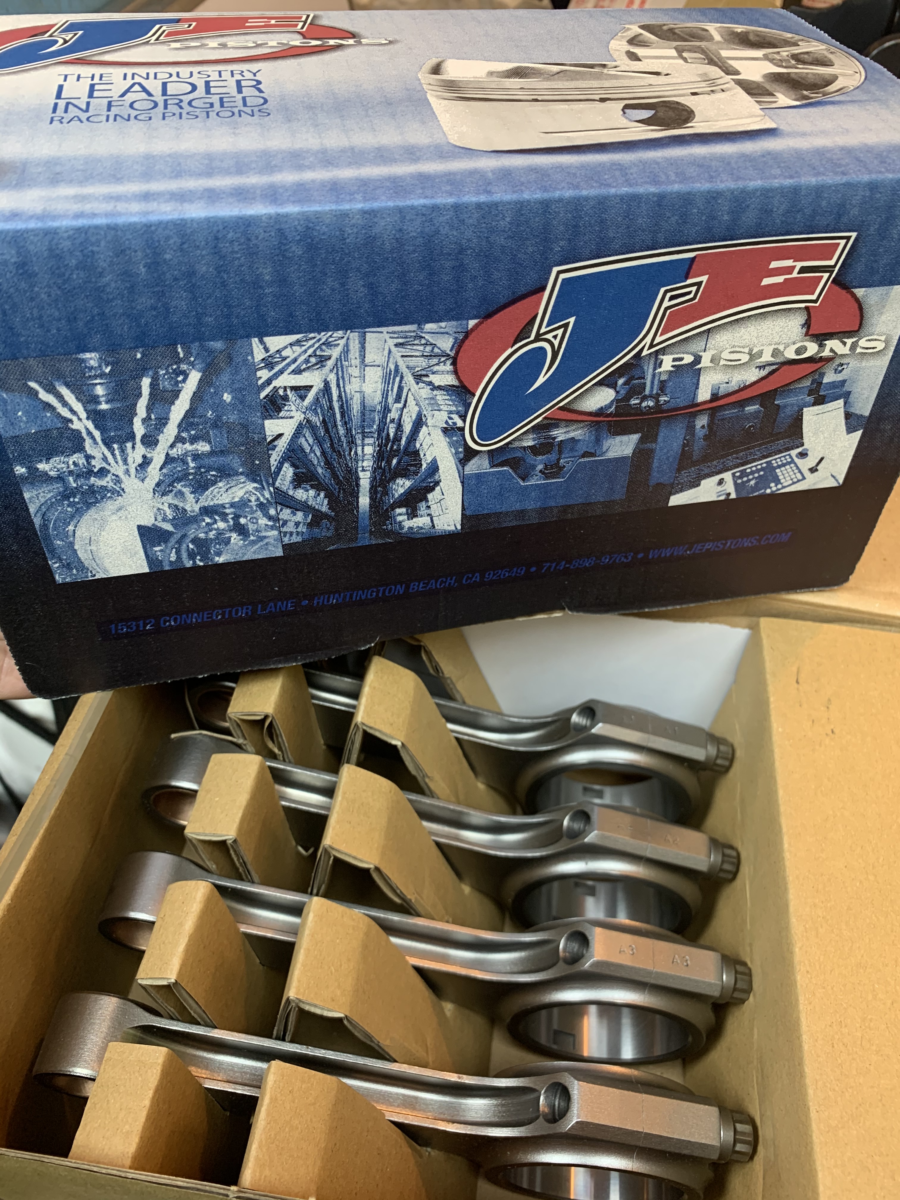

This second engine is being built to the same spec as my current one and will enable me to run them in rotation with zero down time while one is refreshed as well as having a spare engine ready should I have another catastrophic failure at any time. Let's hope it gets built before one of those occurs!

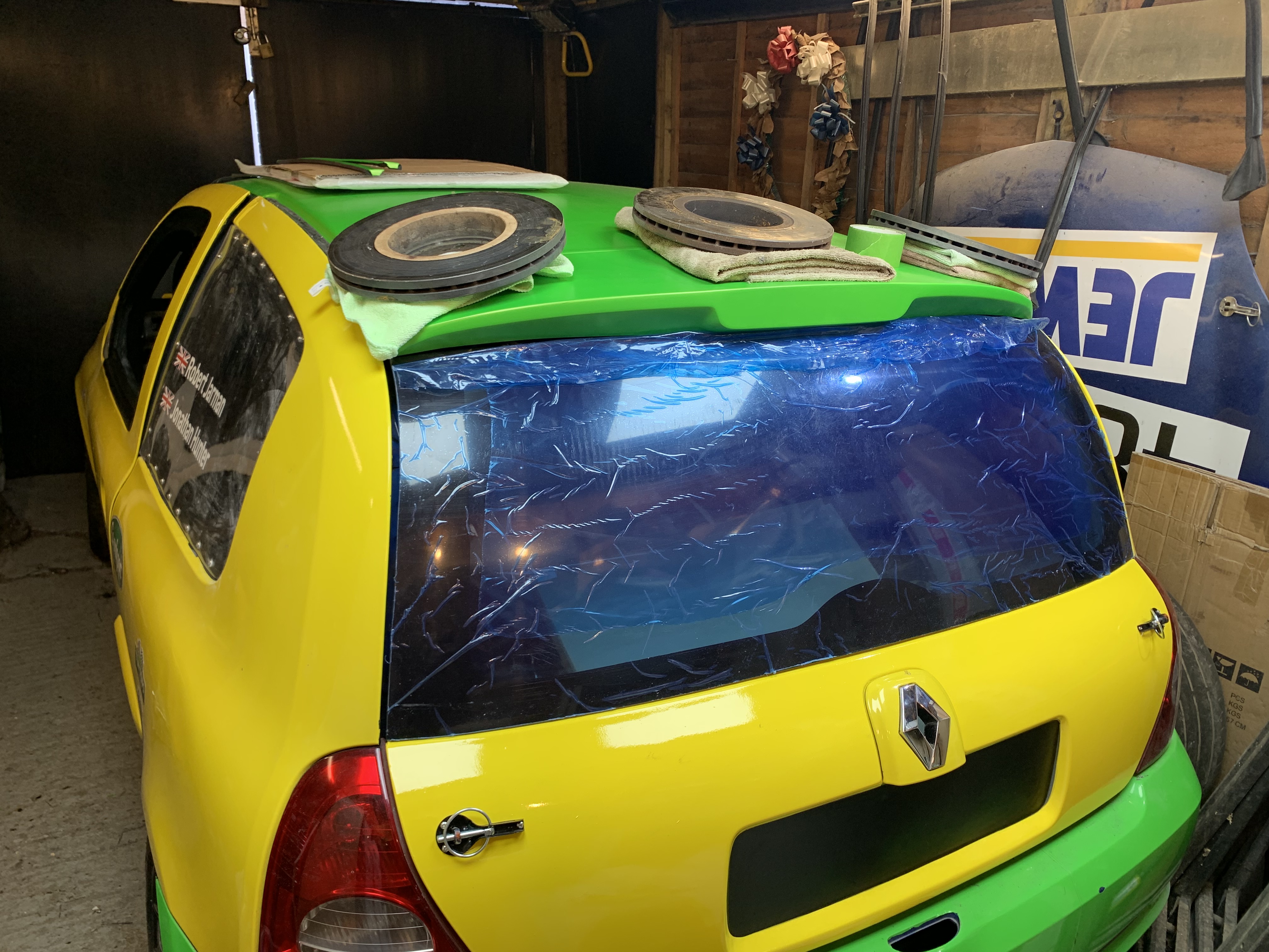

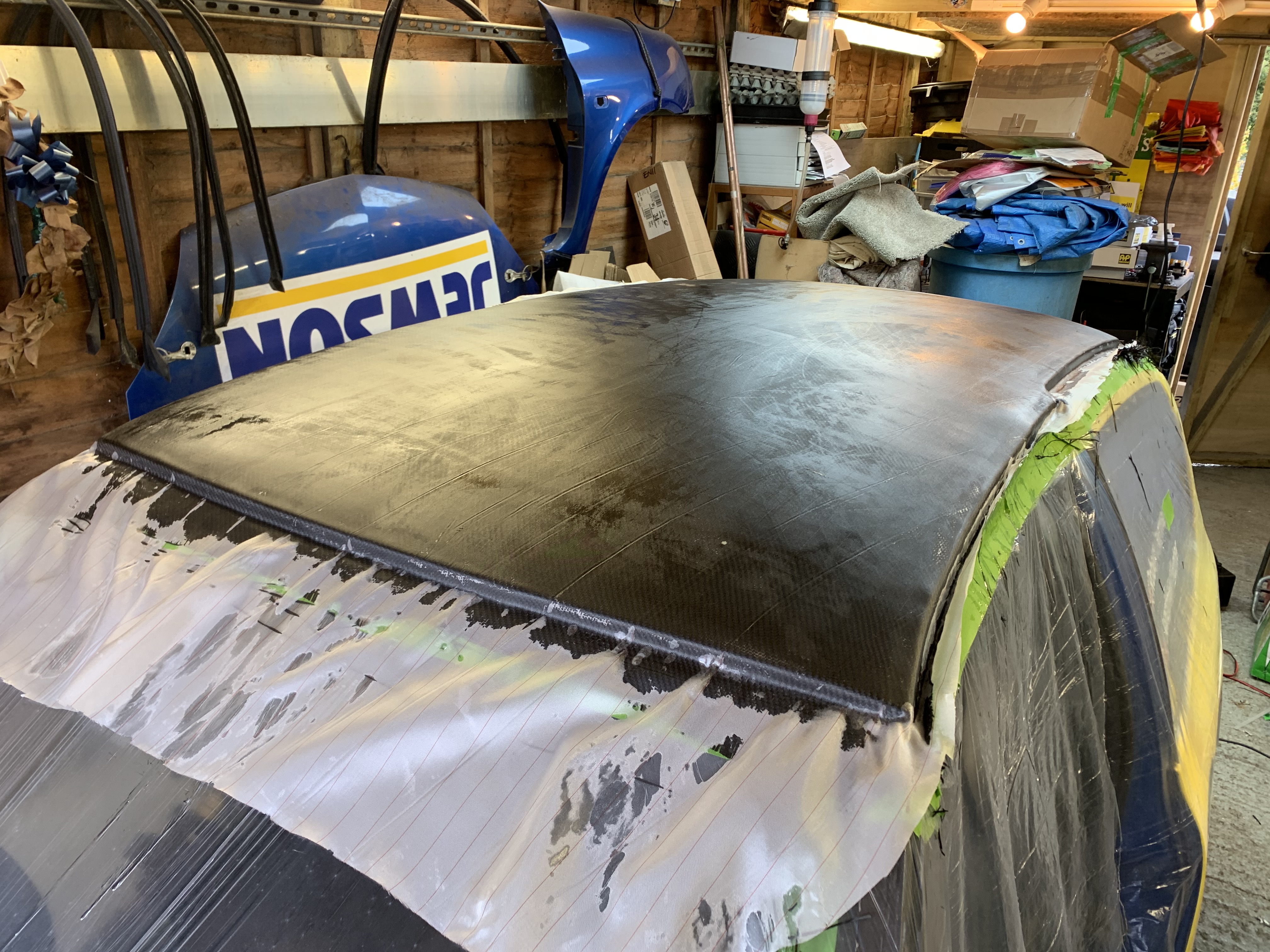

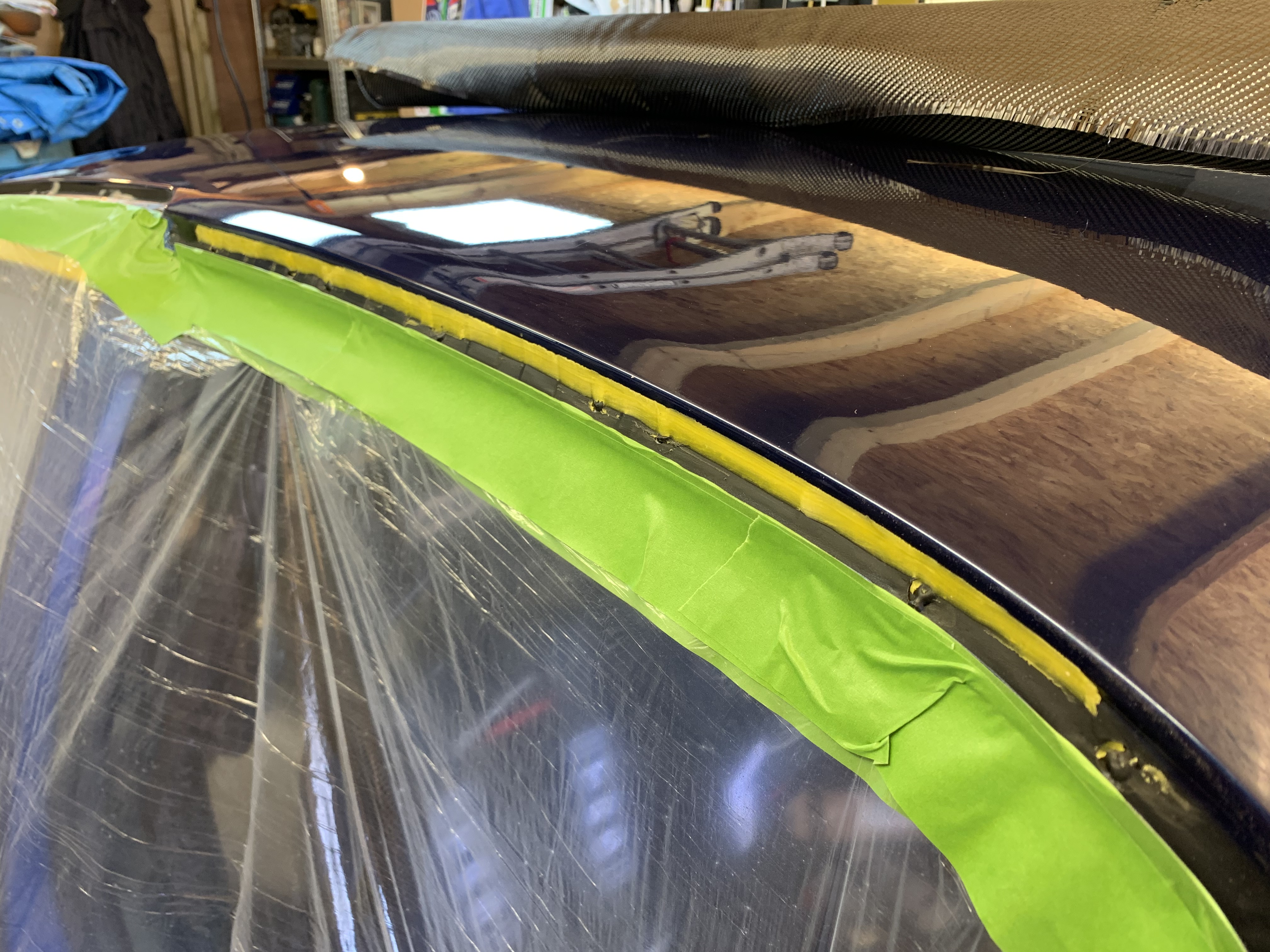

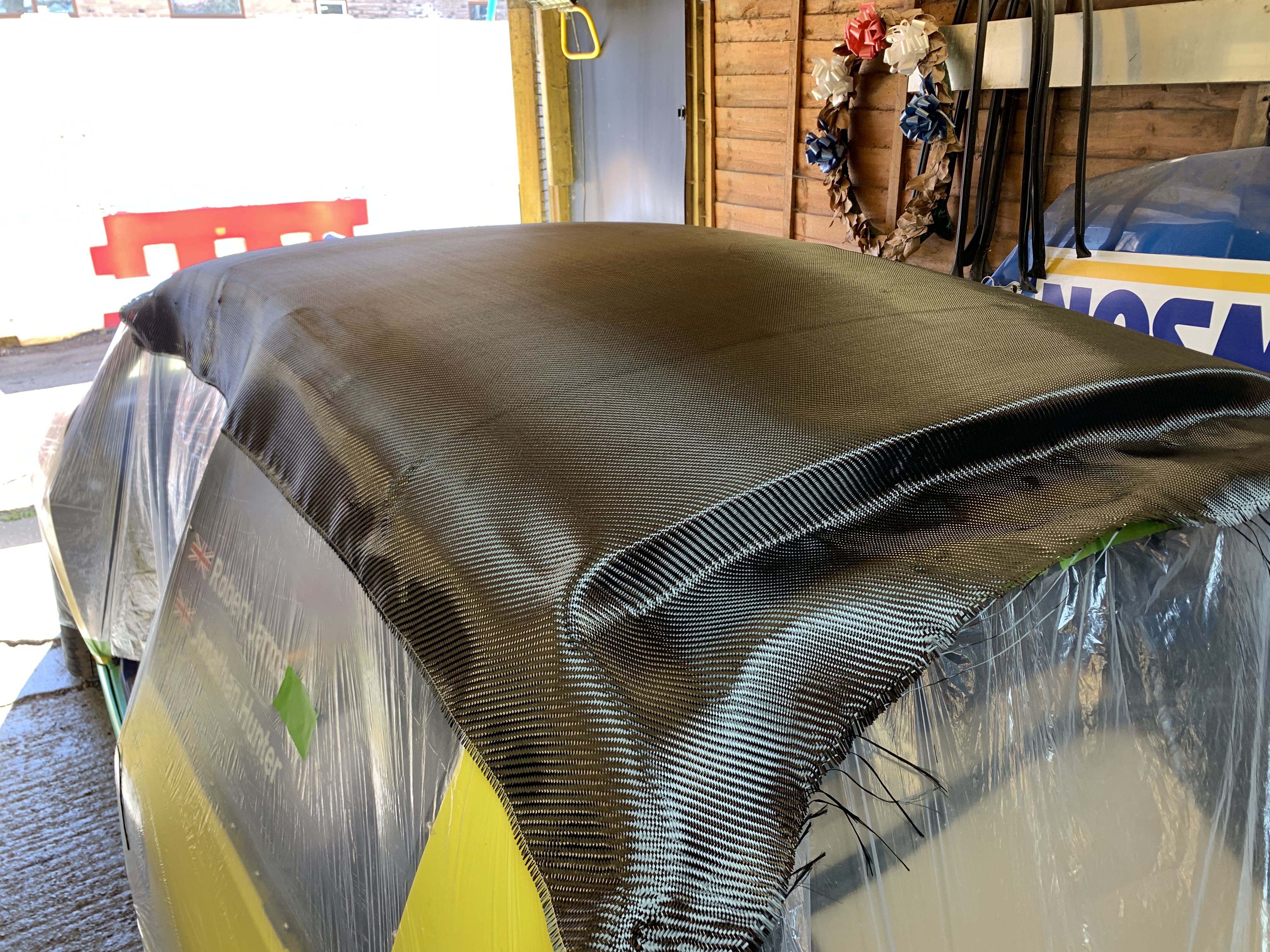

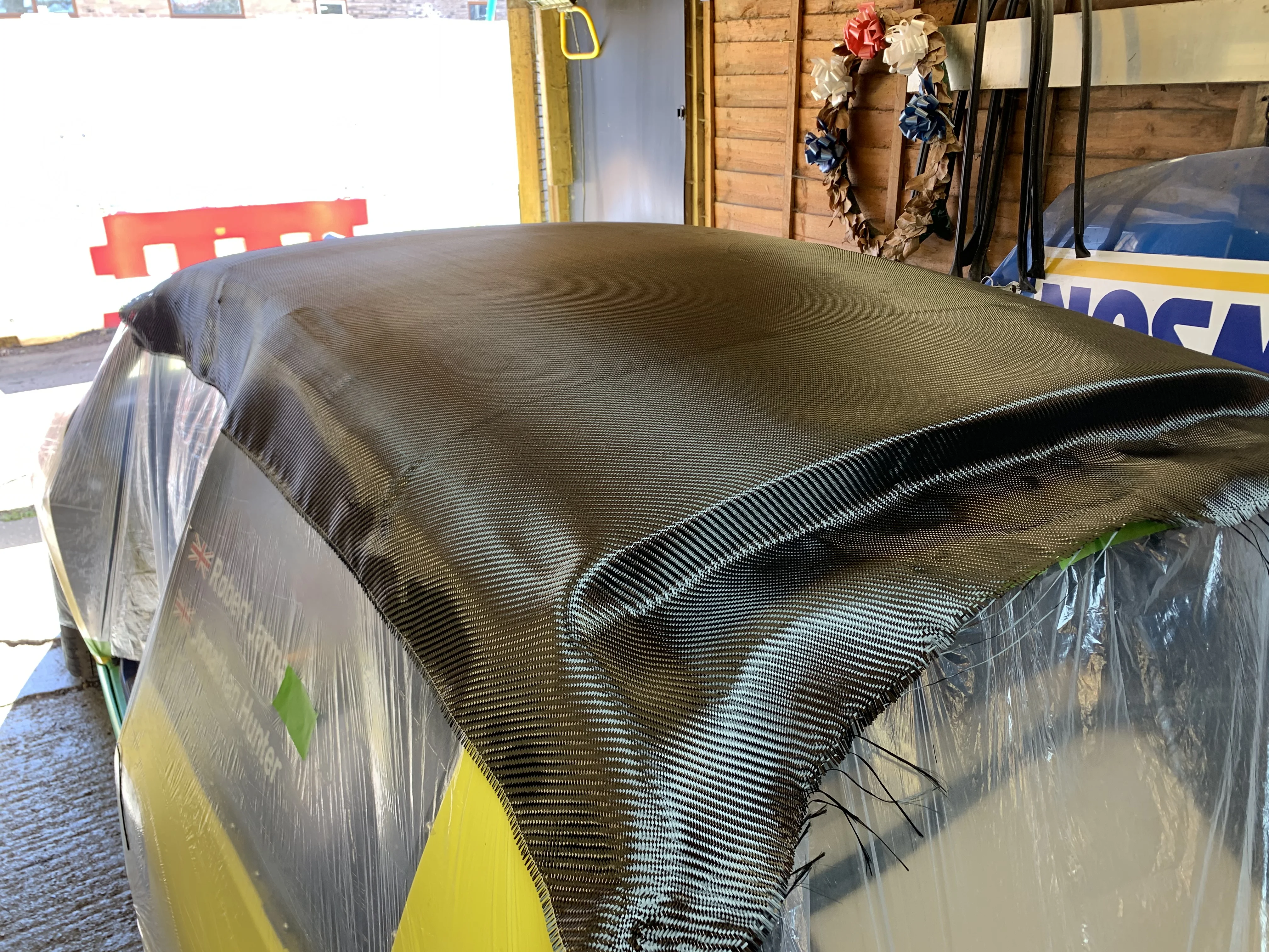

Finally made a start on the roof!

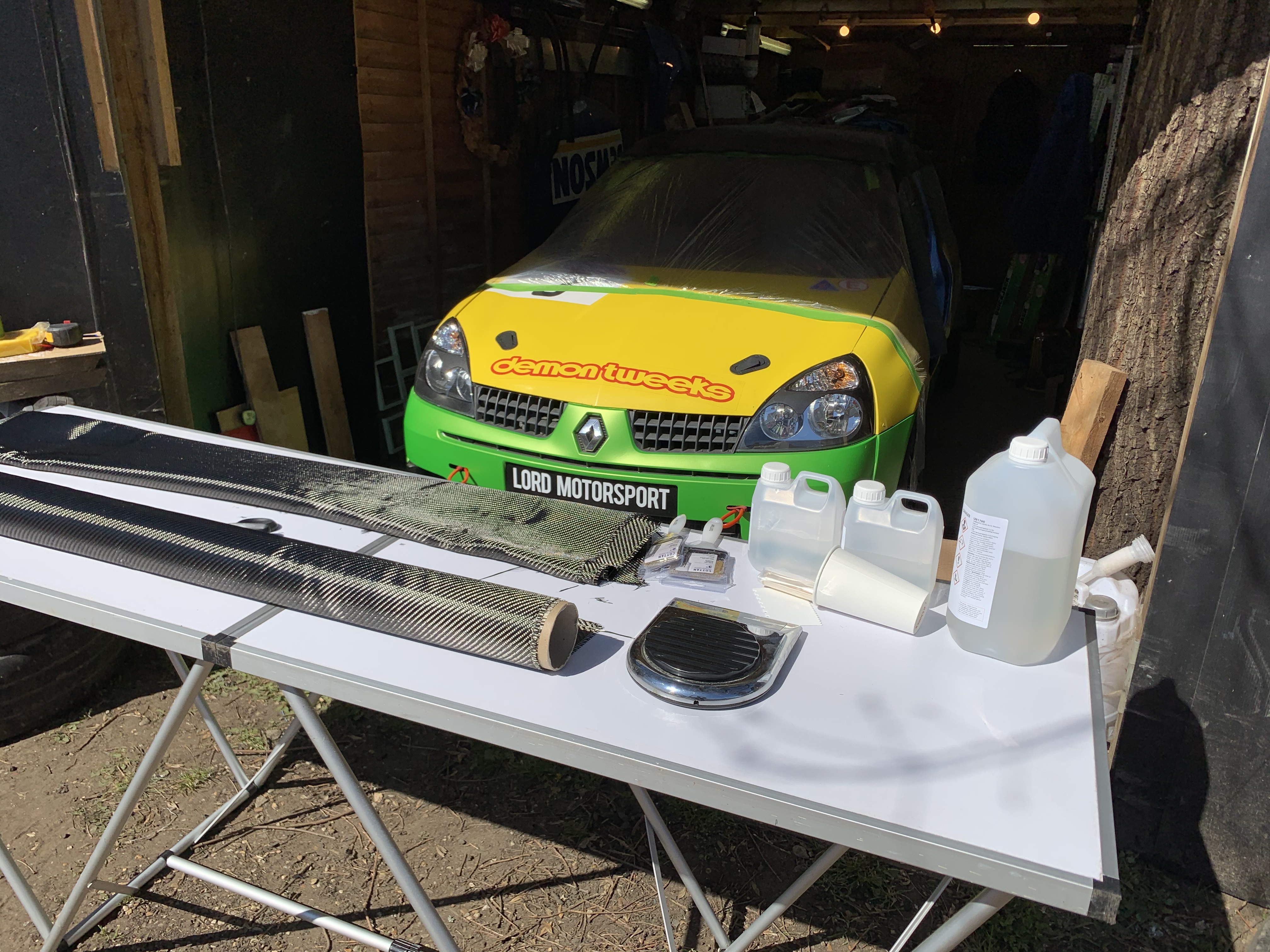

After one final round of cutting, polishing and filling the holes yesterday, this morning I started by applying 3 coats of release wax to the roof before sheeting the car up.
Once this was done I applied some filleting wax to the tight return on the edge of the roof above the doors. This fold is over 90 degrees so if I moulded the carbon fibre into that I wouldn't be able to release it from the roof once dry.
Then it was about getting set up and organised because I knew once I started I would have to get it finished.
Luckily I had chosen the slow cure hardener which would give me 90 minutes work time per mix which turned out to be perfect.
So, three layers with the middle one turned 90 degrees so the weave on a bias would give the roof strength. Only down side to doing this is that the roll of material is only 1.2m wide so it needed a join. If this turns out to be visible hopefully I can loose it with a thin skim of filler or failing that I'll design a pattern into the livery for the roof so you can't see it.
So a solid 5 hours later the roof is finished with a layer of peel ply over the top which should give it a smooth finish.
I've left it to set over night and we'll see in the morning whether it's all worked. (and whether I can actually get it off the roof!)
More tomorrow...
More tomorrow...
top work mate! so you decided to skin it rather than make a mould first. when trying to lift it. peel all corners first and along all the edges! don't be tempted to lift from the front. how many layers? and what weight reinforcement?

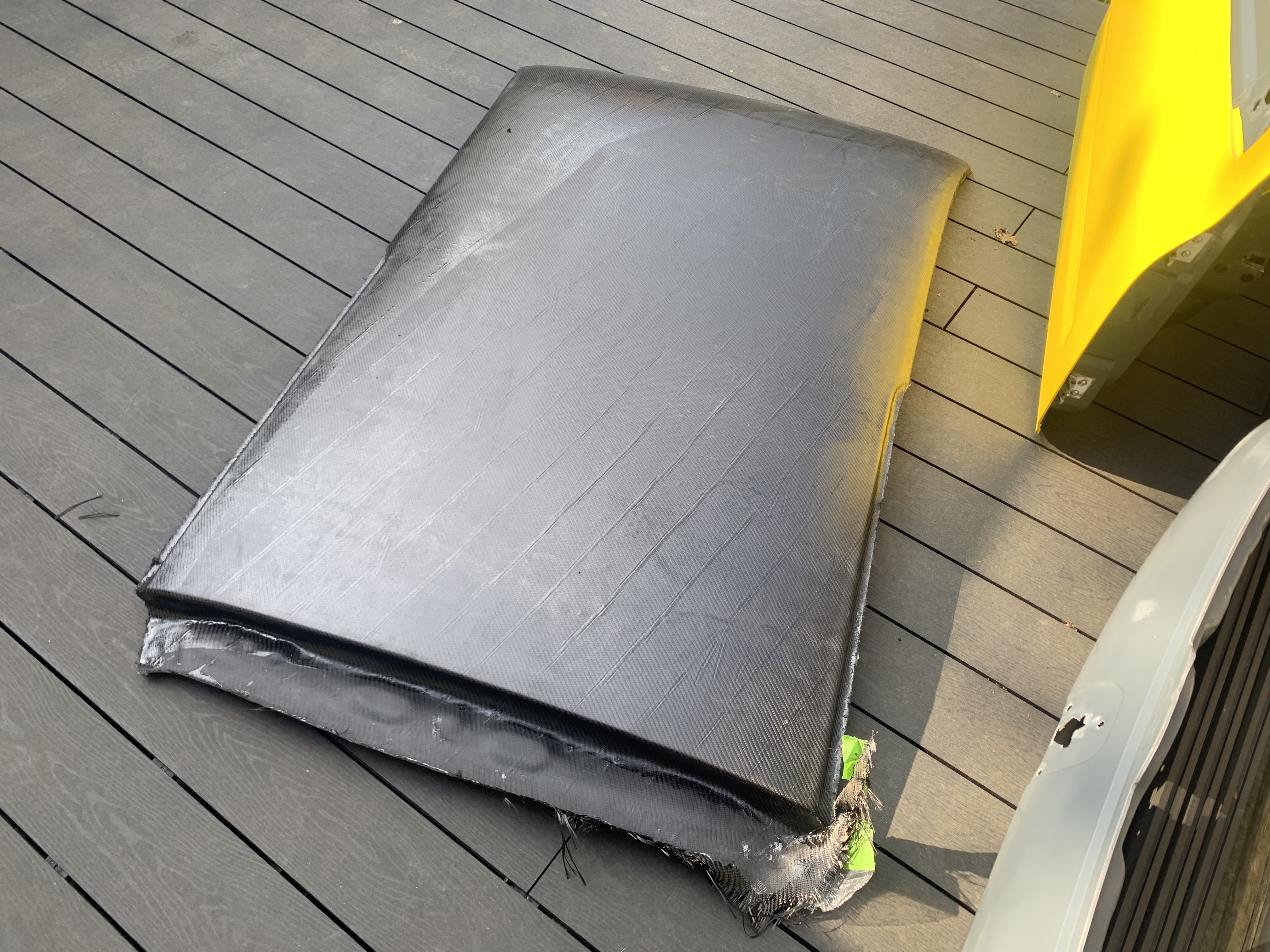

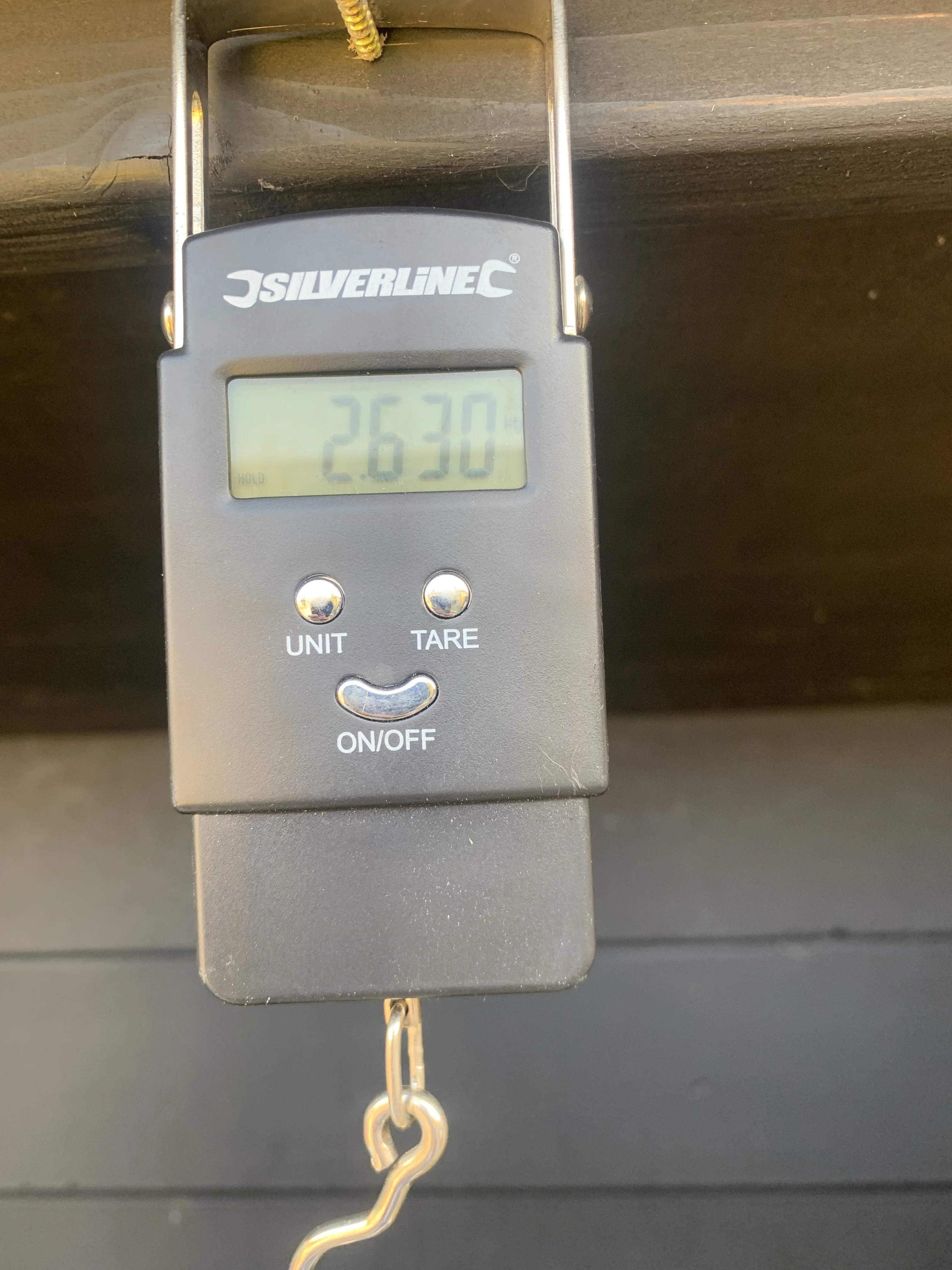

So, roof has demoulded ok and I'm glad to say that at 2.6kg I should go a little faster! The surface looks a little bumpy in places but I think there's enough resin over it so that it can flatted with a sand and then it will be ready to be wrapped.
Also spent Sunday wrapping the 2 fibreglass doors and annoyingly didn't quite have enough to do the boot so that will have to wait until next weekend.
This evening I started drilling out the welds on the steel roof and hopefully tomorrow I'll have that off and be ready to bond the new one on.
More to come....

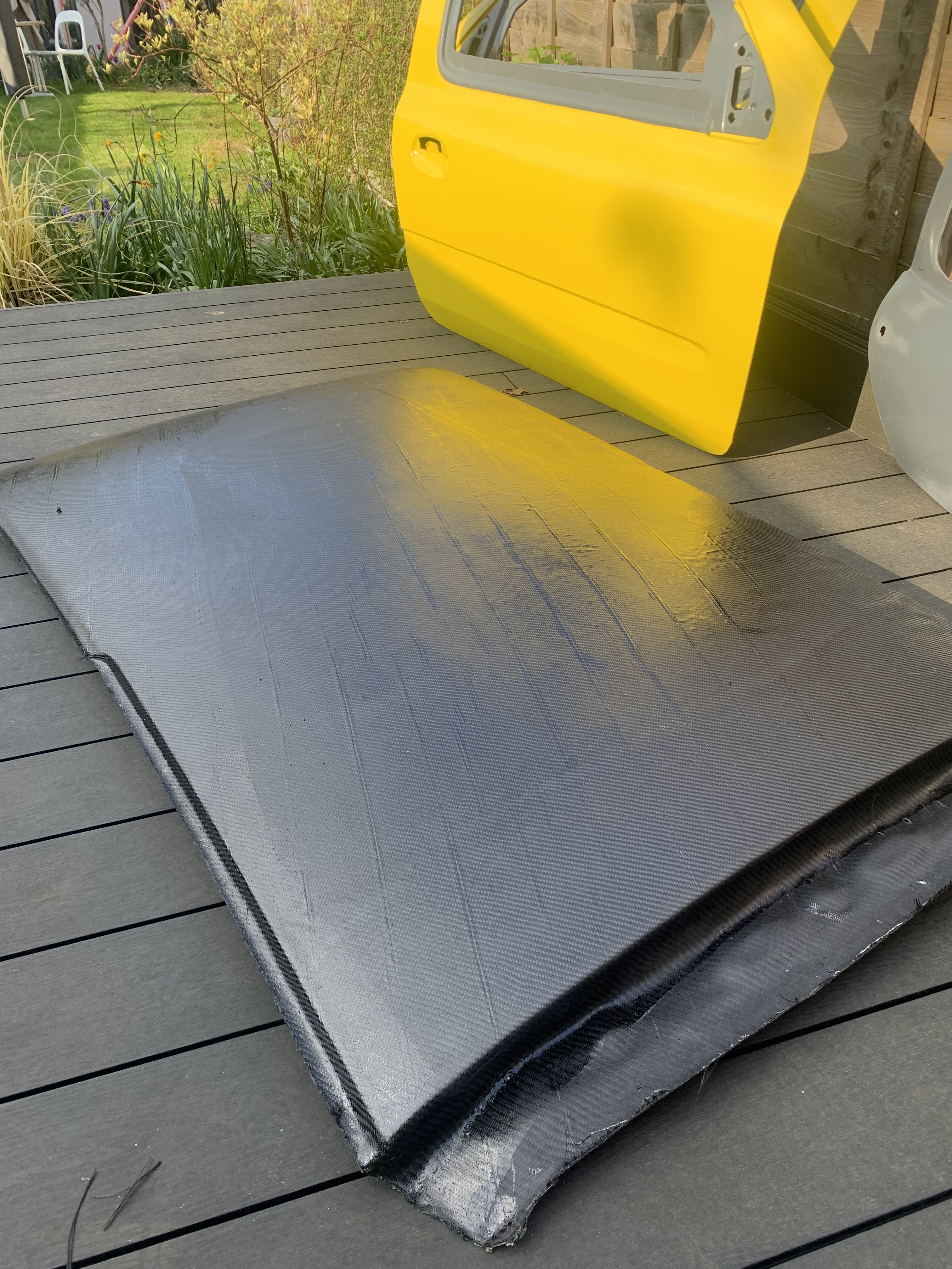

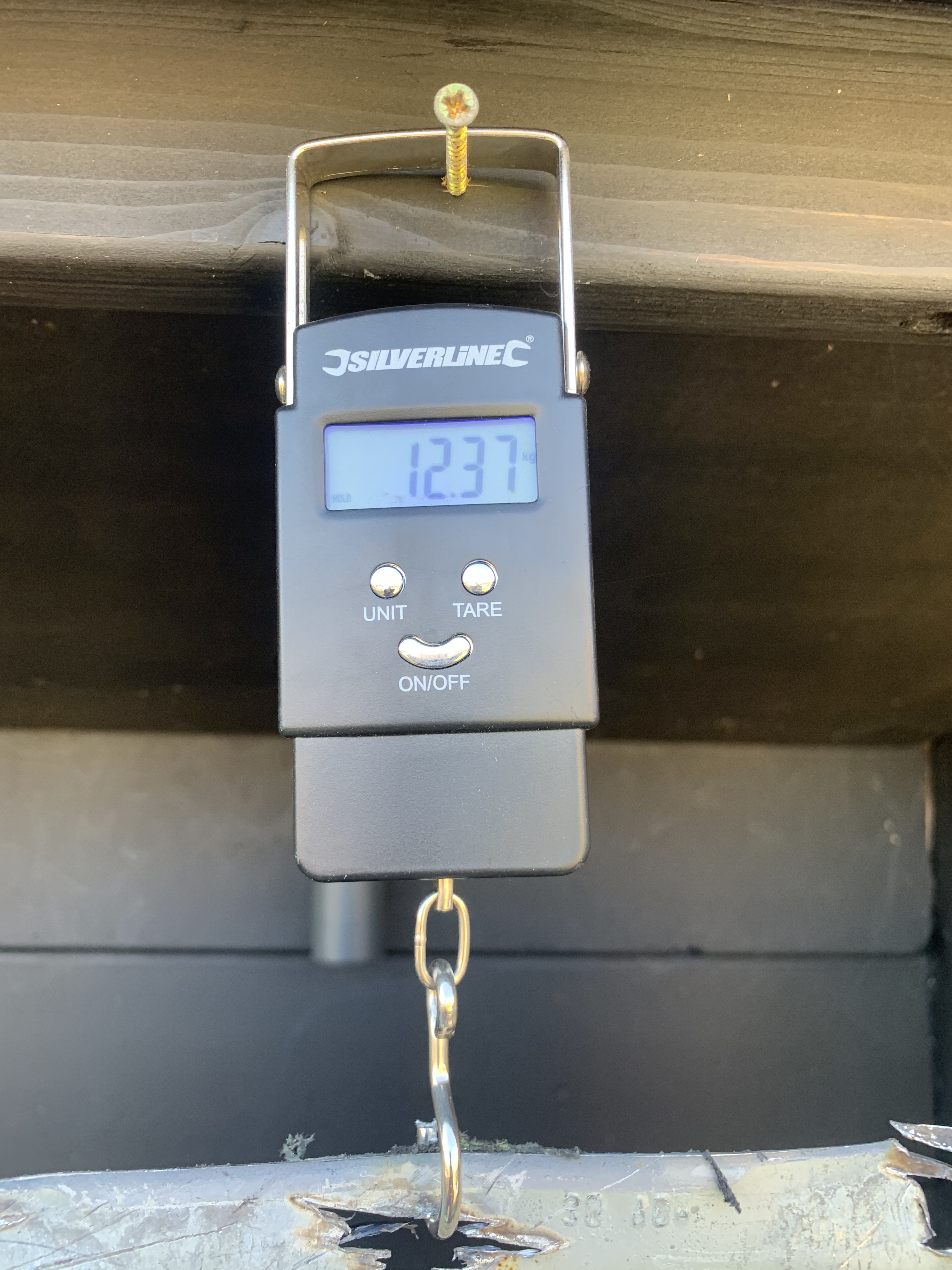

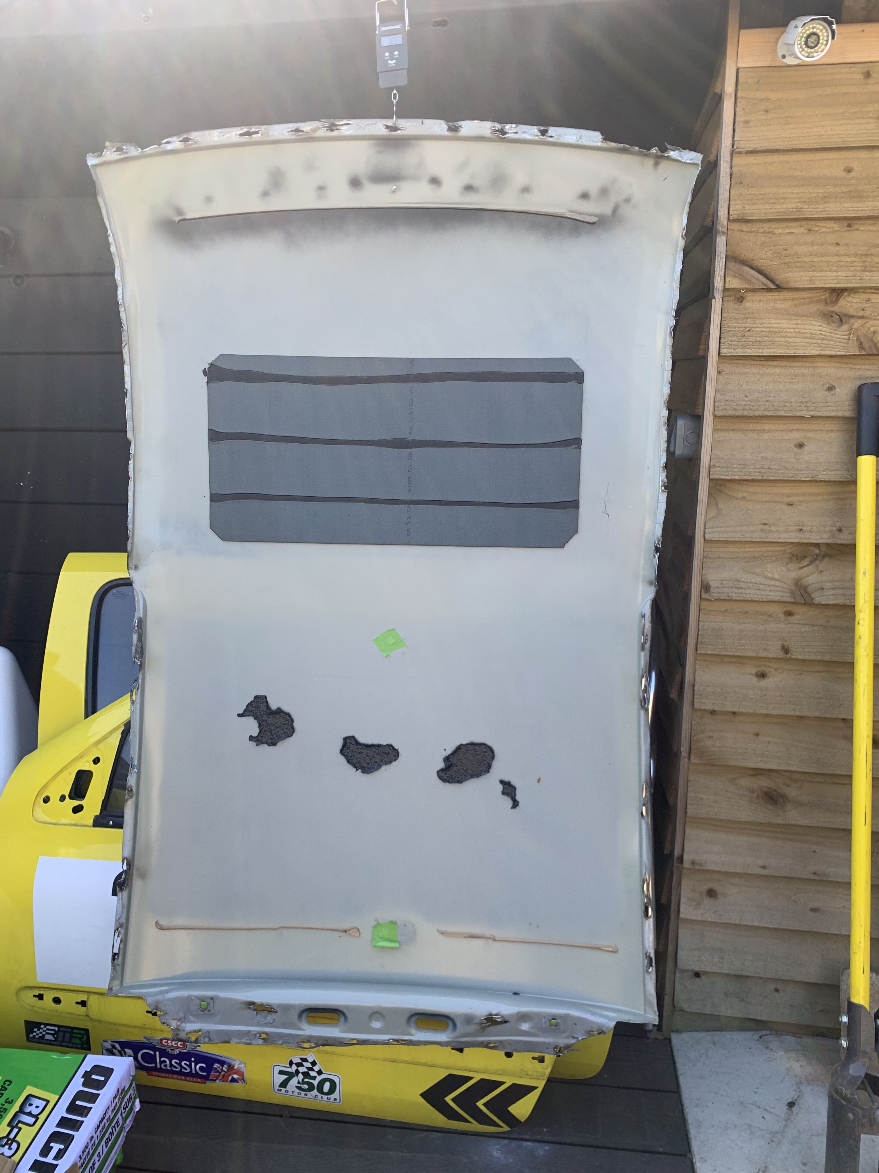

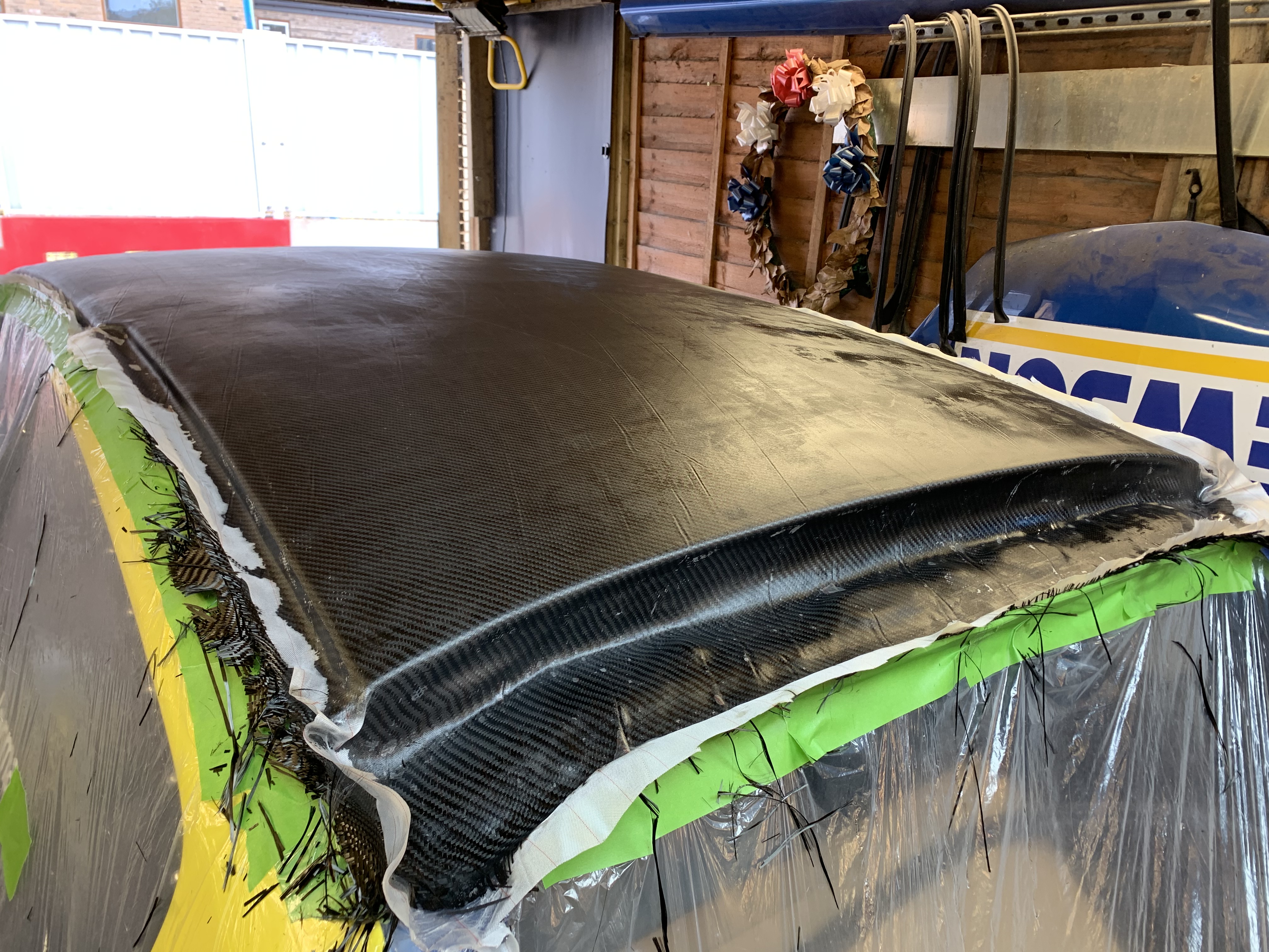

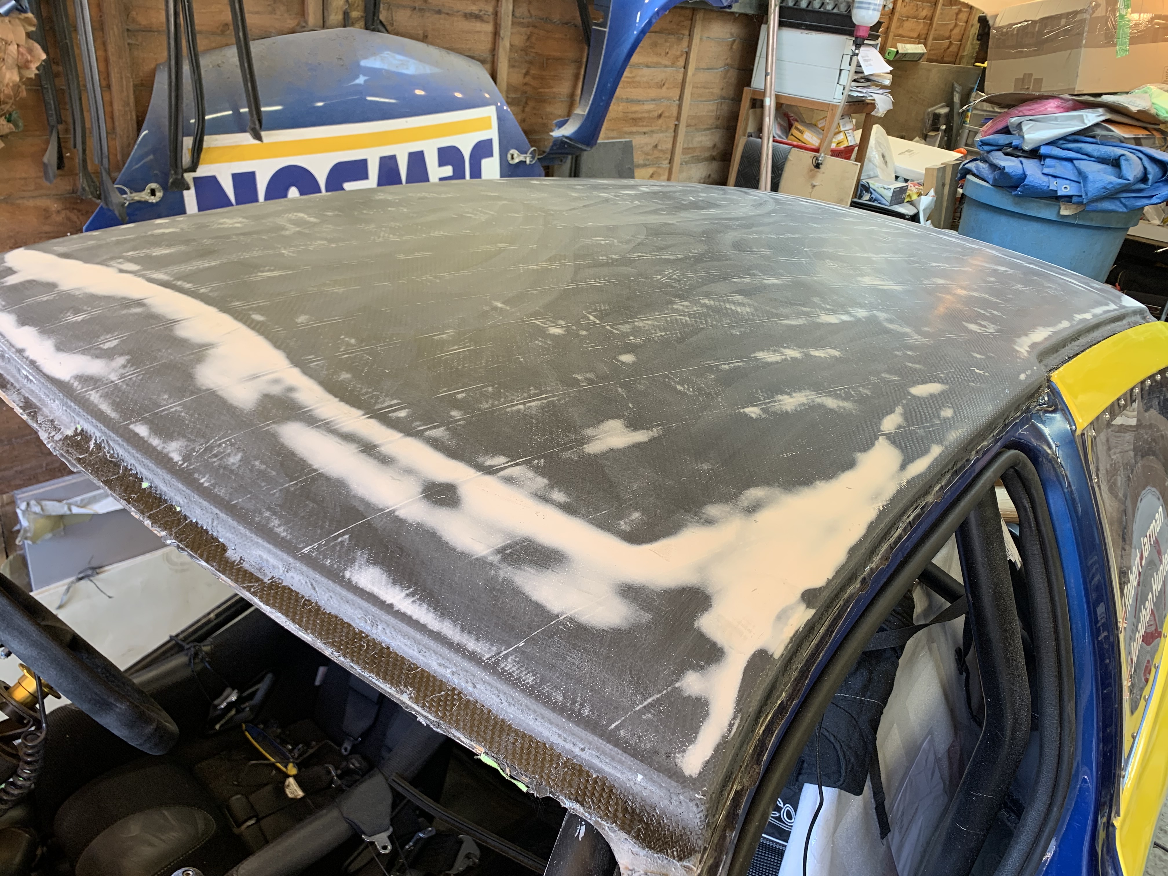

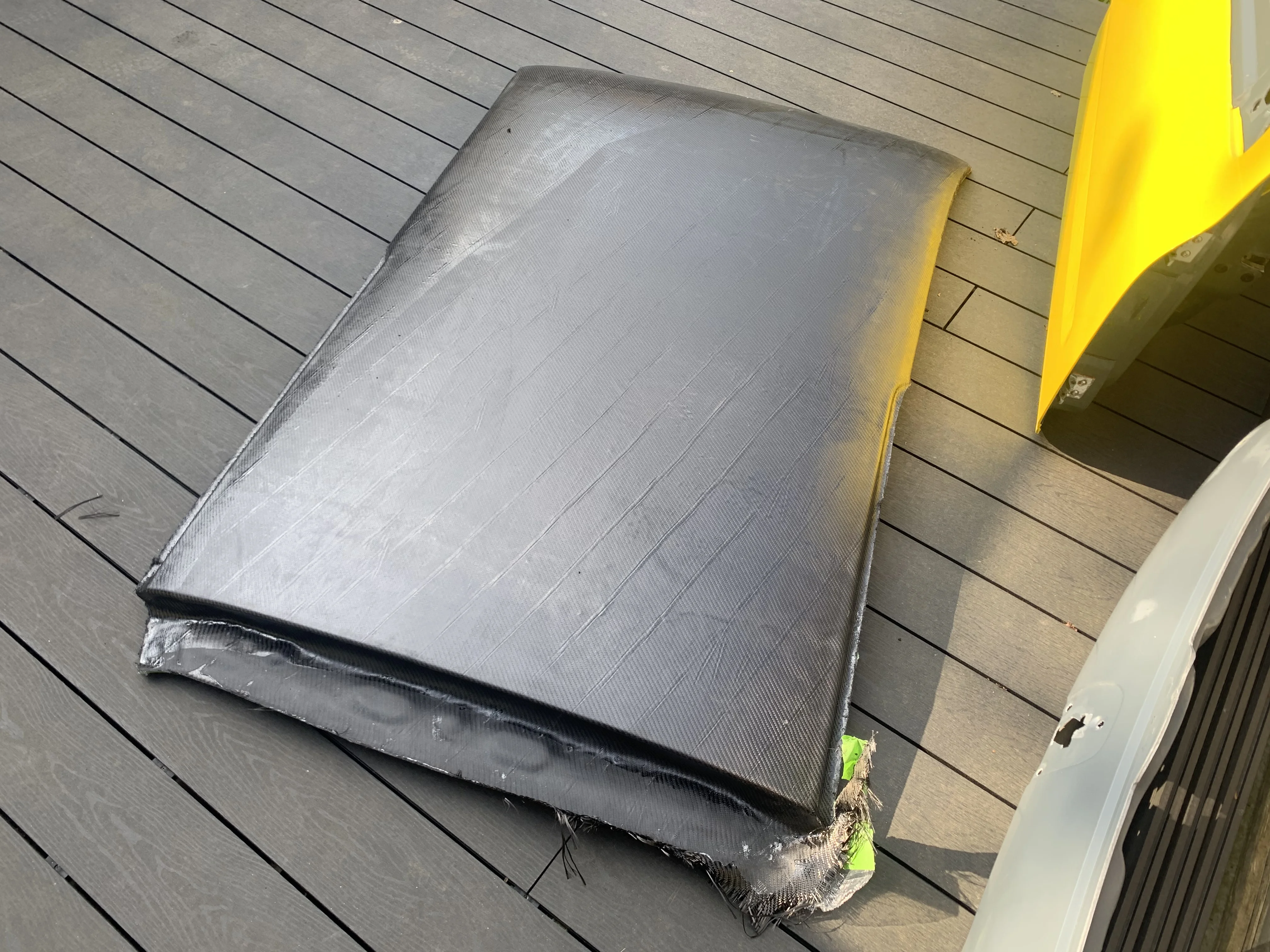

Thursday I freed up some time to crack on with the roof and before lunch I had the steel roof off the car. Oddly a harder job for having welded this one on myself a few years ago. Welds don't drill out as easily as spot welds but it was nothing an angle grinder couldn't handle.
More surprisingly was the weight. I had expected around 10kg, so at 12.3kg I'm now making a net saving of 10kg with the new roof.
I recon this could be a more noticeable improvement to handling than even the fibreglass panels as losing this much weight from the highest point of the car is going to lower the centre of gravity significantly.

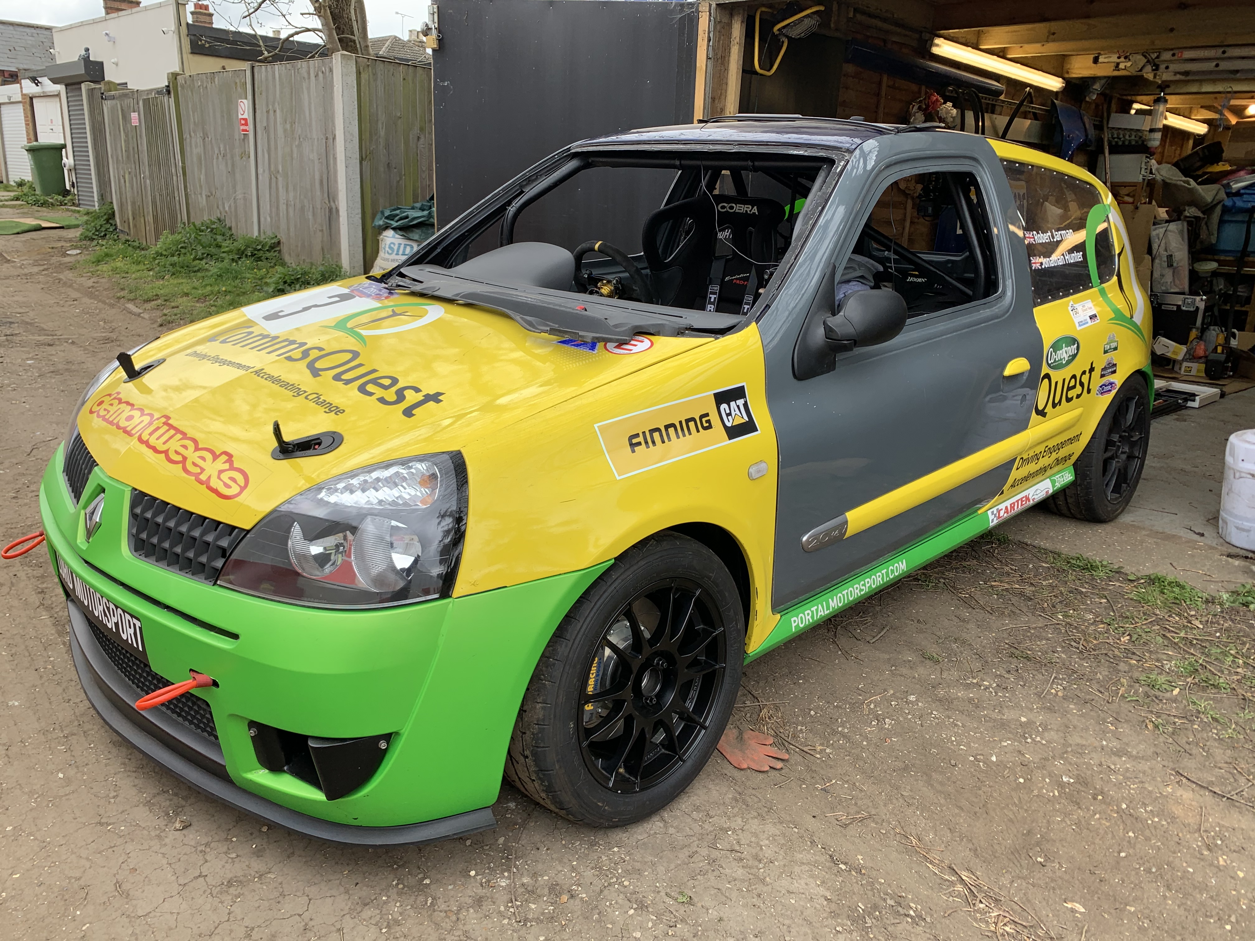

Been a while since I've seen the cockpit from this angle and hopefully it will be the last time.

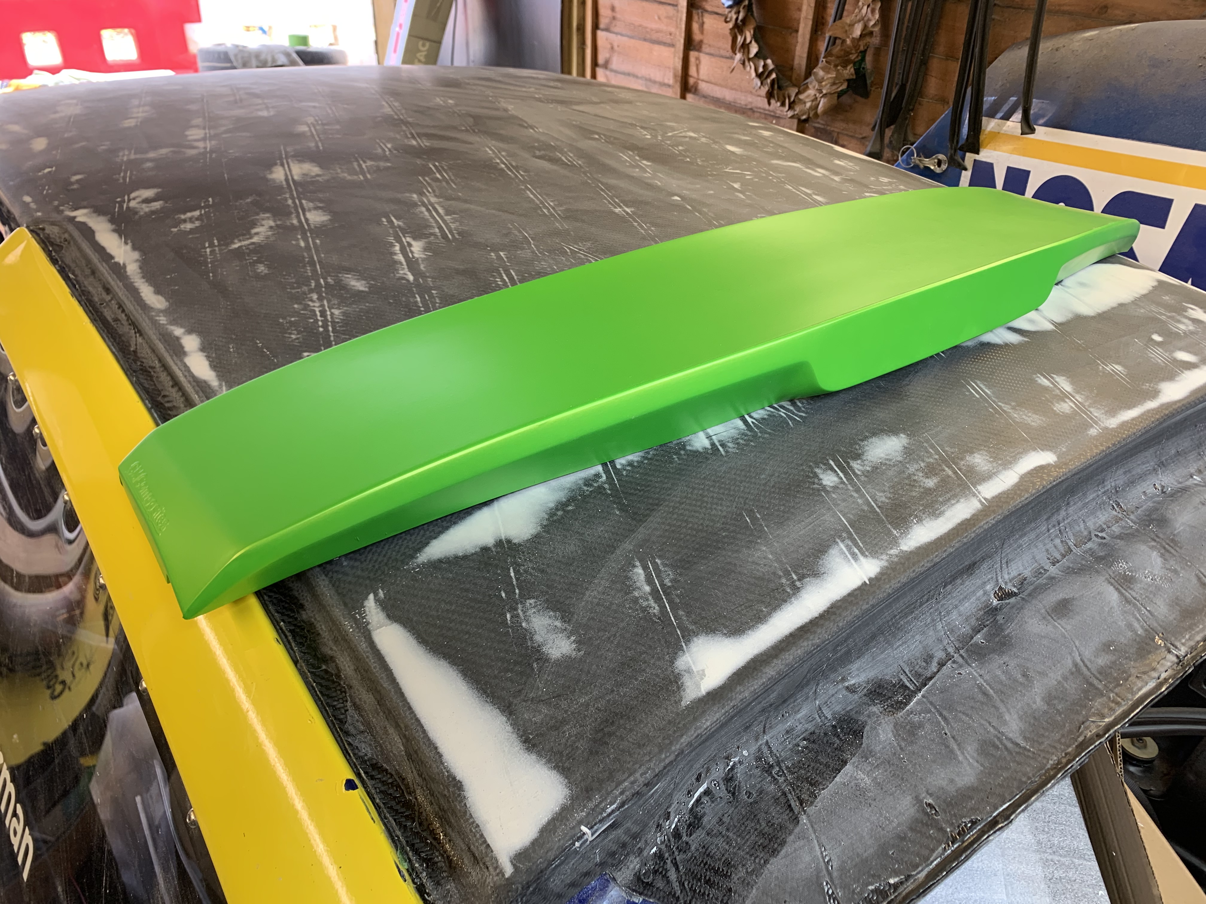

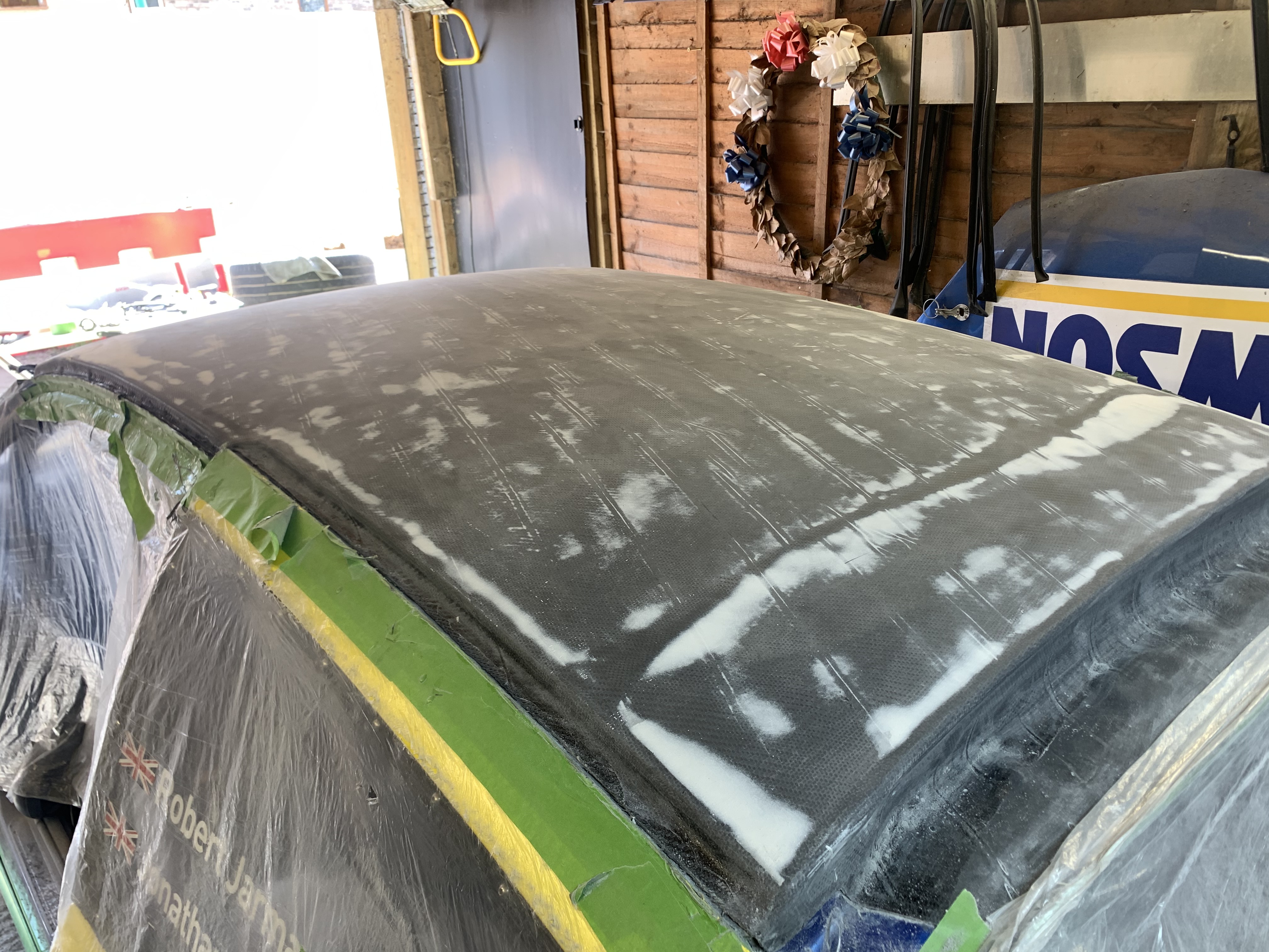

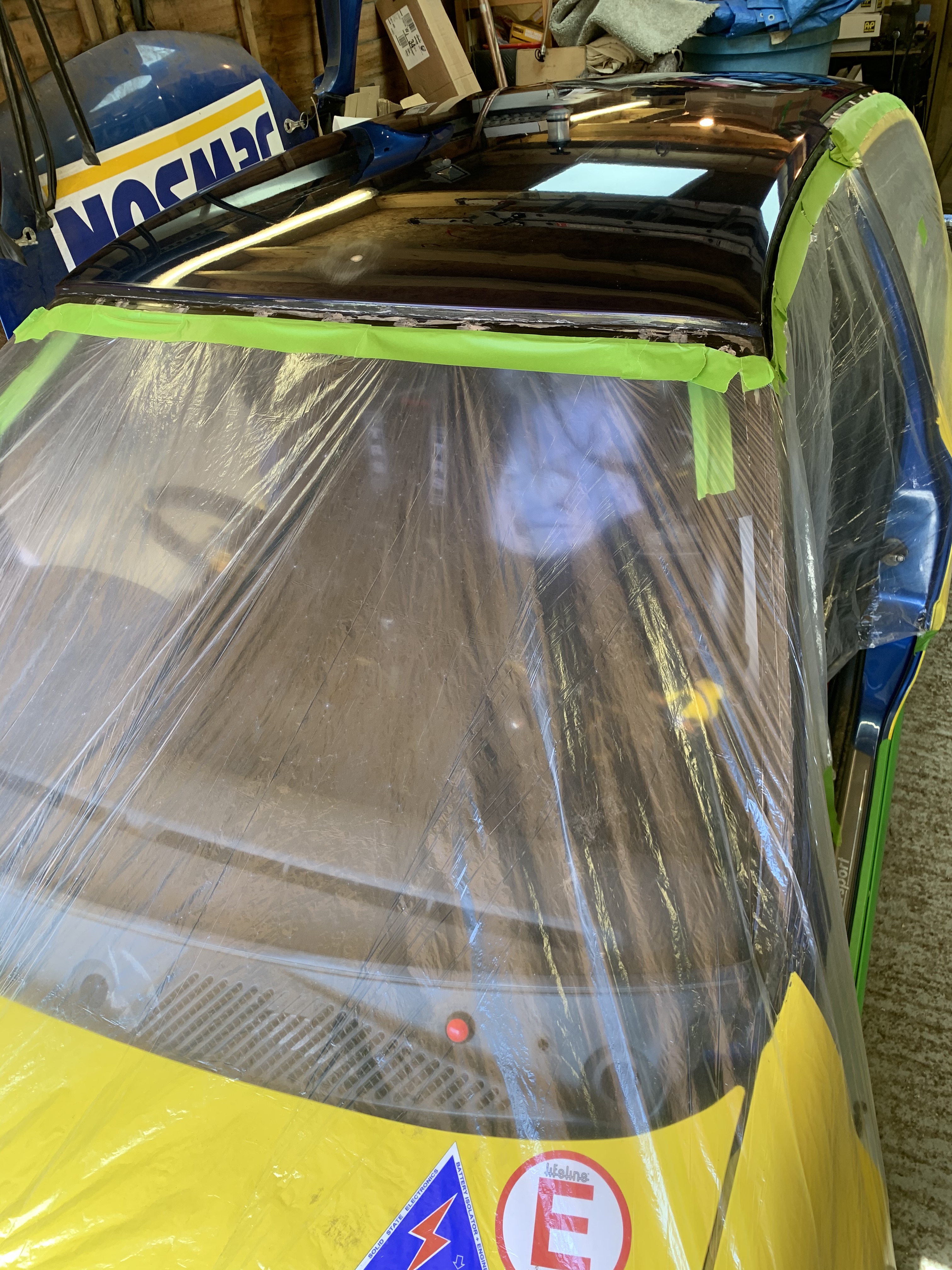

Thursday evening, after a bit of trimming and tidying I bonded the roof in and left it over night with some strategic clamps and weights around it to hold everything tight.
There it stayed until this morning when I began the unenviable task of sanding it smooth. That resin is super hard and I ended up running over the whole roof several times with 60 grit in an orbital sander before giving it all a light skim of filler to lose the lines of the Peel Ply and the 2 areas where I had to make joins on the centre sheet of carbon.
The whole roof was then sanded back again with a DA sander and then finished by hand, block sanding progressively down to 400 grit.
This seems to be smooth enough now hopefully for the wrap to take to it. We'll see tomorrow.
I had a bit of time at the end of the day to wrap the new CM Composites Cup spoiler ready for the bootlid once the Lexan rear screen goes in on Monday.
More tomorrow.

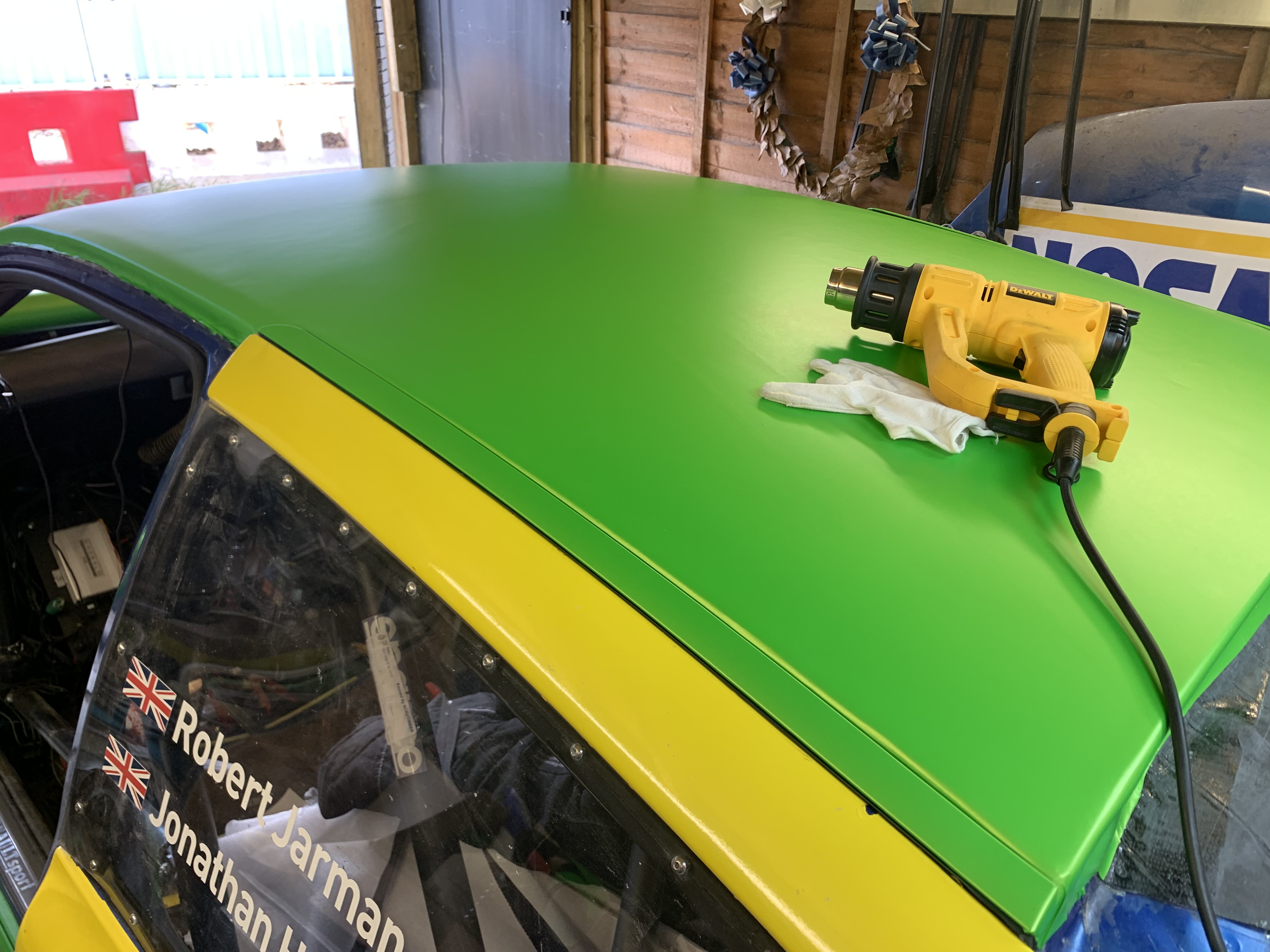

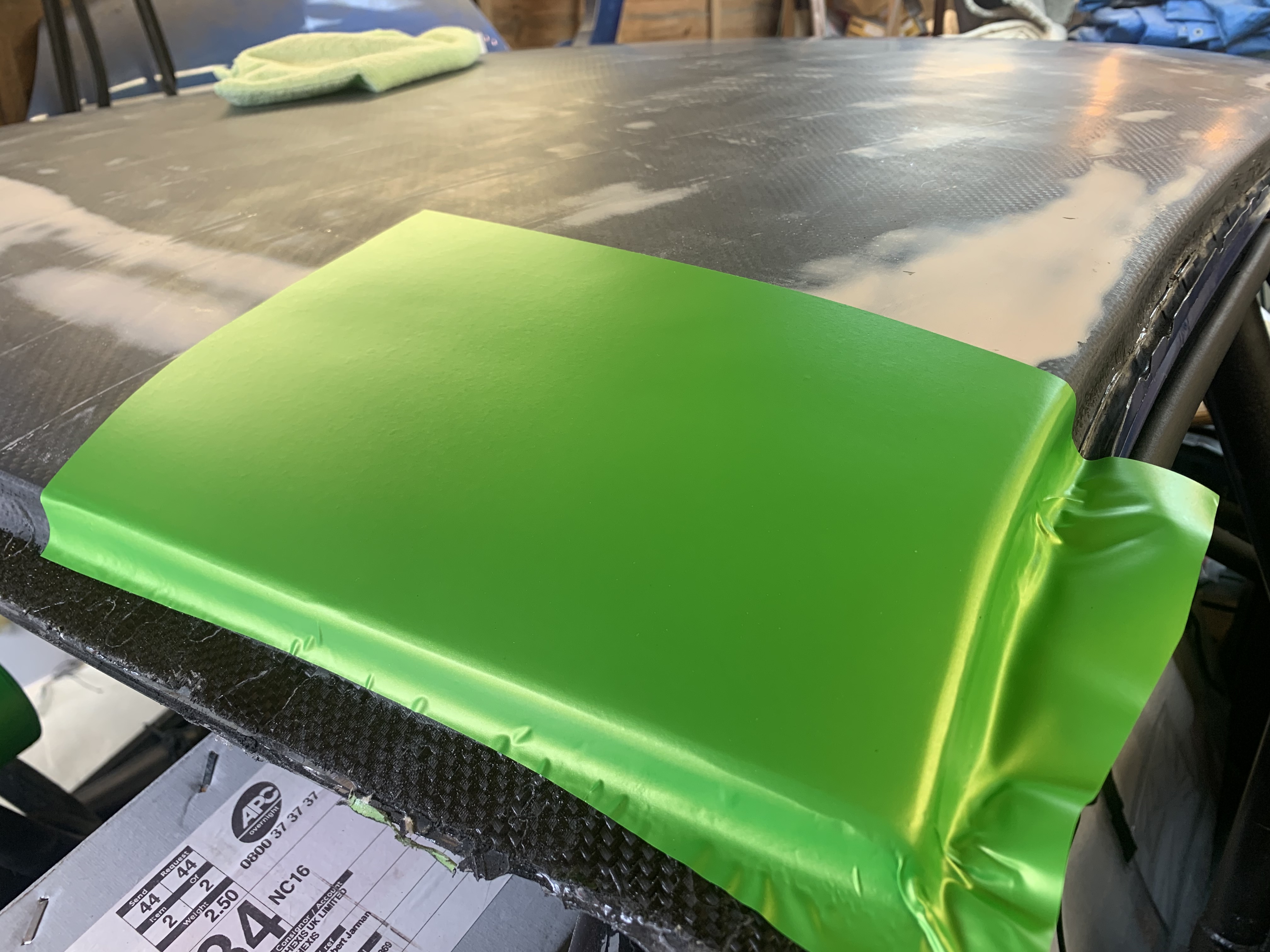

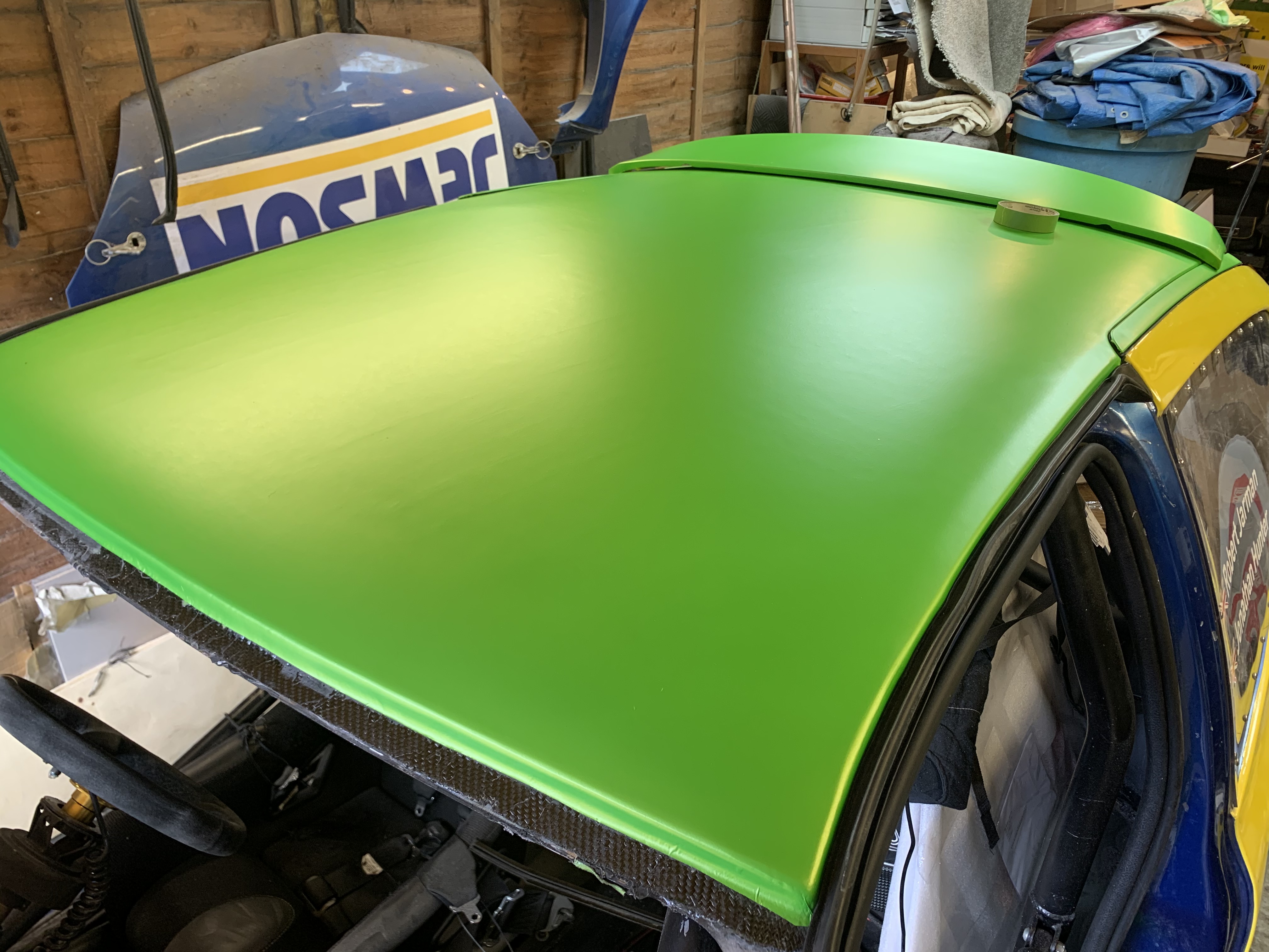

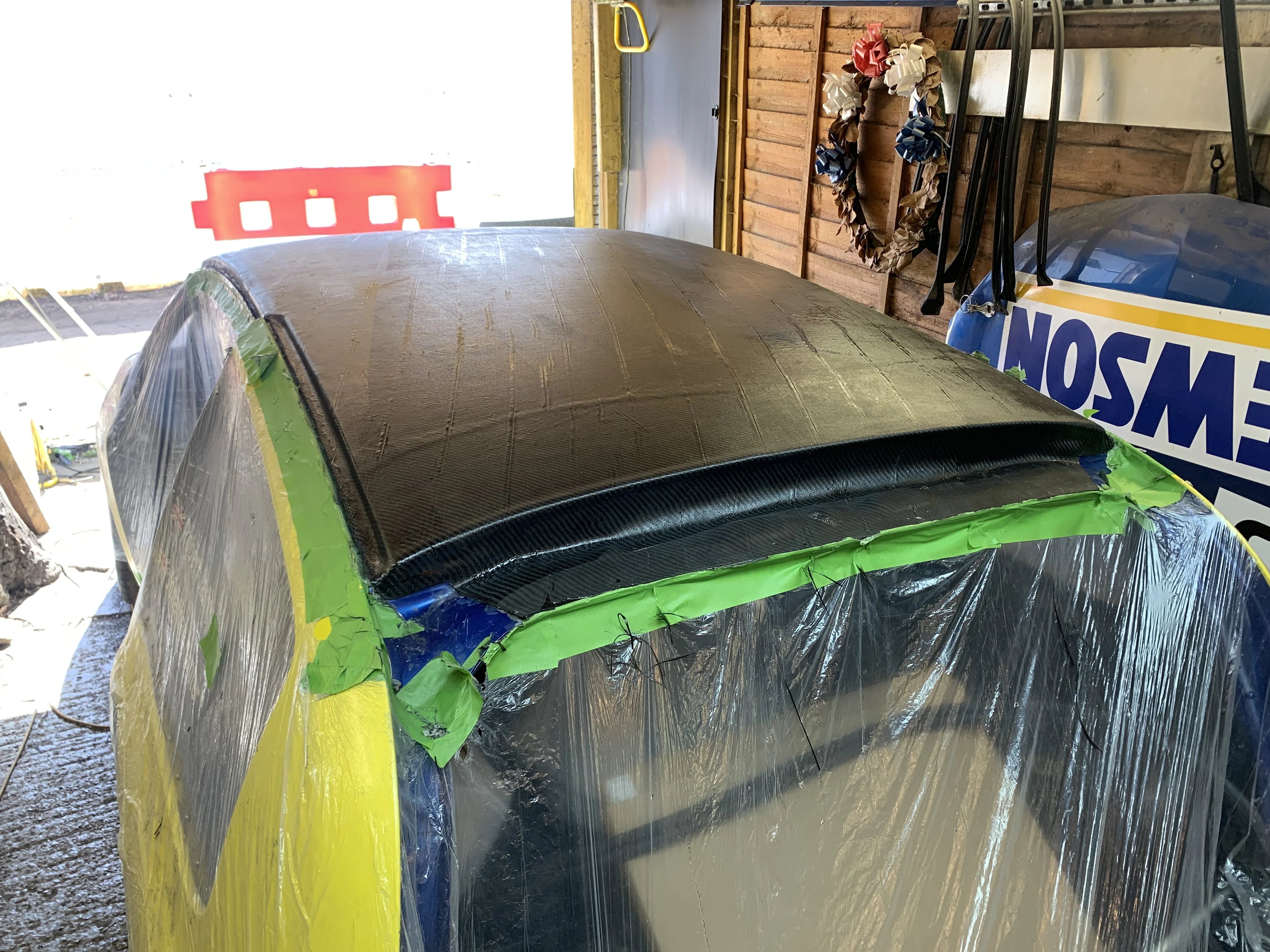

Early start today and before doing anything else I test fitted an offcut of vinyl to make sure it would take to the roof.
All seemed ok..
So with help from the wife we went about wrapping the roof and had it all done in about an hour or so. I have to say it has come out just as I wanted it and I think you'll be hard pressed to spot it's any different to a standard roof. (unless you look up inside the car!)

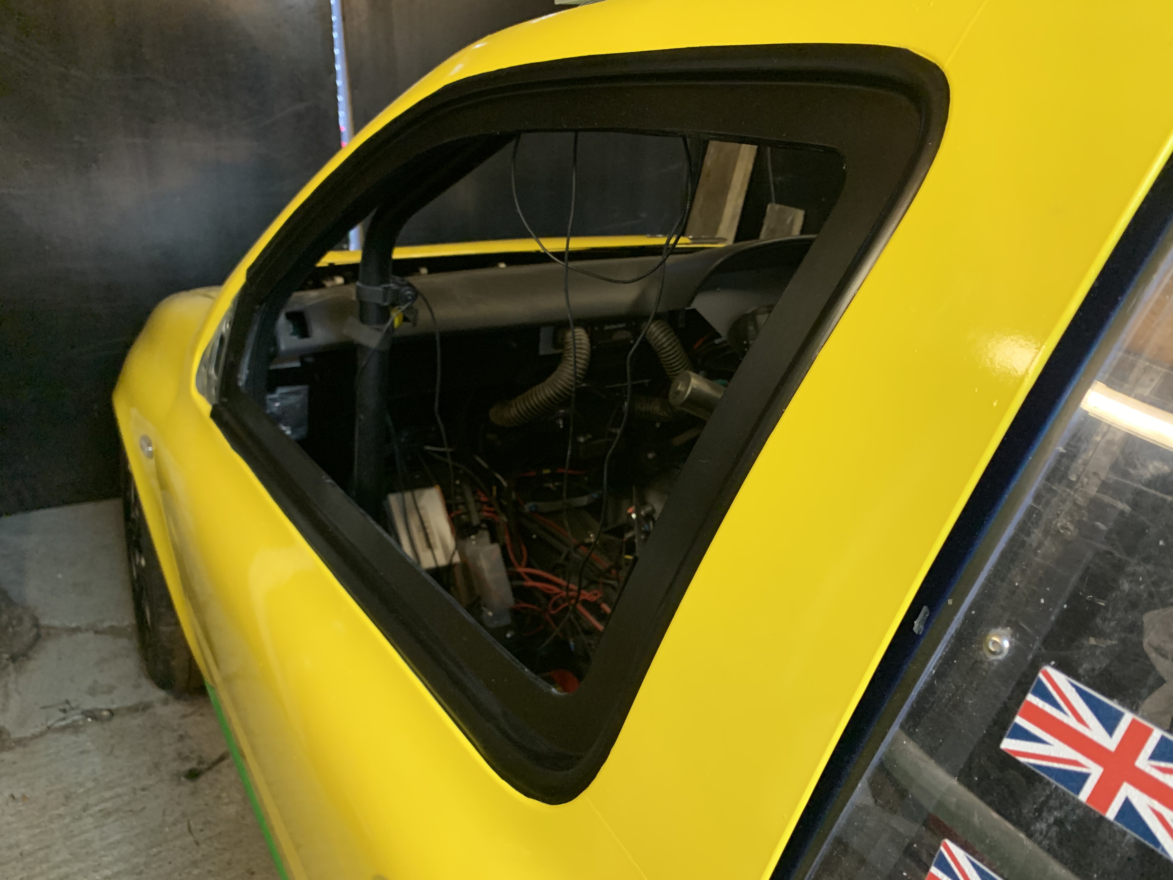

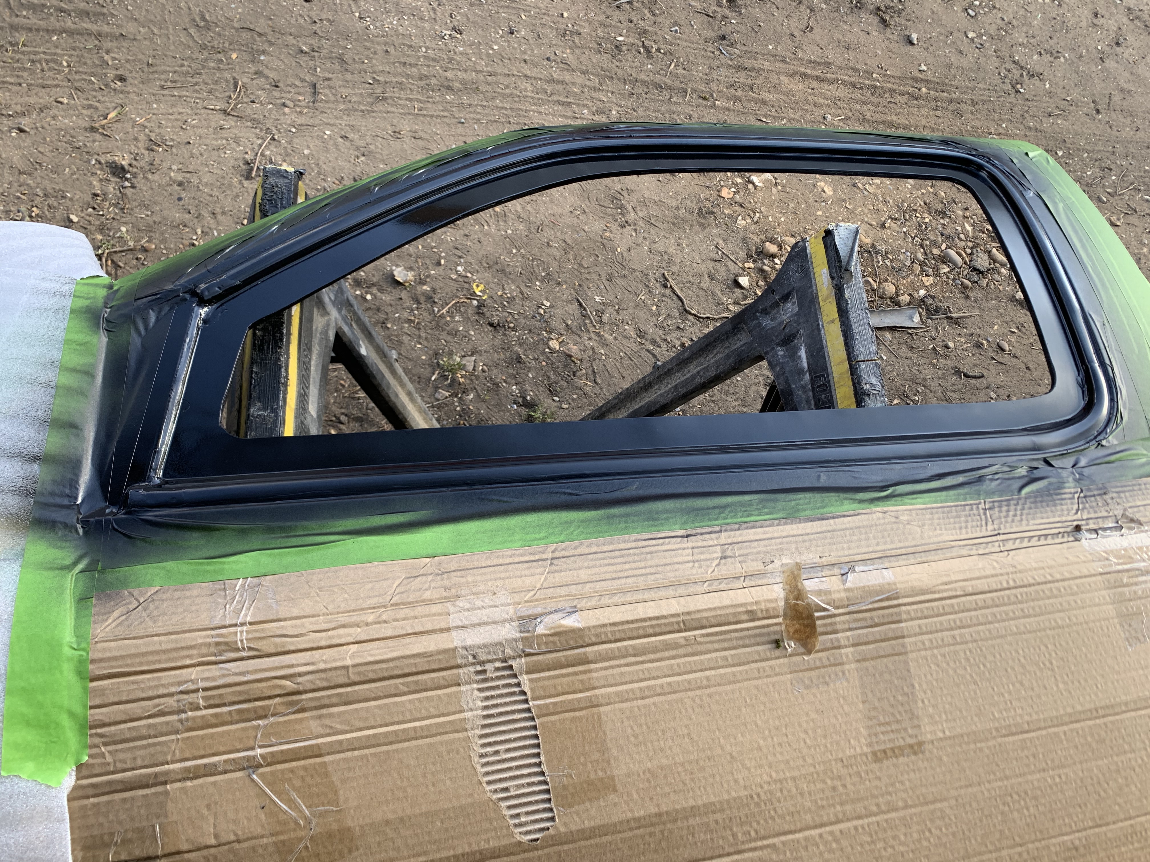

Then on to the doors which first needed the glass surrounds painting satin black.
And ready for new windows.
So next will be completing the doors tomorrow and the new heated screen should be fitted tomorrow too although I don't think it will be wired in for Thruxton. There is already a list of work for post Thruxton and pre-Brands Hatch!
The new livery has been printed up so that will be applied this week. Brakes need bleeding and a full string alignment and corner weigh to do and we'll be about ready.

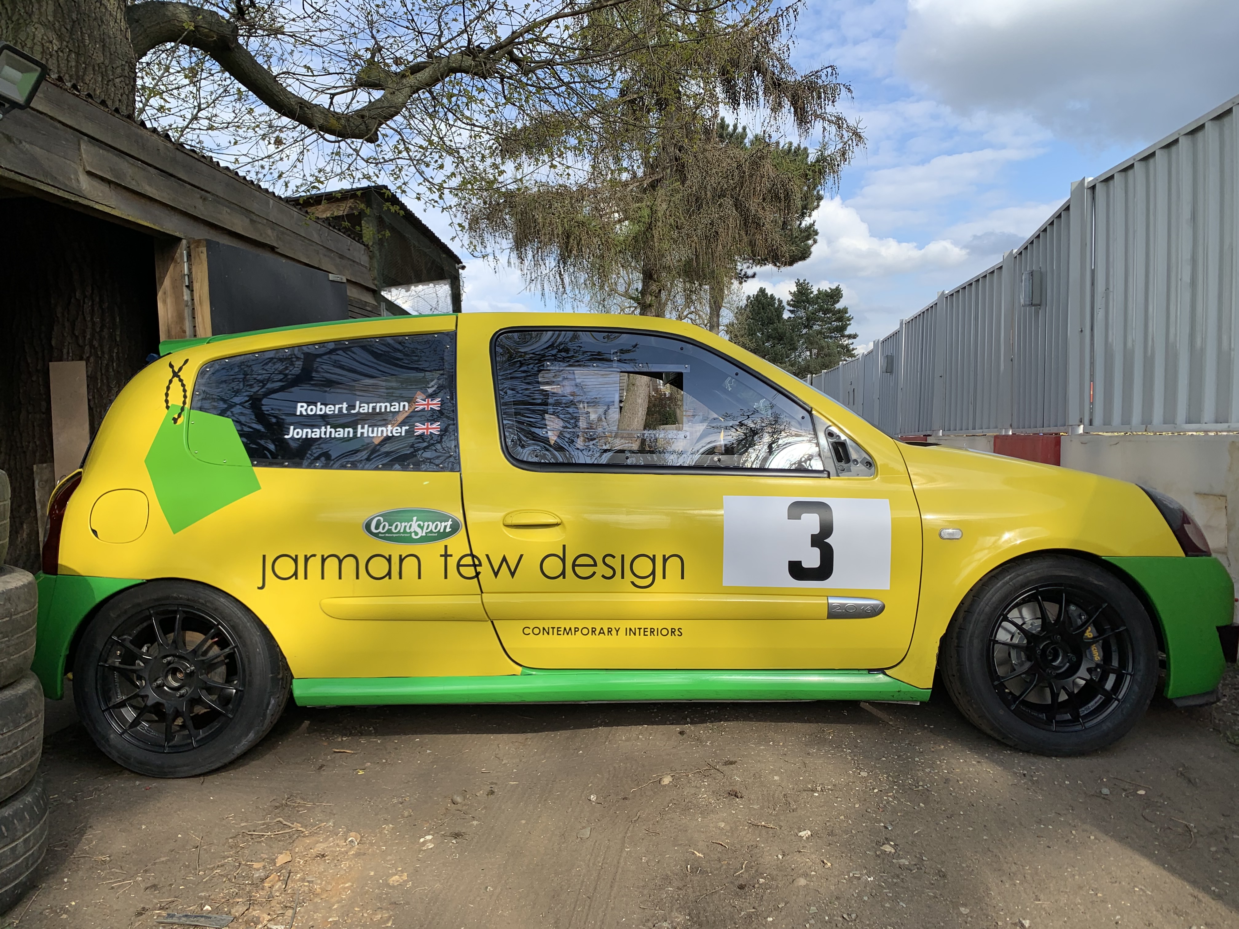

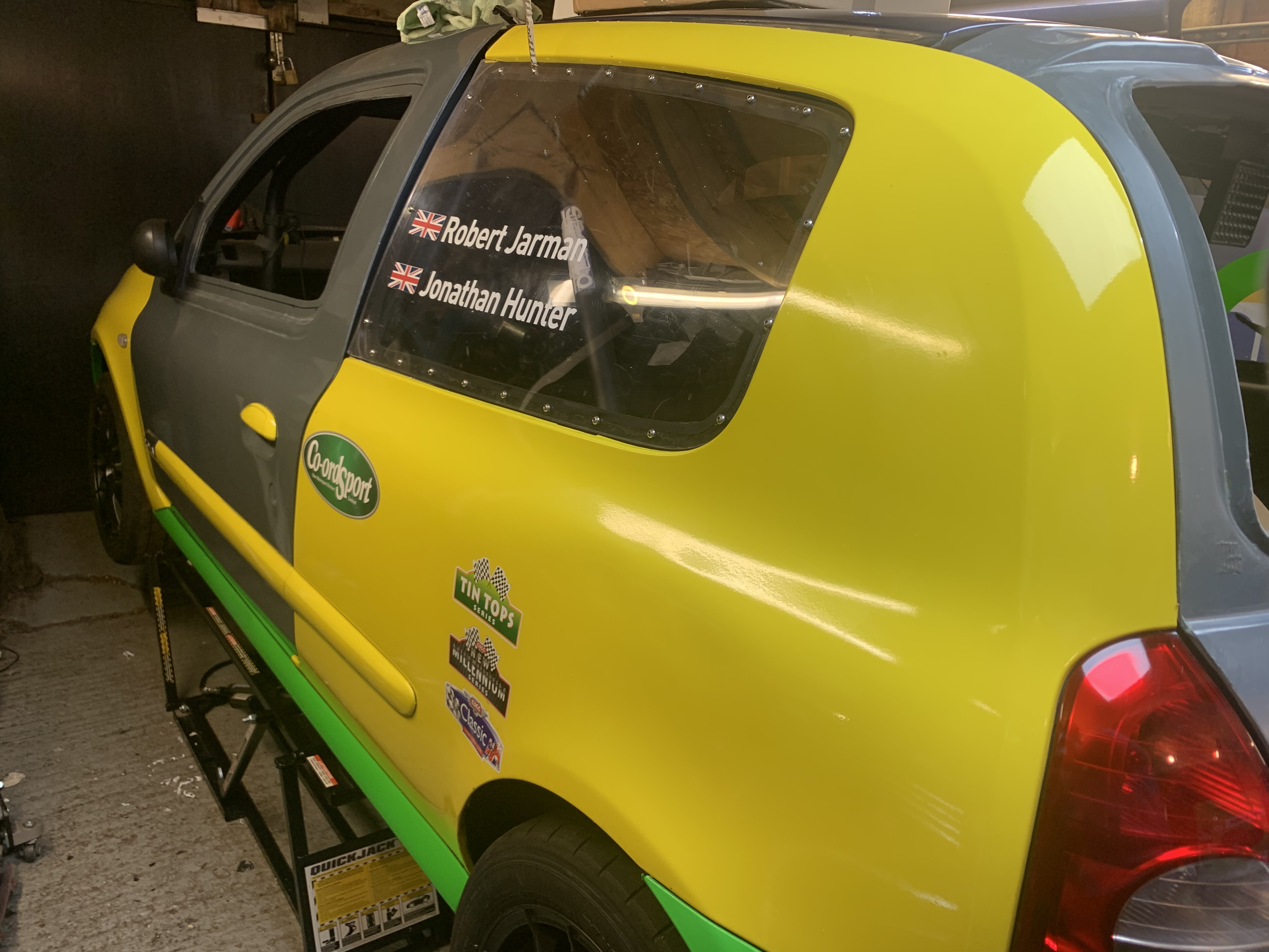

Well, after a couple of late nights she's about ready.
The screen went in yesterday evening and then it was just a case of fitting the new Lexan windows to the doors and hanging them, followed by applying the new Livery.
The doors could benefit from a little more adjustment but they'll do for the weekend and I can revisit them when i have more time.

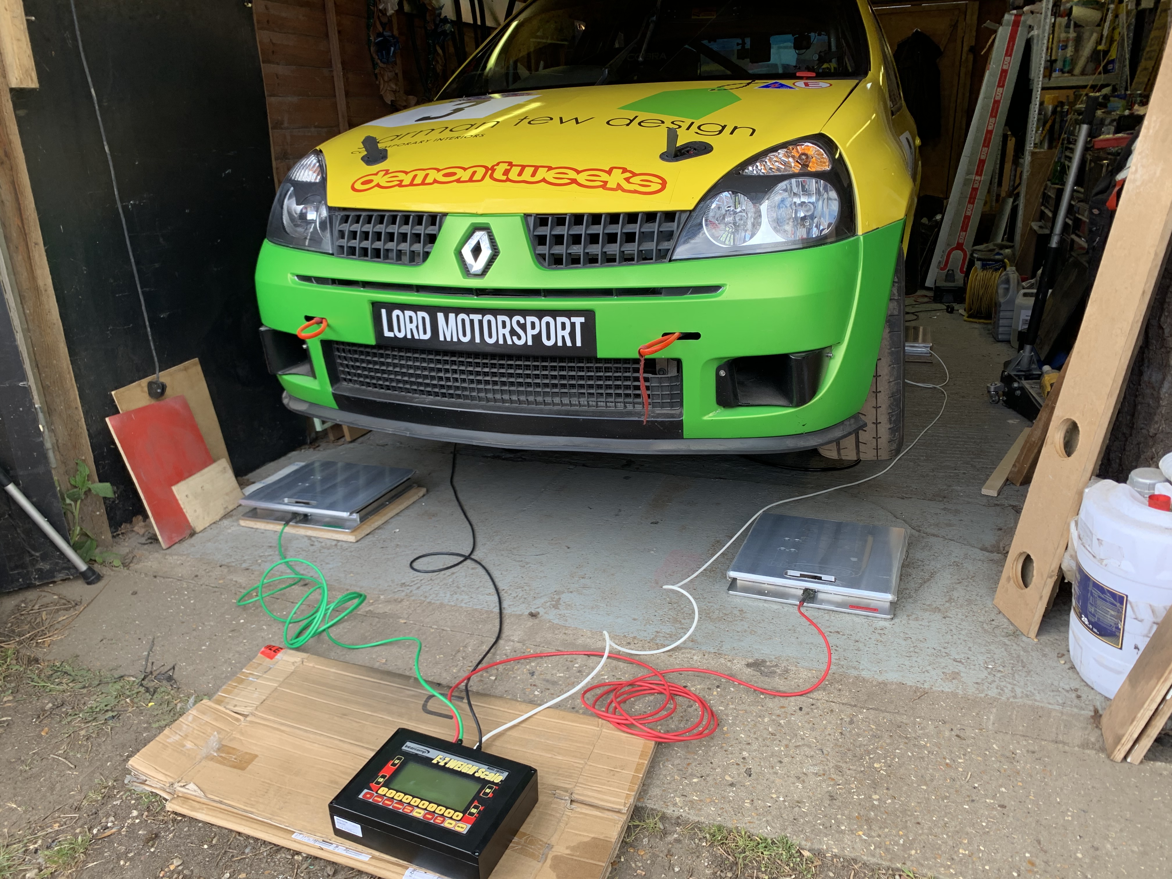

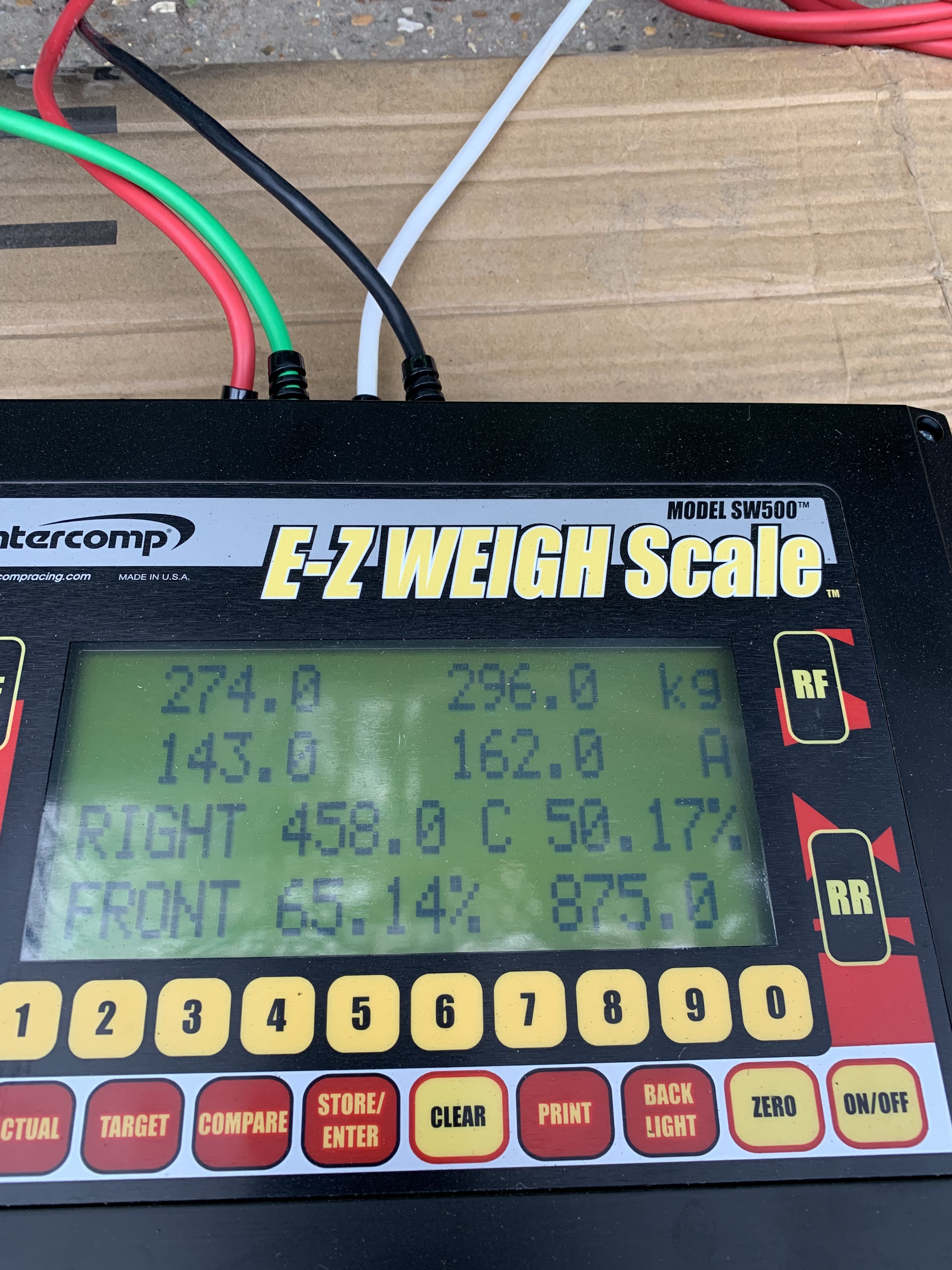

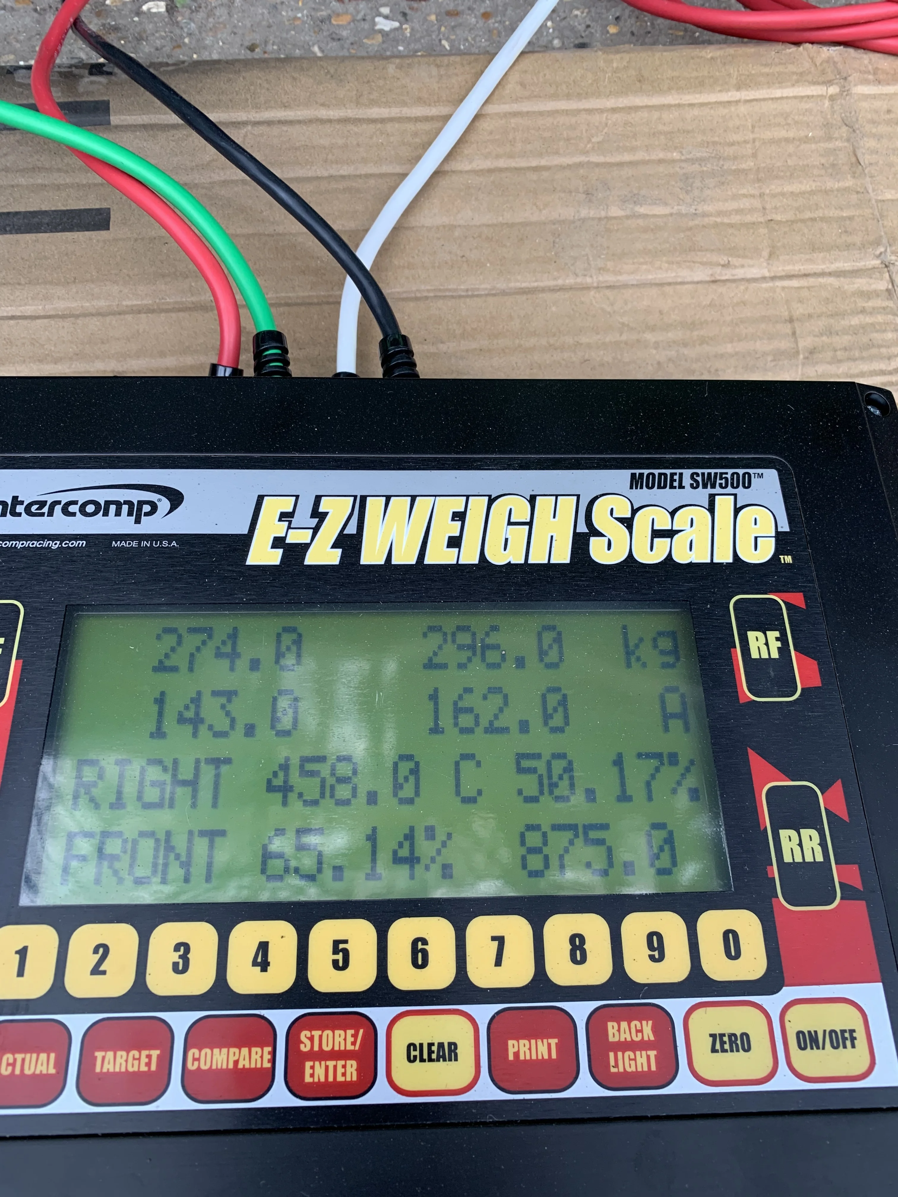

After that it was time for the weigh in!
I recon there's about 30ltrs of fuel in the tank after the 7 laps of Combe last year, which equates to about 23.5kg.
So all in all a dry weight of about 850kg which I'm happy with.

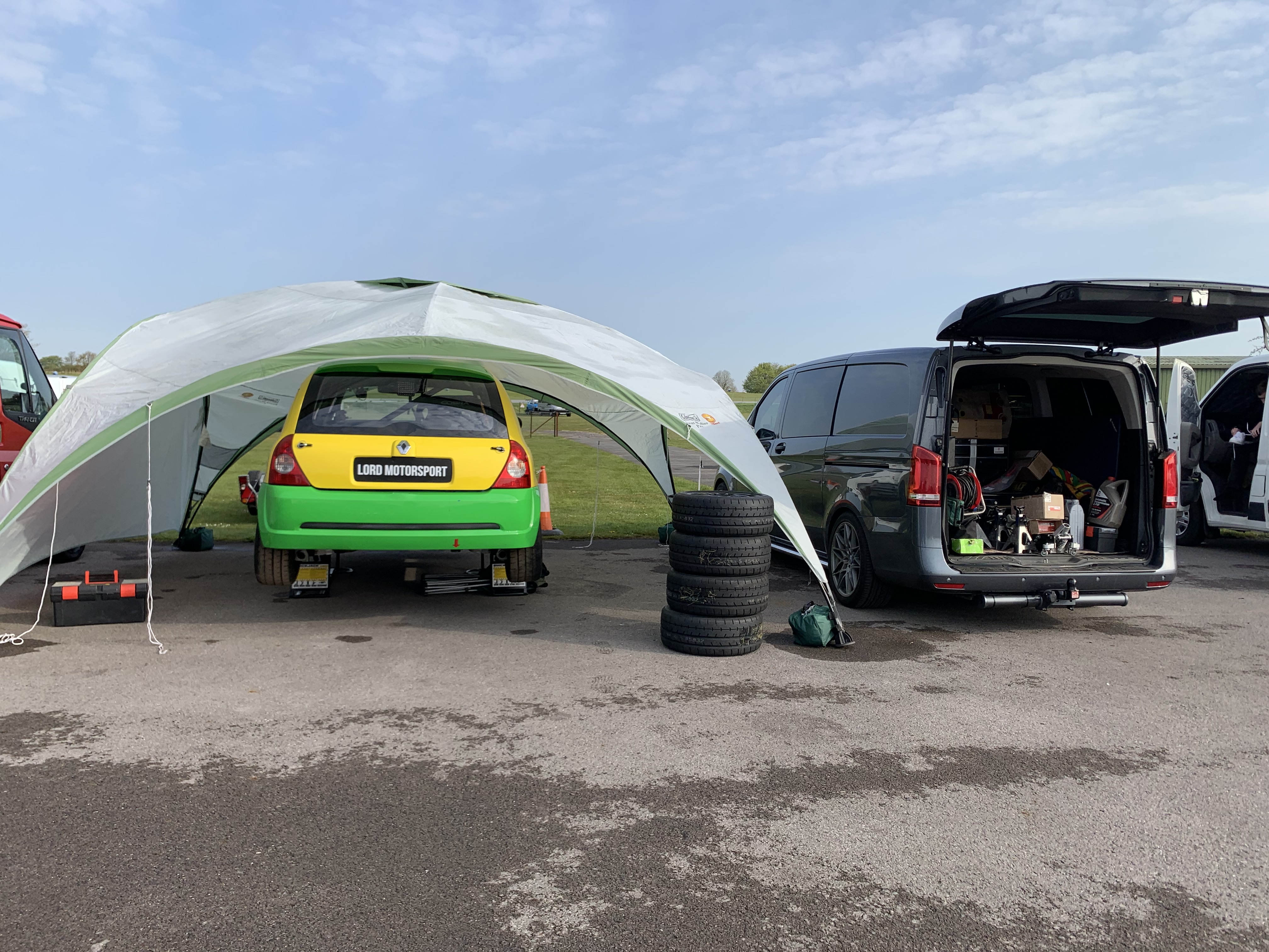

Towards the end of the day the paddock began to thin out as the day's racing came to an end so I staked a claim in the designated Tin Top area for Sunday and set about setting up.
Just minutes after I had the car under the gazebo the mother of all hail storms hit and I began to pray that this wasn't a sign of weather to come tomorrow.
all set up. Quick Jack earning it's keep

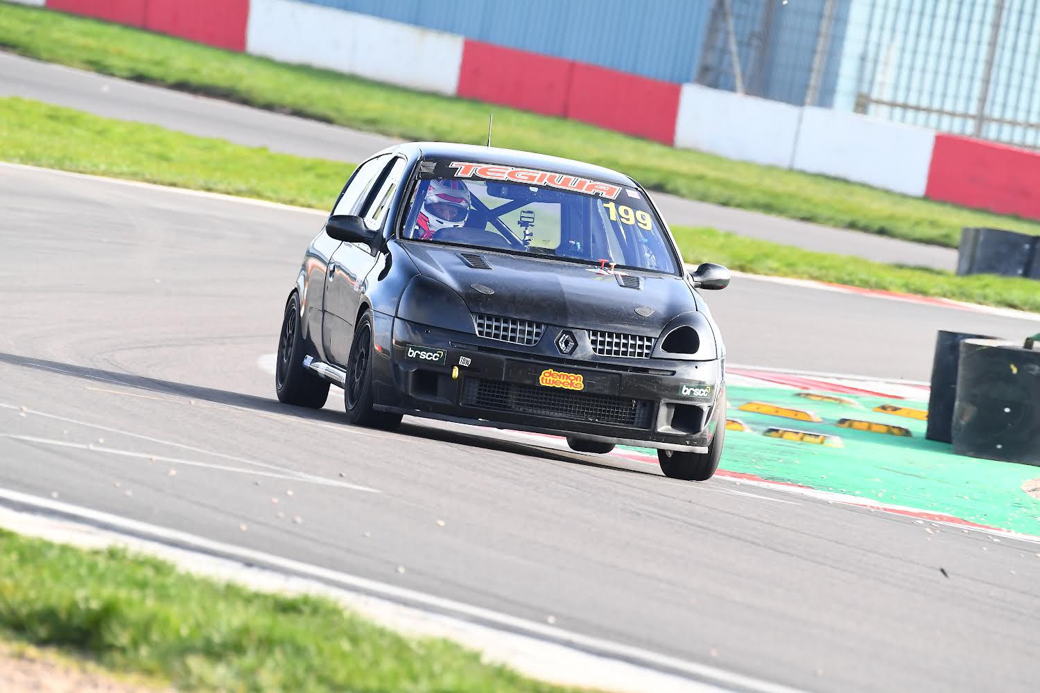

2019 was the last time I raced here so it took a couple of laps to start settling in begin turning up the wick. The car felt great and I could tell there was plenty of potential that I was still to find. Sadly after 10 minutes a safety car was deployed for a stranded car so I opted to pit and let Jon out to complete qualifying. He had never raced at Thruxton before and as he's a paying driver I needed to let him have as much time as possible.
We had already decided that after last season, the aim was to get to the end of the race and not worry about position but of course we are both racers... And fortunately for me Jon is a talented driver despite having far less experience than me. He set our fastest time and put us P6 on the grid of 27 cars. We were happy with that!
It is clear that the car is much more lively with the weight loss and an absolute joy to drive on the limit. For Thruxton though you really need a whole bottle of Brave Pills to get the most out of it and clearly Jon was half way through his bottle already!
Interestingly, in a demonstration of the constant march of progress in racing, my P5 qualifying position in 2019 was a whole second off our P6 time this year!
Anyway, we spent most of the afternoon feeling quietly confident and maybe a little smug that we had nothing to do to the car other than top up fuel, reduce tyre pressures, (fronts were 34psi and rears at 32 after quali) and carry out a precautionary bleed of the brakes (which were awesome by the way). All was calm in Camp Lord Motorsport. Until we were called to the assembly area before the race at 4pm.

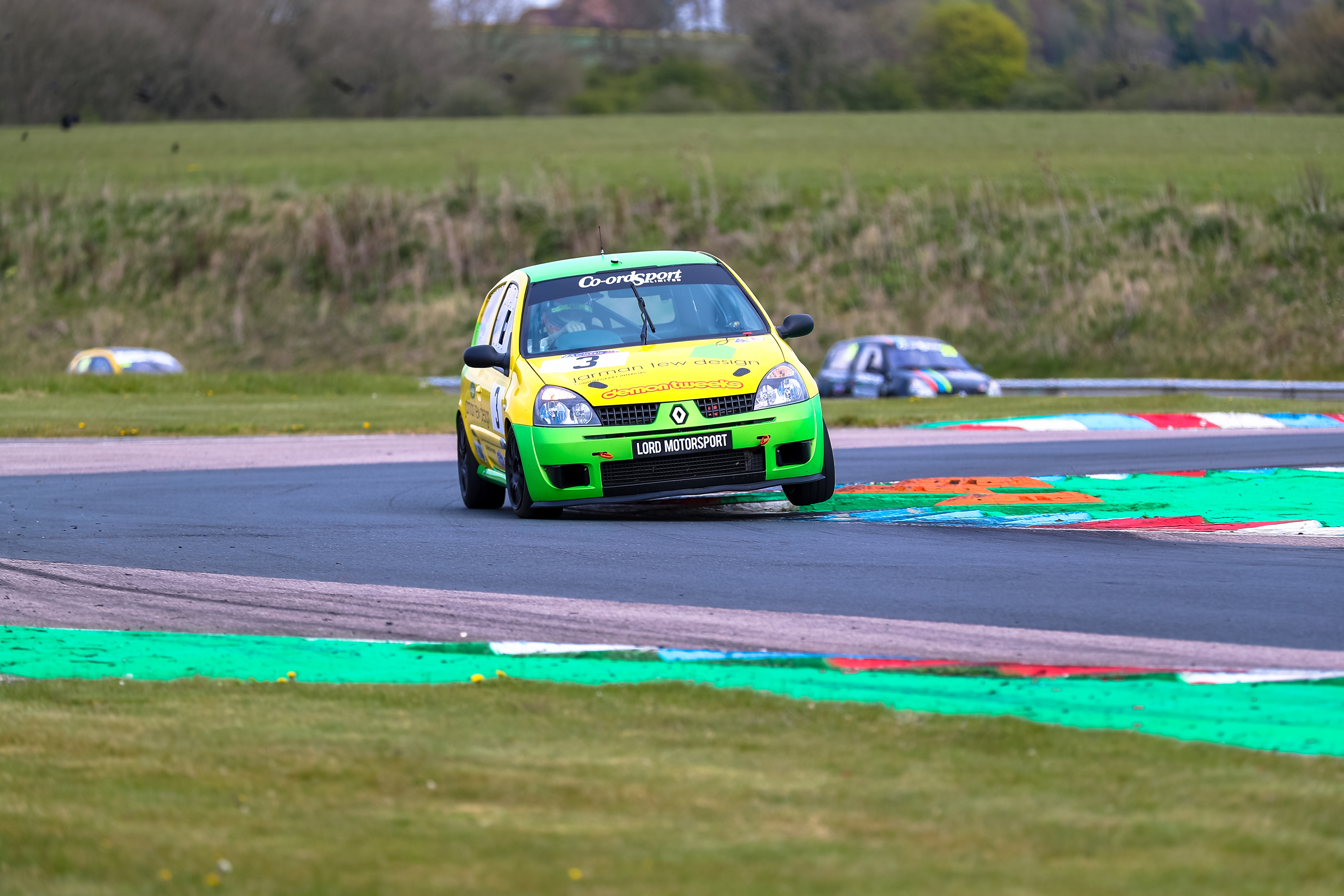

I reached the grid and before long the red lights came on. And then off very quickly and of course I lit up the tyres getting mugged by 4 or 5 cars into the 1st corner.
It's been a while since I've started a race right in the middle of the pack and I was quickly reminded that it gets the juices flowing very quickly!
I managed to keep it clean through the complex, passing a couple of cars before heading out onto the back part of the circuit where the speeds build quickly. On lap 1 this is where the drama happens when tyres are cold and blood is hot. But again all went well and continued the chase to recover my position.

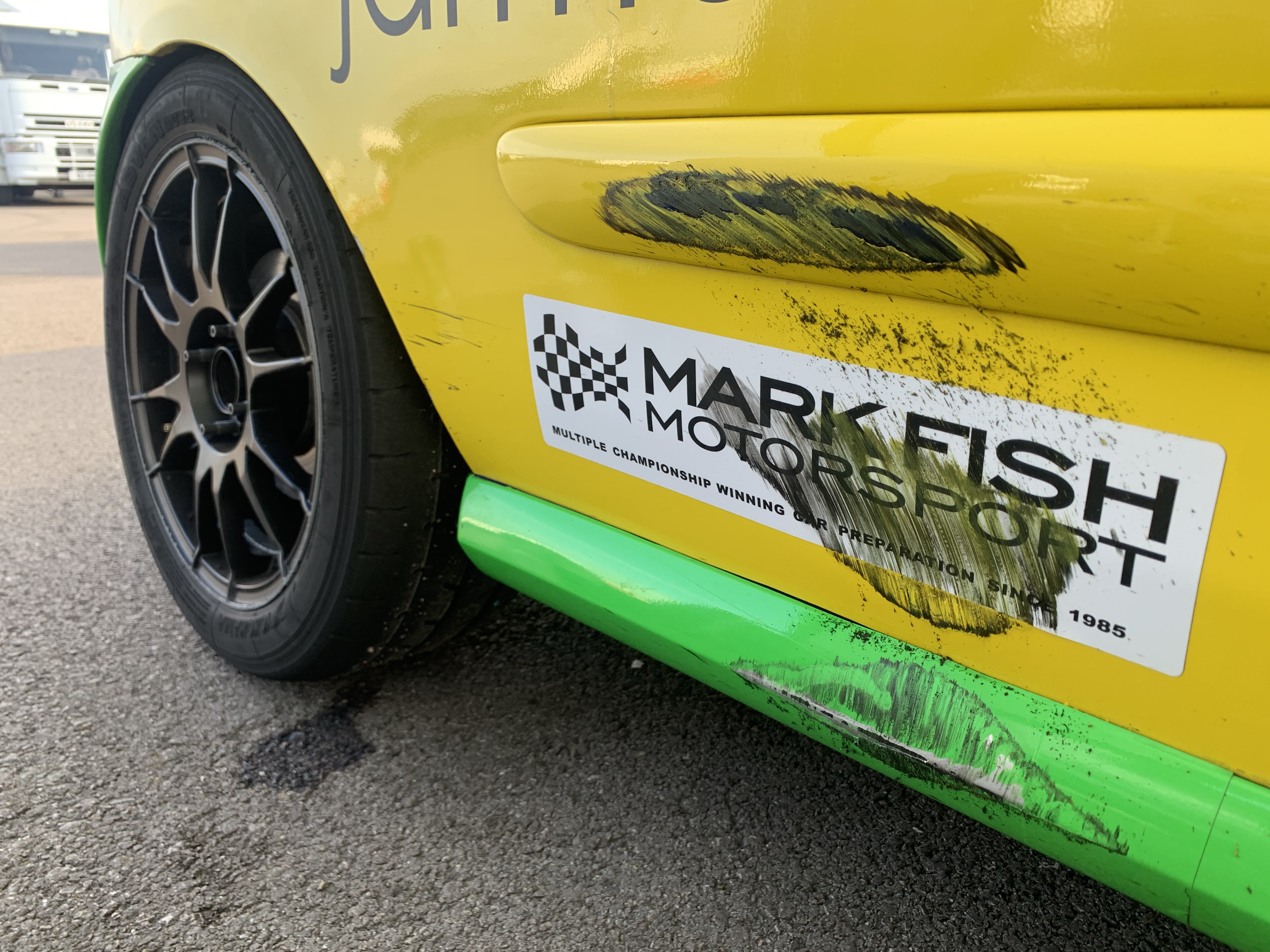

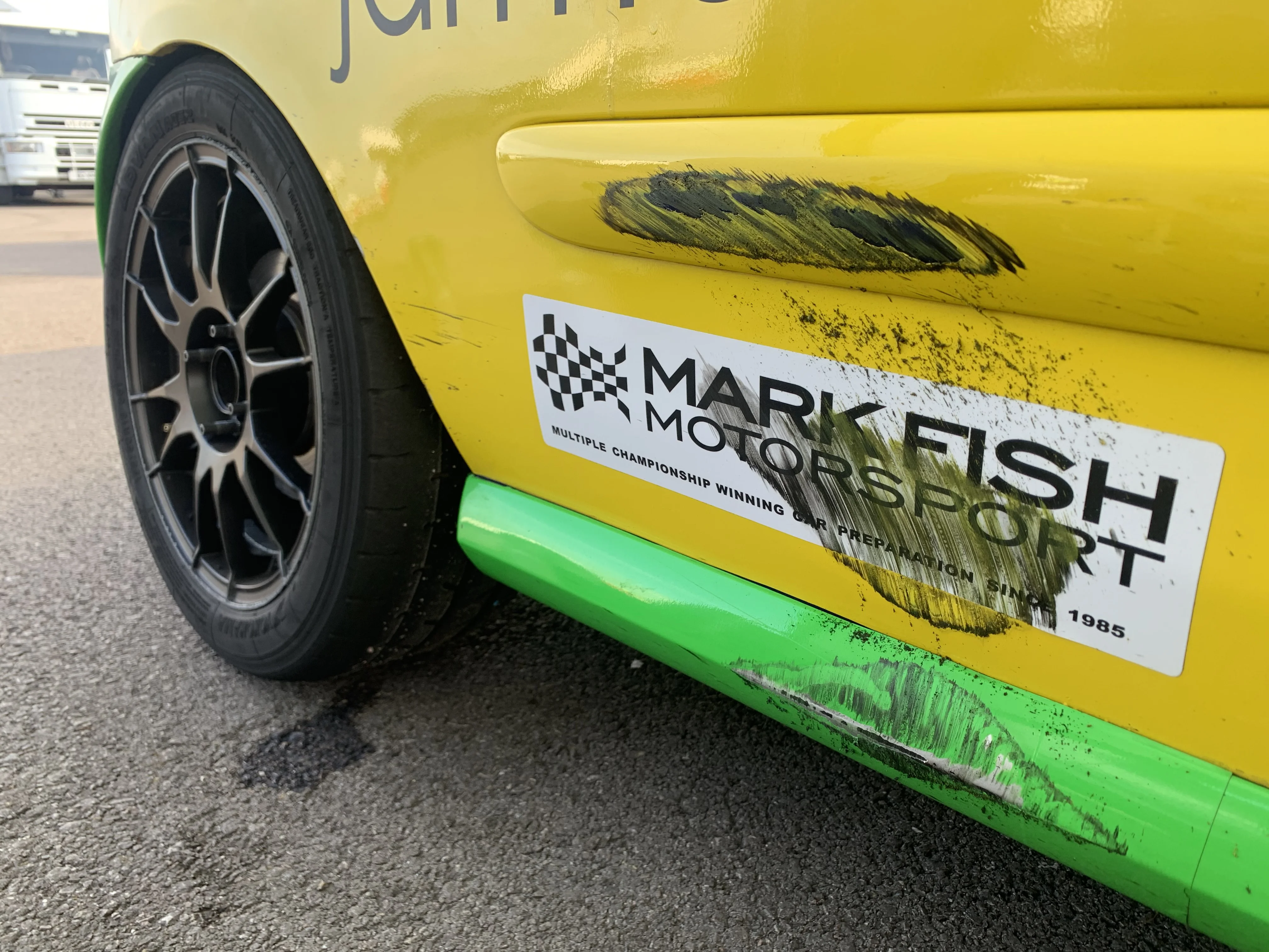

So, some damage to repair to add to the list before Brands on the 22nd but nothing major. Just how I like a weekend's racing to end.

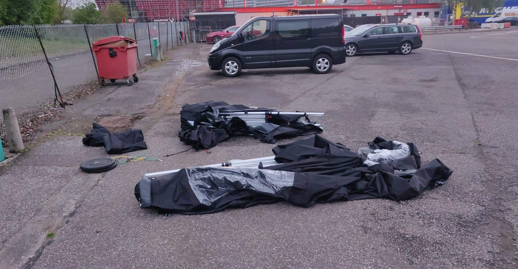

At 5pm that day I received some photos from a racing colleague of our gazebo looking less than secure in the increasingly gusty conditions and by 9pm he and several members of one of the larger F3 teams had held it down to the ground to stop it heading up to Druids and subsequently decided to dismantle it to save it for us.
So that plan didn't work.

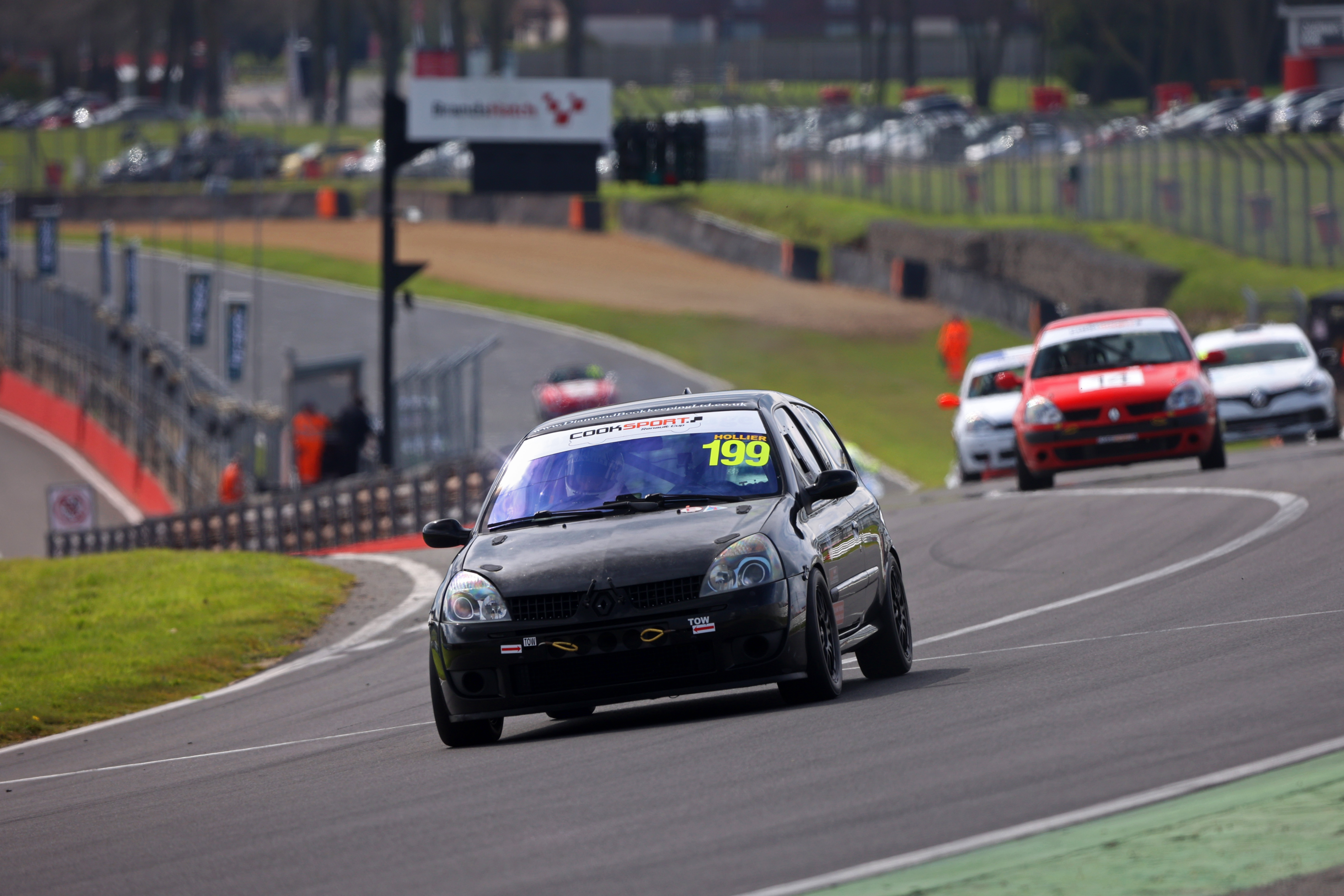

I've only driven Brands GP once on a track day about 7 or 8 years ago so it was going to be interesting. Although of course, probably the majority of the grid hadn't driven it before or had limited experience like me.
There is also a shortage of Youtube footage to watch other than BTCC cars or motorbikes. So not much to go on.
I went first into qualifying and tried to get up to speed as quickly as possible to find the limits of the car (and myself) and start setting some quick times. With only 30 minutes for qualifying, (15 minutes each) it goes very quickly and if a safety car comes out or it rains suddenly an early lap time can pay dividends.
I was running in P3 when the safety car was deployed and we decided to swap over while it was out.
John went out with 10 minutes left and luckily within 1 lap the safety car came back in.
As people got comfortable and inevitably quicker we dropped down to P10 as John tried to get to grips with the track. Then as the clock ticked down to zero he managed to hook up behind the Simpson and Simpson Peugeot 306 who are always quick and on the last lap popped us into 4th right behind the Pug!

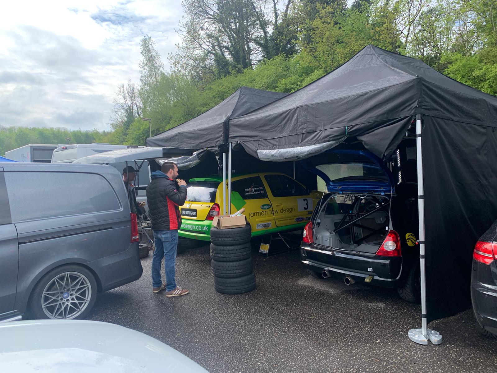

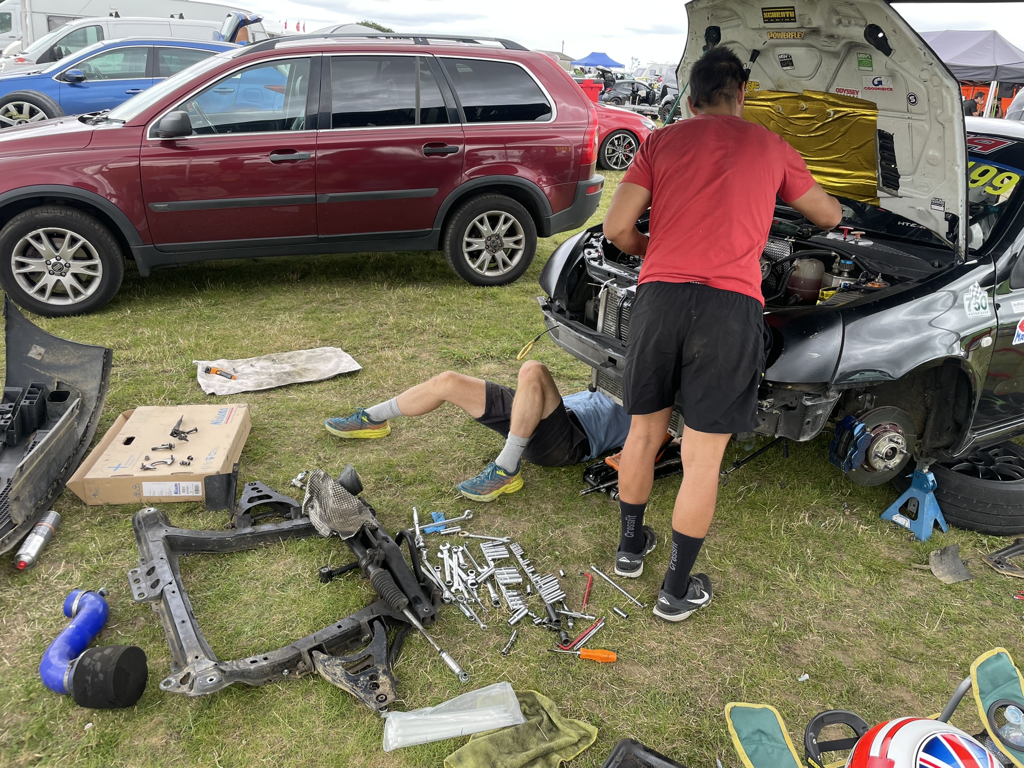

I should add here that @Rob Quantrell and his race partner John who we were sharing the gazebo with were having a very different day to us.

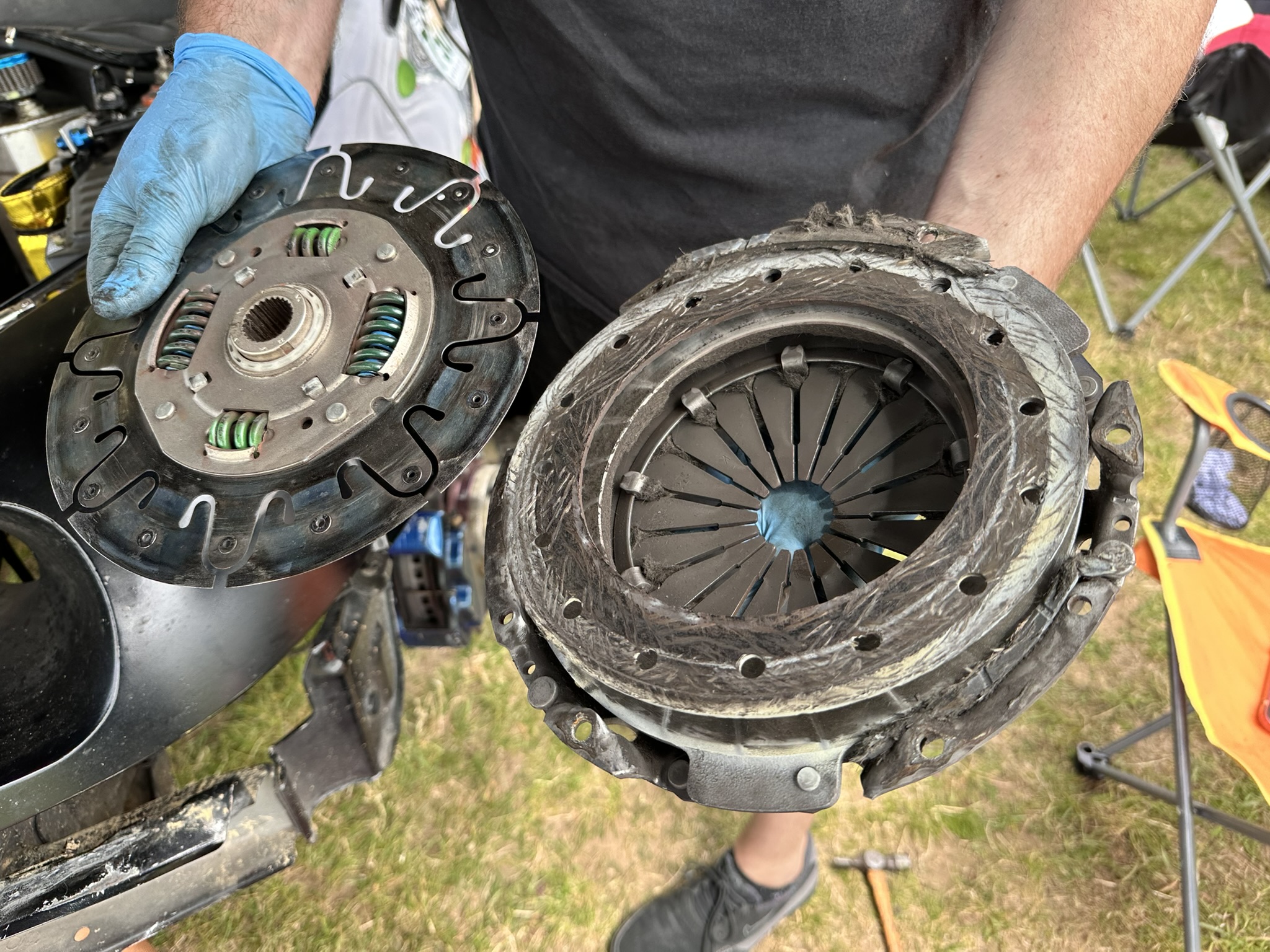

Their Clio decided to drop on to 3 cylinders on the way to qualifying and the decided to die completely. As a result they didn't get out for qualifying and instead set about finding the problem.
This was tracked down to a failed alternator which, thanks to the great club that we race with was replaced by @Russ Rallye's spare.
Once all up and running the organisers allowed them to do their mandatory 3 laps each behind the safety car during the lunch break. So they were to get a race from the back of the grid which would be fun!

However, a strange noise from the gearbox didn't bode well as we went into qualifying and sure enough 2 laps into my stint after taking over fromRob the clutch failed. However I had managed 1 hot lap that put us 3rd in class on the grid.
Rob was about to throw in the towel but I persuaded him that a clutch change was worth a try as we had about 3 hours before the race. So, John, our trusty pit b**ch headed into Norwich to buy a clutch kit while Rob and I began to remove the gearbox.
And as we were called into the assembly area we got the car back on the ground and headed out. No lunch that day!
