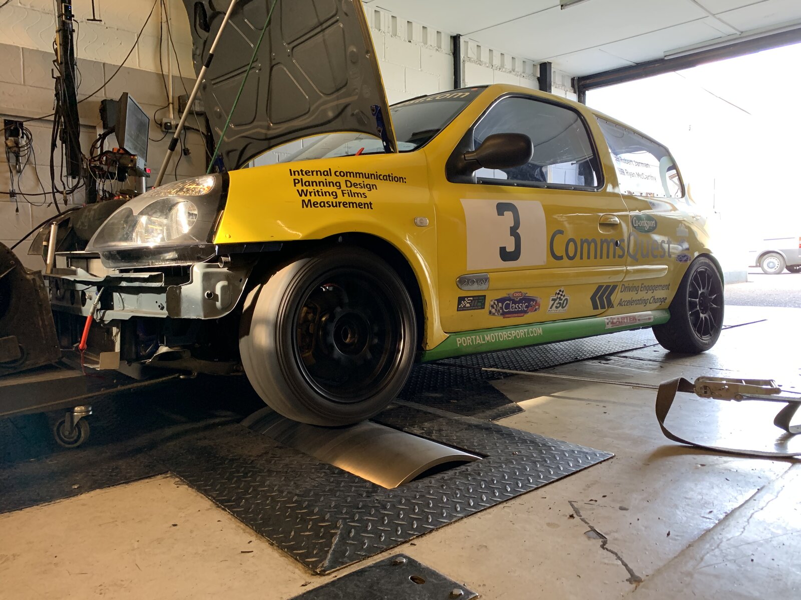

It’s running and on the dyno as I type this!
Very happy with progress today.
Collected another new starter this morning. Fitted it and all good. The car was starting but didn't seem very happy with the existing map. Some adjustment to the throttle position sensor helped it to idle but it was still tricky to keep running while moving it.

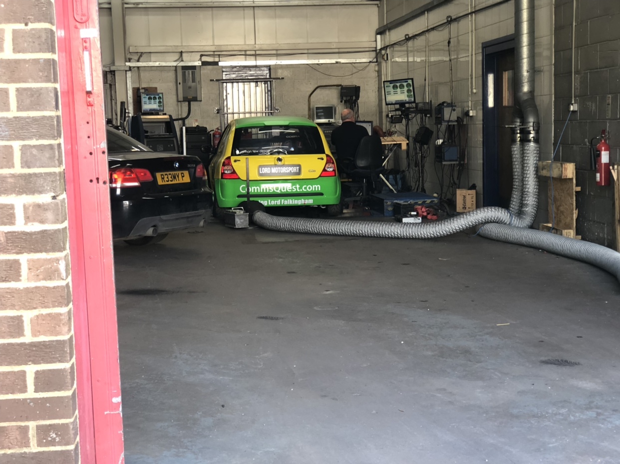

Anyway, after an hour and a half drive I finally arrived in Bletchley for the dyno work.
After an hour or so of tinkering and Steve checking through the map the car was idling much better but he was surprised how far off it seemed from the last time he has mapped it.
After a couple of hours he had built a new map for the car and began the power runs.
Quite daunting listening to the car spin up to the limiter after putting it all back together. Constantly running through your mind, "Did I torque all the head bolts properly? Did I set the timing right? Did I tension the Aux belt?" etc!
But at the end of it all Steve couldn't quite believe I hadn't done more to the engine as it appears to have found another 24bhp!
Admittedly this was a different dyno but all the same that seems a significant increase and he had to change the map quite a bit to get there.
I guess the proof of the pudding will be at the weekend.
Finally looking forward to it!

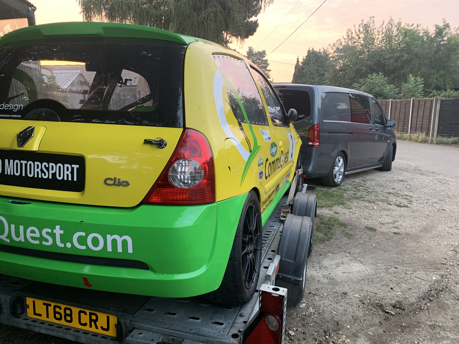

On this occasion I was taking the family away with me for the weekend as this was a Bank Holiday weekend and our race was on the Monday. Oulton Park was holding a Family Fun Day on the Sunday, splitting the 2 days of racing that the CSCC were holding.
So, we drove up Saturday afternoon and arrived at Oulton late afternoon, in time to slot the car into one of the garages as the day's racing came to a close and people went home. It could stay there all day Sunday and be ready for us Monday morning.
Once we dropped the car and the trailer off we headed to a lovely little cottage that I had rented for the weekend about 20 minutes away. So far the family were happy so I was too!

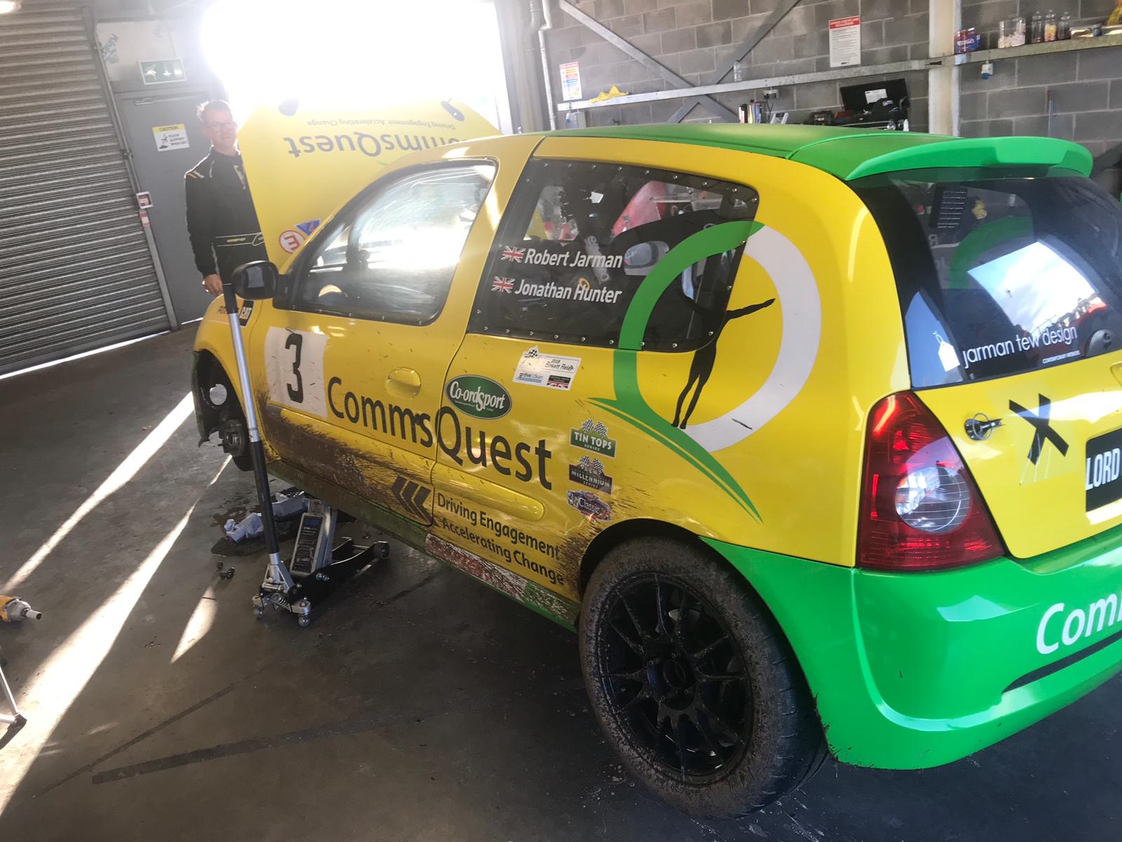

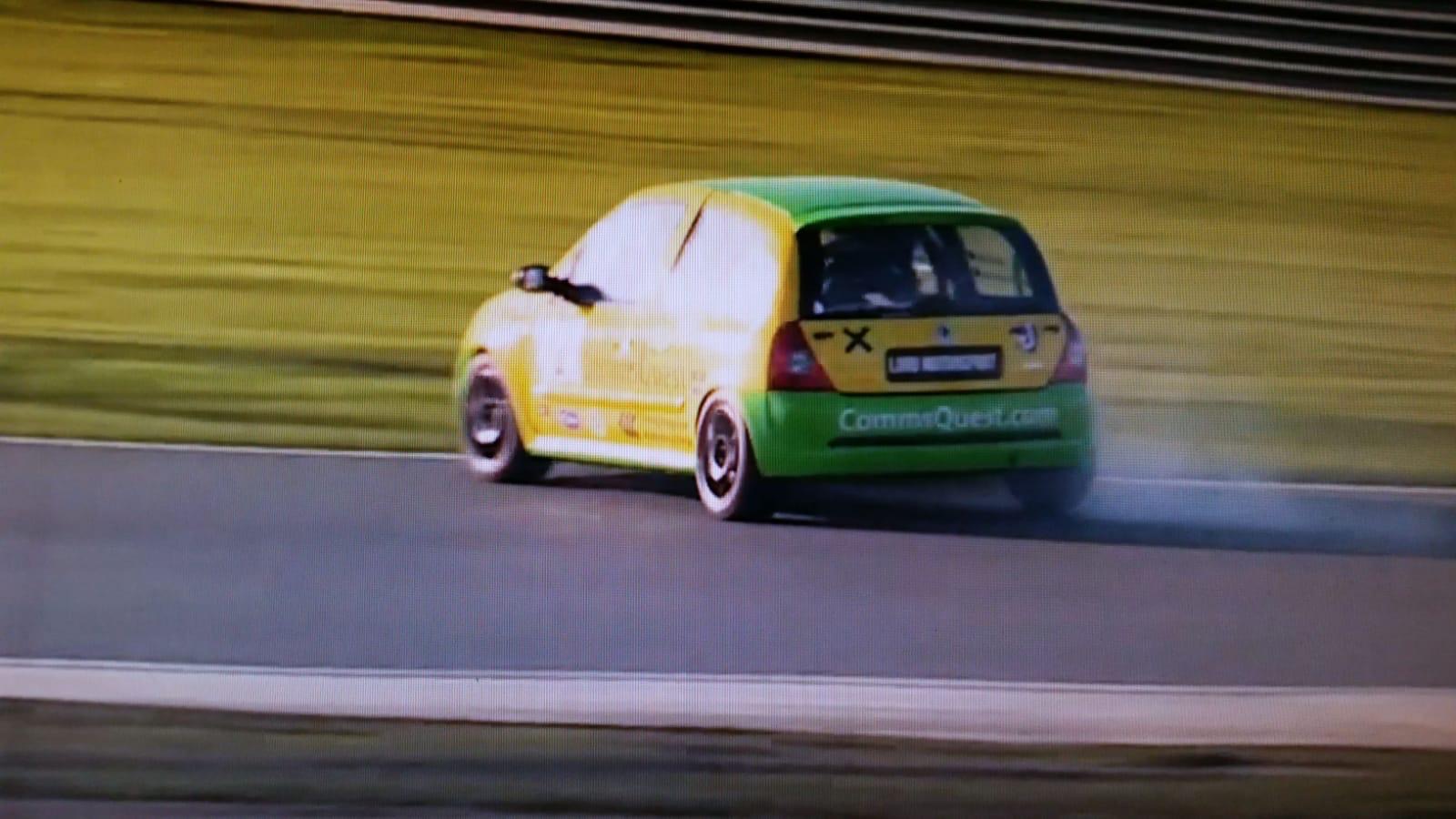

But as I stopped in the pits smoke bellowed out of the bonnet. Upon opening it we discovered the oil filler cap had come off and oil had sprayed everywhere!
We spent 5 minutes cleaning as much as we could off and trying to find something to cover the filler cap with. A latex glove and a cable tie did the trick!

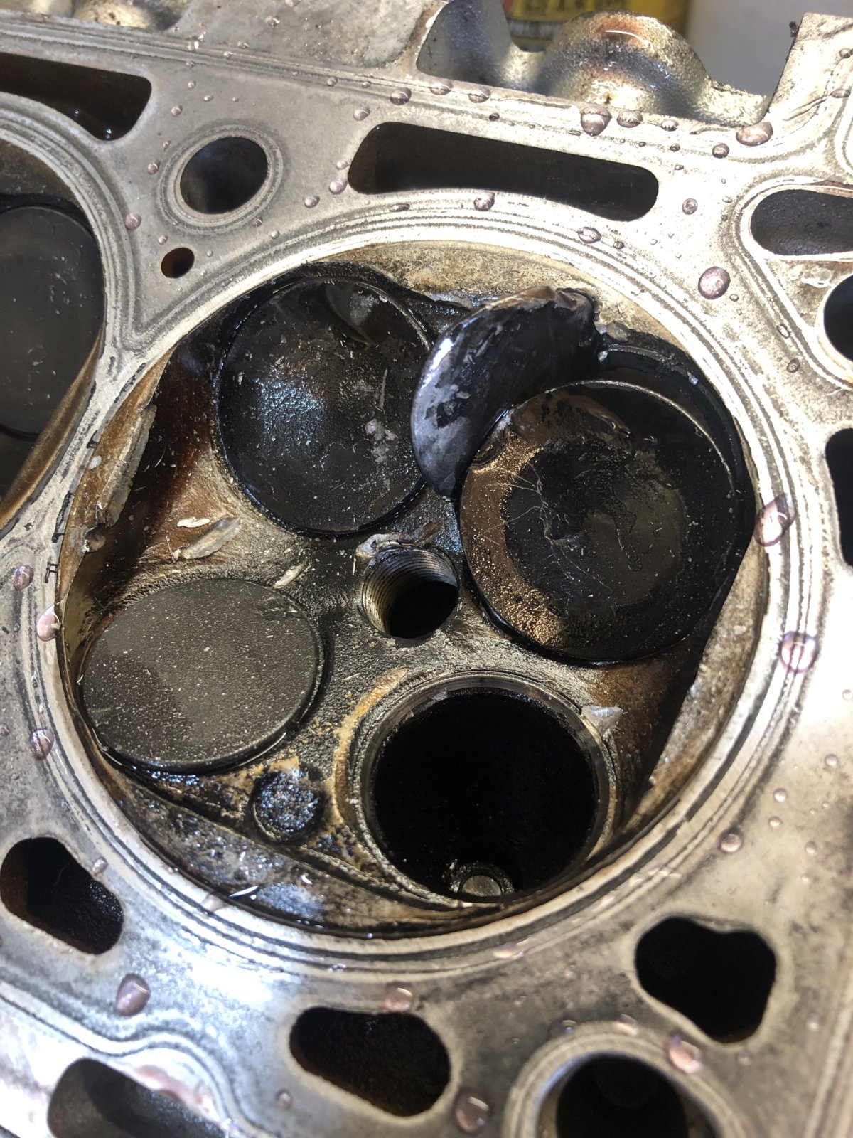

The engine had died with what sounded like valve failure and Paul had killed the engine as soon as it happened.

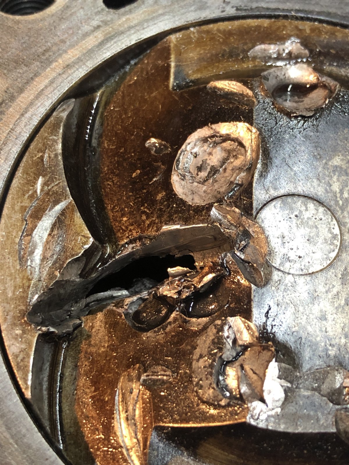

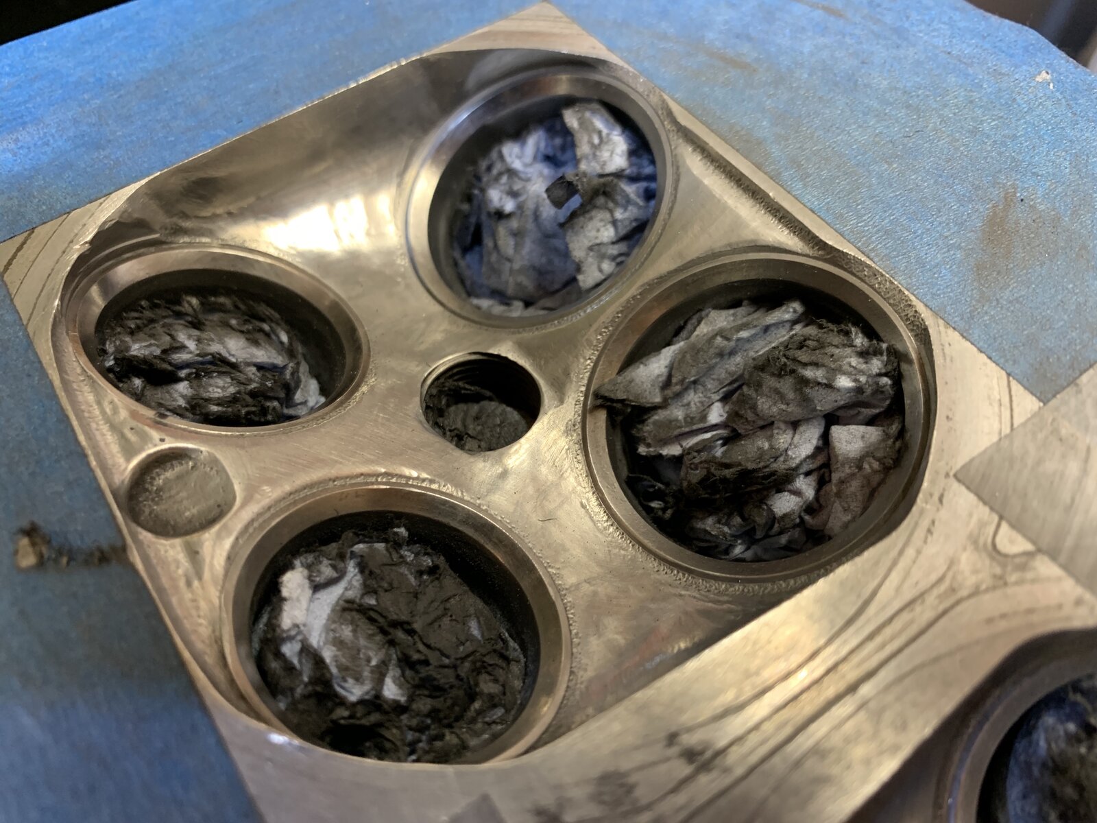

Back at home the following day this is what I found
There doesn't appear to be any real reason why a valve snapped. Watching the video back and examining the rev telltale on the ECU doesn't reveal an over rev at all. None of the other valves or pistons are showing signs of touching and the lifters all seem to be good. I suppose we will never know but what I do know is that I need some new pistons and yet again the engine is out of the car! Fortunately I have a spare cylinder head which has now been stripped ready to go to be cleaned and the battle is on yet again to get it ready for the next race at Anglesey.
Here's the on board footage if you have a spare 20 minutes or so.
The supertechs are still only a friction welded valve. It’s just higher up where they make the join when compared to the original Renault valves, so this could be a reason why they’ve failed.
What valve springs are you running? If the seat pressures are too high, that won’t help.
I'm running Supertech springs as well but not the double ones. I sent them down to Nick at PMS to measure and supply me with the correct shims for them.
first time i've heard of one fail. i'd be looking for something that caused them to go, as mark said.
Believe me I have! It's a bit of a head scratcher. The only thing I can think of is that the lifter stuck momentarily. Either that or it was a rogue valve that fatigued over time.
Although the rev limit was only 7800 I think I'm going to lower it slightly now. Not that that will help with a mechanical over rev but I can't really think of anything else and I definitely don't want to go to solid lifters.

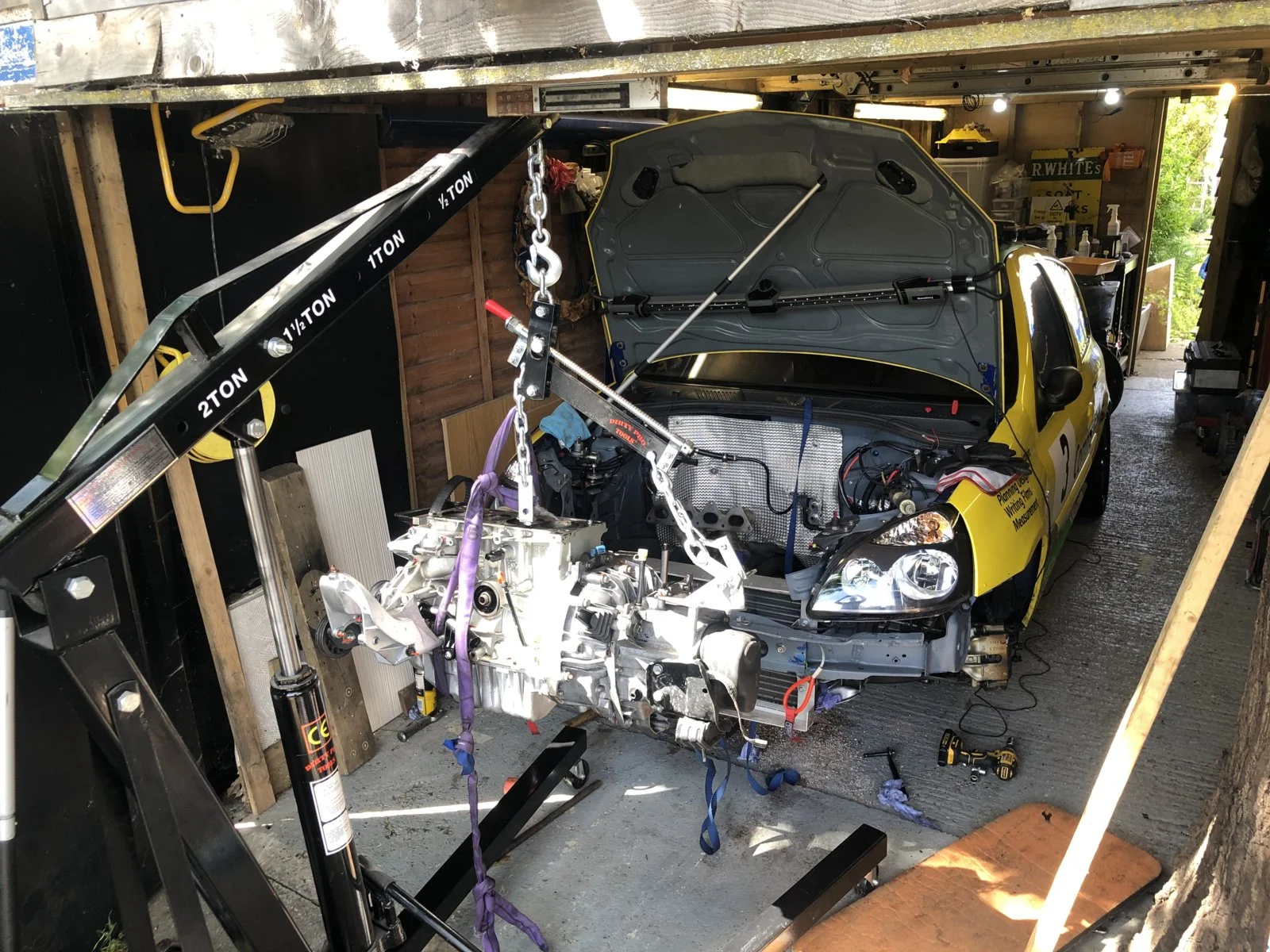

The last few weeks has been a combination of saving funds for the rebuild and the waiting for pistons to arrive from the states.
Last week I was away with the family on holiday but before I left the pistons arrived and I had time to brief Thurston Engineering before I left.
The new pistons are made by JE and come highly recommended by Nick at Pure Motorsport.
As one of the rods had also twisted by a thou during the failure I managed to source 2 being sold used on Ebay which I got for £50. Worth a punt as a complete new set is £500! Fortunately one was good!
While I was away I received regular updates from Thurston, mainly to tell me to order something or give me news about more work that was required on the engine!

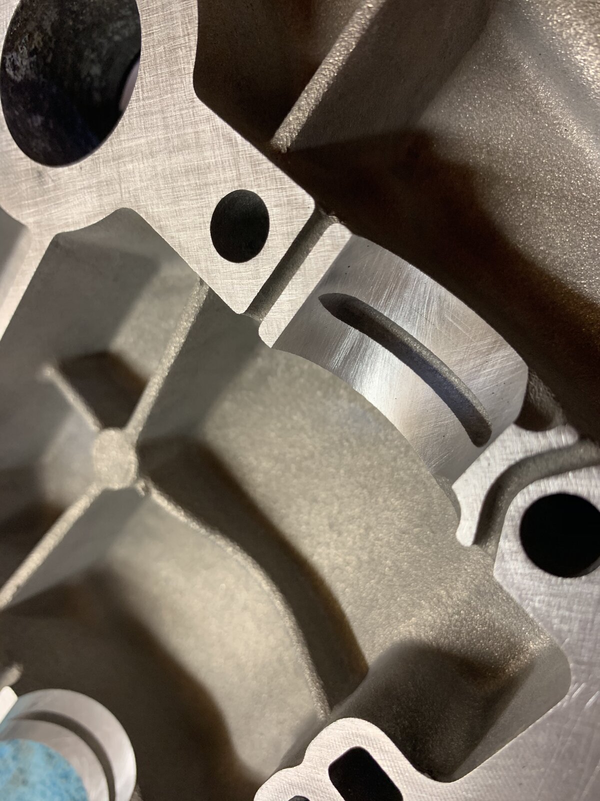

It seems the centre main bearing was a little loose so the block needed to be worked to sort that out and then line bored again. Having been done twice now this block really is at the end of its life so I need to start looking around for a donor engine to prepare.
As is always the way, with my next race at Brands Hatch next Sunday (25th August) and having just got back from holiday things are going to be tight!
The bottom end should be ready for me to collect Monday afternoon as the balancer couldn't do anything until the weekend and the dyno is booked for Thursday afternoon. Up until this morning I still had a new head to prepare as well before the engine can be assembled, so that is what I have been working on today.

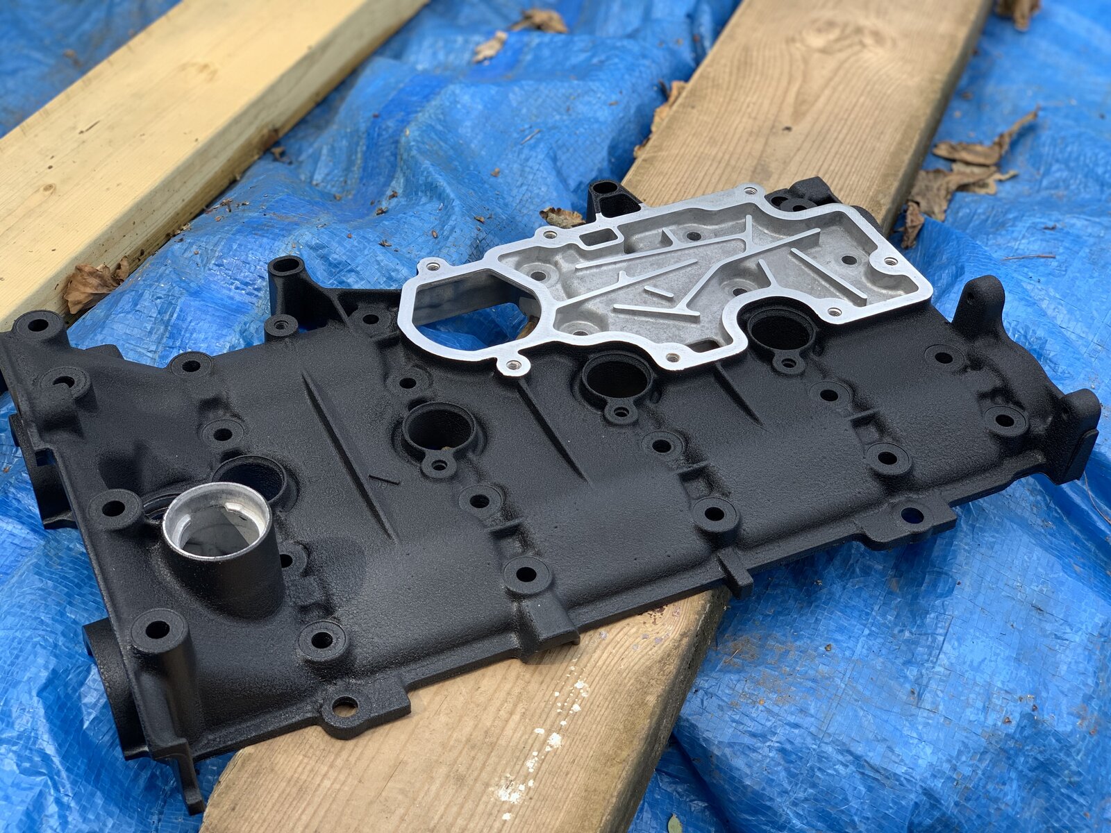

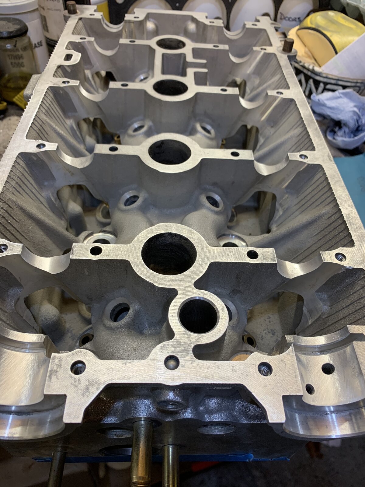

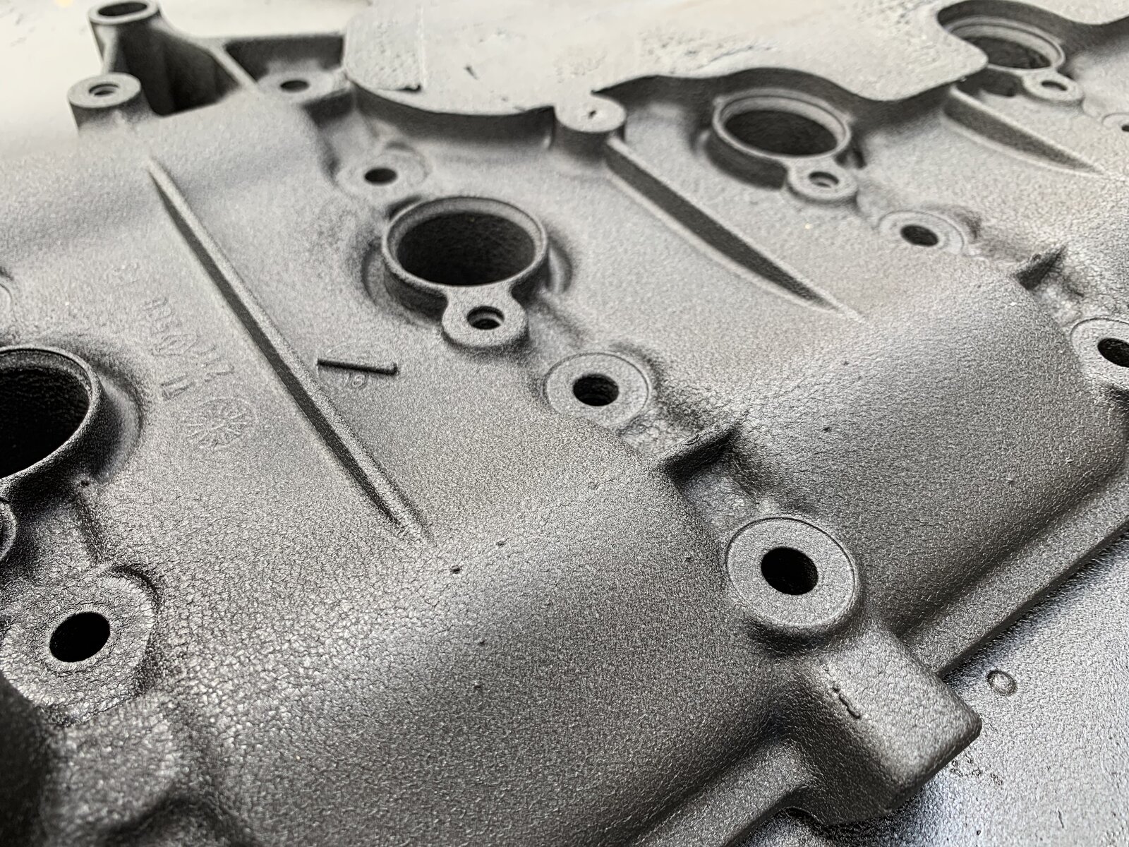

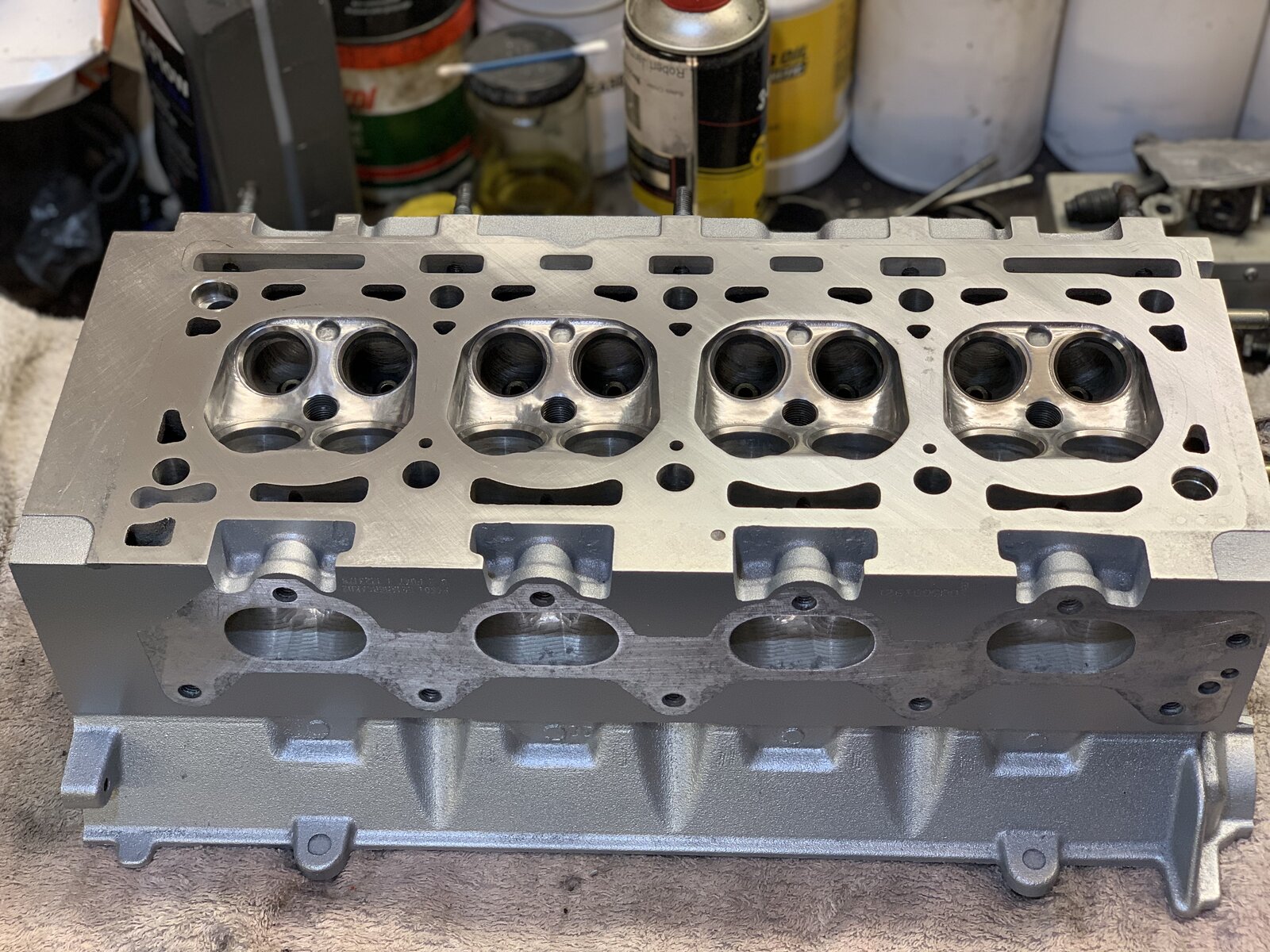

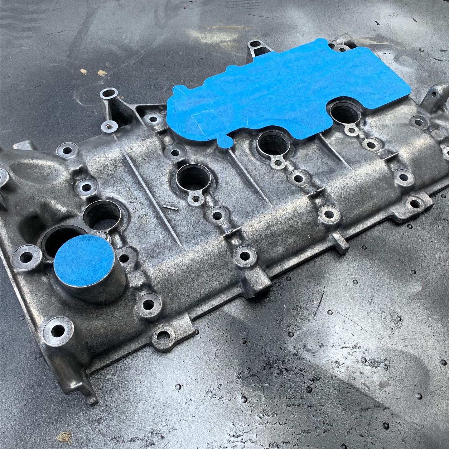

Fortunately I run a fairly standard head with no porting or gas-flowing. The only thing I did on the last head was polish the combustion chamber. As this seemed to work for me last time I have done the same again. Who knows whether it really benefits from it?
As well as this work, all the mating surfaces got cleaned and dressed, cam journals honed and head and cam cover painted. Tomorrow / Monday I will lap the valves in and assemble everything hopefully ready for when the block is finished.
A mate who races in the same series has offered to give me a hand for a couple of evenings to get the engine in the car so barring any hitches I think we could make it. No time for any testing though and my new co-driver will be going in to qualifying having never driven the car so if we do get to the race on Sunday I don't expect we'll be in the running for any silverware. But I'll be just glad to get back out on track!

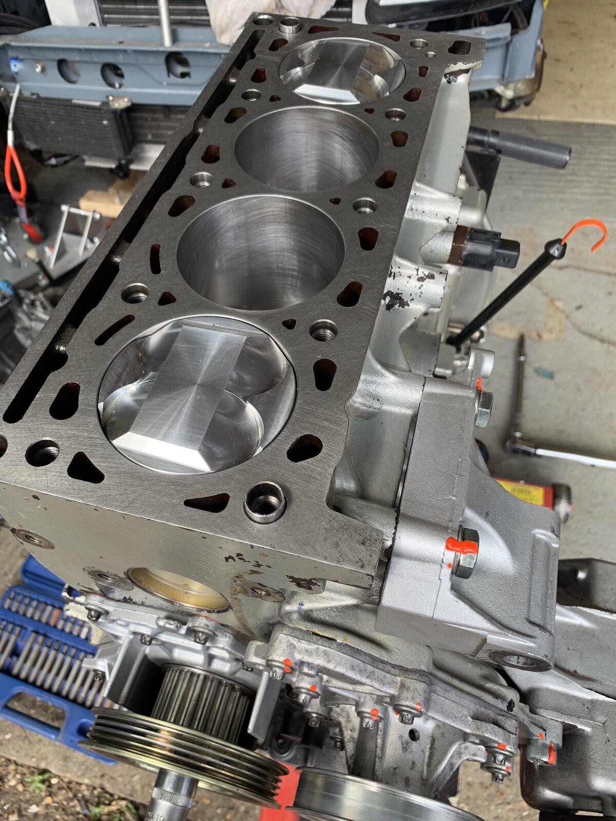

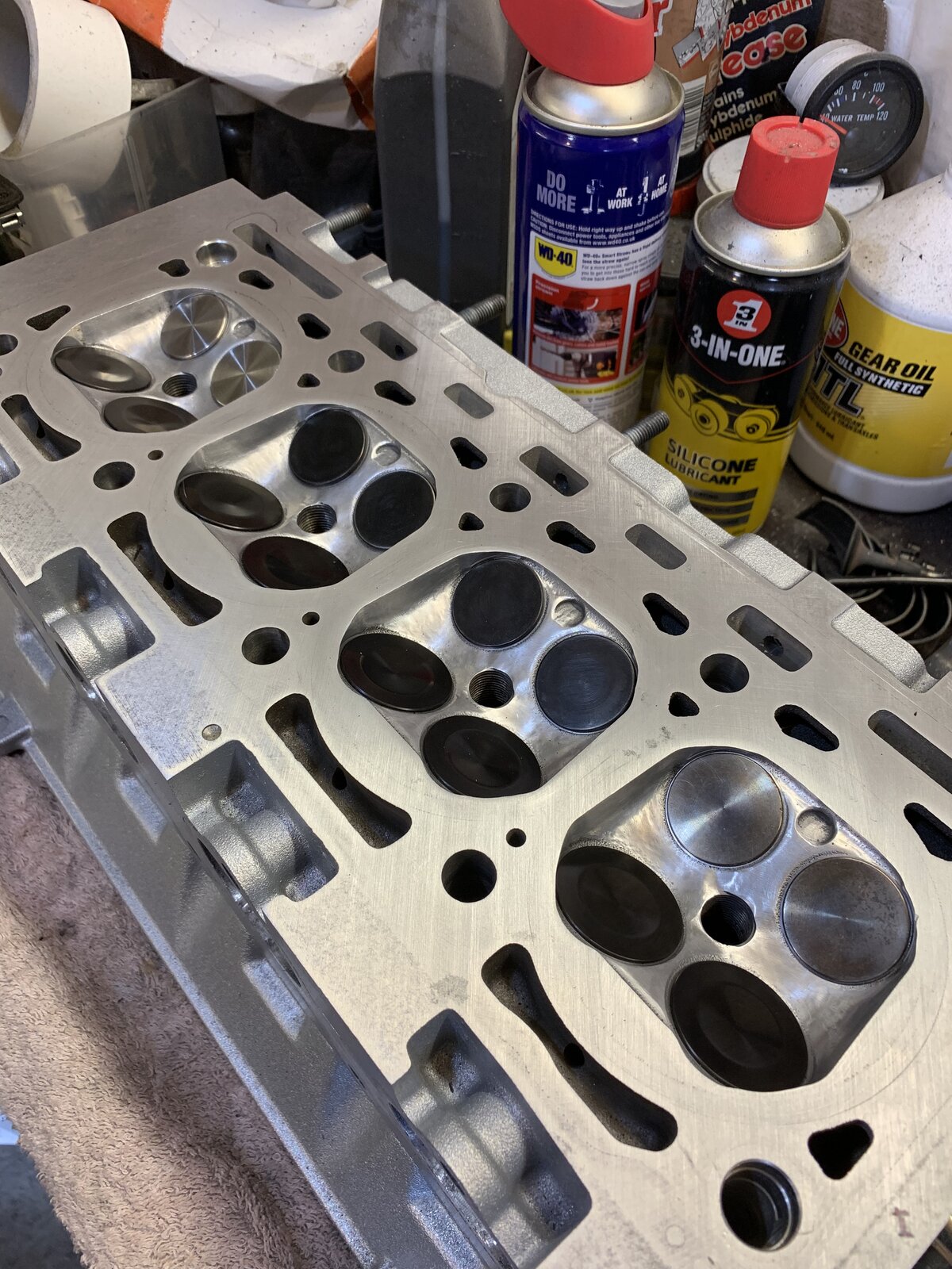

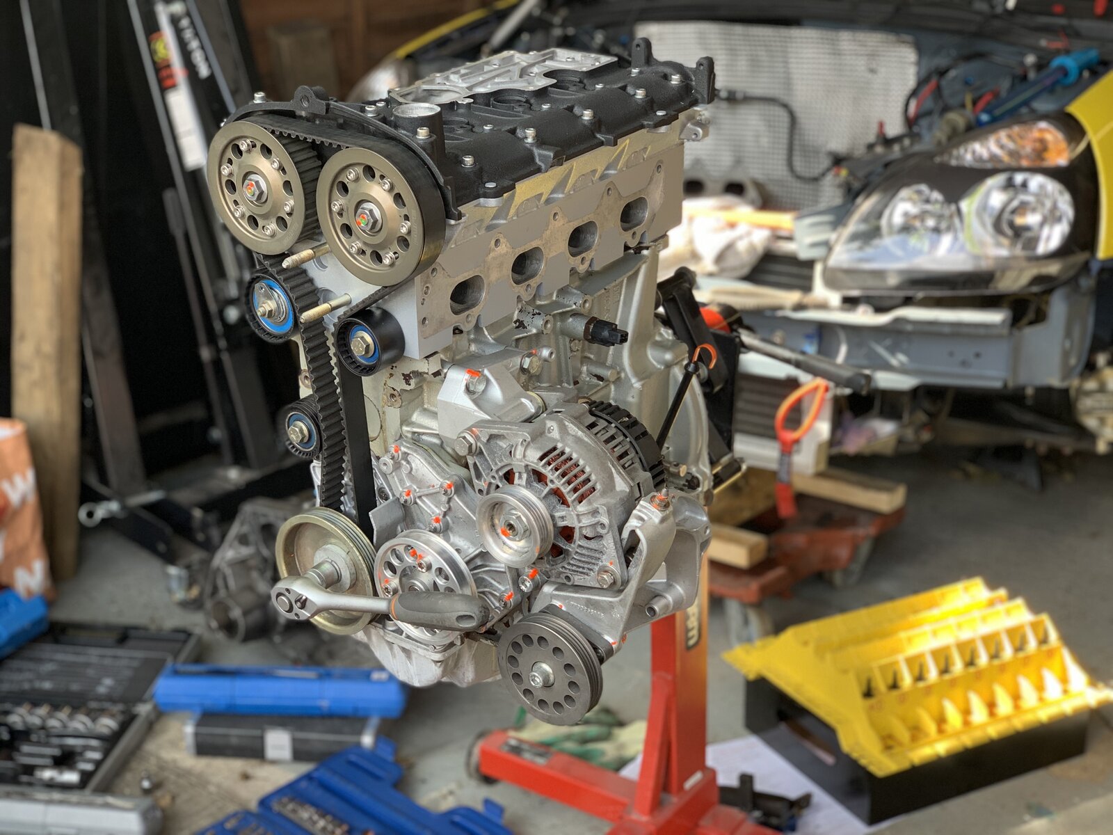

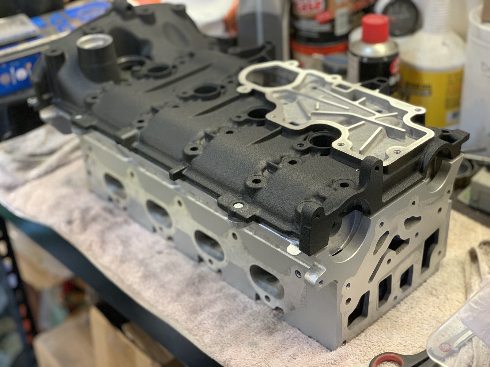

A busy week this week with the engine block having a couple of last minute issues meaning I didn't get it back until lunch time on Wednesday.
With Dyno booked for Thursday afternoon the pressure was on!

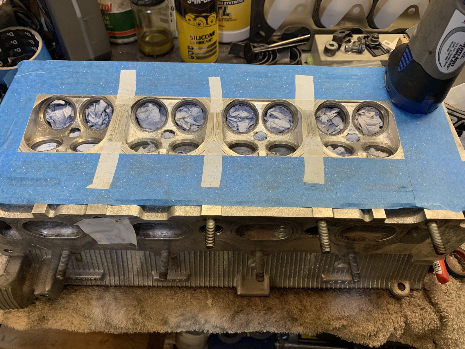

Valves lapped and installed
Block back with sexy pistons!
Firstly I assembled dry, using an old head gasket and old head bolts, timed it up and rotated it checking the valves cleared the pistons. I knew the should but couldn't afford to risk it.
After that it was stripped down again and then built back up with new bolts etc, anaerobic sealer and everything torqued properly.
By this time a mate had come over after work to lend a hand, so by 11pm when he left we had the engine in and had started connecting everything up. I continued until 1.30am leaving just the throttle bodies to fit and fluids to fill in the morning.

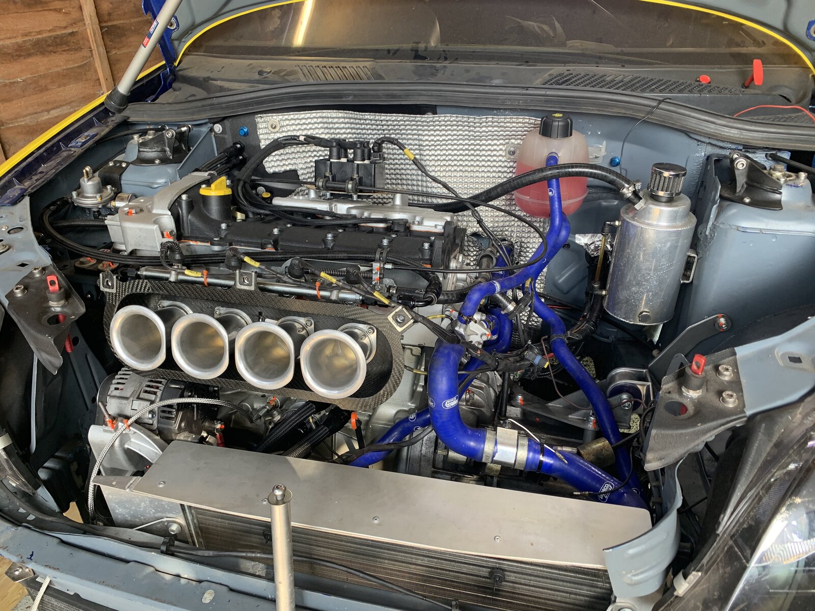

So, by lunch time on Thursday (today as I type this) the engine was ready. I turned it over for a bit with no plugs and fuel to allow oil to circulate and build pressure. Then I went for the real thing.
Thank god it started on the button!
setting off for Rainham
Needless to say, it's a stressful time seeing your engine on the dyno. I felt like an expectant father pacing up and down outside the delivery room waiting for the doctor to bring news!
And thankfully the news is good! She made almost identical power to the previous build with a forecast of more to come once the engine loosens up a bit.
So a small list to go through before the race on Sunday but at last I can say with some confidence, we are racing this weekend! Watch this space.

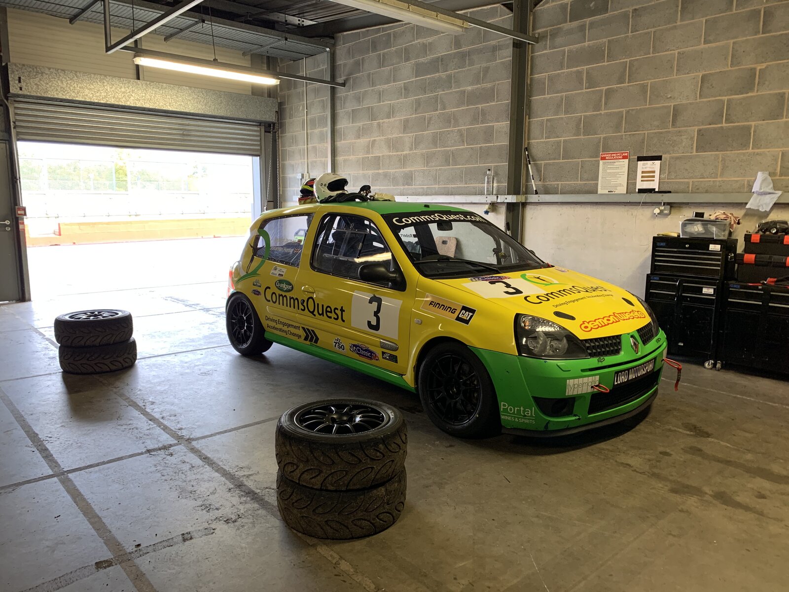

So, early start on Sunday morning even though quali wasn't until midday I wanted time to set up and settle in.
6 am departure
7am arrival

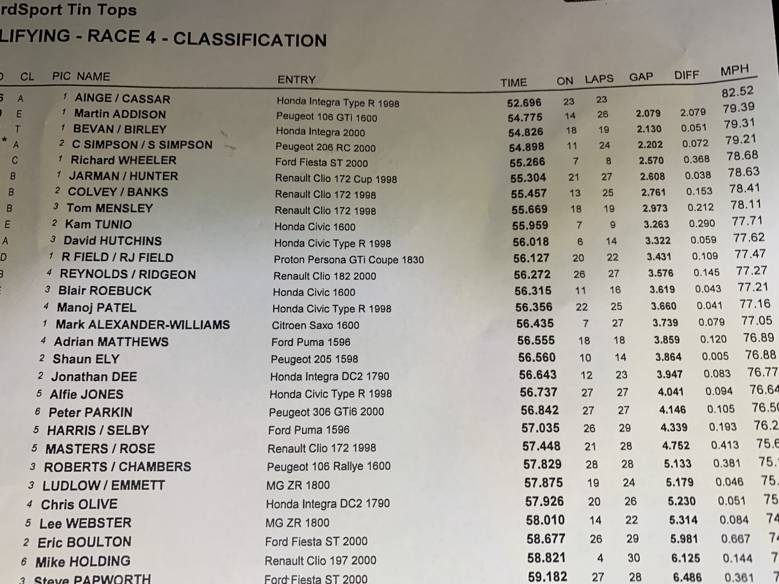

I took the car out to start quali. We had decided I would do just 10 minutes, make sure everything was ok with the car, bank a lap or 2 just to be sure of a half decent grid position and then let my co-driver have some time to get used to the car and learn the track as best he could.
At this point I either need to make excuses or eat humble pie, because by the end of the session he had settled into a nice rhythm and beaten my time by 3 tenths putting us in P6 and 1st in class for the start!
waiting for quali to start
Obviously, I was very happy with this result and the car had performed faultlessly. My only regret was that we didn't put the new tyres on for qualifying because in the heat the tyres on the car were way past their best. All we could do was swap front to back and work with them.

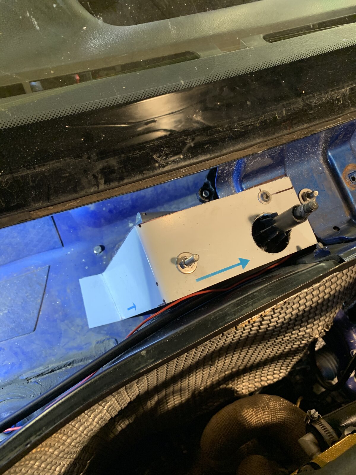

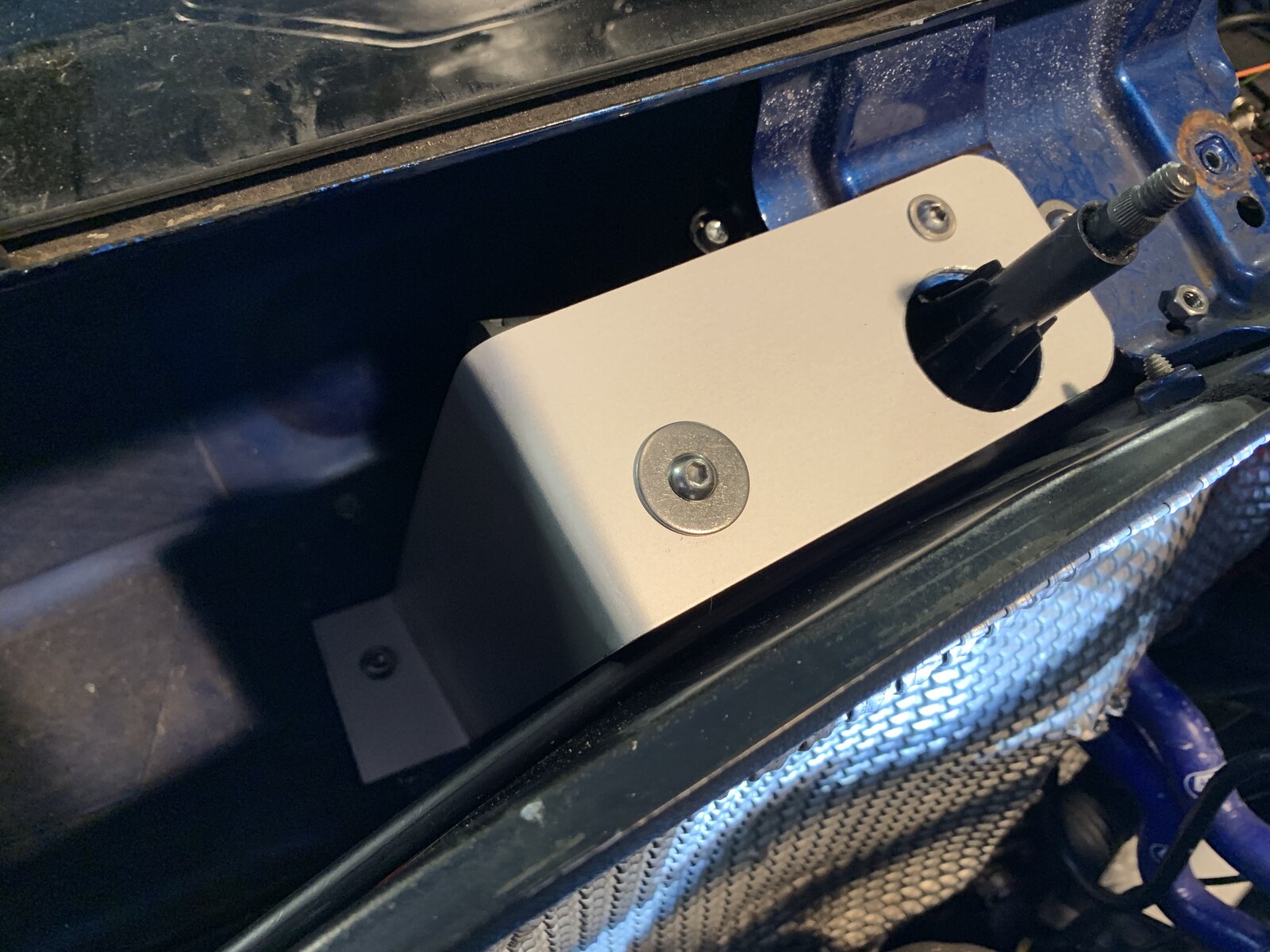

Some of you may know that last November my brand new van was assaulted by a bin lorry with the result being a stoved in rear end. As all this went through the insurance the body shop replaced everything on the rear including the rear wiper motor despite there being nothing wrong with the original one. Perfect I thought. I nice brand new (1 month old) wiper motor, single speed and light weight. Perfect for the Clio.
So the past couple of weeks I've spent a few hours mounting and wiring this in.
Unfortunately I overlooked one major detail. The stroke of a wiper on a van tailgate is 180 degrees with the result being a rather comical wiper bouncing off the scuttle panel in front of the driver, across the screen and back onto the scuttle panel on the other side, hopping over my cutoff button and switching everything off! Perfect!

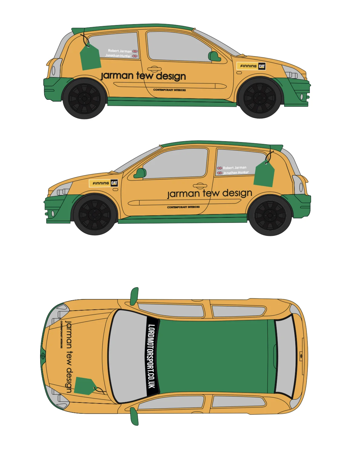

In other news, I am planning a new livery for next year. nothing too drastic but unless my friend who owns Comms Quest wants to cough up for a season of sponsorship I shall be changing to my own company Jarman Tew Design using the same colour scheme.

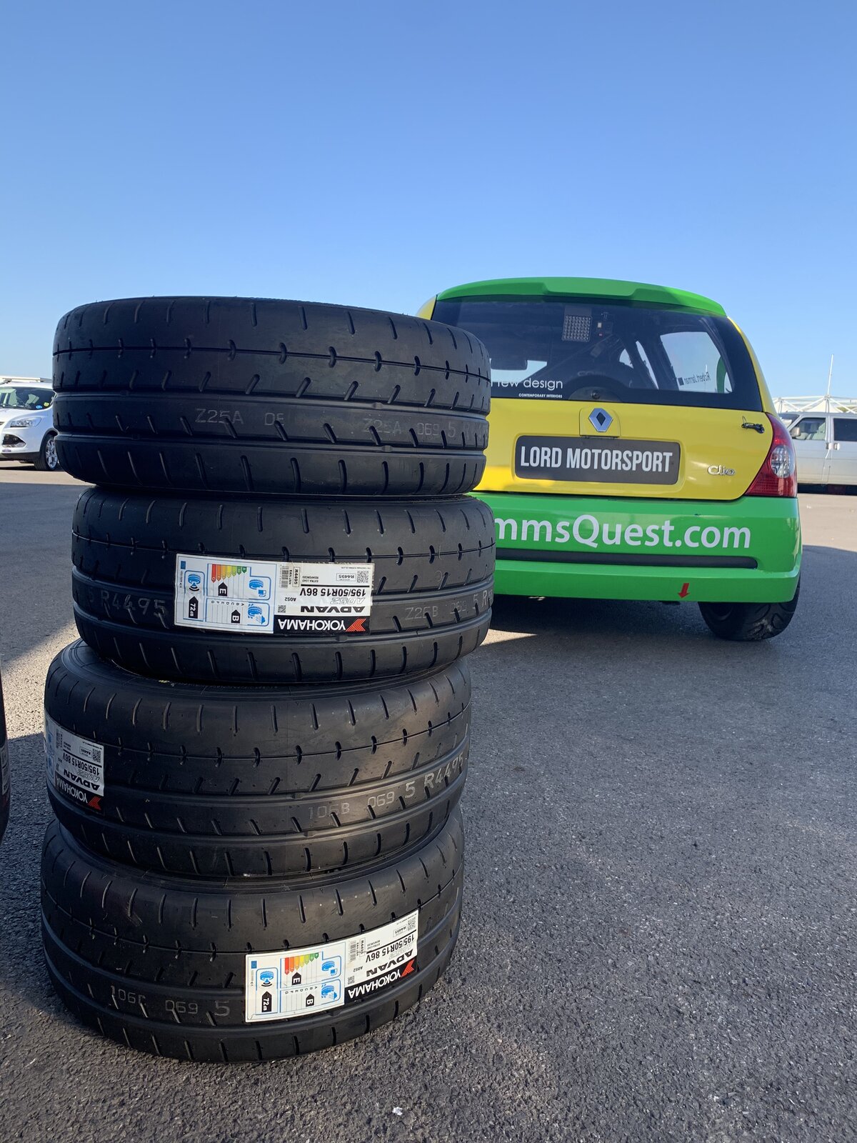

First things first though, I purchased a set of AO52s to replace my shagged AO50s which will be perfect for Donington next month. For this race I had a new set of AO50s on my TD 1.2s.

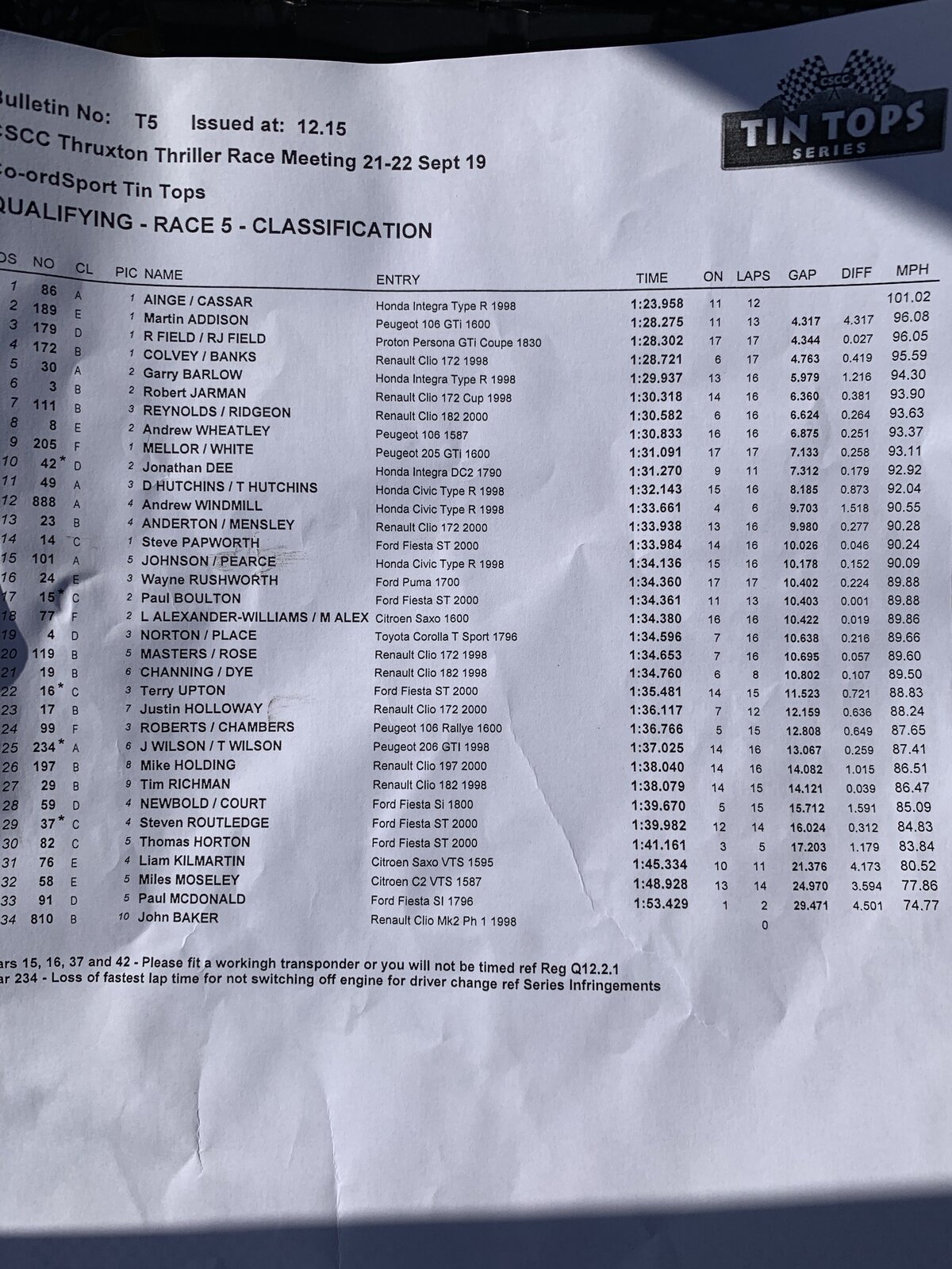

Quali was late morning so we were well ready for it by the time we were called to the assembly area. The aim was to scrub the tires in and then try and hook up behind one of the quick boys so I could get on the pace quickly. As I was driving solo I had plenty of time to learn hopefully!
And it pretty much went to plan! The boys from Chase racing in their Hulk green Clio almost won at Thruxton last year before their aux belt let go, so I knew they'd be competitive. Like me though, they had already had 2 engine failures this year.
So qualifying turned into a bit of a race! With me pushing hard and (unintentionally) forcing Dave in the Clio to outbrake himself on several corners! After a quick dive into the pits to check tire pressures and adjust I headed out again but I couldn't better my best time while chasing Dave and Dave's partner Ryan had already set a faster lap still.
After half an hour I was happy with 6th on the grid, 2nd in class and the car was behaving faultlessly.

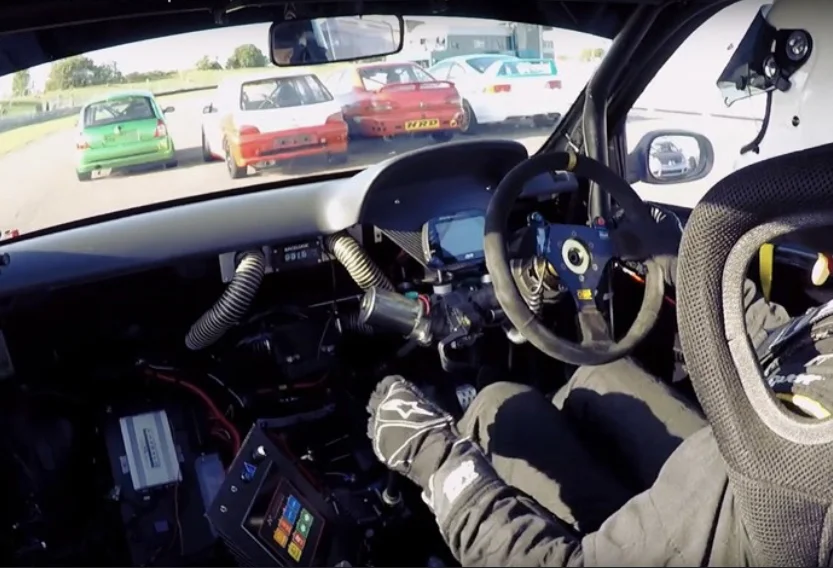

The race was awesome. This screen grab from my GoPro shows us all getting off the line. As you can see, it was tight! I made a decent start, went around the outside and headed into the complex in 4th place which is where I stayed for the first couple of laps.
Eventually I got outbraked into the final chicane by another Clio, pulled it back again the following lap by getting a better exit out of the chicane and then lost it again along with one more place after getting held up by a backmarker who didnt know which way to go.

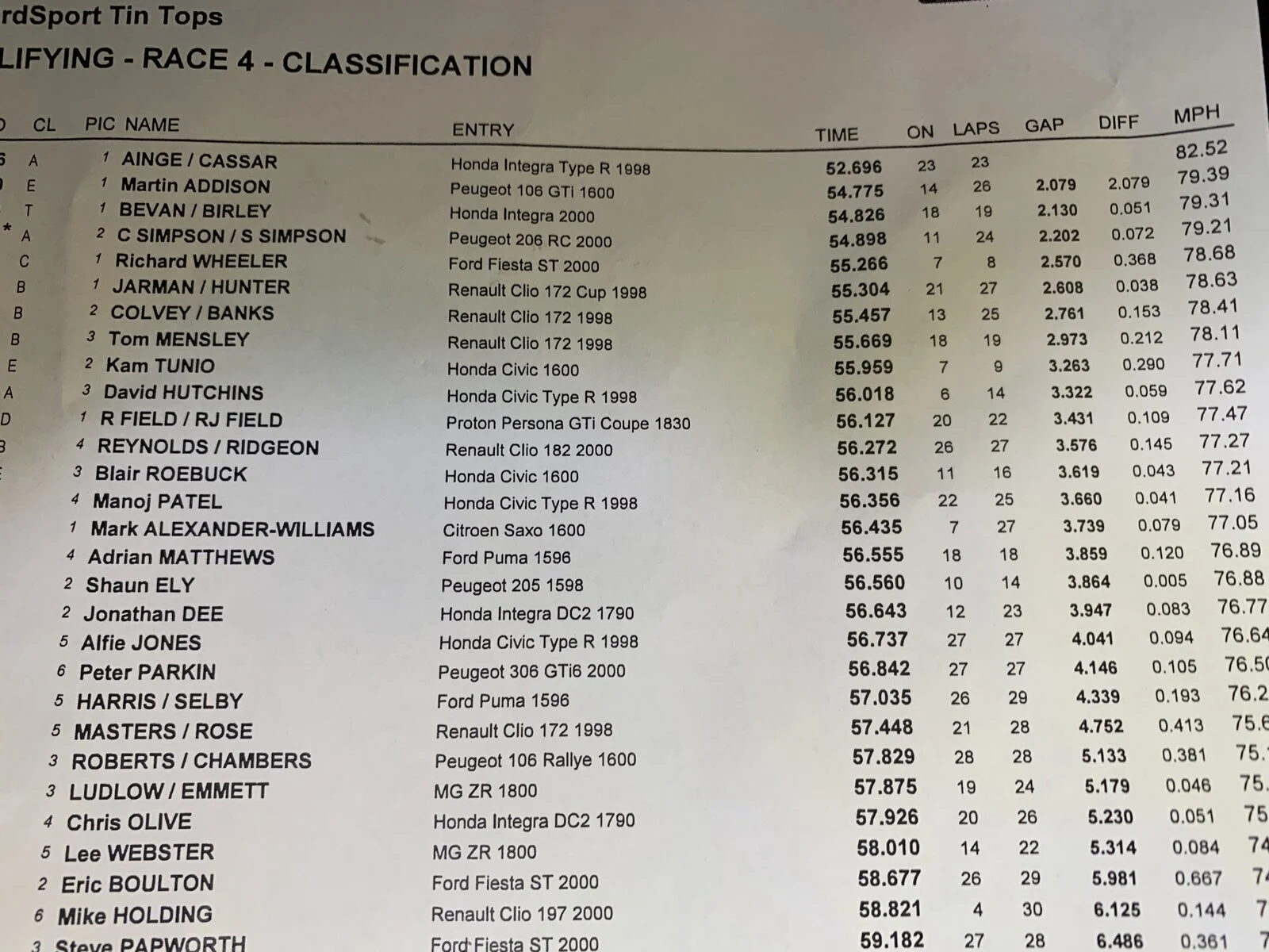

Qualifying was difficult with a few yellow flags and the car also picked up a slight hint of a misfire. We finished in 10th but with the 2nd place man sadly retiring quite spectacularly we were bumped up the order.
A beautifully prepared Integra Type R that was only just back in the series after being punted off badly at Thruxton in 2018.
On the grid for race 1 I was lined up directly behind Tom Mensley who historically is the fastest Clio and a regular all out winner. So I planned to tuck up behind him into Redgate and try and stay with him through Craners. With a rolling start this had the potential to work well as long as Tom had a good start.

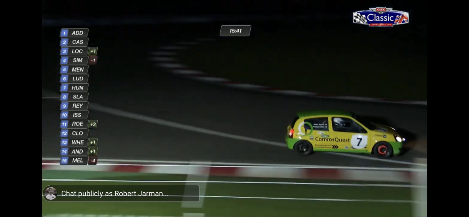

Before the night race there was a 30 minute "acclimatisation" session. Not a qualifying but still a timed session. So with lights on we went out to see what it was all about.
After about 20 minutes we were the fastest car on the track! The car was running beautifully and Jonathan was getting into his stride nicely too.
On the back of this I decided to make Jonathan start the race. He needs signatures for his licence so it made sense for him to try and get his stint done.
We started 7th on the grid based on our earlier qualifying time. This race was a mix of Tin Tops, Turbo Tin Tops and the RX8 series. He had a good start and made up a few places only for the race to be red flagged on lap one due to a car rolling at Craners.
So after a restart he still managed a few places and the car was going beautifully. After 15 minutes we were up to 2nd although a long way behind Andrew Jordan who is unsurprisingly in another class!
BUT... as he came into the pits to change over, the dreaded misfire began again! F***k.
