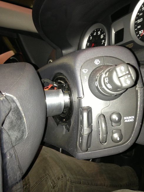

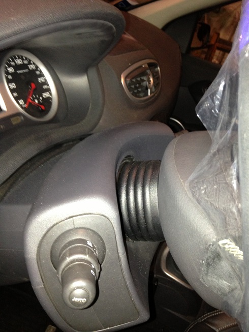

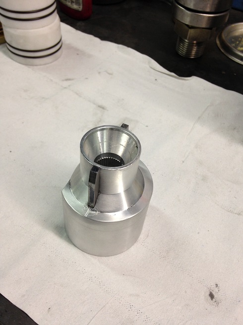

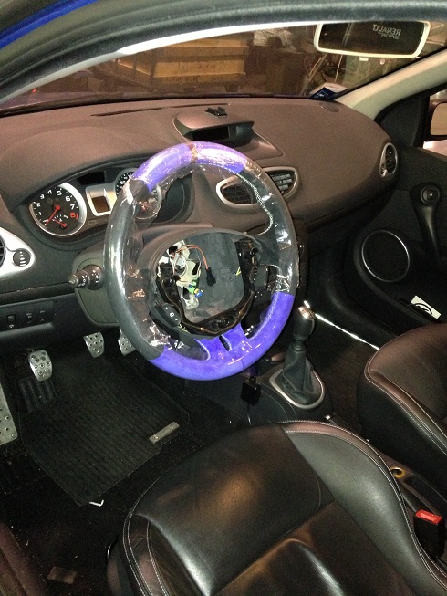

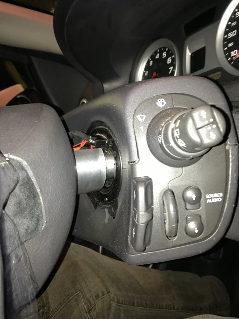

There is one problem that I couldn't stand since the first day I sit in the car: the steering wheel is not provided of any kind of axial regulation. I'm 1,80 m (6 feet) tall and the steering wheel is too far for my arms when my legs feel comfortable. Last month I had to re-cover the steering wheel because the original leather was damaged from finger rings (my mother also uses this car), so while the steering wheel was under re-covering, I have studied a solution and made a spacer that makes the steering wheel becoming more near to me of 4,5 cm (little less than two inches 2"), but the good thing is that all the functions of the steering wheel still works! Airbag, horn and cruise control still works because you keep the original steering wheel. You only have to go to Renault and make the wires longer by cutting and jointing them.
This solution can be alternative to mounting steering wheels which are not original and has no airbag. I didn't want to give up the Airbag, it's too important for me in road daily use.
Now I try to post some pictures.

They look good and I like the idea as I find the wheel to far away but won't the indicators and wiper levers be to far from the steering wheel now?

With the cheap version the steering wheel gets 4,5 cm (less than two inches) closer to the driver, but all the lever are still comfortable to be used.
The expensive version in the last picture is perfect if you don't buy the intermediate spacer between the steel and aluminium side, but if you want the steering wheel in racing position (in your mouth :D) and your going to buy it with more than two intermediate spacers you have to take one hand off the steering wheel to use the levers.

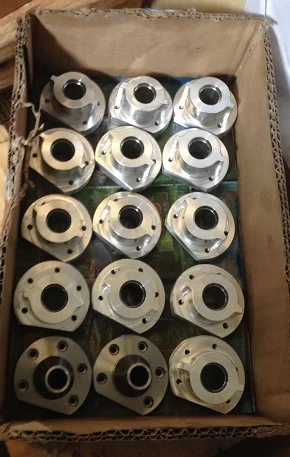

150 € is for the whole kit pre-assembled, as you see in each pic, plus a longer M12 screw (OEM will not fit because too short) and a rubber cover ring (not in the pictures) which you'll need so won't see the spacer from outside when fixed.

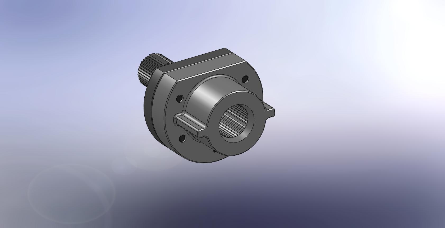

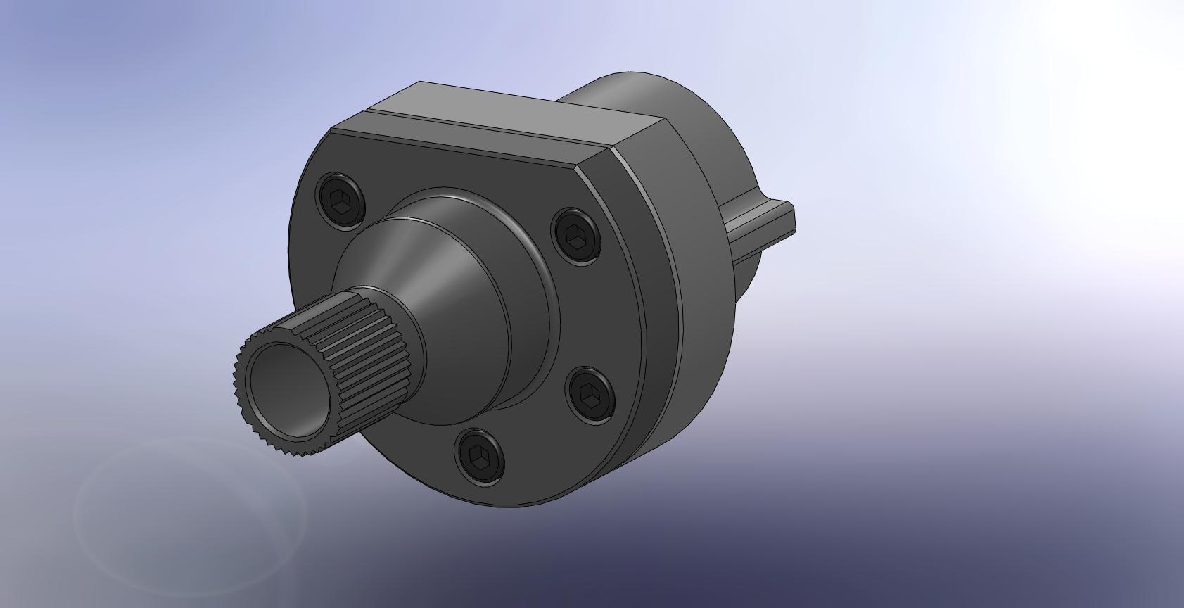

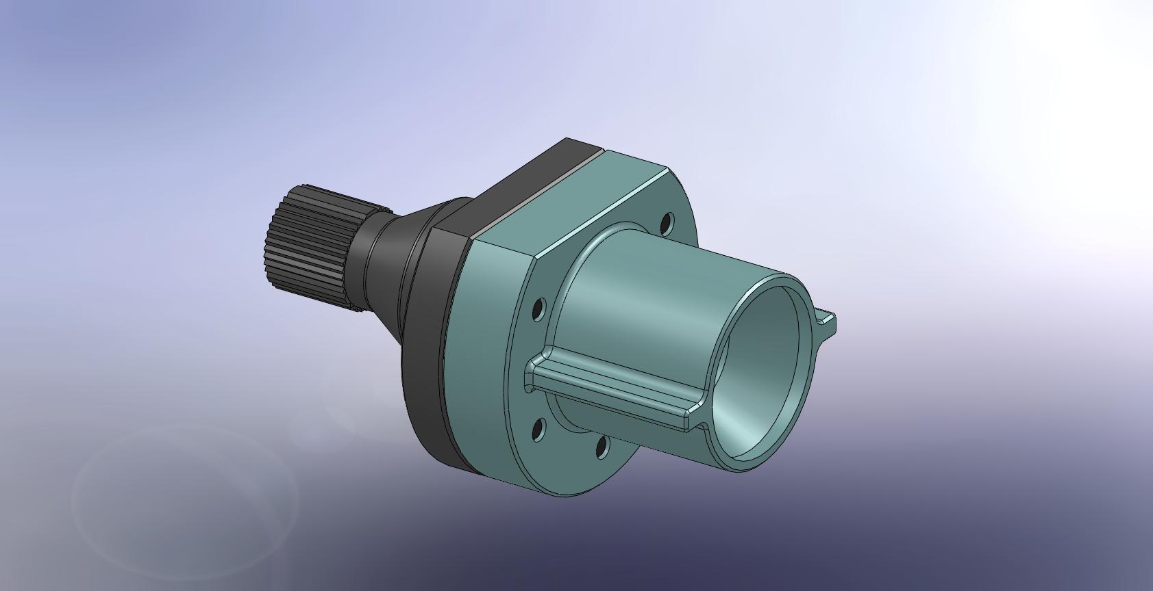

Please keep in mind that i'm referring to the pics ON THE TOP OF THIS PAGE, which are 3D Solidworks renderings of the spacer.

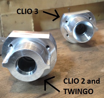

The first two pics are front/rear pics of the same product: spacer hub for Clio RS 2 (172/182) and Twingo RS.

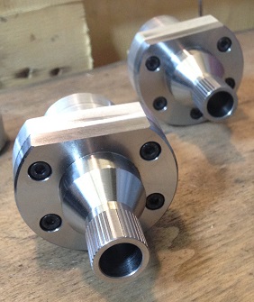

Pics no. 3 and 4 are front/rear pics of the other product: spacer hub for Clio RS 3 (197/200).
Each hub assembly is composed from two parts bolted on with 5 screws: a male-splined stainless steel hub, which they share, and female-splined aluminium hub, which is dedicated to Clio 2 or 3.
While ordering, you only have to ask for it and tell me for which car you need it. Also write me your address to evaluate shipping cost by carrier.

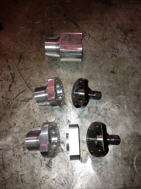

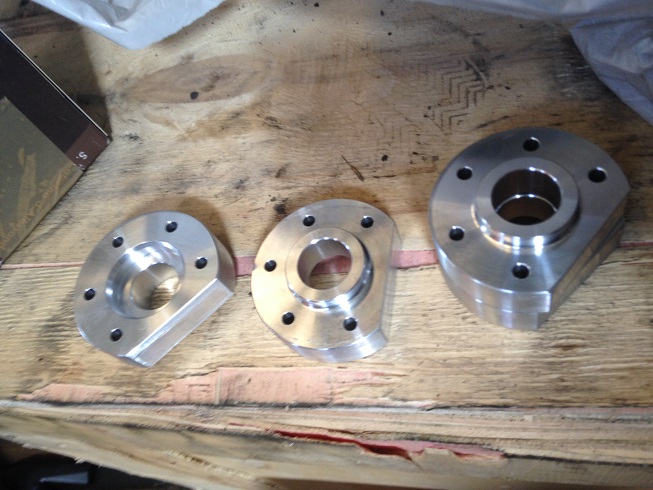

The single block aluminium hub, on the top of the first page of this topic, was for sale for 100 € and IS NO LONGER AVAILABLE.
The intermediate spacer, which you can see at the bottom of this pic ( in the "third line")
cost 20 € and increase the hubs of 1 cm more. But you don't need it if you're not taller than 1,90 meters (6 ft 4").
But such tall people won't buy a Renault Clio, maybe a Megane RS.

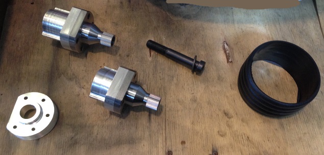

Some pics more, now I'm going to answer to PM's.
Kit for Clio 3: 1+2+4+5 €150
Kit for Clio 2: 1+3+4+5 €150
Kit for Clio 3 extended: 1+2+4+5+6 €170
Kit for Clio 2 extended: 1+3+4+5+6 €170
Pre-assembled hubs
Steering wheel side
Steering column side

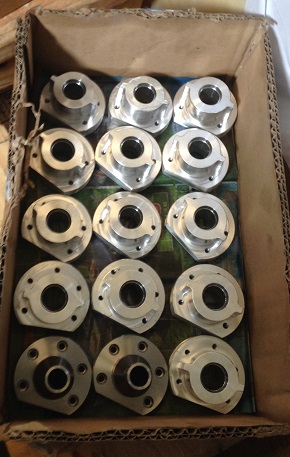

As I said, ready to stock
