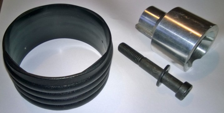

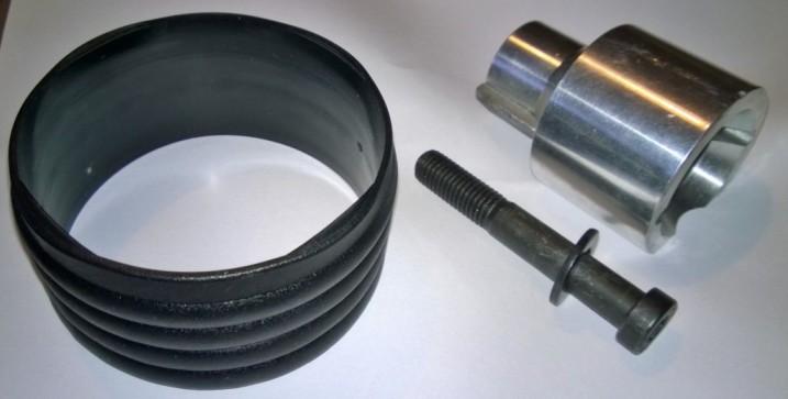

Im guessing the screws that screw parts 1,3 + 6 together are also included.
Also if i ordered one of the spacer pieces , will the longer M12 bolt still have enough thread on it to tighten up.?
Thanks.
Yes, the bolts are included. If you buy the intermediate spacer also, I'll supply a longer M12 bolt. The kit arrives to the customer ready to fix, you won't need to buy anything more. ;)

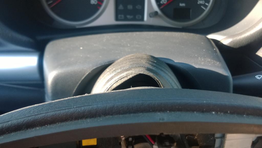

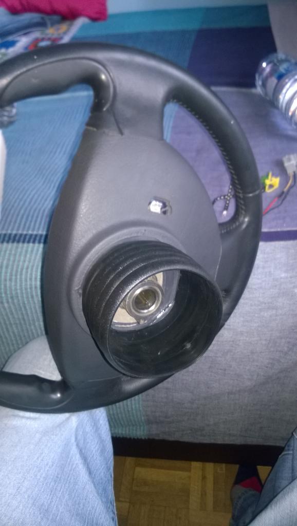

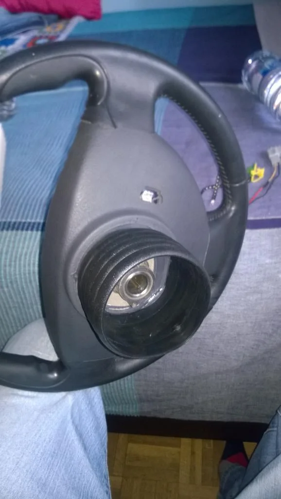

I think the rubber cover is not a problem as long as you fit it with care and use some glue. I mentioned it in the guide because mine was a bit bent and I had to use some heat to re-shape it.
Since you can't see the guide I'll post here the pics of the cover for you:
Glued:
And this is how it looked when I tried to fit everything the first time:

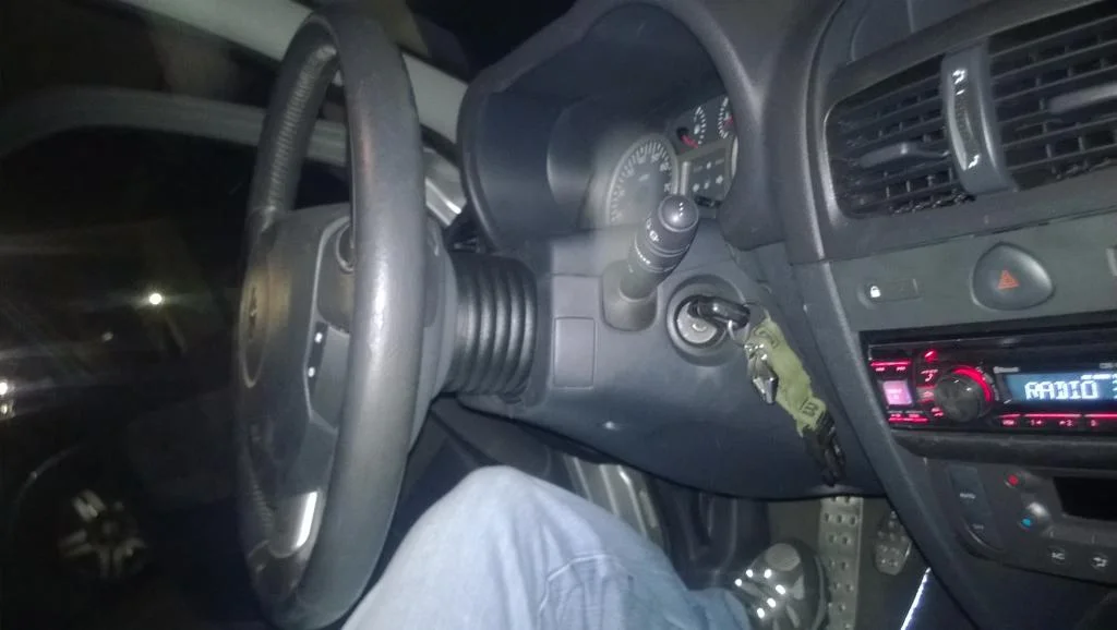

Now finished the install of this steering spacer.
Fine piece of kit from Italy. Thanks G..
The wires have been extended by aprox 100mm as bozo has said.
That took some fiddling, but managed to do it.. Its just time consuming.
BUT so well worth it. I can now drive the car in comfort...
No issues with the indicators though, everything works fine....
Also I super glued the black extension onto the back of the wheel, as pepinosport has , after warming it up and reforming it, as it had got misshapen in transit.
As I have the extra long extension I found the black " bellows" wasn't quite long enough, so I used an old shampoo bottle, [treseme] which as luck would have it is just slightly smaller diameter than the bellows, and cut that down, fitted inside the bellows , then glued it in place, so the steering column is now hidden...
Ill post a pic when ive taken one...
