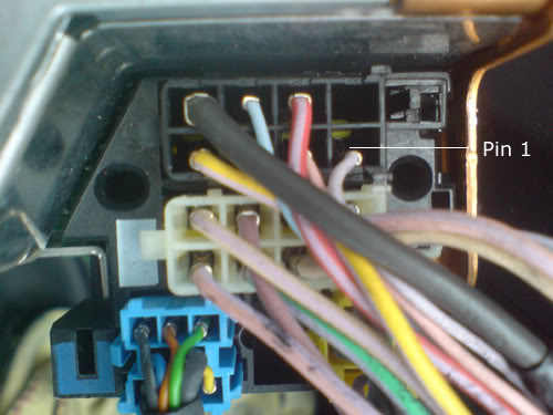

I've just bought a Pioneer AVIC-X1BT sat nav unit for my 182 and u have to connect a wire to the speed pulse of the car. Does any1 know which wire it is coming from the ECU???

Mine was underneath the steering wheel, was the centre pin on a white connector. Unsure about 182s but have heard some clios have it behind the instrument cluster...

Its on the radio connector block Pin.1 (black connector)
