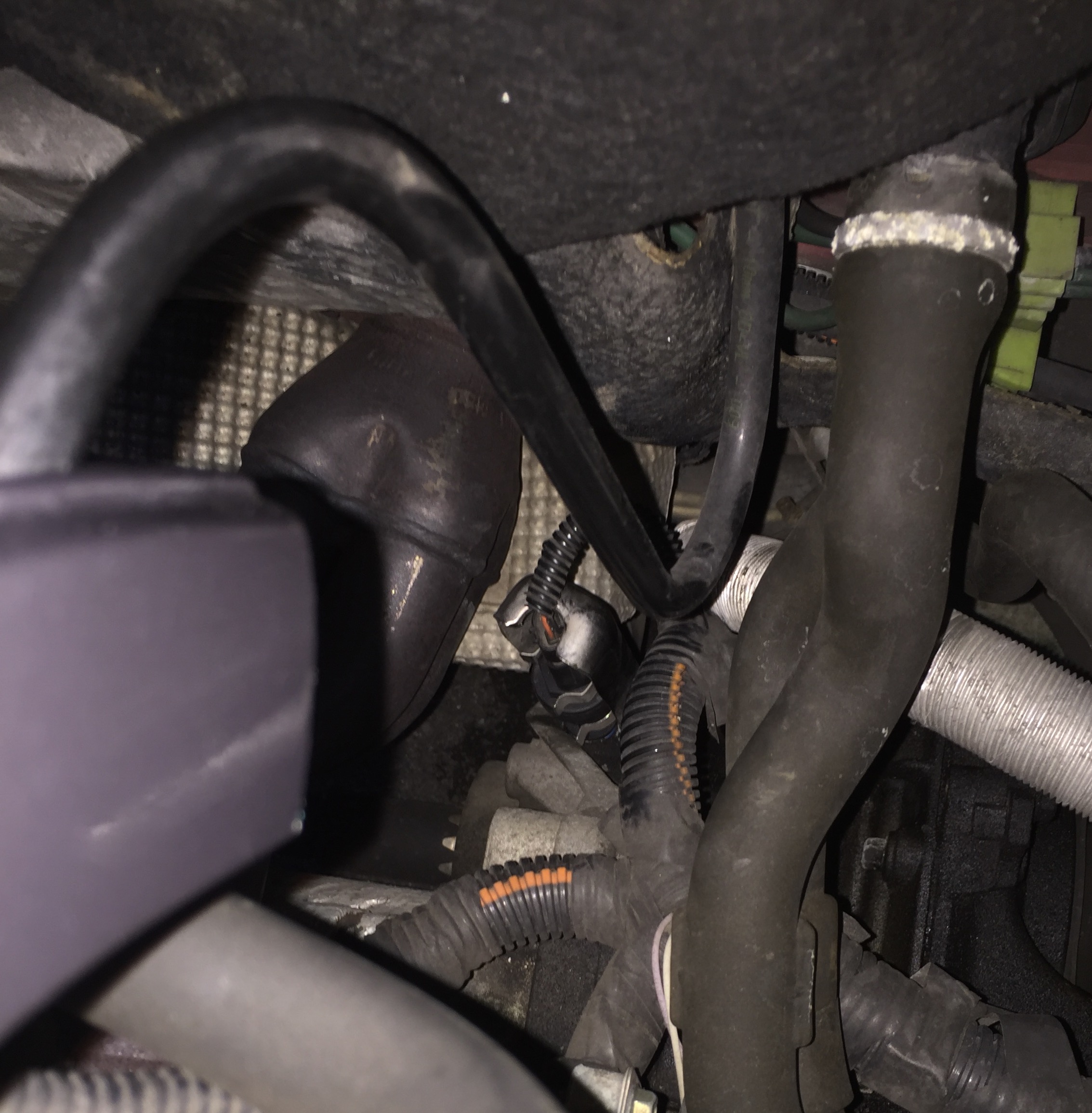

I'm not 100% on the non sport setups, but for the sports there were a couple of options.
The earlier ph2 sports and the cup versions (as they don't have abs) have jc129 gearboxes, which use a speed sensor attached to the gearbox as in the photo above
Later ph2's ran with jc130 gearbox which uses the abs system to determine vehicle speed via front wheel sensor, I believe an easy way of checking is to see whether the car in question has traction control as only the later 130 gearboxes used traction, although I may be wrong
Hope it helps
