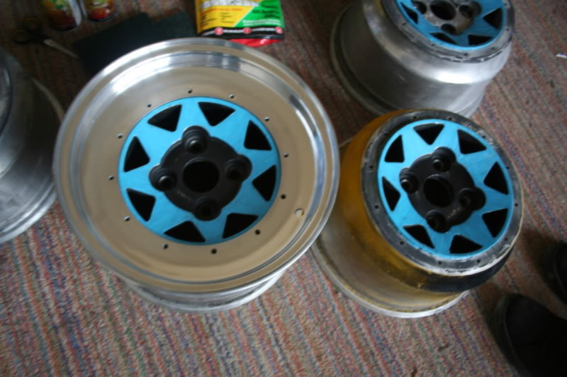

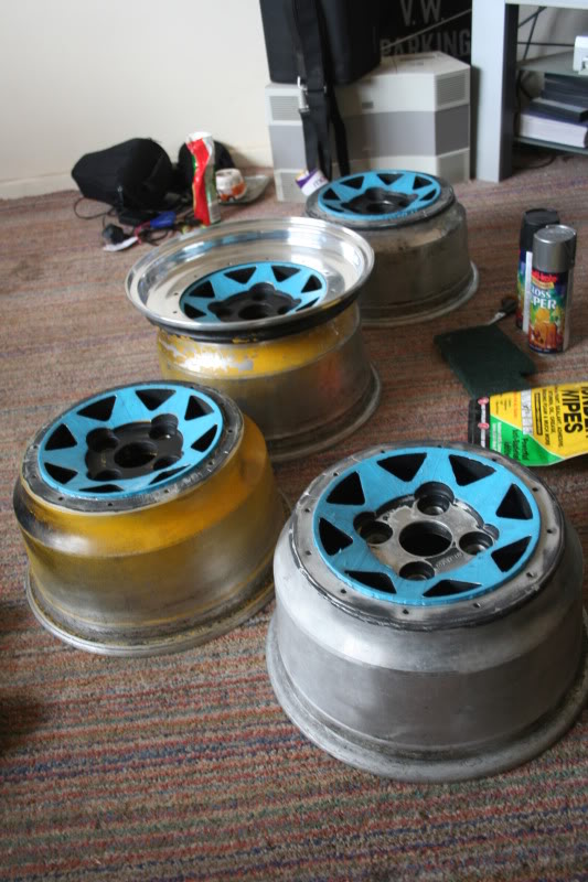

Like a fool... I never painted the inner spokes and centres... So I have had to mask up the polishing. Im just waiting for a dry day to paint them
The question is which colour?
Ive also been polishing the bolts.. Im glad there was only 48 lol
I bought some 175/50 dunlop SP tyres last week and they are sat waiting in my shed... So not long now folks
Cheers for reading :)
Its a labour of love... Im going as fast as i can lol
40 hours on the dishes
20 hours on the centres
4 hours on the bolts
1 hour masking
Still to do
few hours painting
few hours final polishing
Ive still not even trail fitted them to the roco.. I hope they clear my brakes lol

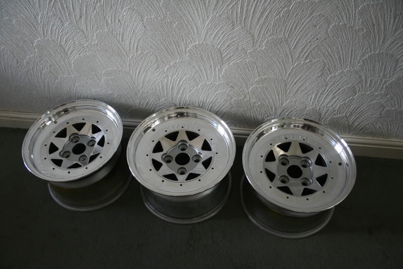

Well they are nearly done at long last.. I can deffo see the light at the end of the tunnel... me spending 2 weeks in hospital has held them up but everything should be done in time for edition38.. So its allllllll gooood!!!!

They look incredible mate! Muchos Kudos for all the time and effort you've put in :)

I read a few threads on the net about polishing and they raved about Britemax products..(google Britemax Final Shine) So i thought i would give them a try, Im pretty happy with the results, you don't really see the instant effects like you do with one coat of autosol etc you have to build up the layers, Ive given each wheel 3 coats of each.. its very watery and goes on and comes off easy enough... Im still yet to apply any wax to give them some extra protection but im to tight to buy a decent wax lol

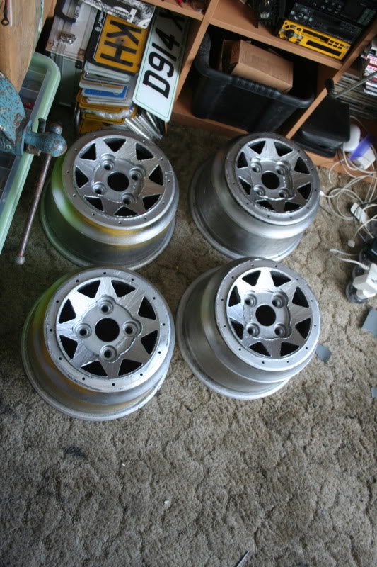

Why did you blast and sand the anodized finish down?
Usually all you need is some acidic oven cleaner, leave it for 30 - 45 minutes and you will see the anodized finish basically falling off. Or take it to a local anodizer ask them to drop it in the bath and strip it off. Takes even less time then usually, and they leave the metal under it in a better condition. So less refining to do.
Would save you a lot of time, and probably pain with the sanding and buggering about.
My bad Wozzaa.. it was more of a thick enamel like coating.. nothing like anodizing if im honest :eek:.. the blaster told me what it is called but ive totally forgot, its used alot in motorsport iirc.. I wish i had taken a picture of how thick it was.
