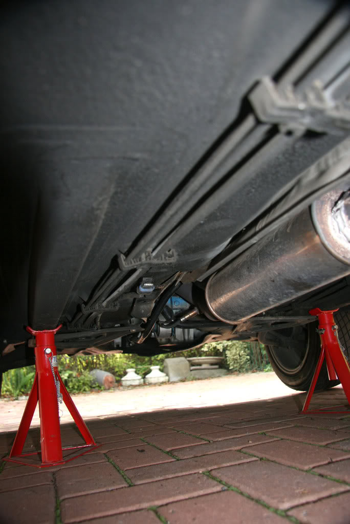

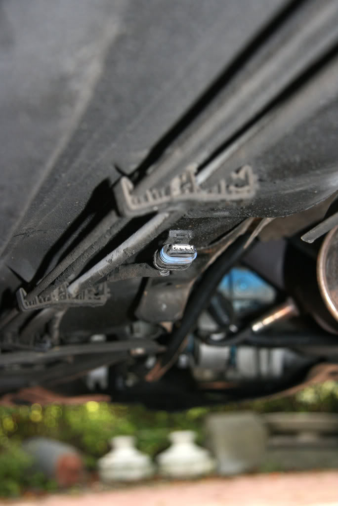

spotted this hanging under my ph1, whats it connect to??
Car  02' PH1 172
Hey guys. Just spotted thing haning loose under my car and cant find what its supposed to connect to???
Help please!!!
Dont know if having a decat will have anything to do with it?
ah ok. with a decat youre normally just left with one lambda sensor right?? so this just might be the plug for the labda sensor which is no longer there?
keep it safe from the elements, that's all I can say...lol...it looks like it was just disconnected.
As above its the 2nd lambda connector. Some ph1s only had 1 connector anyway, later ones had 2. Id just wrap the end up in electrical tape to protect it.
