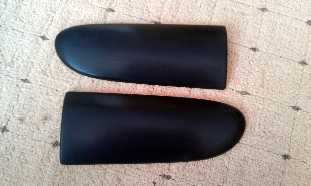

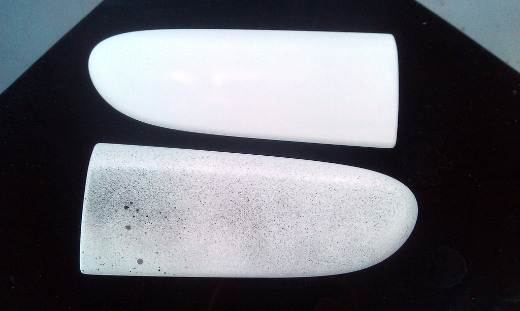

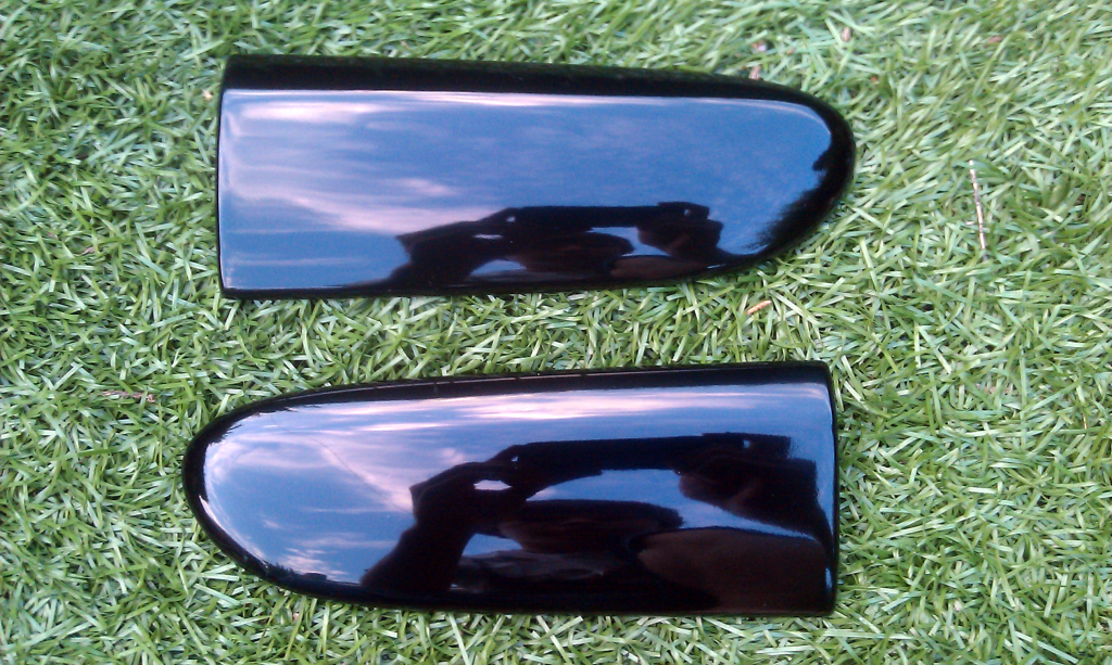

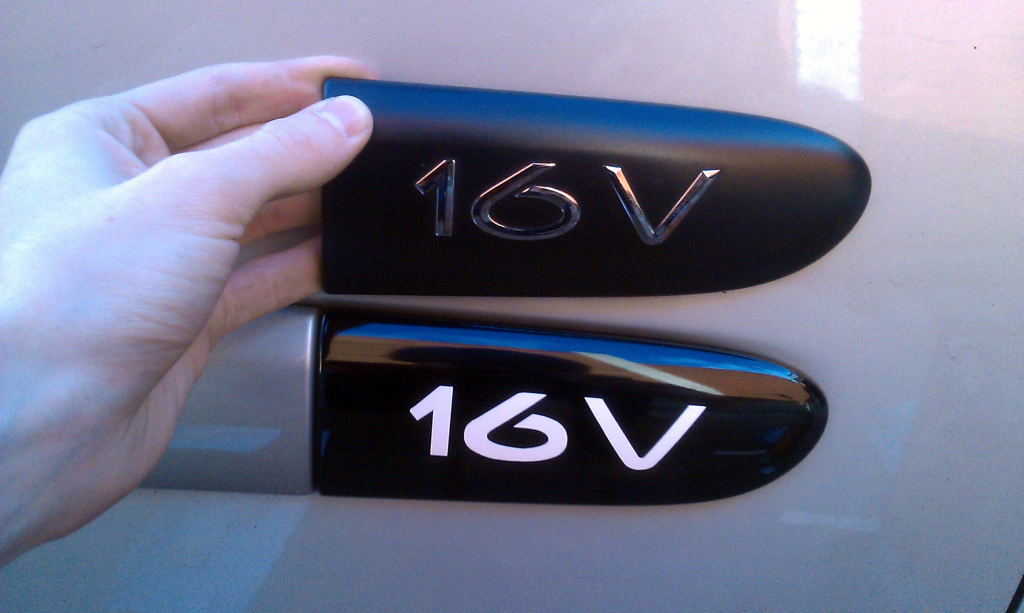

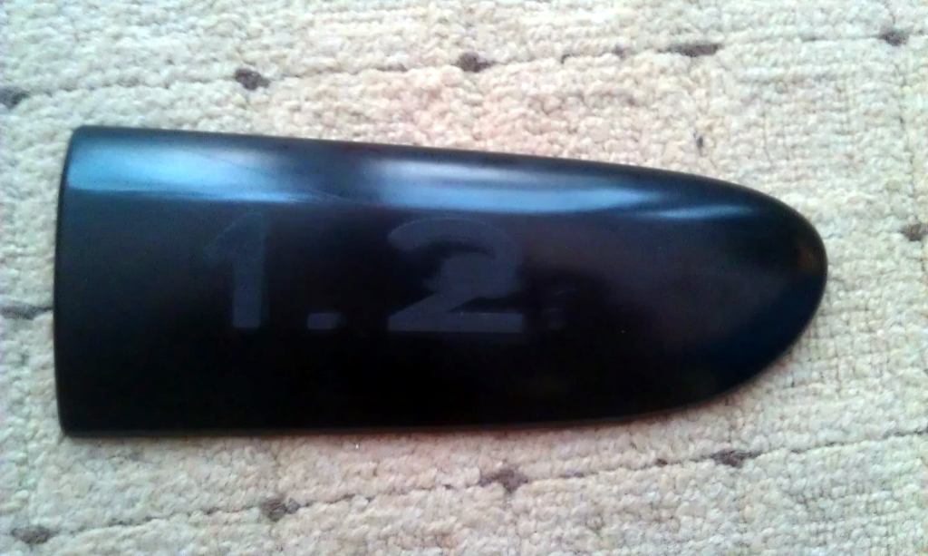

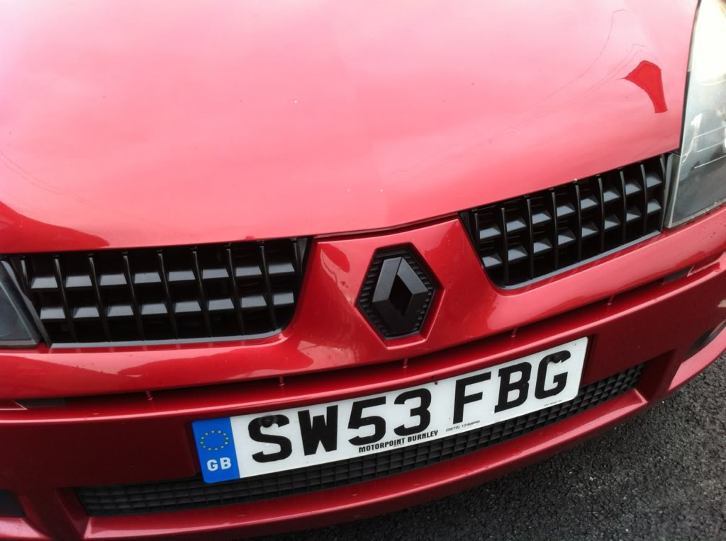

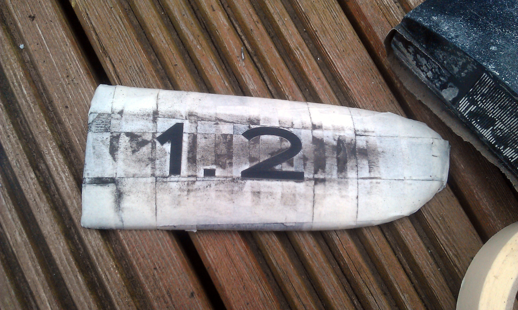

Here's how I sprayed my bullets:
Firstly I masked up the bullets and used a block to smooth down the raised numbers.
Then went through 600, 800 and 1200 wet and dry paper to remove the rest of the numbers and scratches (as well as keying it so it could be primed)
I then sprayed a few coats of primer.
Finally I gave them about 2/3 coats of gloss black (Didn’t need lacquer)
Finished product :)
Sorry for all the pics but I hope they help. I thought It'd be easier showing the process instead writing of a block of text :)

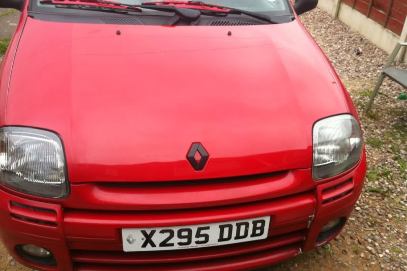

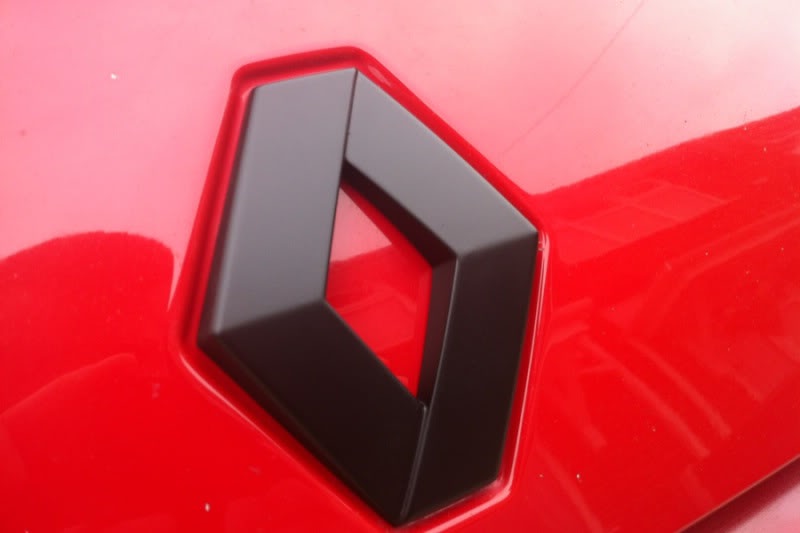

When the weather is nicer I'm spraying my spoiler for the astra using rattle cans. Keeping the part warn seems essential. When I did a matte black spray job on my front diamond on my old Clio between each coat I stuck it on a hot radiator for 15 mins. The heat thins the paint when it's wet and it seems to help gravity make it naturally smooth itself out.
Nick
  Astra (H) VXR
Looking at some of these bullets, mine are coming off at the weekend!! Colour code the lettering I think..
