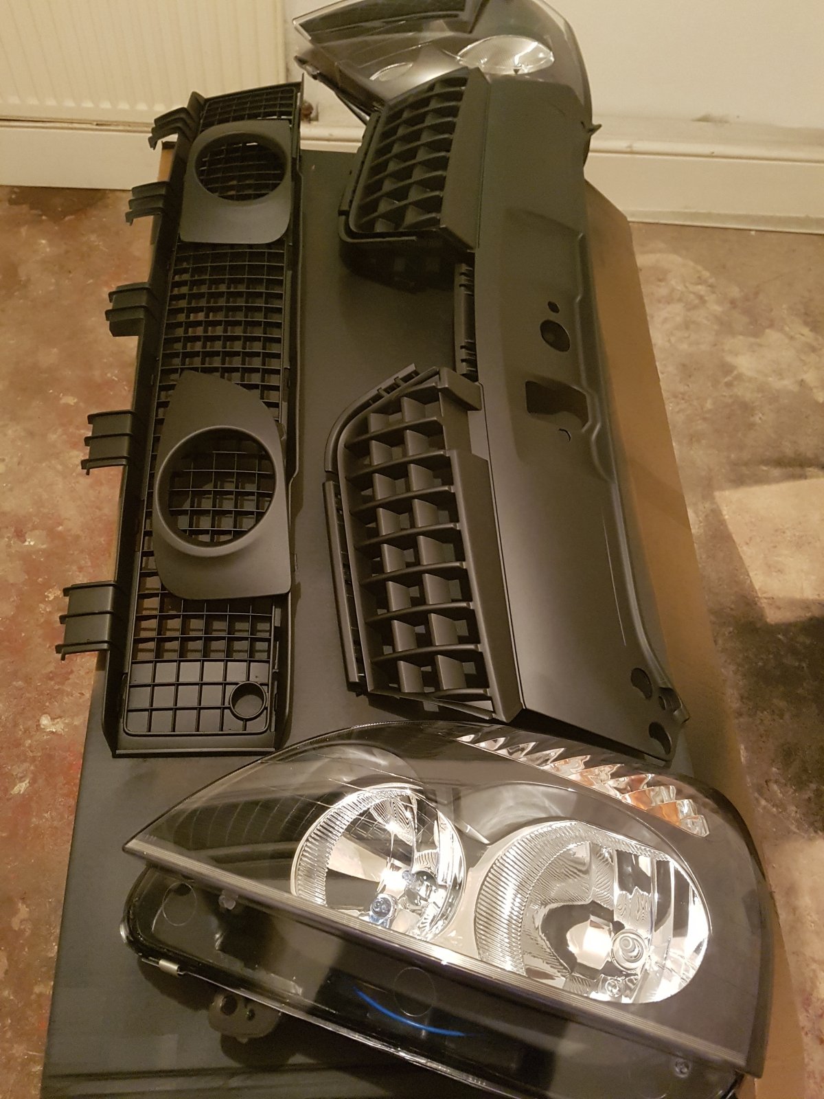

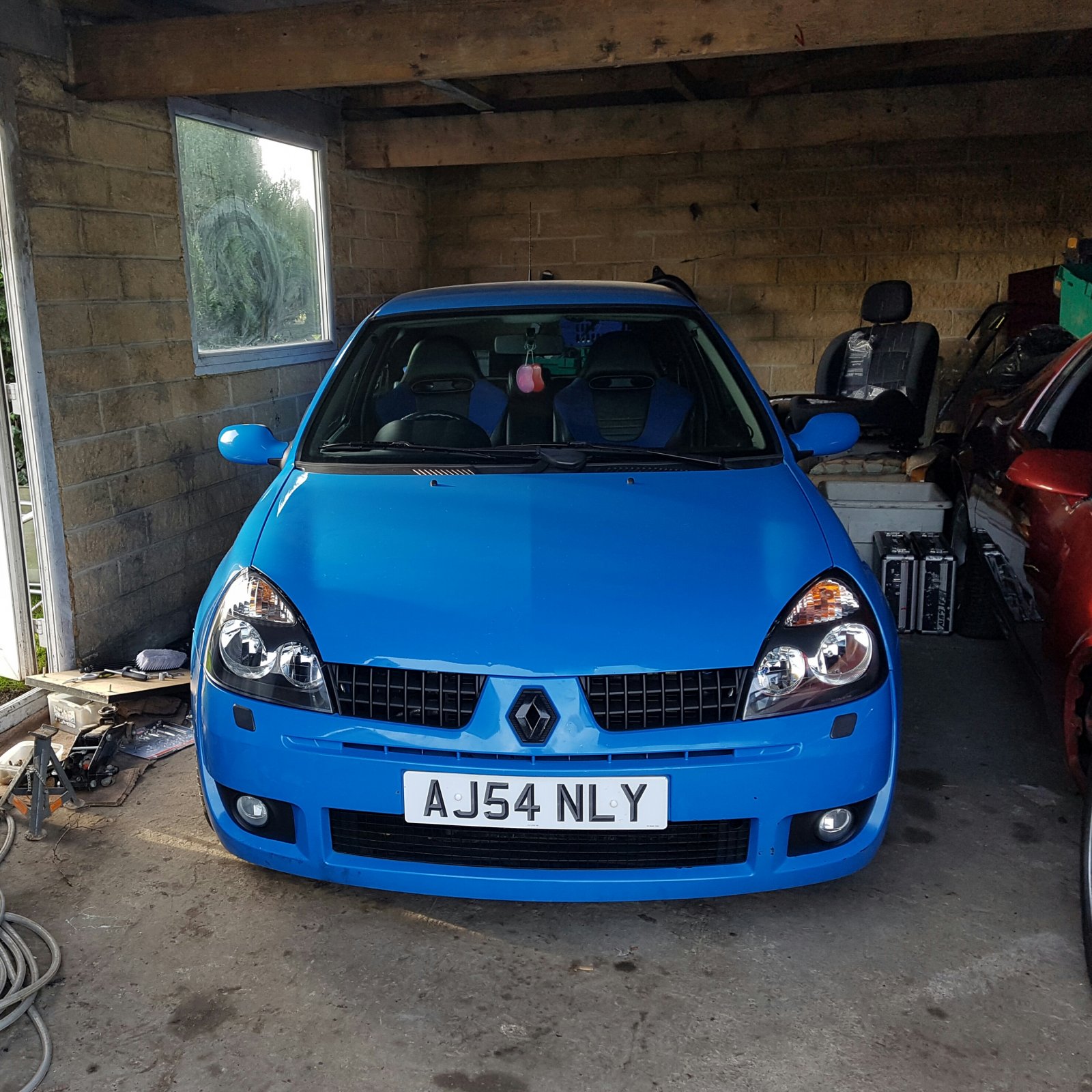

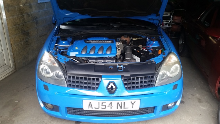

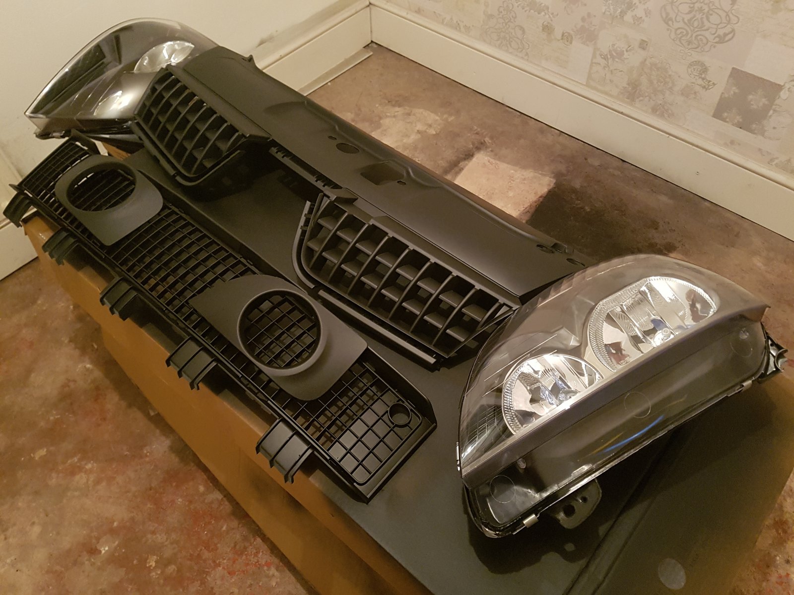

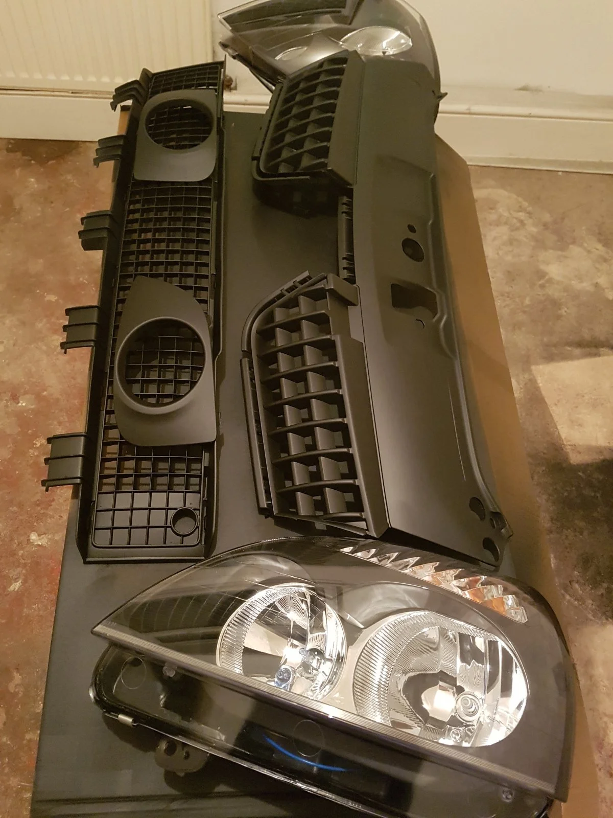

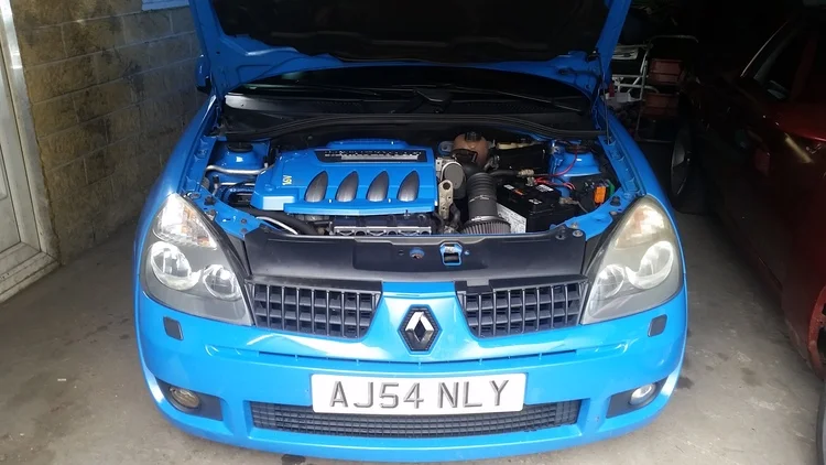

I used halfords plastic primer an matt black flexible paint think it was called no problems whatsoever

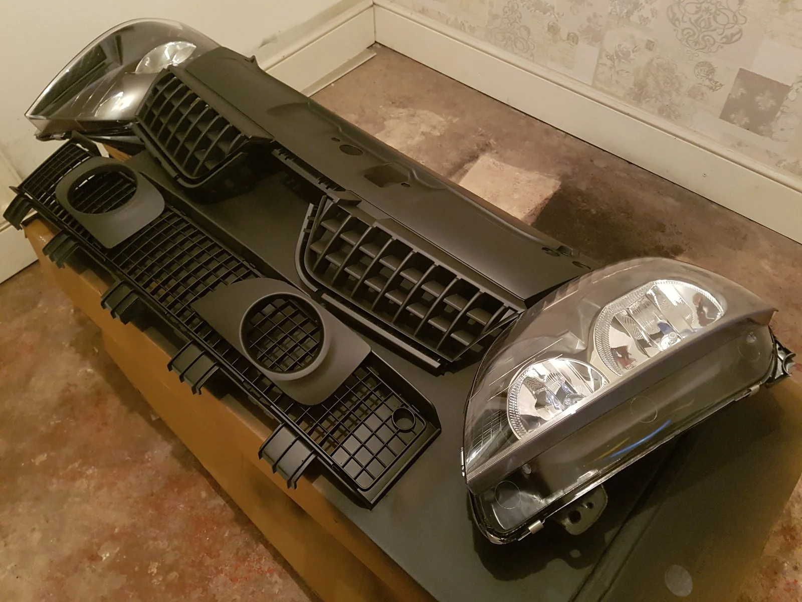

I used to work in body shops and this is how i would do it. I would also recommend the G4 good results, easy to apply and lasts a while. You can also use the old heat gun trick and that brings the colour right back.
* Remove and clean the grill, use some degreaser or IPA
* Key the surface either with a scotch pad or some fine grade sandpaper.
* Wipe the grill down with more degreaser or IPA
* Use plastic primer, you can get it in an aerosol. Follow instructions, probably best to do at least two coats
* Spray with your colour of choice, first coat go light and whilst it's still tacky go for the second coat. It's better to do some light coats then heavy wet runny ones.
Any more info let me know.

I'm probably going to give Technic G4 a go. Easiest, quickest and looks good. Probably try small areas like the 2No exhaust surrounds in the bumper, as they are virtually grey. Failing that i'll have a go at spraying with your pointer's. Thanks Rojer :up:
Jon46
  BG FF 182

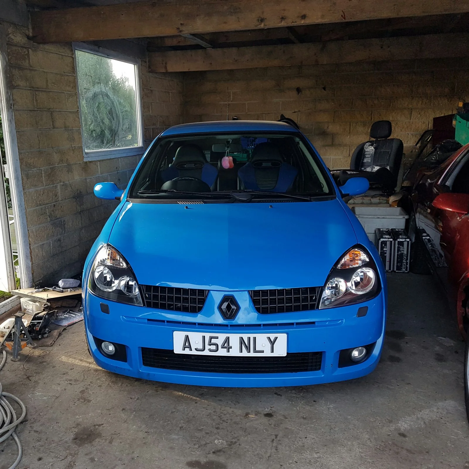

Paul they look superb!
Did you apply any lacquer to them Paul? Would be a shame for them to chip after all that effort :)
I got some Solution Finish black trim restorer, and it’s worked well for the last 6-8 months....can’t quite remember when I applied it.
But looking at Paul’s pics again, I’m probably going to spray all the grilles, and fog light surrounds when I change my cracked n/s fog light.
