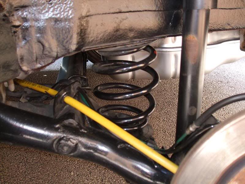

having had the pleasure of x3 182's my current 182 seems to squeak a little from the rear (not when driving) but when your loading stuff in the back or when the handbrake isnt on enough?! i havent known anyone else have this problem?! any thoughts please? if i get the wd40 out what do i squirt? the shock or the spring? its not a horrid noise just a bit annoying! thanks folks! :)
when i jack it up i can hear it too?! :o
i saw that as well Rich.. so what do you thik spray the shock with wd40?! :S
its seems to be coming from both sides though :S
i havent a clue?! im confussed need help please?! its dont it since i got in! never got any worse! its a very strange noise?! so are we thinking shocks or springs folks please!!!!! ;)

i dont think so! its when you slam the boot down or put stuff in the boot or as i say when the hand brake isnt on enough it makes the noise!?! :S if you push down on the back of the car it makes a squeaking noise?!
^^ i do and it stops it! but when i push it down at the rear it shouldnt really squeak should it! i know the hand brake could do with tightening up at its service! ;)
Get someone else to push down on the car and see if you can tell where it's coming from Paul?
I'd imagine the springs and shocks are the only place it could be coming from really.. just a process of elimination!
^^ thanks folks! :o is it a common noise when the handbrake needs tightening up? :S - its worse when my car is parked on my drive (which is a bit of a hill) :o but im sure it coming from the springs or shocks?! unless its just the brakes trying to bite in but loosing pressure (ie needs tightneing up) but why squeak?!
You answered the question in your first post, it's just the handbrake aint on enough, and when you load the car the suspension compresses which causes the angle of the axle to change which puts pressure on the brake pads causing them to slip.

Loads of cars do it, it will be the pads vibrating cos there put under strain.
my 172, 182, mums suzuki, dads zafira, bro's scenic and my old corsa all did it.

^^ just been out side to my car and pulled the hand brake up more and it stopped it! (i often dont pull it up much as i leave it in gear) i think thats why id does it! :(
pull pull pull ftw! :) thanks fellas :)
