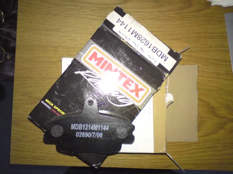

Few weeks ago I fit new discs and pads (brembo max + mintex pads). Pads were constantly squeaking (rotationally), took pads out and ground the backing plates down. Cured that
Now they just squeal when coming to a full stop

Are they 1155 mintex?
If so, they are just a noisey pad IME, if you want quiet pads when applied gentley (ie normal breaking on the road etc) then sadly you will have to change them.

Mintex are always a bit noisy, all compounds. They usually supply stick on anti-squeel backing pads, but if you don't have these it's acceptable to use a smear of grease

Yeah they are the 1144 pads. The rubber backing has been stuck on them too
Is it worth giving the backing plates another tickle with a grinder?

how much did you grind them by? Enough to keep the standard anti-rattle shims? if not, do this and refit them

The shims ares till in. The squeal is getting louder though, that's the problem (radio gets drowned out easily) a friend has exactly the same pads and discs - and no noise on his

Ive never had squeal like that on mintex 1144, and ive been using them on and off for about 15 years or so now on various projects so I really think there is something actually wrong with your setup somehow, pads sticking at an angle or something etc.

pads too tight in the calipers, it can't be anything else really

They have been filed use the rattle shims and have the sticky pads on them too, which are a bit mullered now mind.
