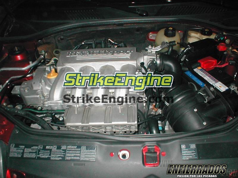

Heres a pic of an engine bay (not mine), I know the cambelt is on the left, where is the aux belt?
If you look at the left side of the bay you'll see the alternator, and the belt that runs it is the aux belt
The belts looked new, I saw the cambelt at the side of the engine then looked towards the bumper and saw another belt which I guessed to be the aux belt.

Looks ok to me.
BTW Thats the aux belt. The belt in the background is the same belt also!! The cambelt will have teeth on it.
