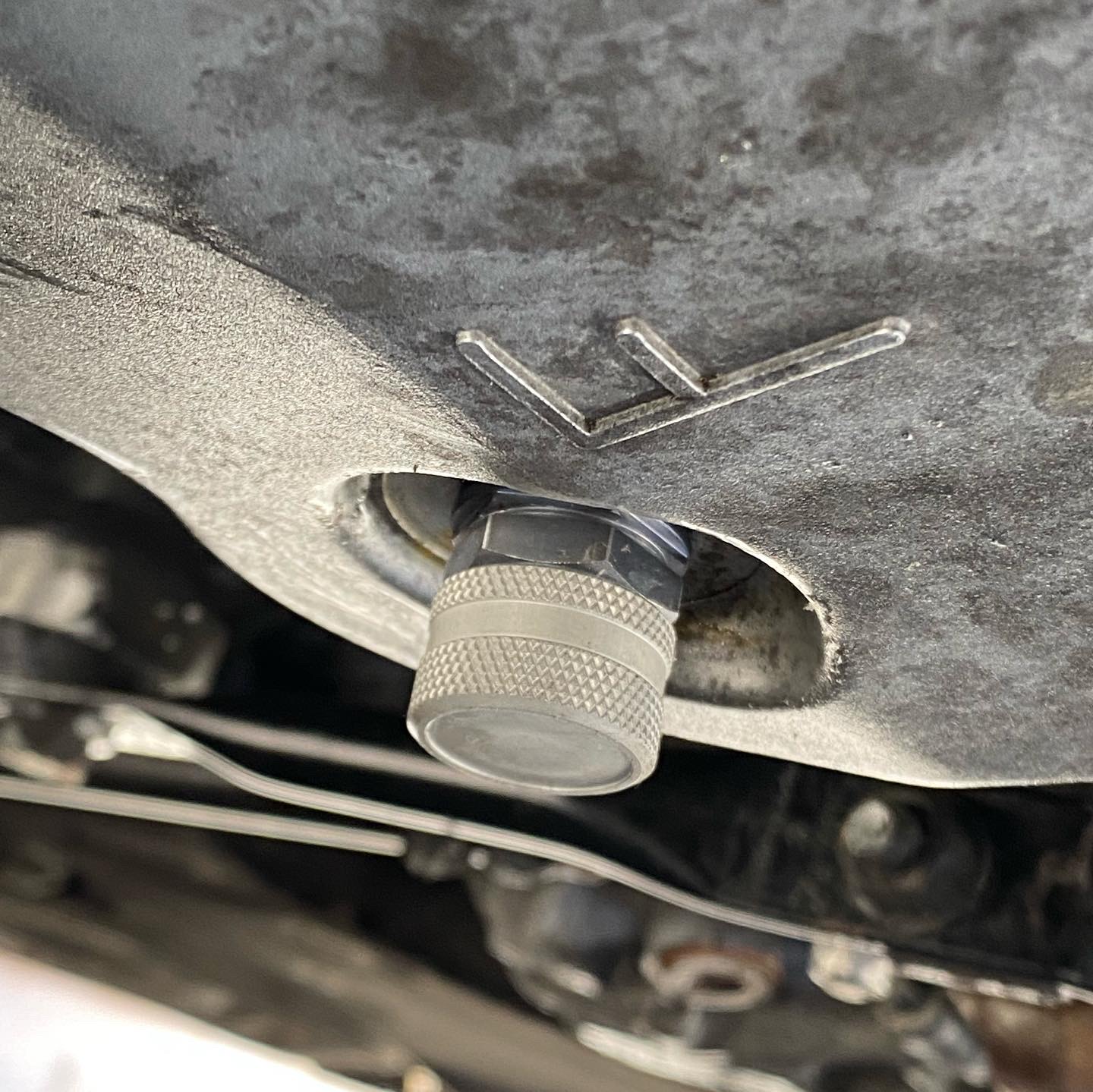

That's the oil drain valve, nearly bought that but think it would stick out too much from the oil sump.

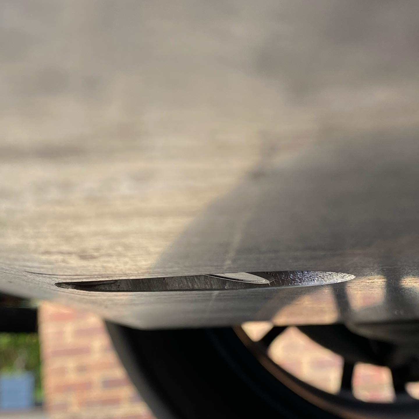

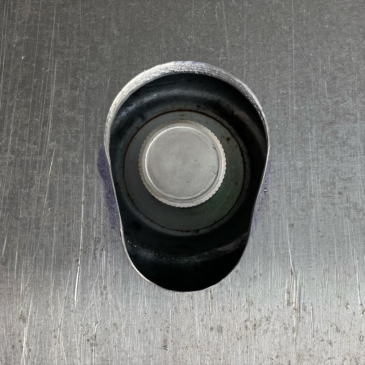

I run a full PMS sump guard that I still had to modify to house the drain plug. I wouldn’t fancy running one without a guard covering it.
MLB
Looking at the scratches on your sump guard I wouldn't either 😂
Mine bring as low as it is I'd be afraid of it dropping its oil every drive..
frayz
I live in an area where I drive a lot of undulating lanes every day. So a sump guard was always up there as an addition to when I lowered it. Same reason I removed my genuine cup splitter… it was only a matter of time. 😅

I’ve since had some alloy pucks turned up and welded onto my sump guard to shim it down about another 10mm. This gives a nice layer of protection that I’m sure will be fine for road use. I wouldn’t run the plug valve for stage rally use.
