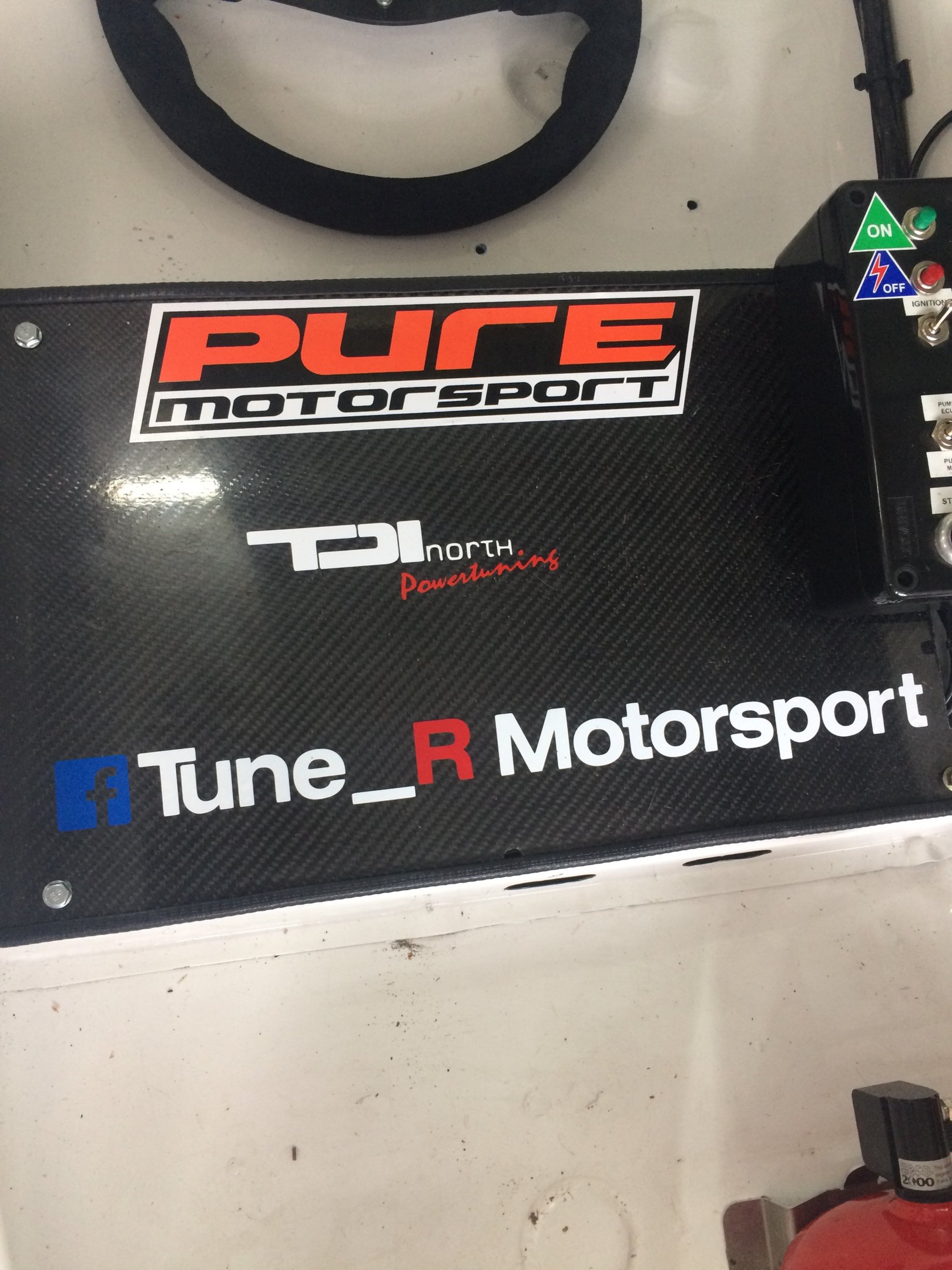

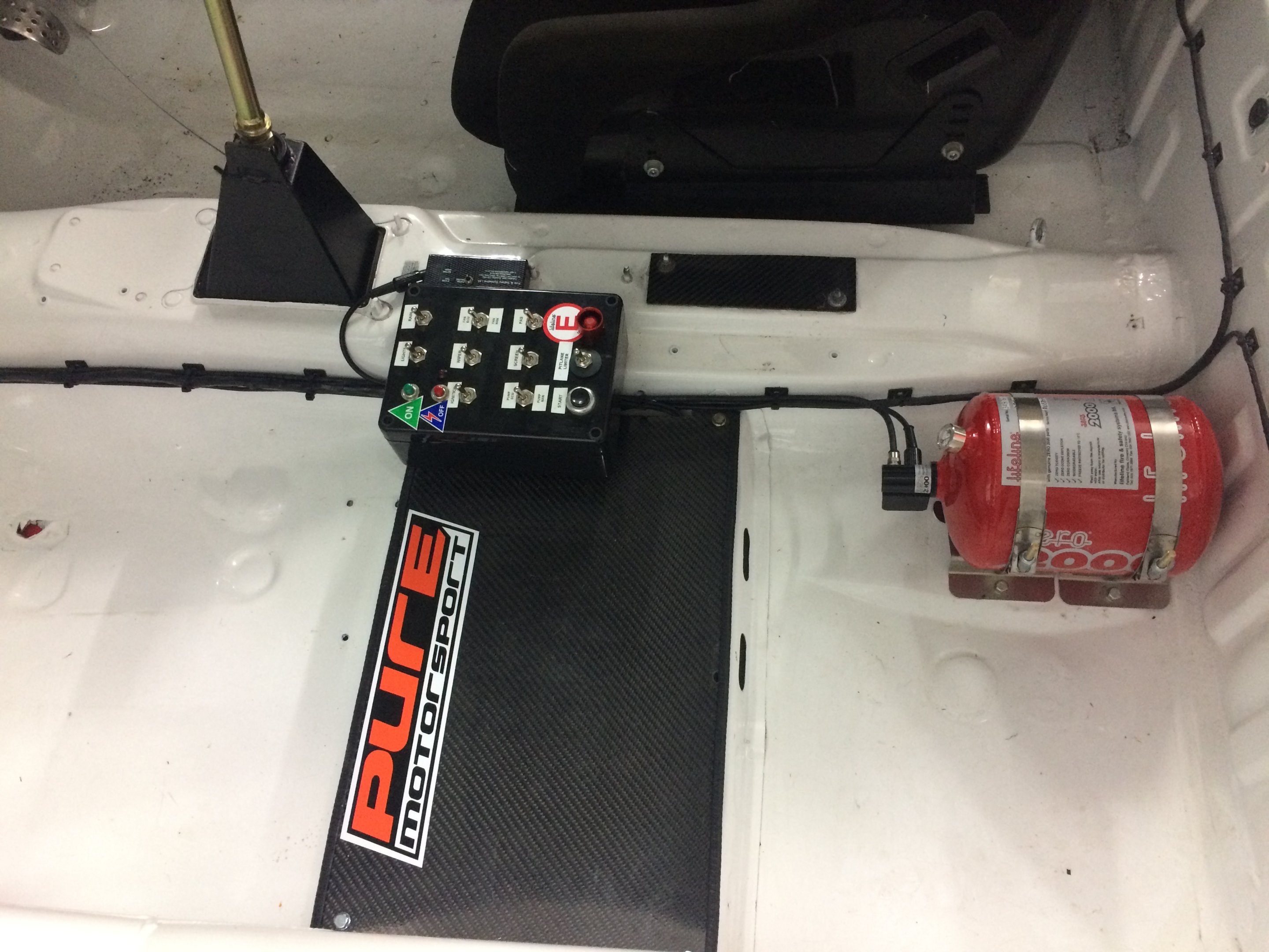

Dta S40 on my car, get rid of everything and start again, easiest way. Obviously that loom that nick at Pure motorsport does is just the engine loom you’ll still Need to re-do everything else. One other thing is you’ll need a new dash/instruments as the oe won’t work without the uch and Ecu.
All electrics live under here now and dta is under the scuttle.
Russ
