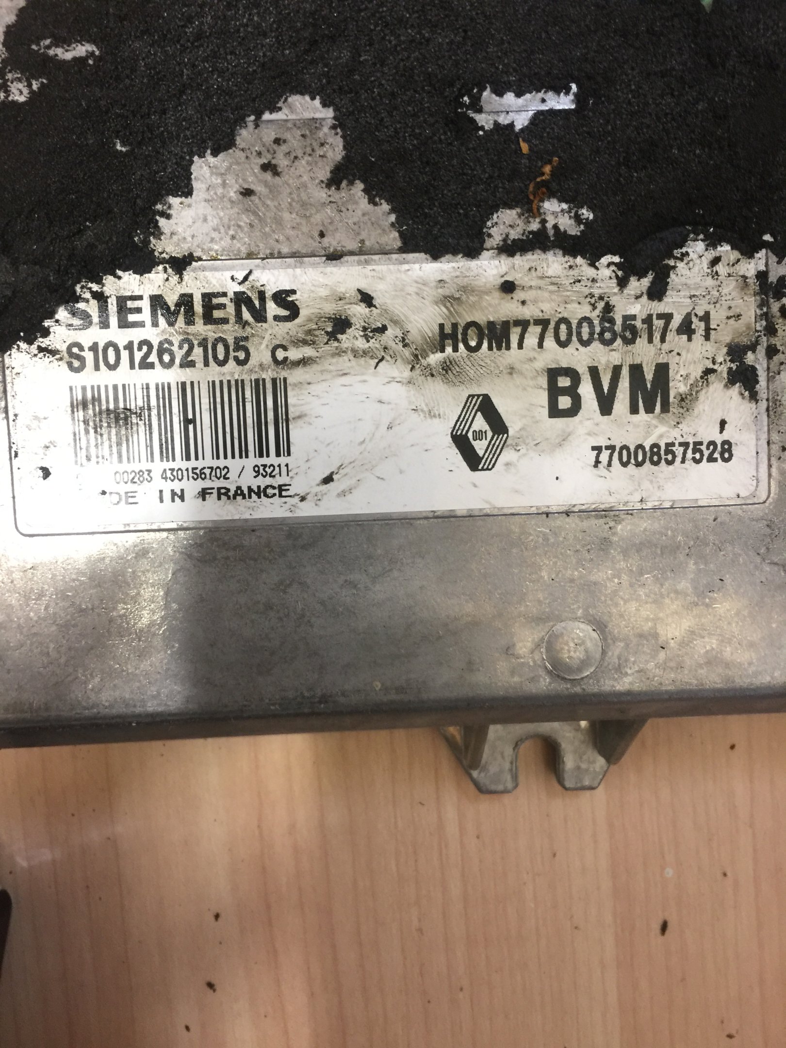

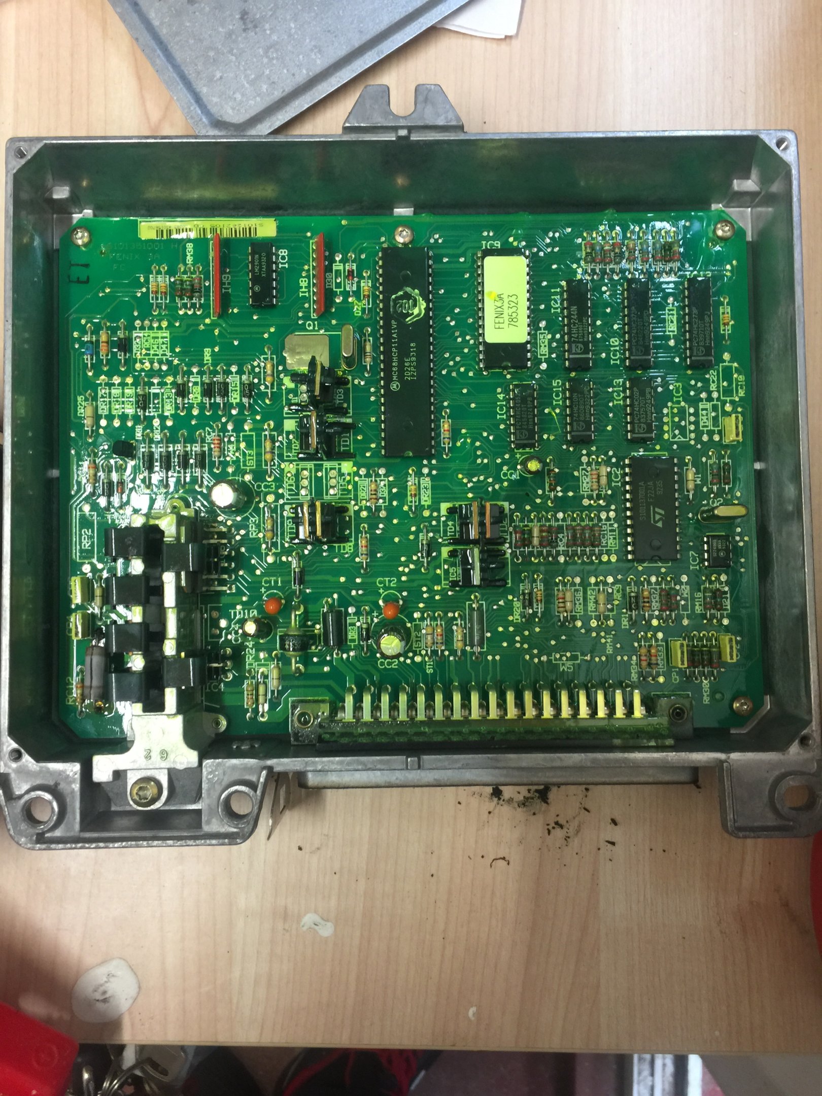

Problem I have, my ecu inside is like a big square chip, where as the one I've seen on eBay
(mk1 1.8 16v) ecu is a little different shape inside...

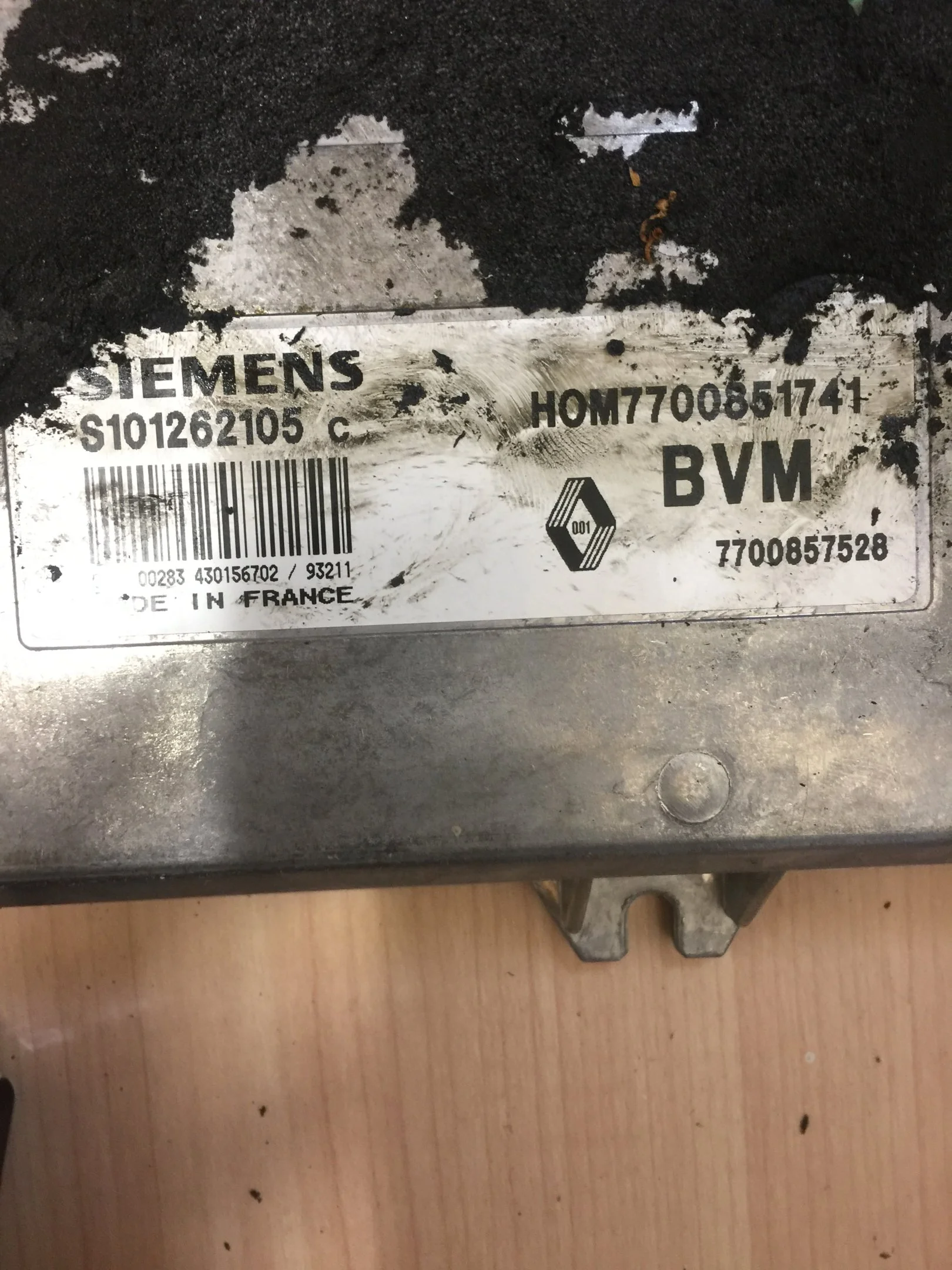

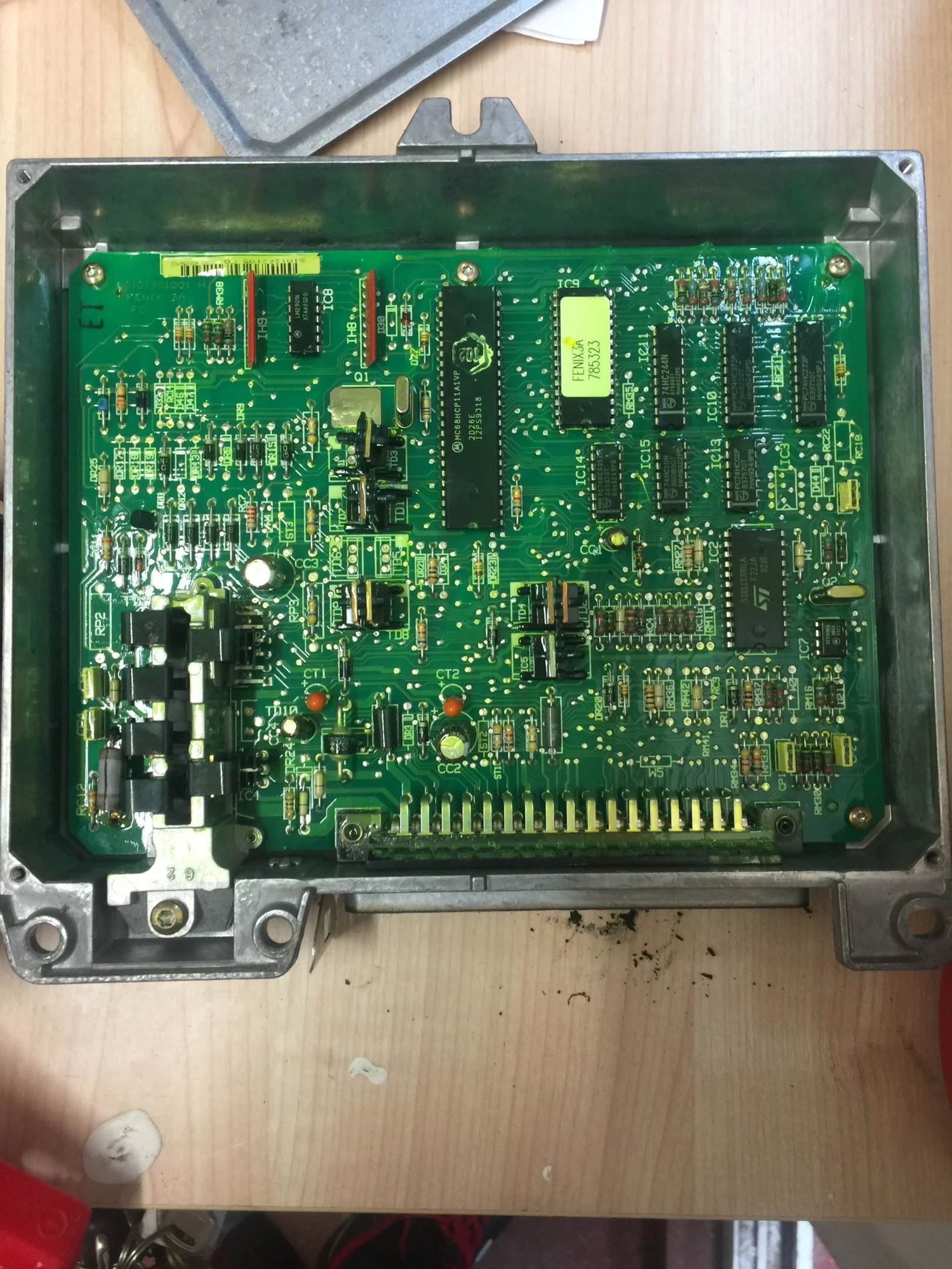

So I'm wondering if mine is a 2.0 Williams ecu? Il upload mine

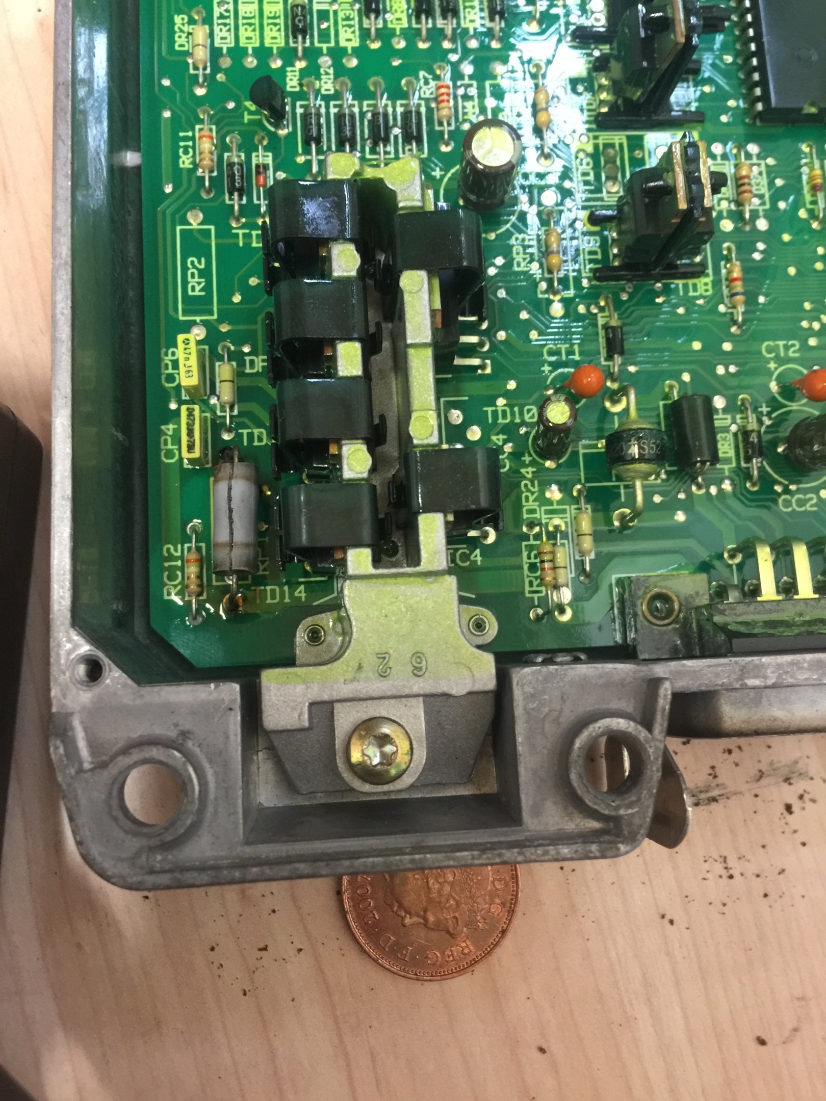

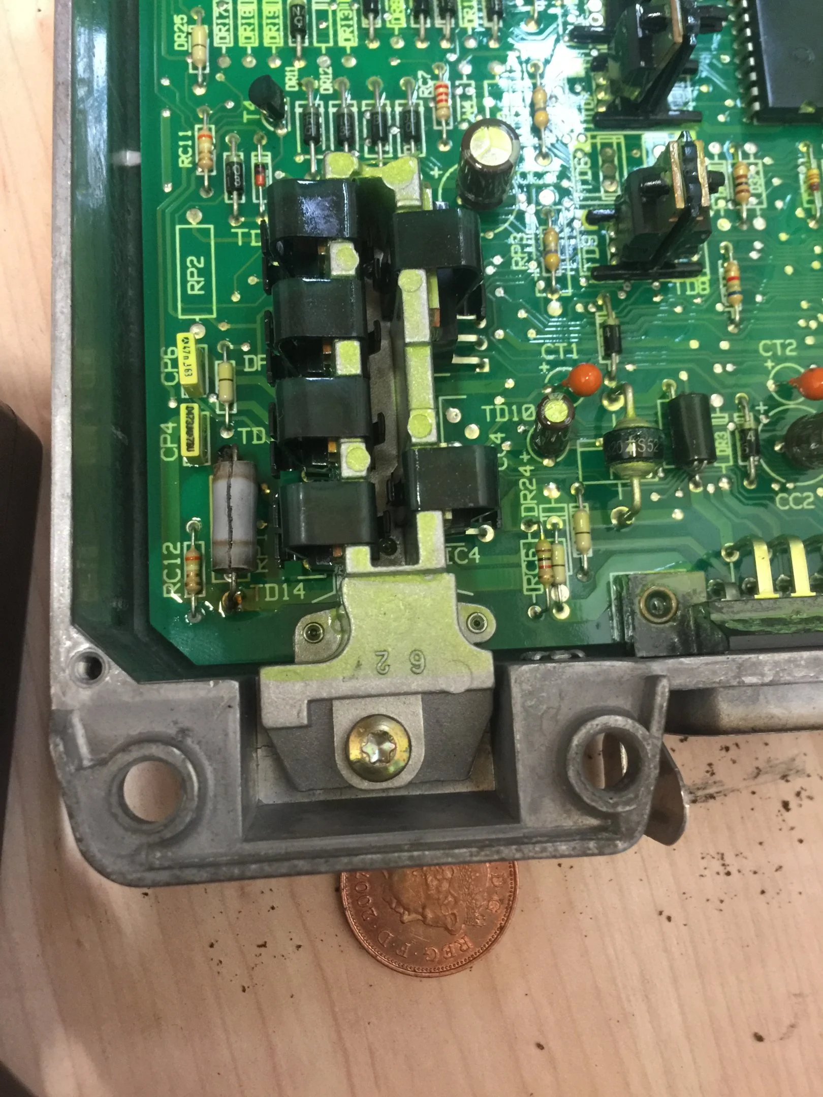

Also if you soon in you can see the burnt out capacitor, does anyone know if this ecu is 2.0 or 1.8? Thank you
Doing a quick Google of those ecu part numbers and it comes up as a clio /r19 1.8 16v ecu. And your board hasn't been socketed to enable eeprom swaps. So I'd say that looks like a standard ecu

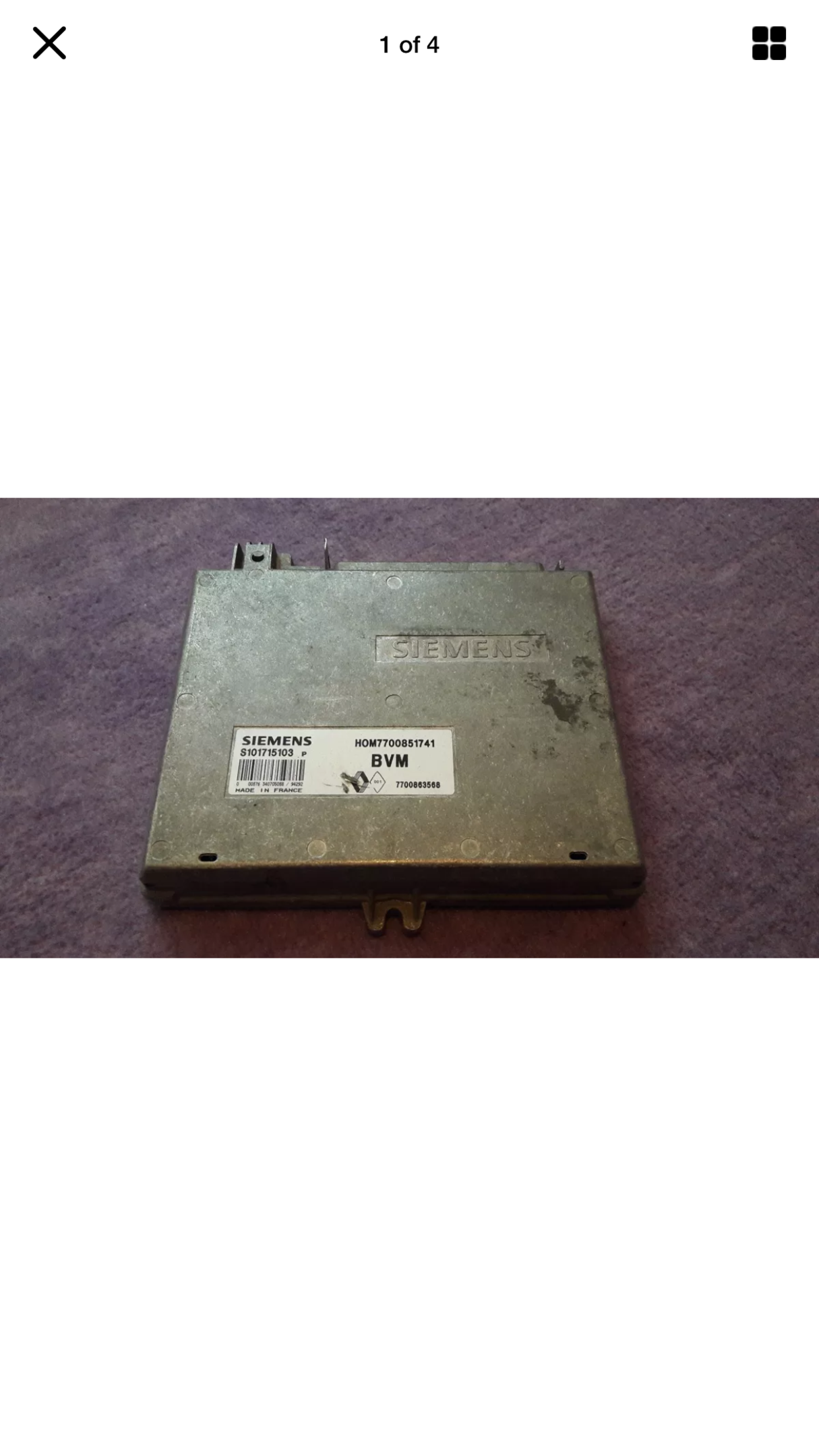

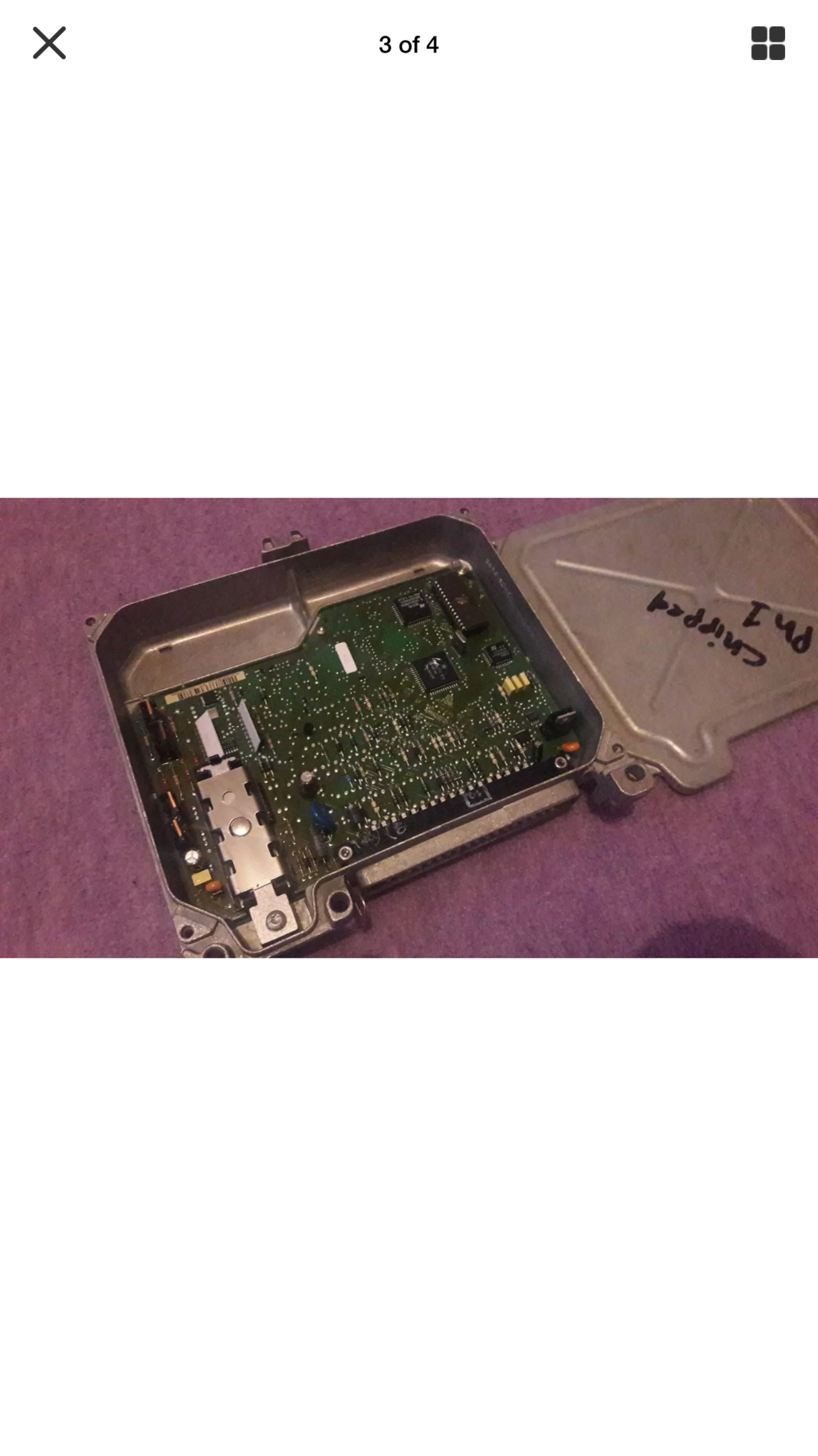

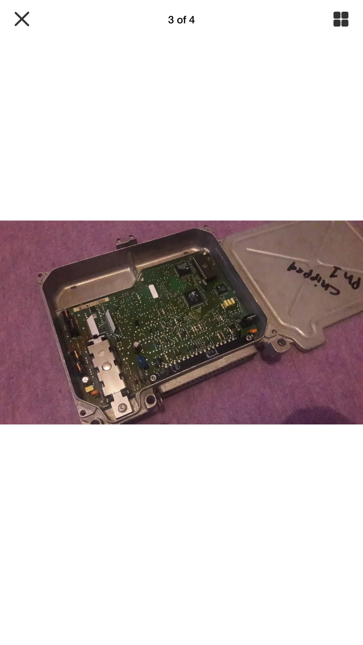

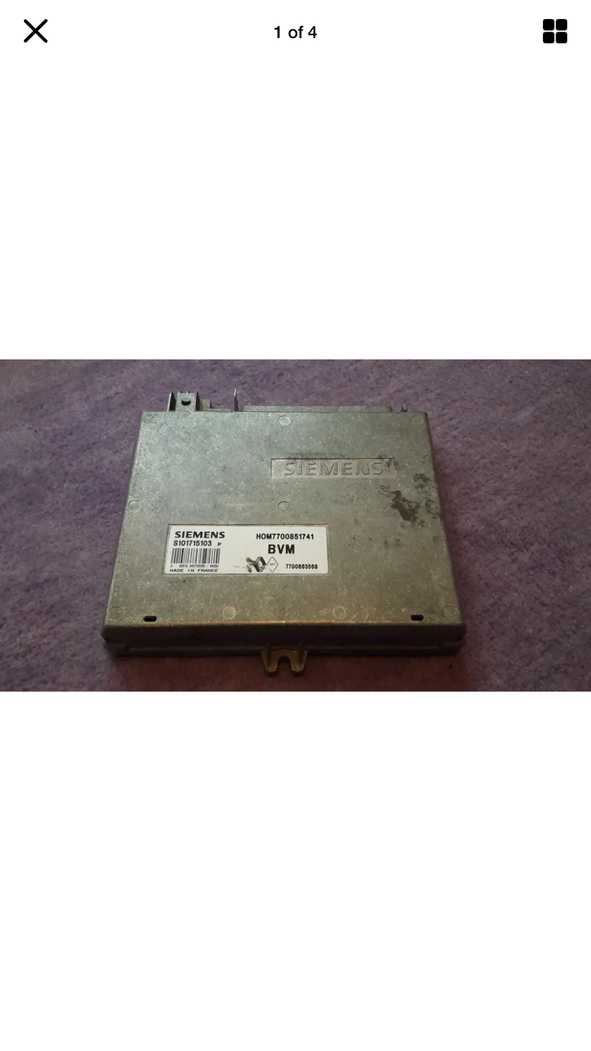

Thanks for your help. If you have a look this is he replacement ecu I'm going to buy, however if looks different shape to mine? Il attach photos, this also has a sport chip or something apparently, I'm not to bothered about that il just be happy to have it running lol. Do you think this will run my car even though it's slightly different?
The problem is you don't know if the one your car came with is the correct one. Someone who knows the part numbers better should help. Or phone a renault dealer and ask what the ecu part number is
