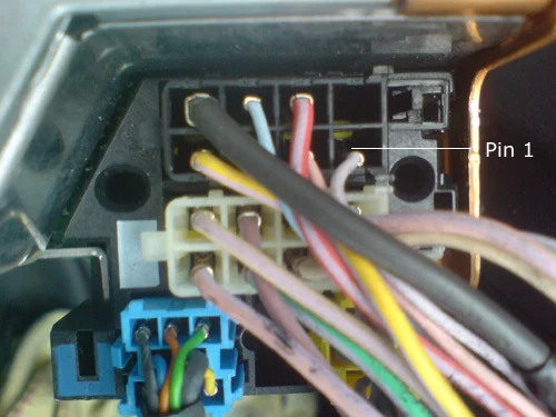

I got it in atm but cant find the bits to plug in my wires from the amp it is most annoying any help?

Yes it will work with the standard head unit, you need to find pin 5 on the black connector. pin1 is arrowed and 5 is the one three to the left of it.
The layout is:-
8-6-4-2
7-5-3-1
