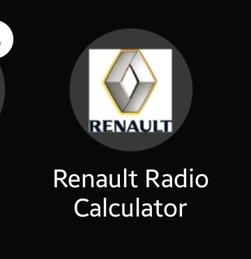

I have an app on my phone which scans for the code. If you send a picture of the bar code on side of the stereo I reckon I could get code for you. Sure there are some free sites too.
Krarl
Aye if you're an Alpha male and have an android then you'll be able to get a free app for codes
RustyMojo
Bon Jovi Officianado
There is an app in Apple store for Renault radio codes
It’s free to download and use
