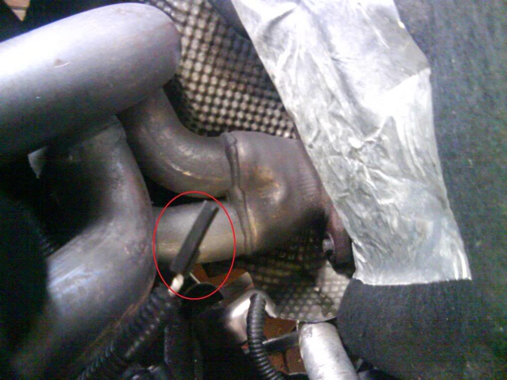

Whilst messing under the bonnet this morning I noticed this plug was disconnected in the image below. This must be the reason why my starter motor won't fire. I've tried to look where it could plug in to but can't seem to find where it goes.
thats the starter solenoid wire! Goes from your key barrel to there, and engages the motor.
It goes onto a spade connector on the top of the starter motor solenoid, bit fiddly but is doable with a bit of patience.

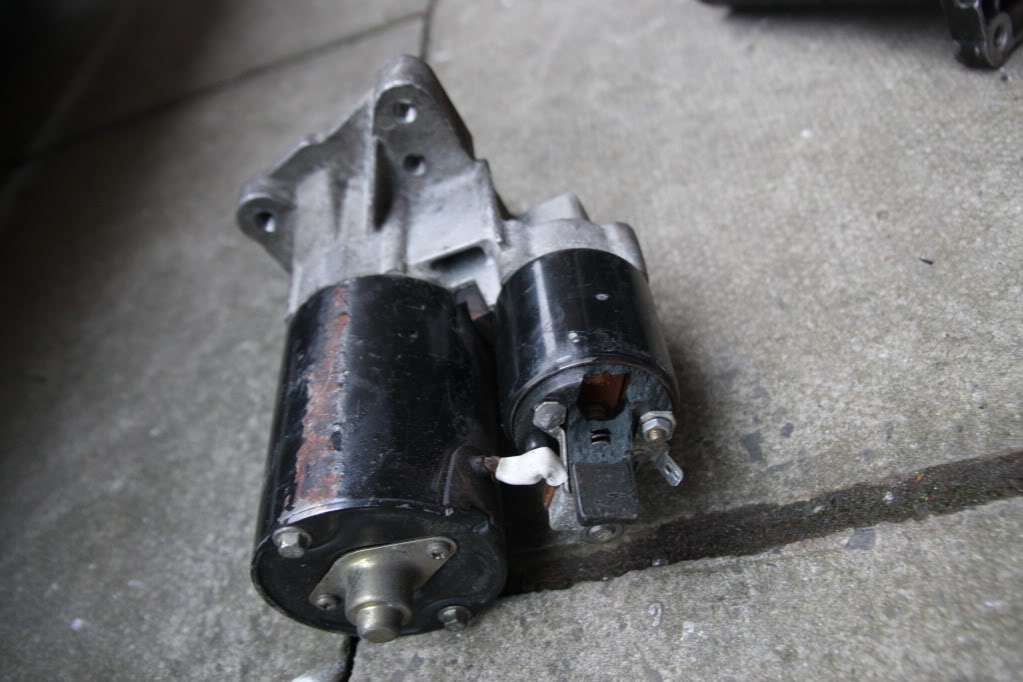

You can see the spade pin on here...

How's yours going mate? Had much luck with it? and cheers but I don't think it's my battery that causing my problem after finding that disconnect plug in the image above.
So that's definitely my problem then?

Easiest way I found is put your hand in flat, under the manifold but on top of the starter from the gearbox side....you will be able to feel the little spade connector then and hopefully wiggle the wire back onto it!
I think the spade pin where the plug has come off is bent towards the starter. I can't get anything tool wise in there to try and bend it back so will that mean the starter motor will have to come out?
Probably yes :(
Disconnect the battery, undo the 3x 16mms holding the starter in place and take it out the gap. Sort the pin, connect the solenoid wire before putting it back into place, then bolt it all back together....sorted ;)

Lol, you make it sound so simple, I wish it was though as I haven't really got the right tools for undoing those bolts holding the starter in, just had a look and I can't get the sockets/wrench I have down there to undo them.
