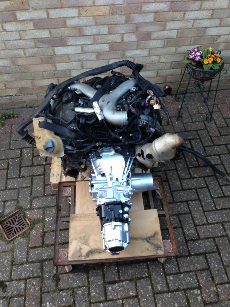

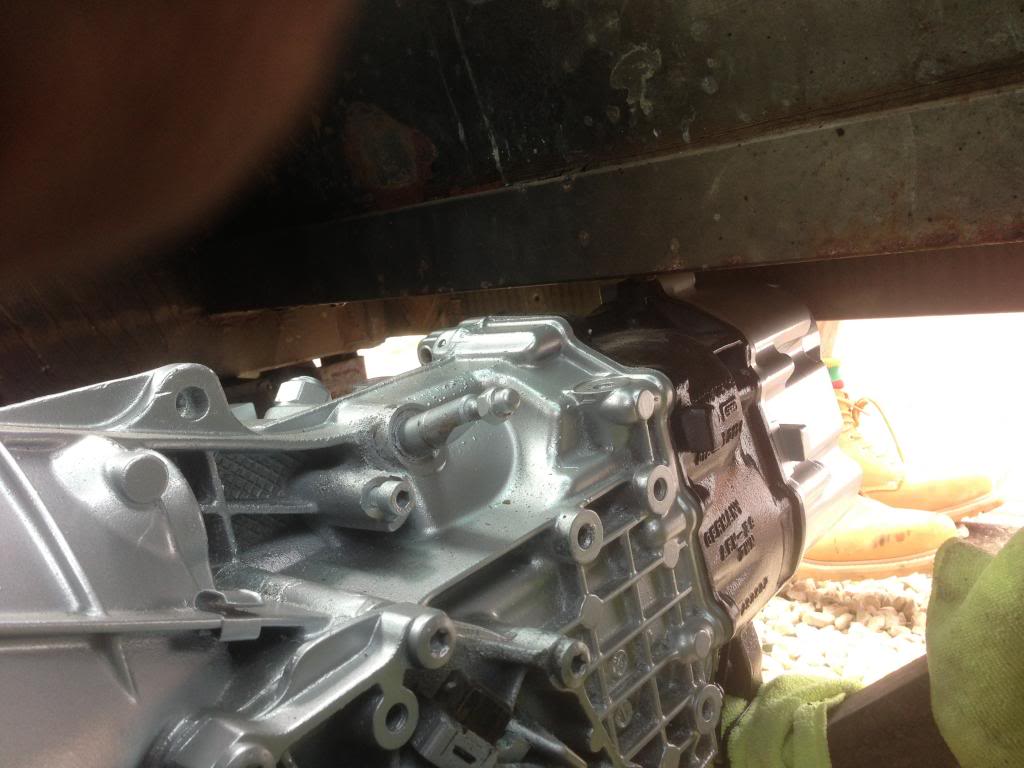

This is the box as I bought it a few months back. Following a good going over, it was time to clean it up good and proper. It was probably clean enough to stick straight in to most, well used engine bays but I have the option of having it on show should I want to cut the centre bar out of the bumper again. Not only that but I'm sure a few people may try and take a good butcher under the car to see how I've mounted the engine and 'box in the way I am. Anyway, after a bit of elbow grease, its now ready to face the music and 600hp should I wish to throw that much at it.
Next job, ENGINE!.......
Will it fit!?
Place your bets now!
This was the first time both engine and gearbox were mated to one another. Was very relieved to find that the VW Passat 'box fits perfectly to the S4 lump. It's just a case of getting the engine detailed where needed and adding a few new parts before fitment. Have signed up to a very good Audi forum which offers heaps of great info along with great build threads. Have tracked down an ecu to get it turning over and now I am seriously looking into K04 or RS6 turbo's. Turns out as they are so cheap to get hold of! With a simple injector upgrade 500hp upwards is very very easy to reach with the later setup. Purely because they flow so much more air at lower boost levels. Would be around 450 with K04's.

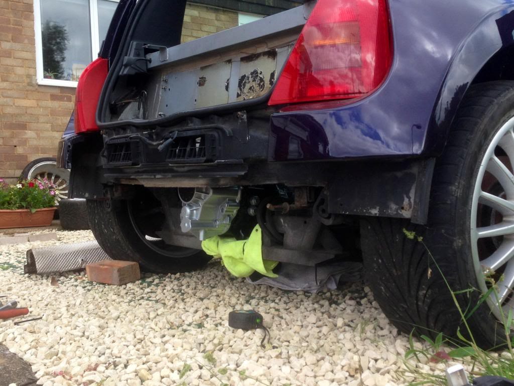

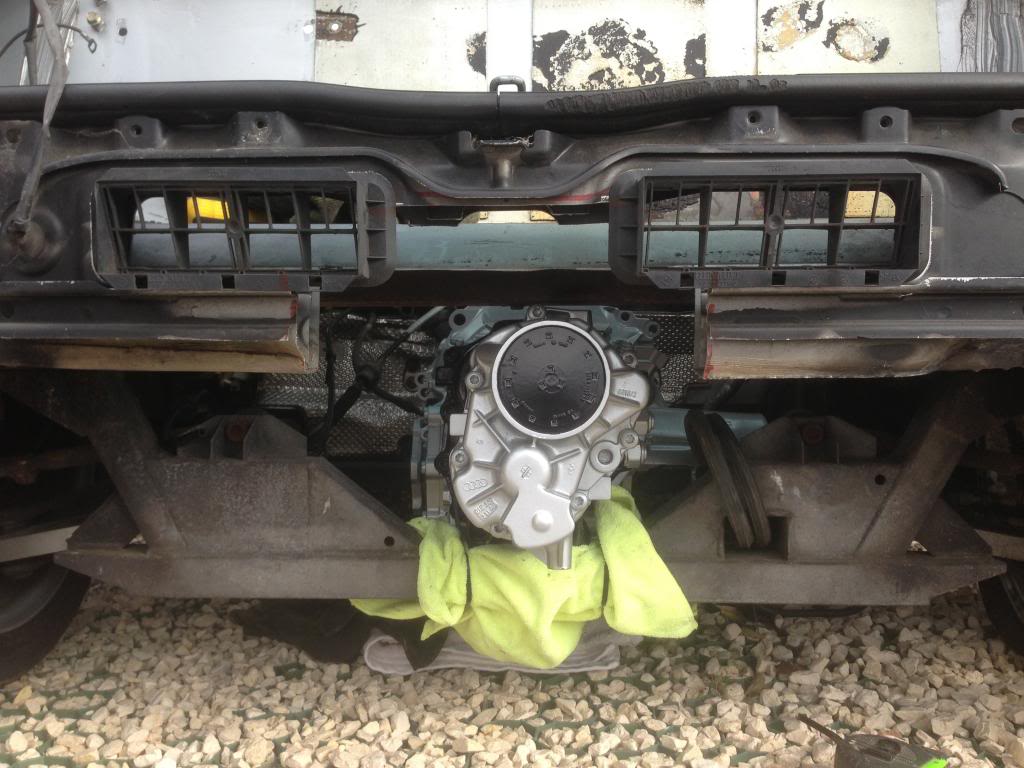

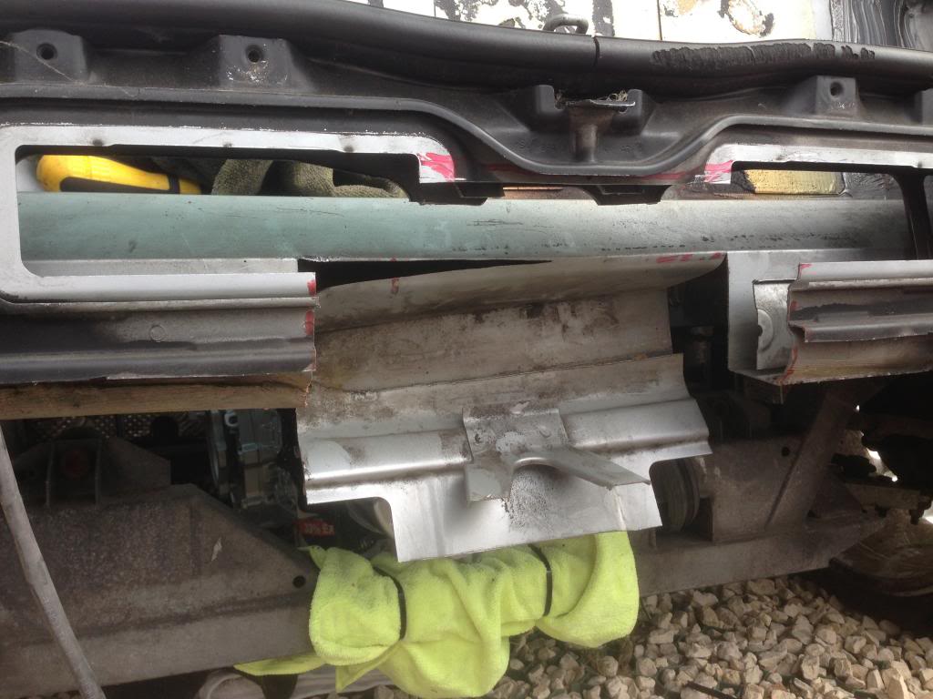

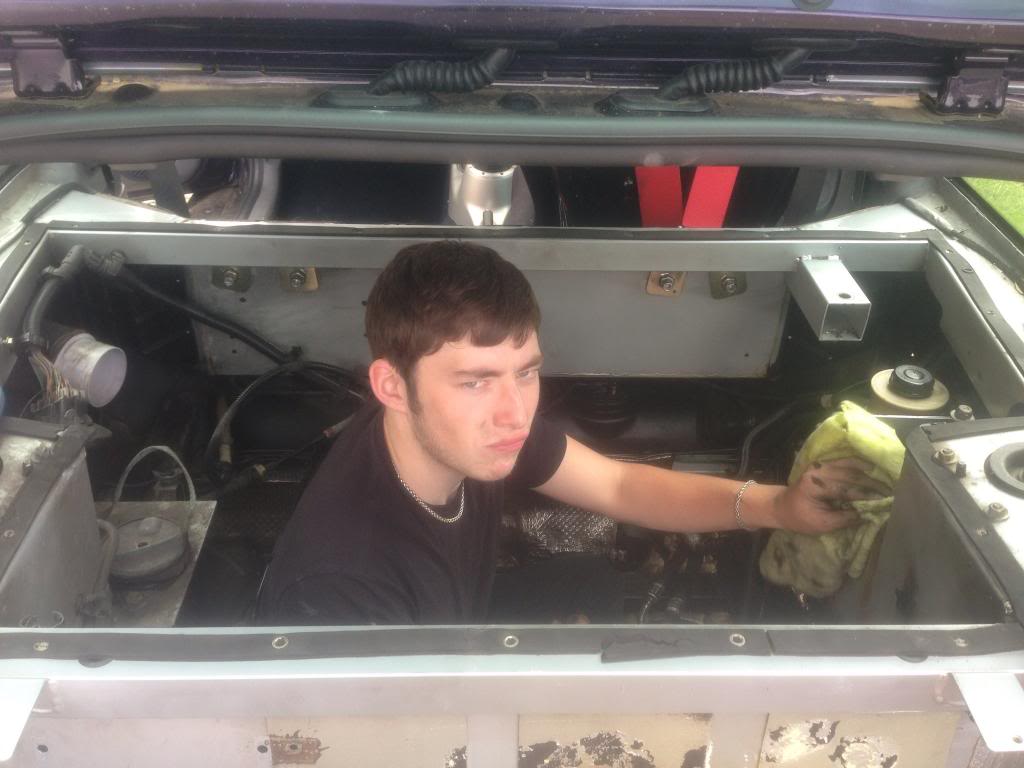

First of all, we hauled the 01e gearbox into the car so we could see whats what. It was then a case of making decisions of what needs what doing to get the the transaxle as far back as possible. Initial signs were great and the gearbox very nearly fit with zero body modifications. However, the main casing is 10mm too tall to fit the whole way back. This meant I had to cut a section out below the boot latch which seems to add little or no strength to the back end as there are a few 2x2 box sections going from left to right. Yes these pictures look drastic but it'll all be tidied once the paintwork is done.
Out came the tools...
After the dreaded no return point. Bingo! It fits perfectly.
