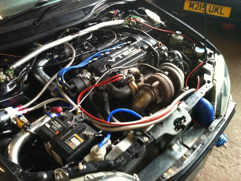

Is that turbo above definatly a HX40. The one I have is much bigger. Might just be a slightly different housing than mine.
