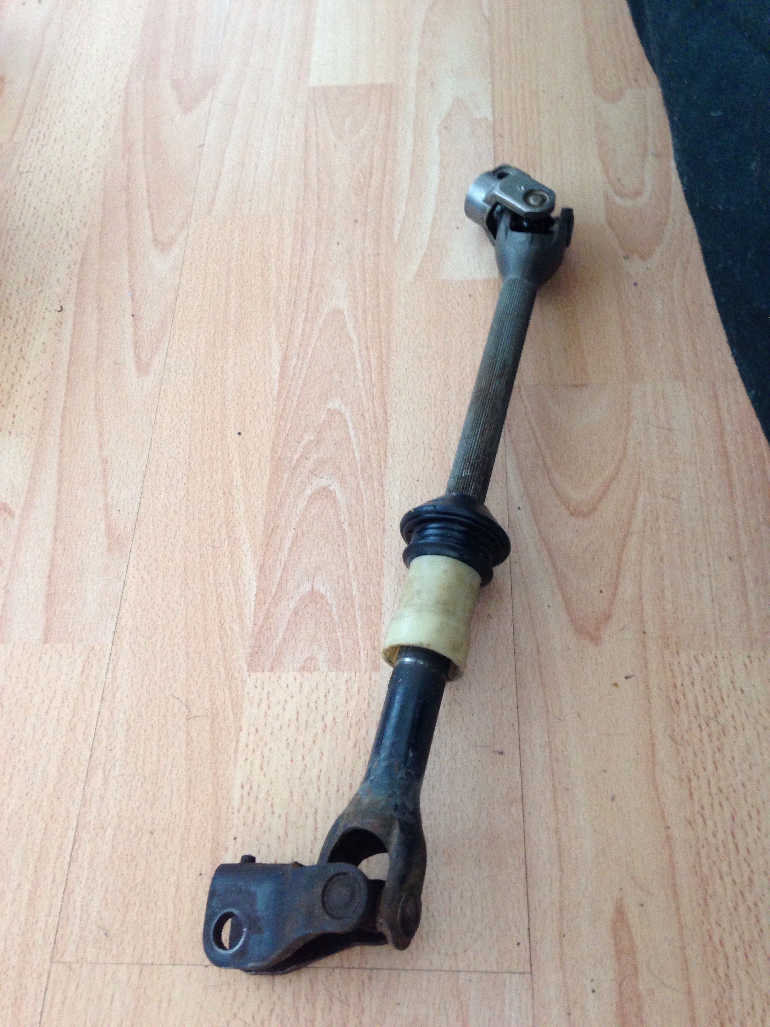

I have removed the steering shaft from the car but the knuckle is well worn cracked in fAct and i cant seem to find another like it think it might be the end off litlle blue unless i can find something soon
  Clio Campus Sport
Here a picture of it , just hard to find a replacement for my model
A picture will help! Just replace the column. It's a £50 part and pretty easy to fit.

Looks battered ive found one on ebay for £20-£10pstage. But im going to nip to a scrspyard tomorrow try rip one out of a clio downthere thanks for the help man much appreciated
