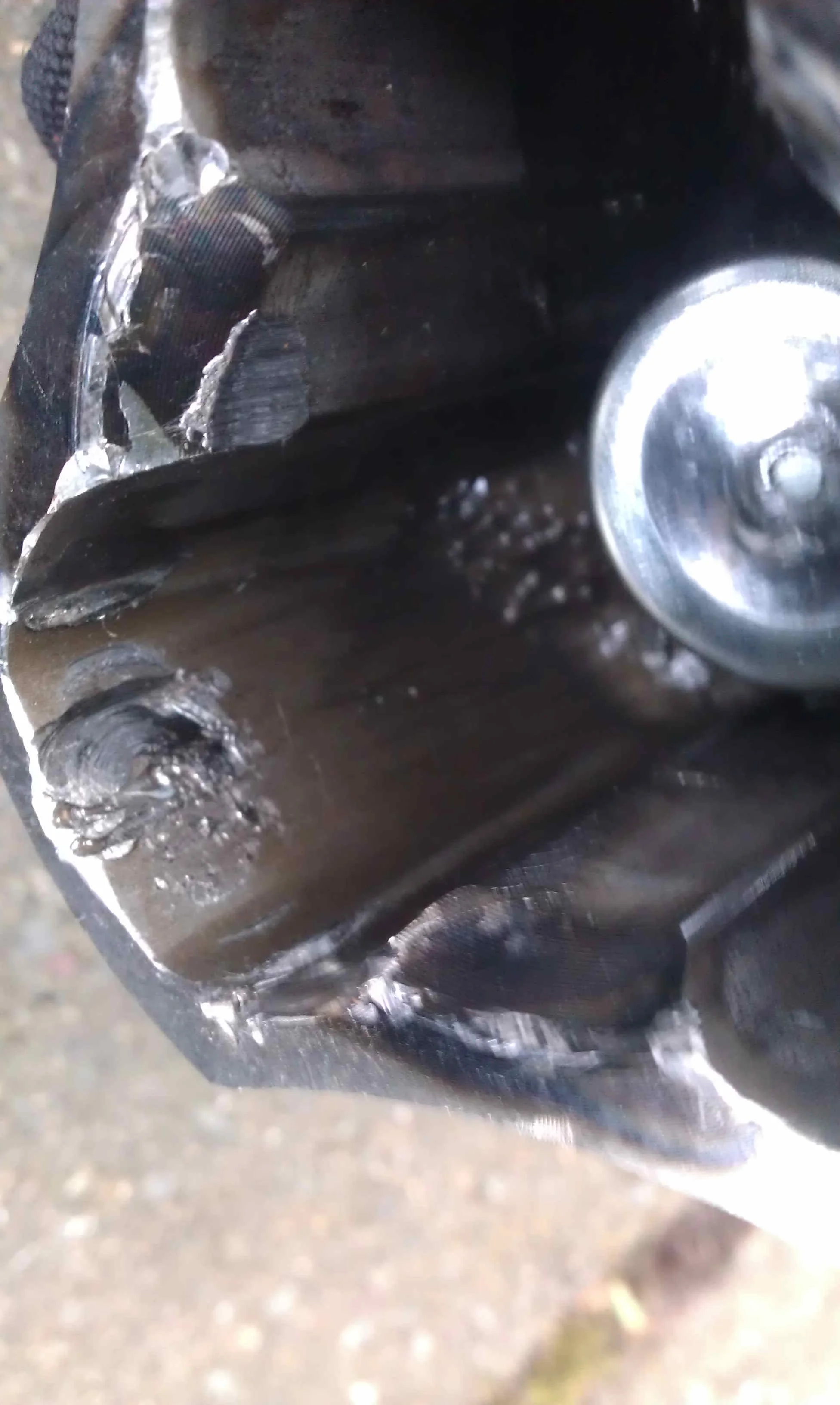

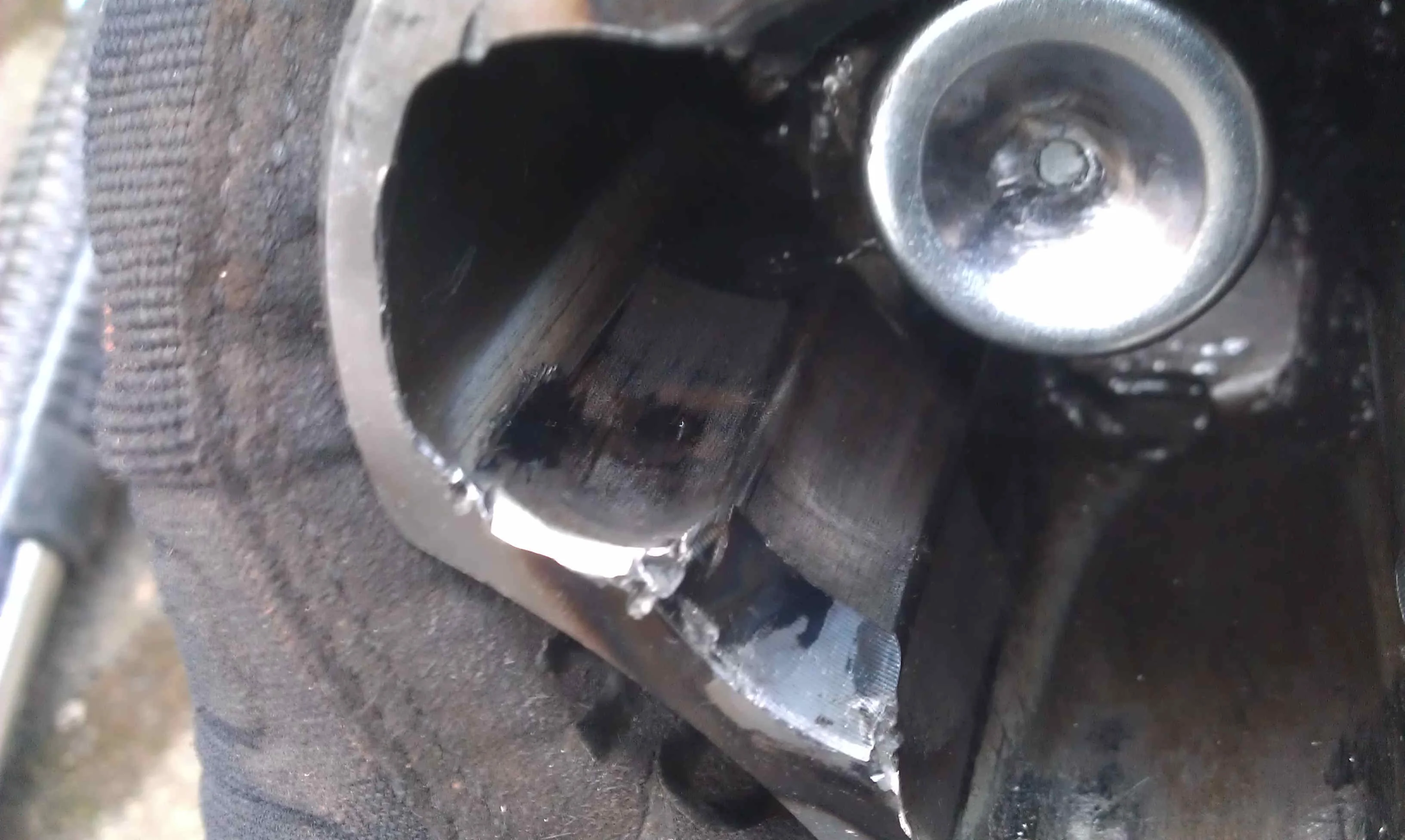

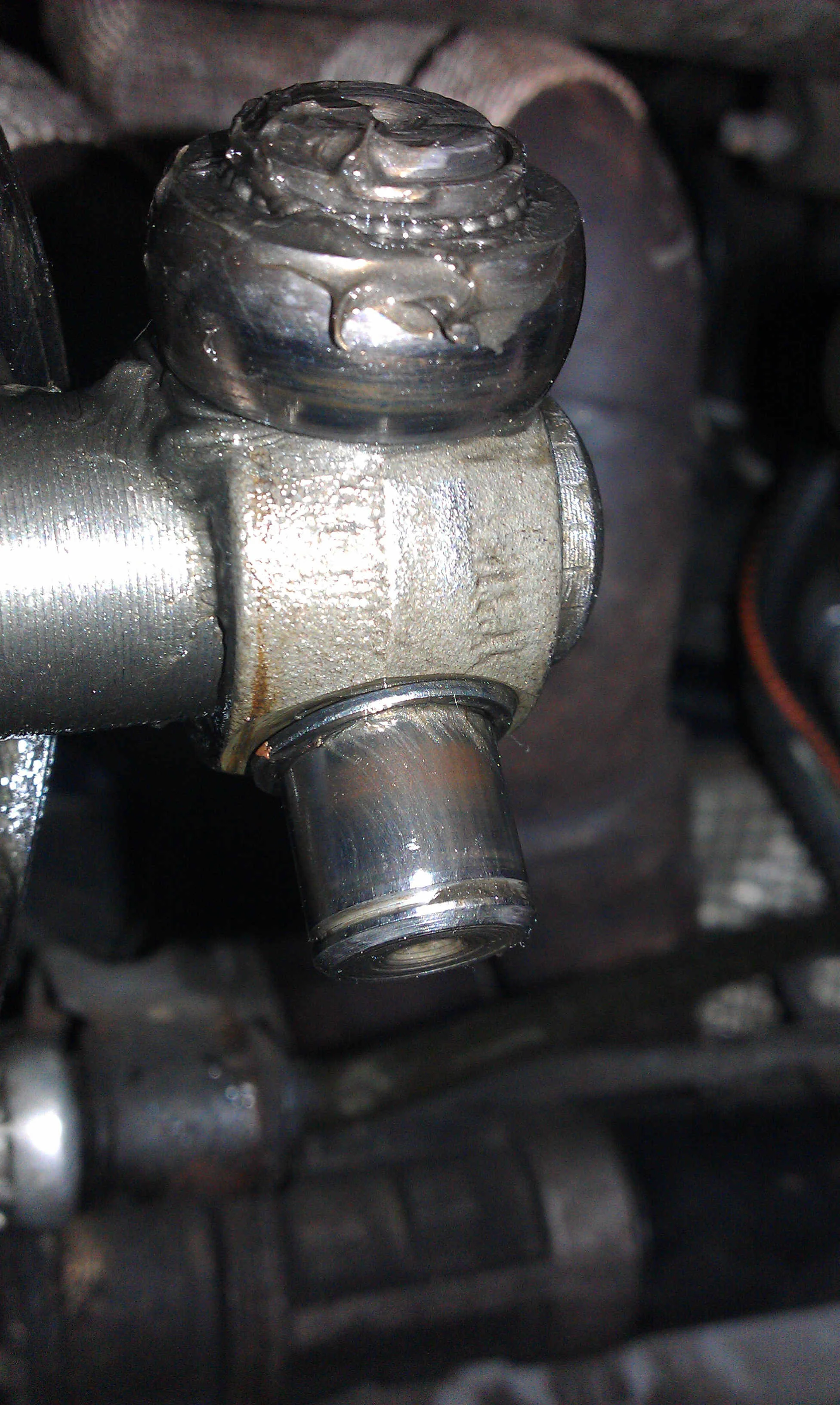

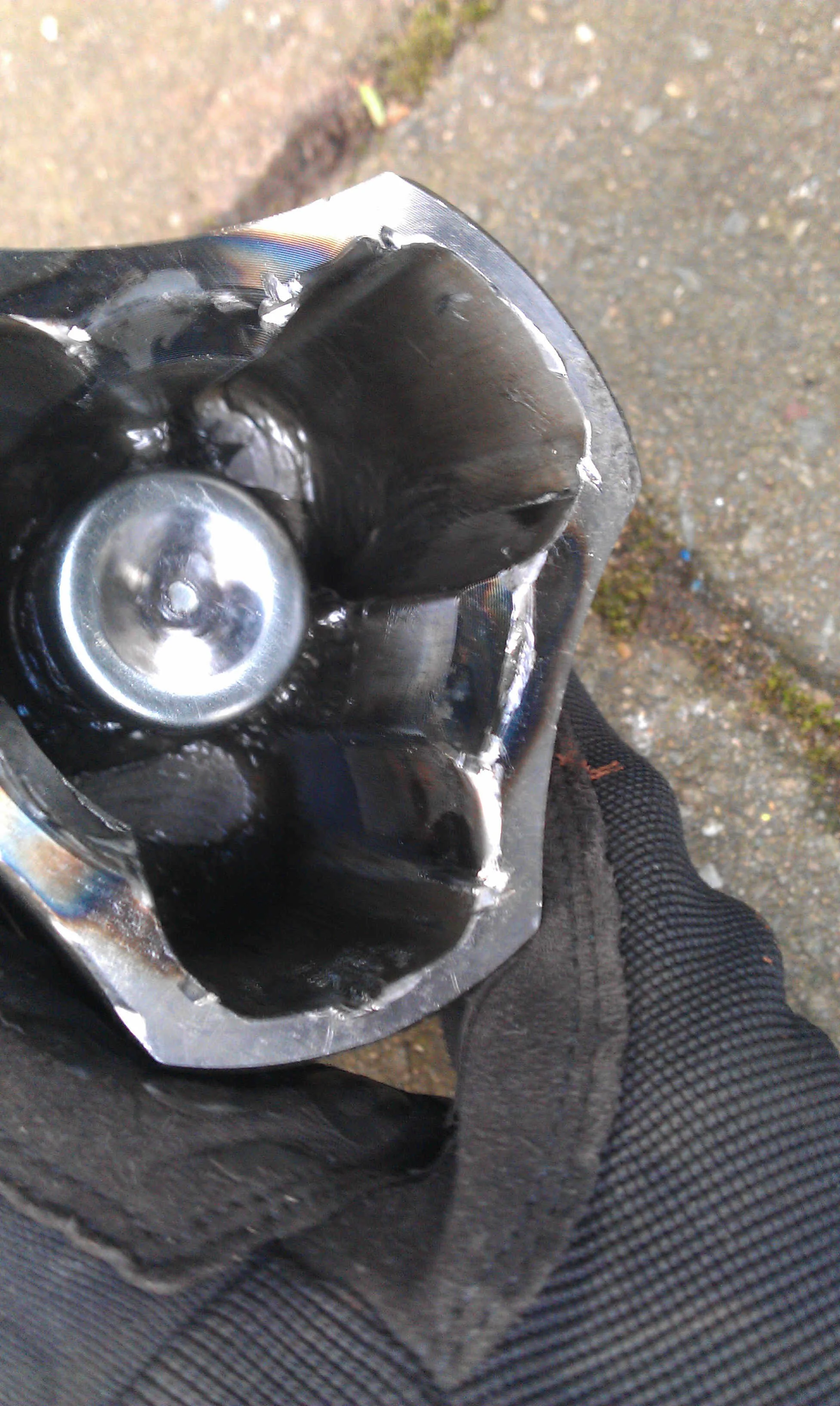

Well I popped the offside shaft off and opened up the inner CV joint. All the grease was grey/silver with swarf everywhere, here are the findings:
Gouges and scoring
And the actual cause.
