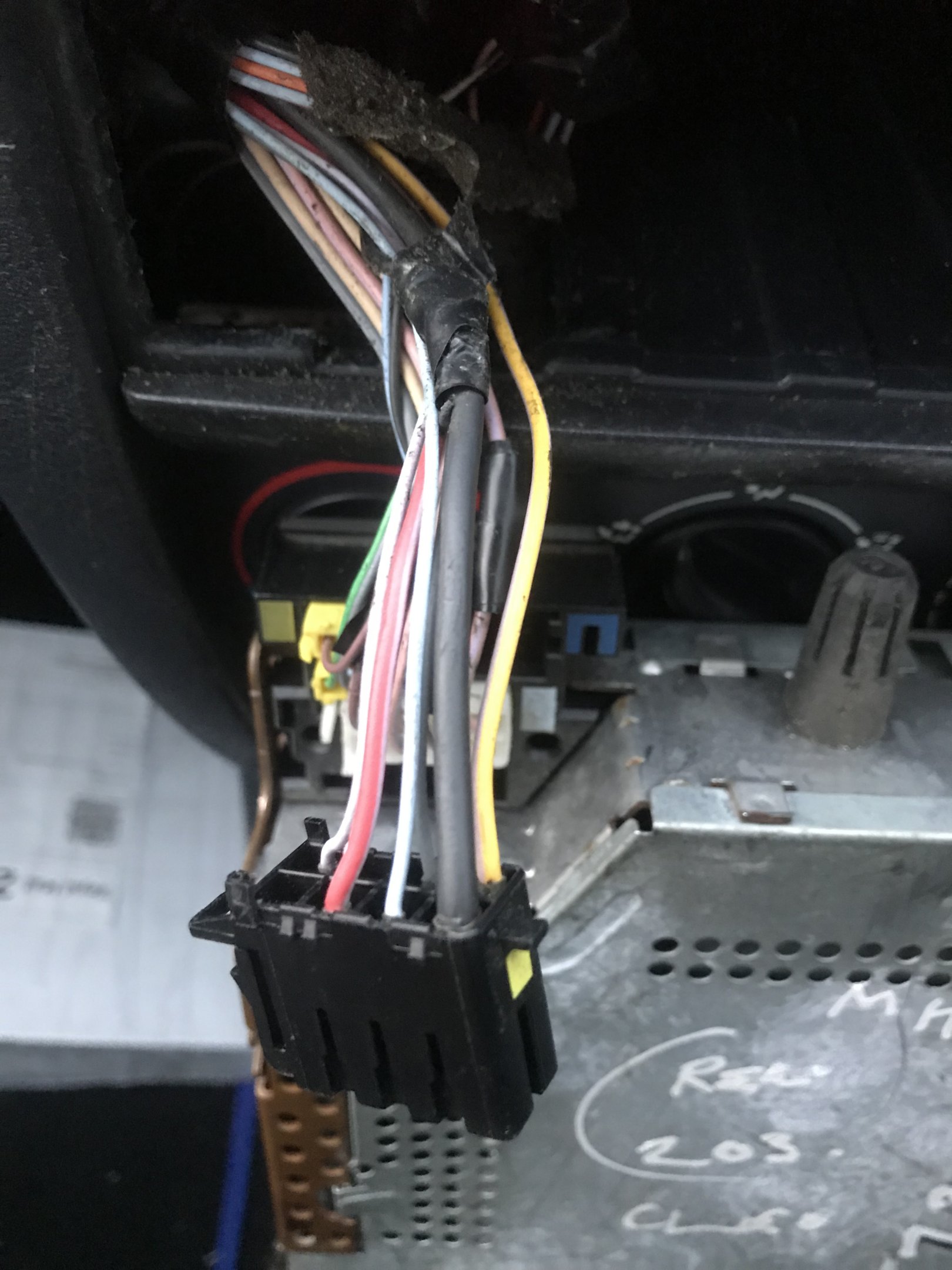

I managed to get the radio back out. Two bits of coat hanger worked great btw. I can’t see any bullet connectors on the loom, it looks like the standard Renault loom. So I’m not sure why it won’t work perfectly with a standard head unit.

Check fuses, im sure ive heard when a fuse goes it can cause the stereo to stop on.
I checked the fuses and they where all ok. Strangely enough it seemed to fix its self after having the heaters on in the car so im guessing some of the wires at the back or the stereo itself got damp and where causing it to play up
