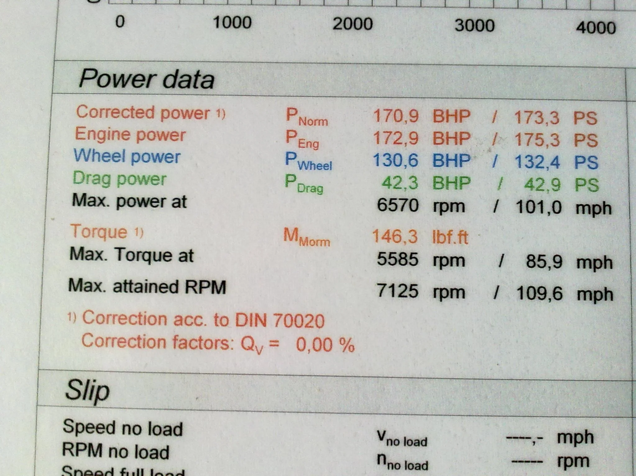

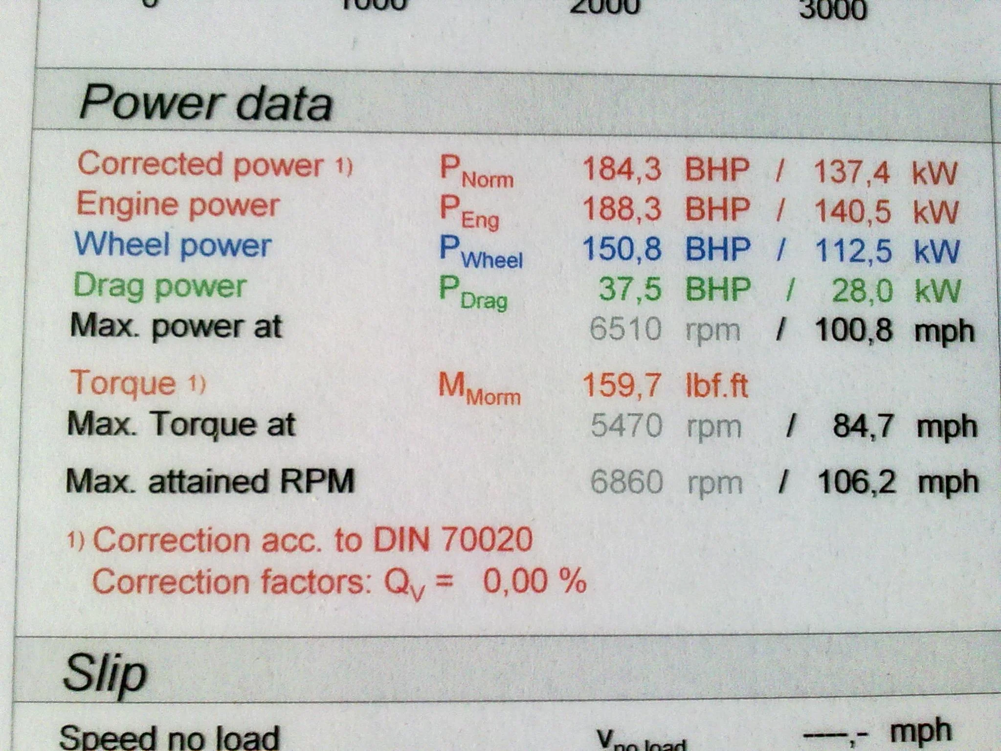

bog standard as it left the box vs 182 manifold, matched inlets and k-tec stealth
best mod i done.
