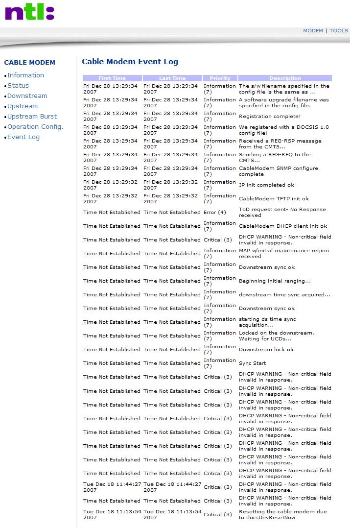

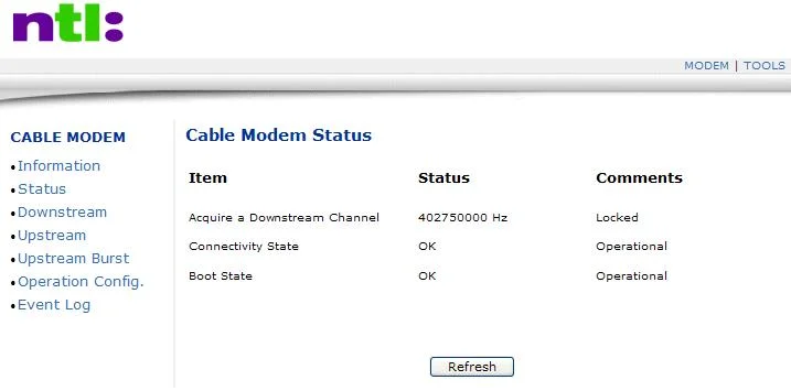

Log into your modem and see the 'erroe' log and status screen.
Post a screenshot here.
To log in, type 192.168.100.1 into your browser, modem dependant on how you log in.

Oggy - here you go chap as requested :
2 screen dumps...
"CABLE MODEM STATUS SCREEN"
and
"CABLE MODEM EVENT LOG SCREEN"
Problem solved - called a sneaky 0114 tech support num from "saynoto0870.com" and it turned out that the outage caused my mac addy to be deleted from the system... in other words, virgin were sending a signal to nowhere...
