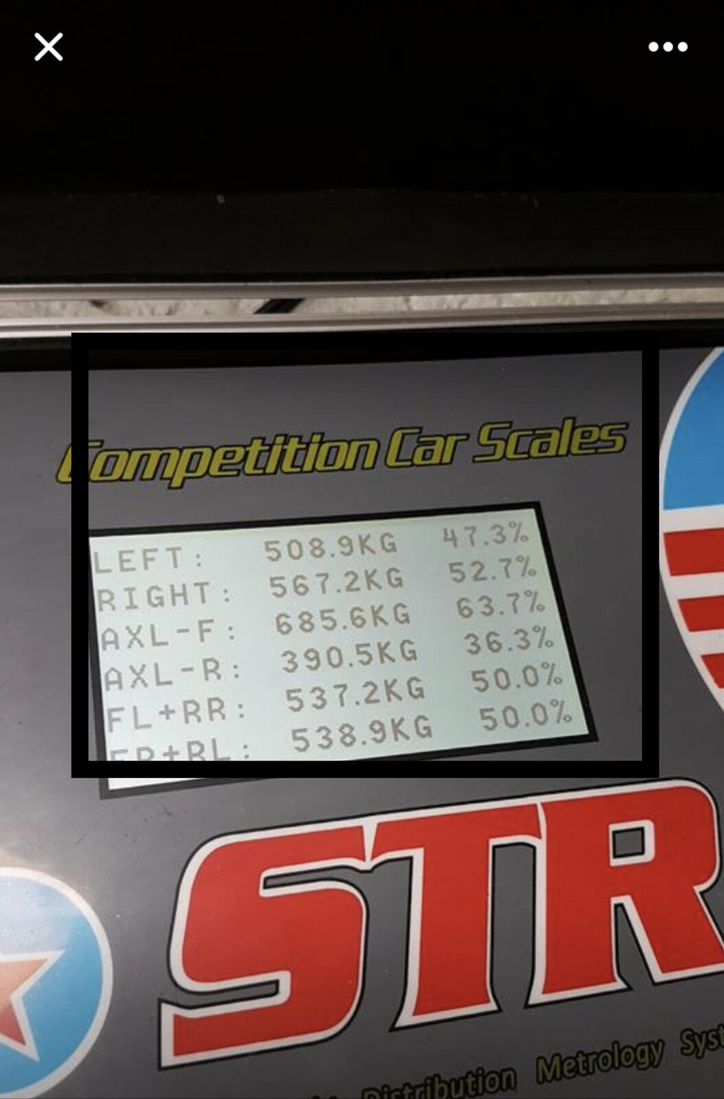

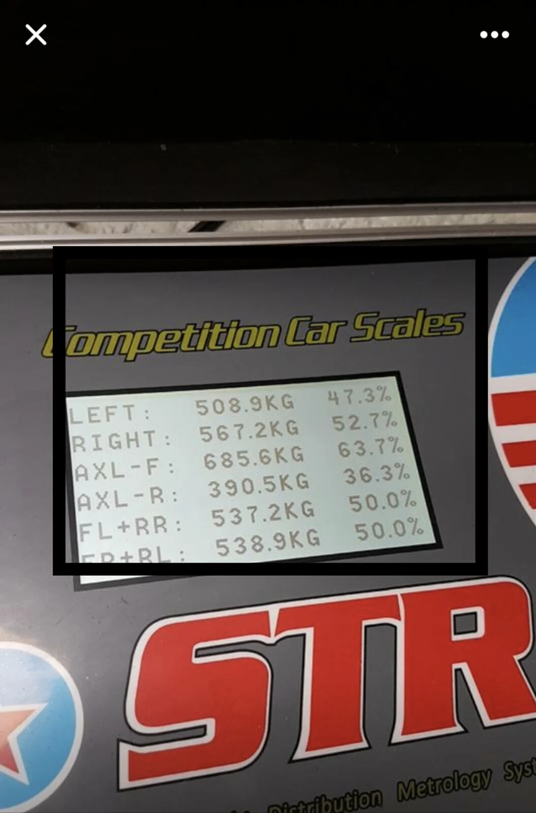

That’s with me at 80kg, quarter of a tank of fuel.
It’s striped apart from head lining,radio,full dash.
Safety devices 6 point roll cage, painted interior, throttle bodies, cup alternator, brackets and tar removed, bucket seats x2, light weight battery, fire extinguisher, coilovers on rear and all steel panels and glass. Aluminium bonnet.
If I find or win lottery I’ll be going grp panels and windows.

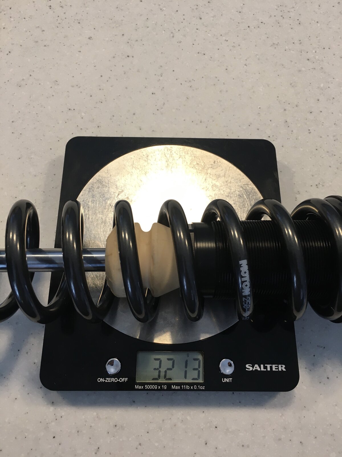

Did you actually weigh the rear coilover vs the separate spring/damper setup?
Just interested to know if there was actually much difference? 🙂

4 pots and 2118s aren’t exactly light either lol.
Just because it happened to be sitting there. I’ve just put a rear AST 5100 on the scales. 3.2kg
Perhaps if I remember I’ll weigh a cup damper/spring when they come off.
