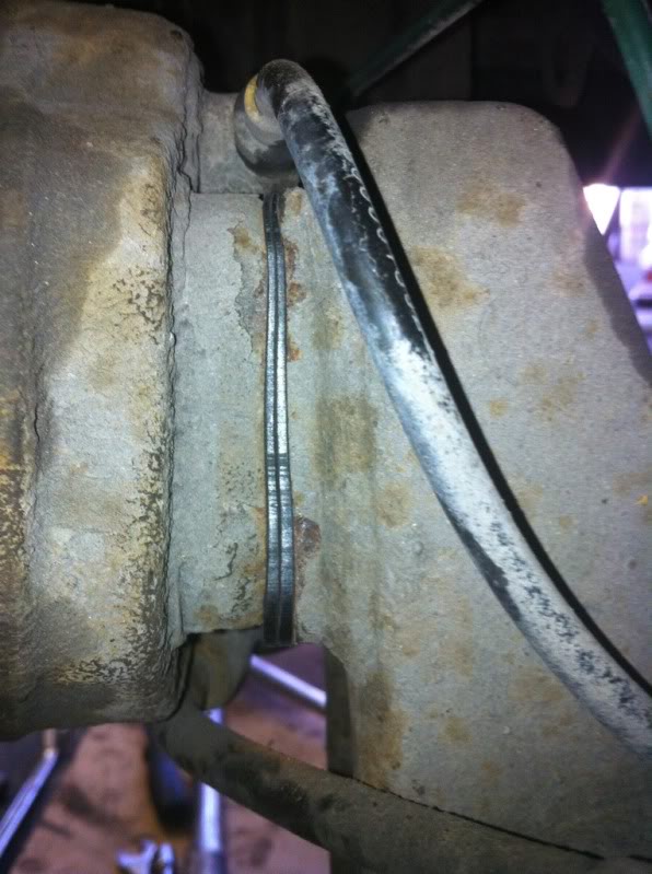

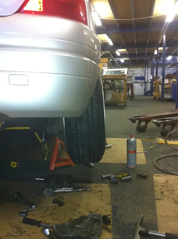

Hey guys fitting camber shims yo' and just come to tightening the rear stub axle bolts up but I'm not sure how tight to do them. Anybody know?
Btw I'm talking about the 4nuts that hold it all on that go through the camber shims
Help woyld be much appreciatde or they are just getting the tight as f**k treatment !

tight as f**K treatment isnt good, its plastic so itll deform and lose your camber! when i did my polo it was torqued to 44nm, scary but safe according to ez-shim!
  ph1 mk2
because your adding camber, the hub becomes on an angle to the axle, and so when you tighten it, the bolts try to straighten the stub axle out in line with the axle, if you tighten it too much itll distort the shim, and squash it flat

They are actually
M10 57Nm
M8 29Nm
