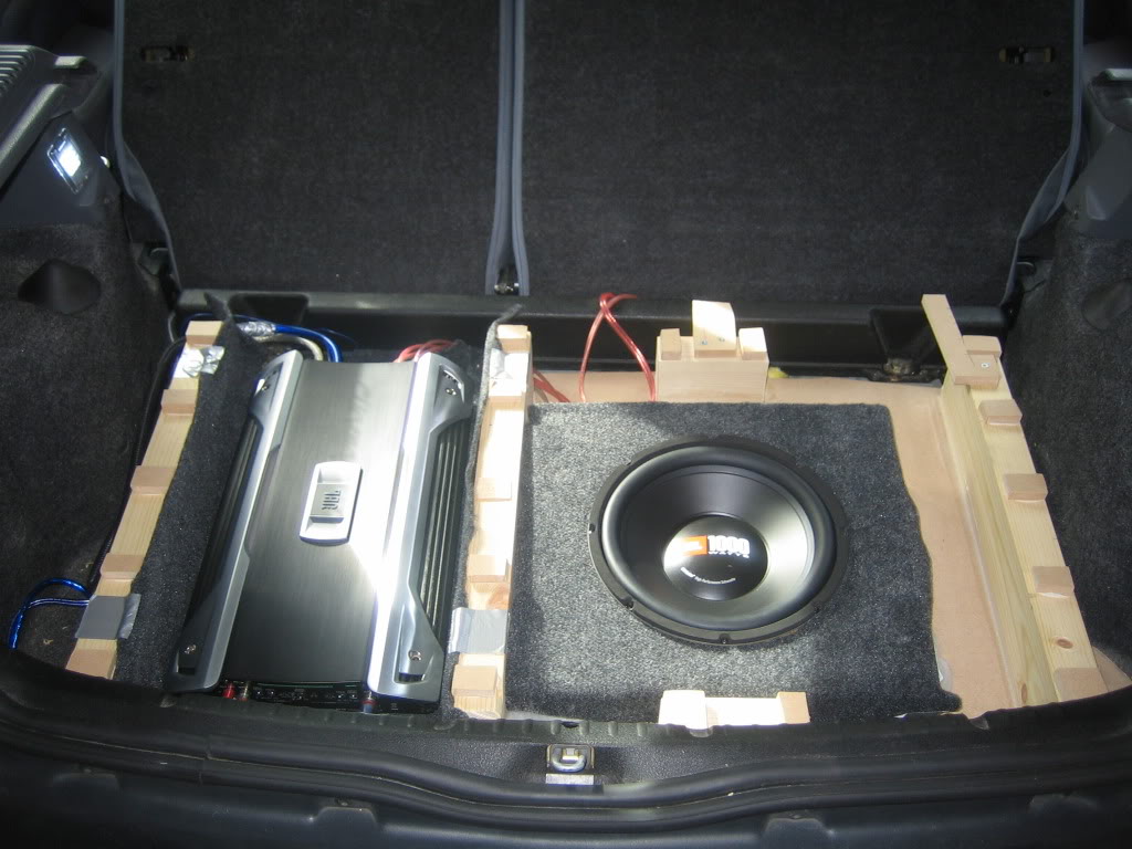

I put a normal sub box in the spare wheel well. Couldnt be bothered with fabricating fibreglass, dimensions and all that. Cut the spike out and in it went. I filled the space around the box with insulation to prevent it from moving around.

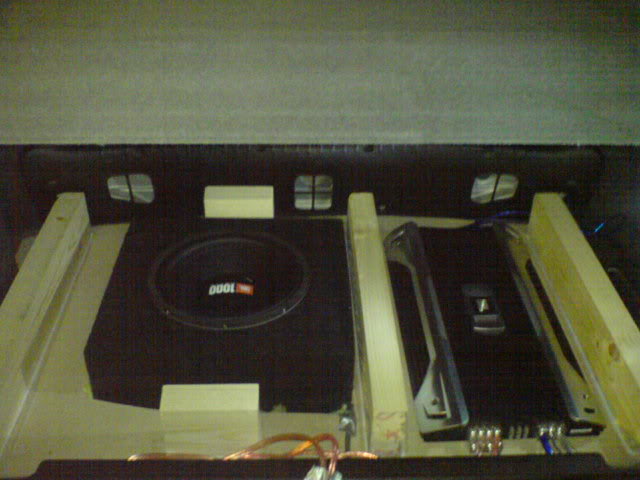

Next step was a raugh template of the boot floor, with a hole in it large enough to fit the top of the sub box through. Screw amp in place. Place blocks of wood to space the raised floor up. Make sure its enough to clear the sub. Supported by L brackets and "sticks like s**t". Drill some holes in them too for ventilation.
Wire everything up. Trim the parts around the amp and the sub. The way i done the false floor was so everything was below it. You could see through to the amp and sub so all bare wood needed to be painted or trimmed.

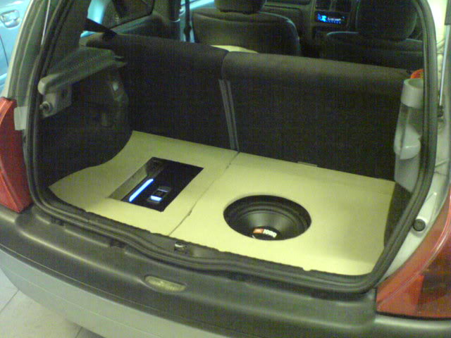

Next step was to fabricate the top floor. Do it in carboard first. then cut to size on MDF. I couldnt fit mine in one piece so i cut it in half. Trimmed it as one piece though so it would fold to go in the car and then lay flat.

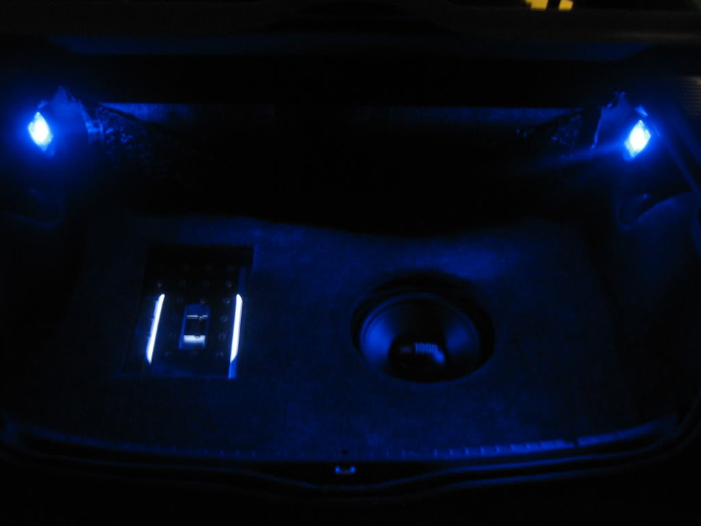

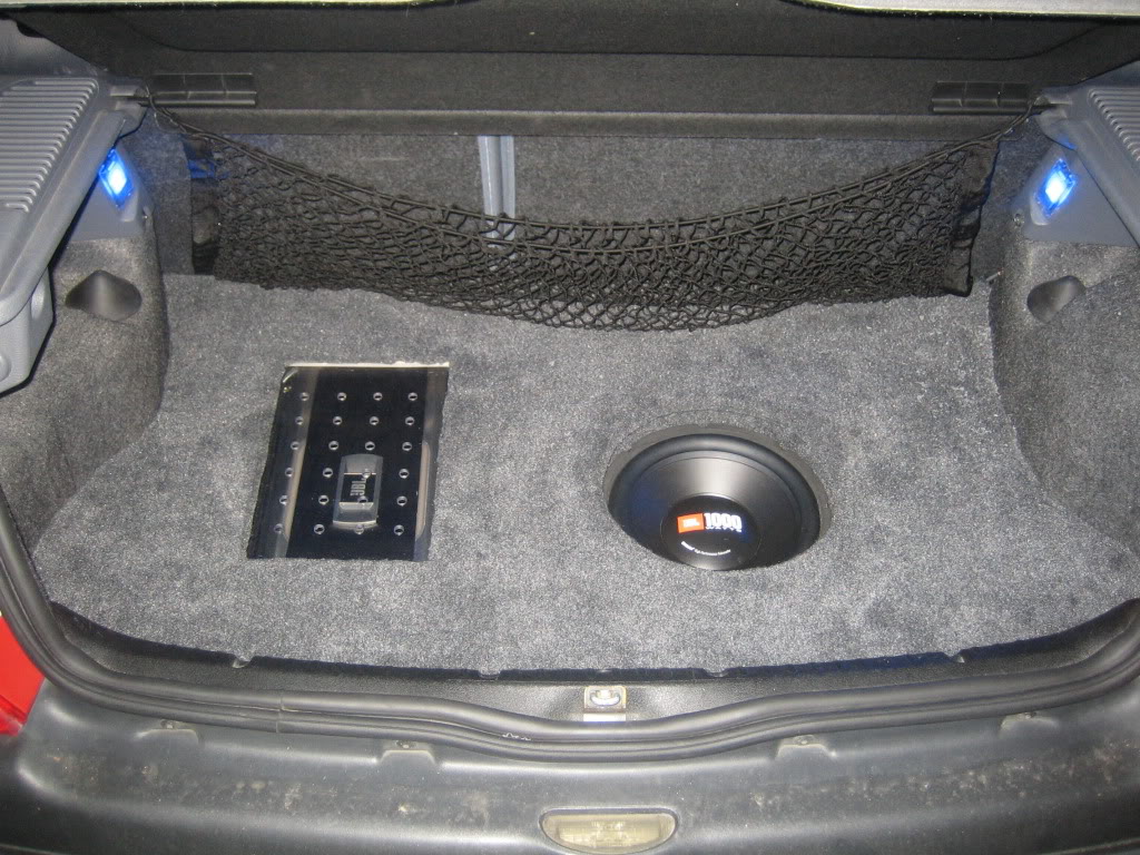

Perspex over the amp with holes for ventilation. Finished pics:
I never really used the boot but if you want to then id advise getting a grill over the sub to stop things falling down there. Thats why i had the boot net.
