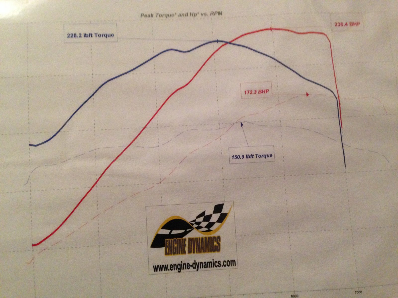

I've an engine dynamics conversion and it really does drive and feel like it left the factory this way.
I'm adding an oil cooler for track use but on road it's done 8,000 miles
  172 Turbo
What's the power delivery like on the ED conversion ?
Is the MPG still reasonable ?
Current mpg reads 35.9 which includes a few 4 or 5 local trips less than a mile each way.
