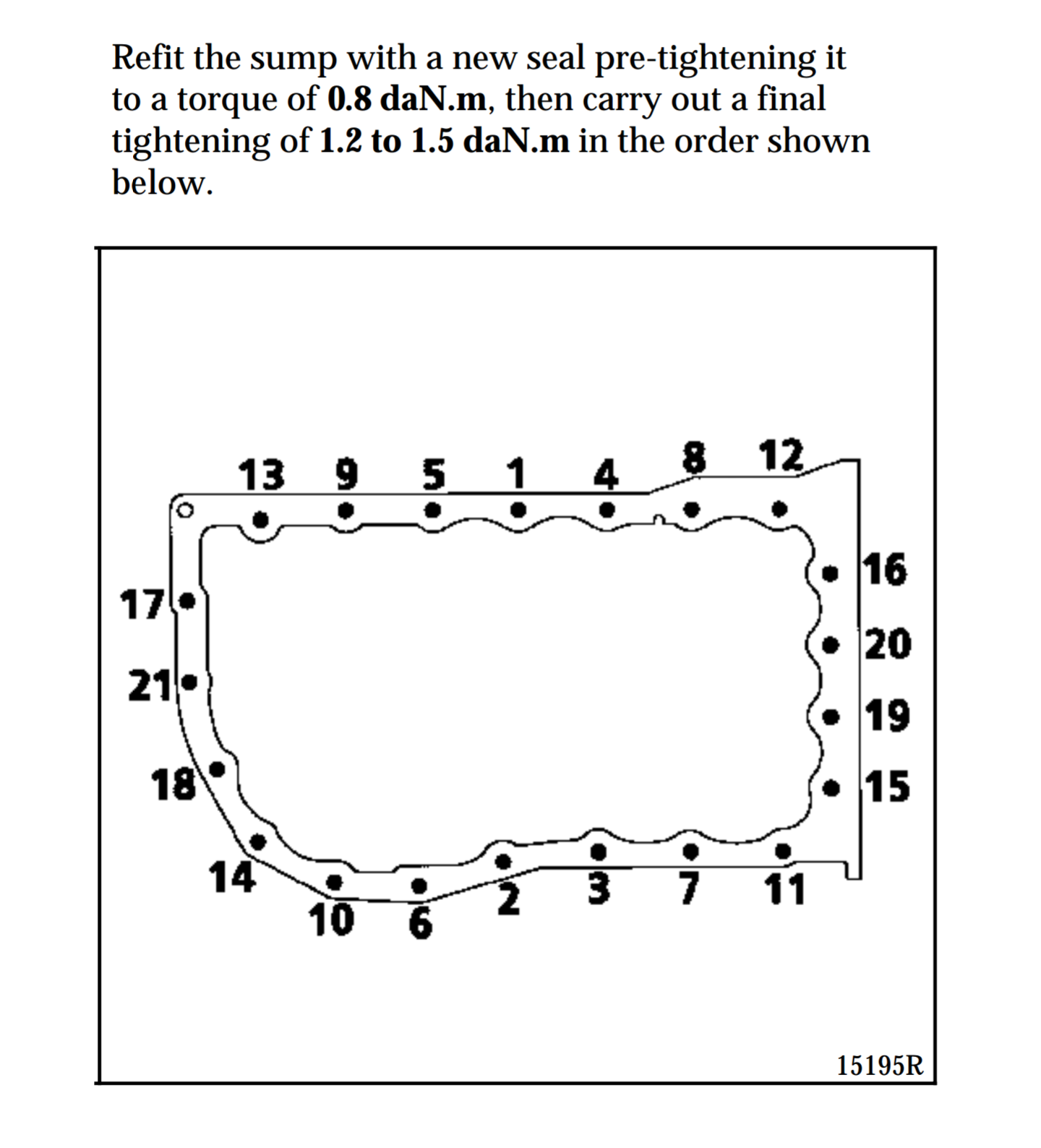

Is there a certain torque setting and will the standard OE Renault rubber seal be ok to use?

There is a torque setting yes and also a particular order to do them in.
Some people fit ARP rod bolts while the sump is off too.
Here's the info from the repair manual
