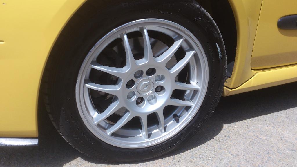

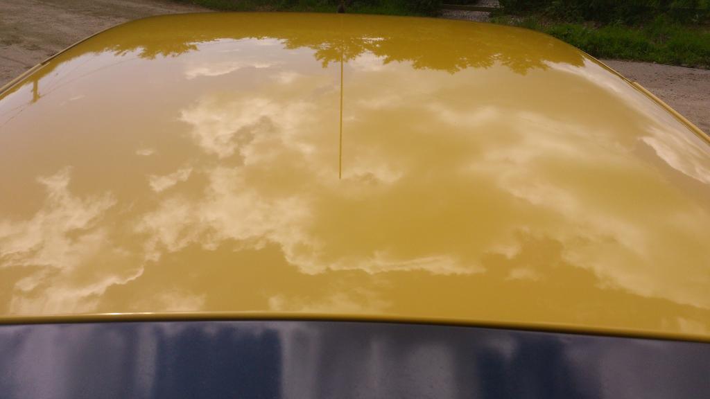

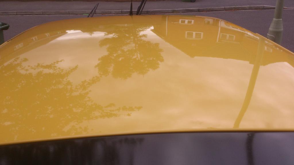

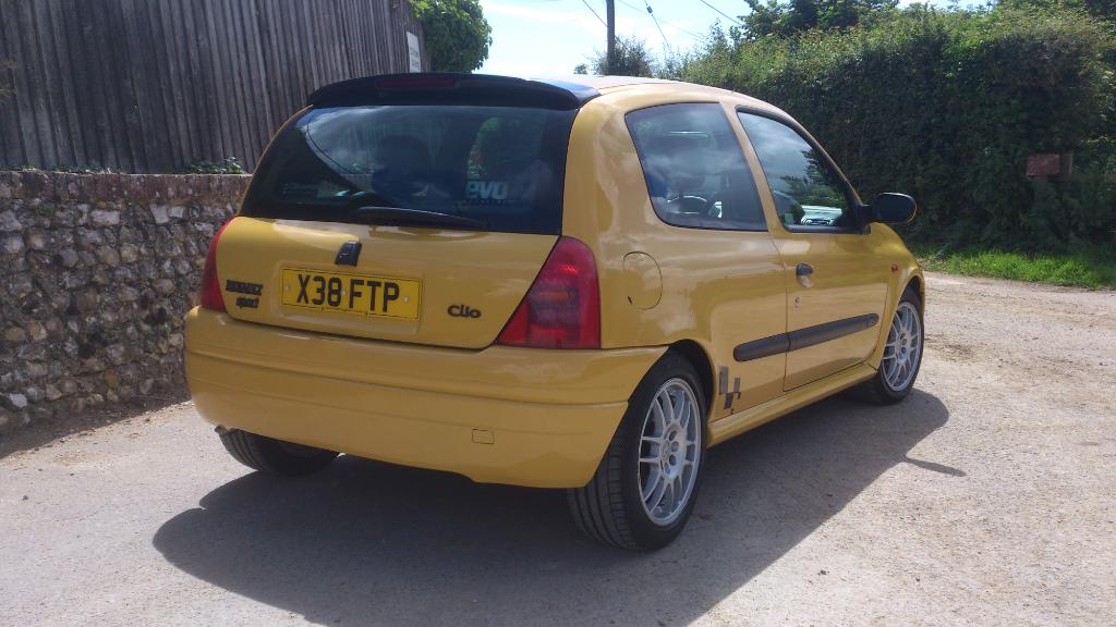

Finally managed to get the time and weather to give the flower some TLC, as you can see it was a bit too sunny really but it was now or never, so did my best.

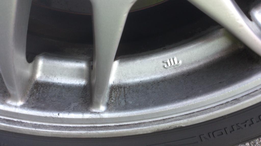

well process

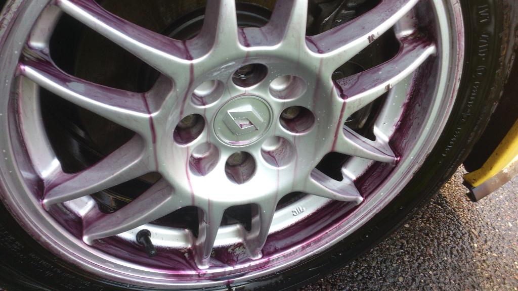

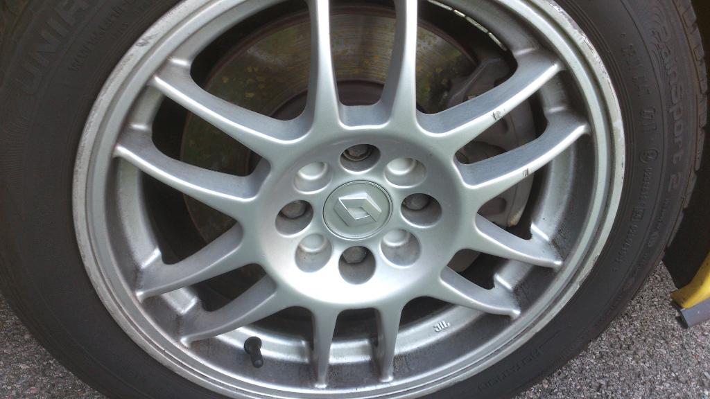

wheels washed with Chem Guys blue wheel cleaner and various brushes followed by my first try with Iron x, wow you guys were right it smelly stuff, but works wonders.

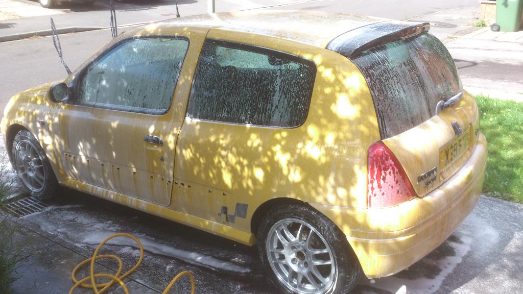

onto the body,
snow foamed followed by 2BM was with CG citrus wash
then AG tar remover (had this laying about) then rinse

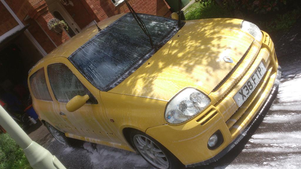

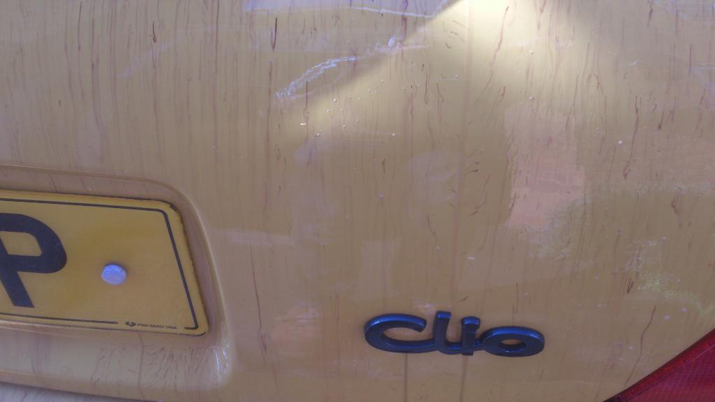

Iron X all over, boot was by far the worst.
Repeated the wash process and dried with 'fluffy' towel
CG V4 all in one polish applied via Das 6 and green hex pad

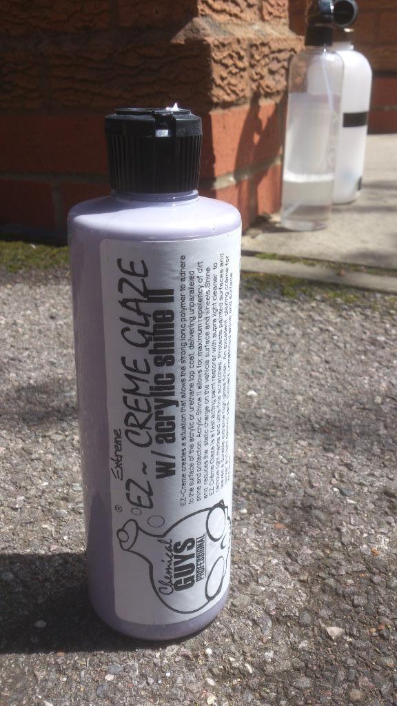

CG Ez Glaze via blue hex pad, applied 2 coats all over

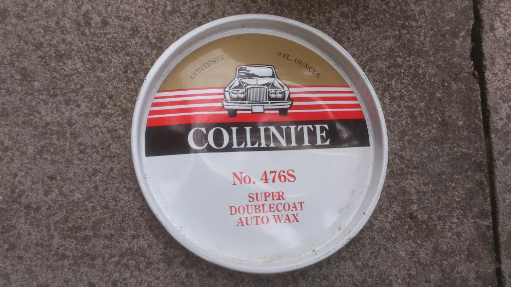

Collinite 476 wax, again 2 coats have been applied.
Plastics dressed with CG VRP dressing.

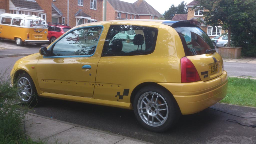

this was my first time using both Iron x and also the glaze process, but having read the guides on here it was a stage i wanted to try and very pleased with the results, the yellow really became alot deeper and brighter with the glaze applied.
In fact the wax seemed to dull it back slightly, would a liquid sealant be better suited?

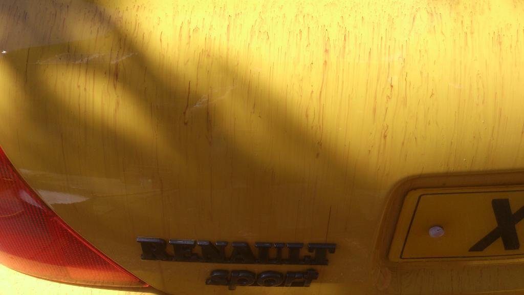

wheels
Iron x

Onto the body
Foam
Iron X
More foam

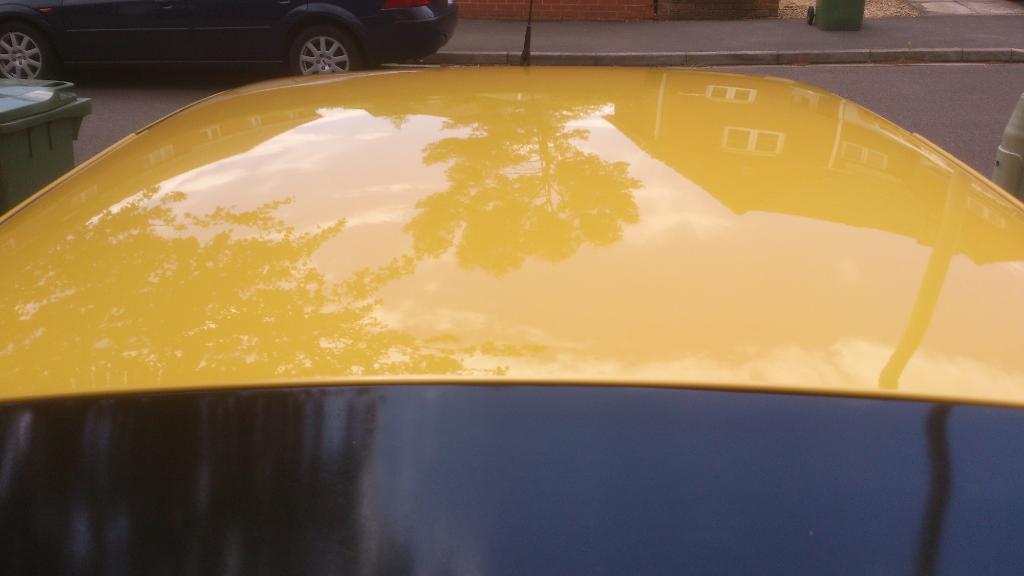

Polish
Onto the glaze
Wax

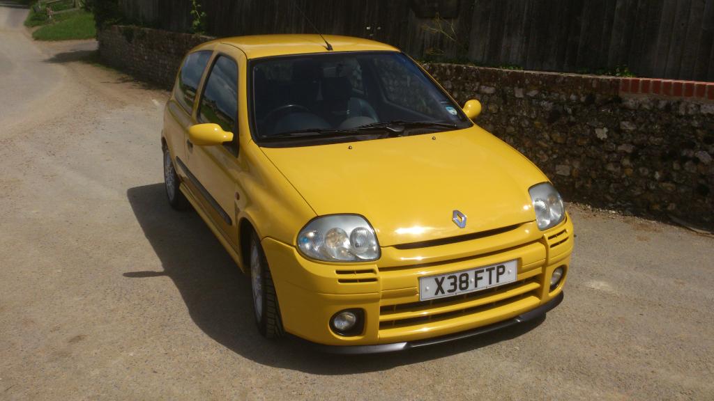

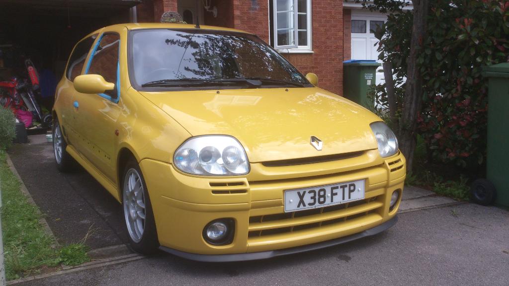

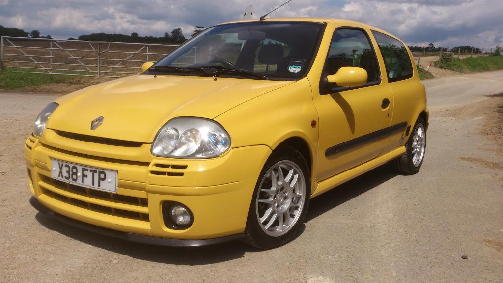

Finished results

476 is a dull wax. I'm not surprised it left you a little disappointed.
What's your budget for a wax?

476wax is quite solvent heavy so I believe so this in itself will affect any base of glazes and fillers. Due to this it may also affect the wax itself becoming a little contaminated as it cures. But 476 is soo durable I can't imagine it being a big problem.
I used it quite a bit on silver when I first started using it and found it loose some of the flake pop where as others for that budget I'd recommend AG HD wax

Might lack a tiny bit of shine but still looks absolutely stunning mate, I am SO jealous!
Would love a sunflower.
That IronX is brilliant, my mrs uses it to detail our cars with, yours certianly needed it, the wheels look like they have been stabbed and are bleeding to death, lol
