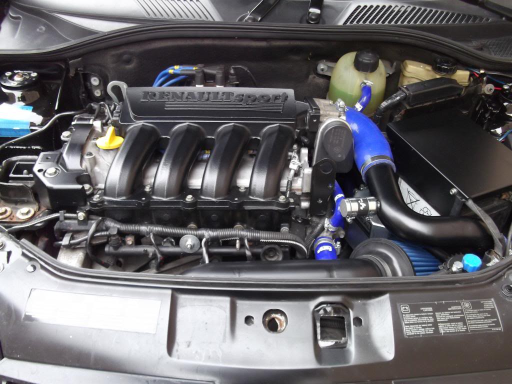

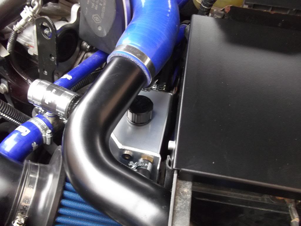

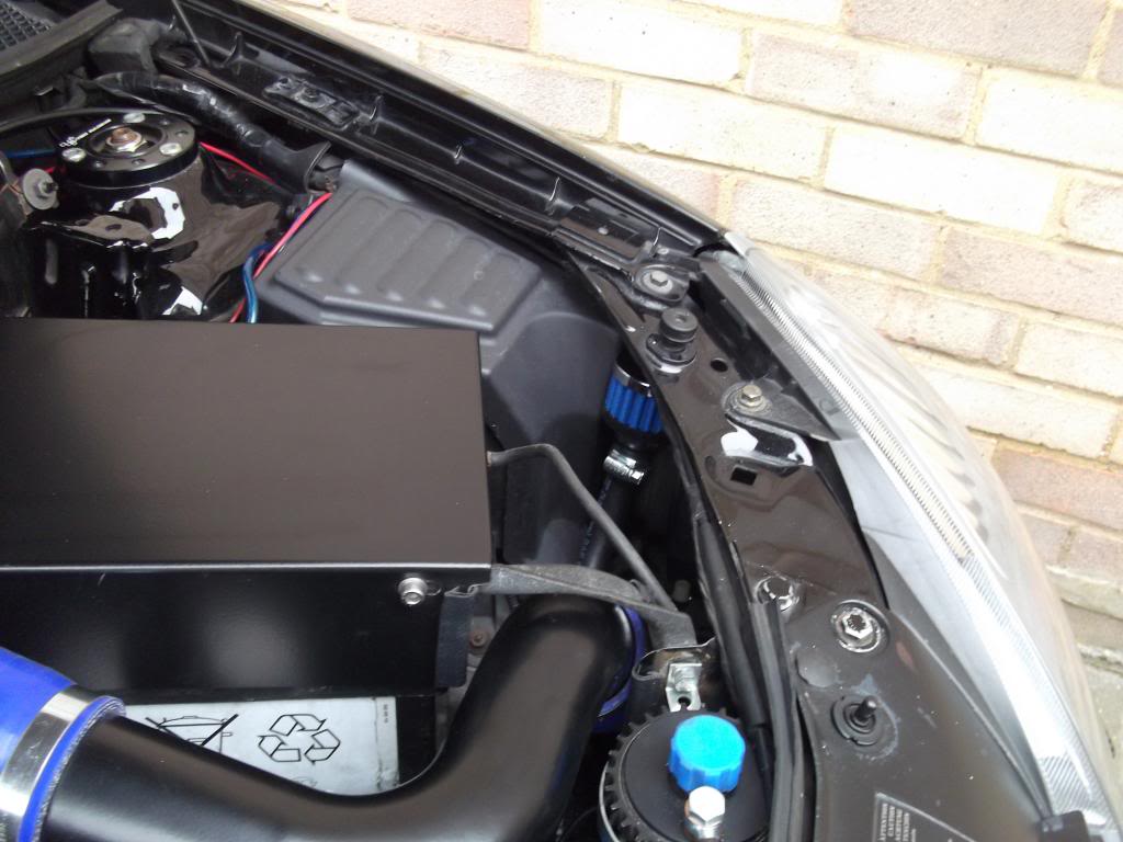

Fitted a Mocal oil catch tank yesterday, I haven't got a lot of room under the bonnet now so the normal places people fit them was out. Managed to get it under the inlet pipe, used the old bracket for the old air box and also got a fixing for the other side in the bottom battery bracket, really pleased with how it looks
Put the breather over by the left front light

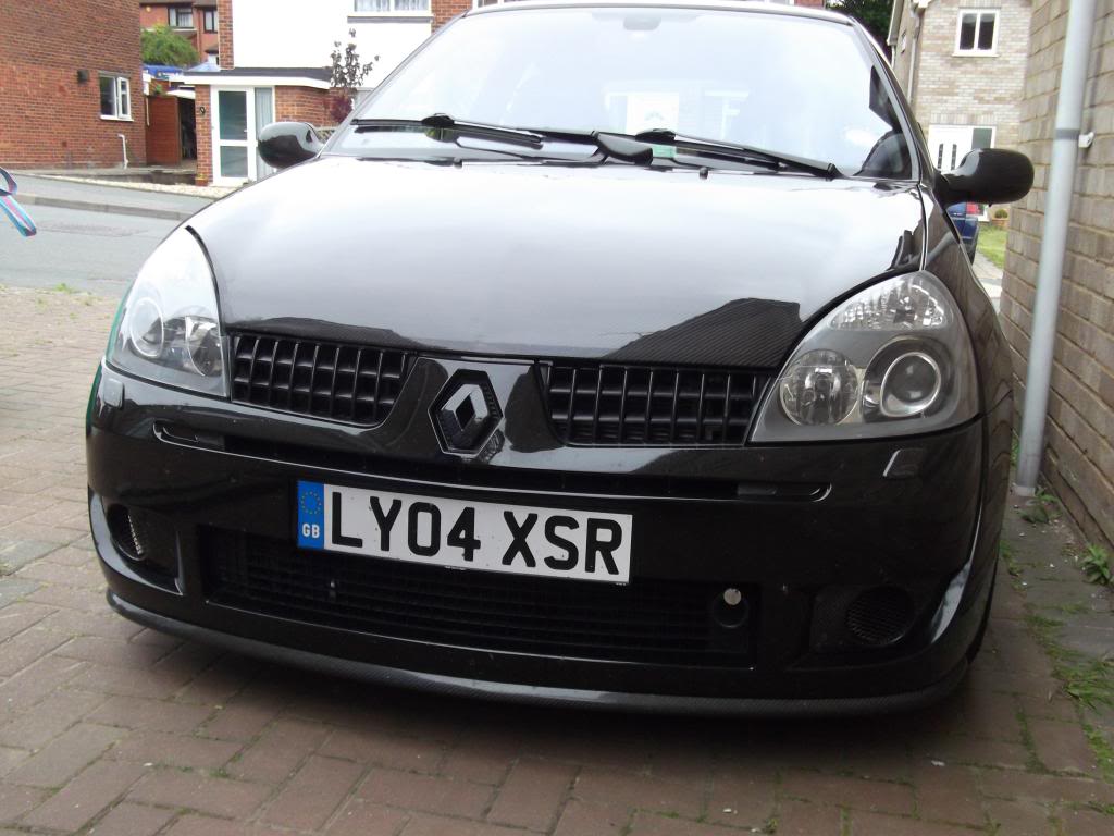

I have had a dent in my bonnet for ages now, right in the middle at the front, so a right pig to get out. The bonnet is also covered in stone chips (as is the front bumper) so I got a price to have the bonnet repaired and have the bumper painted as well. Was going to get it booked in when I came across a brand new carbon bonnet for sale, the guy wanted to much money for it at first, but managed to get for a price I was happy with considering I was going to have mine repaired away.
Went and picked it up on Saturday morning and fitted it as soon as I got back, as it was new and never been fitted I had to drill all the holes for washer jets, bonnet stay ect. Tool a couple of hours and was pretty easy really. Really very happy with how it looks, it doesn't line up perfect but its not bad and I am very fussy.
Just need to get the front and rear bumpers painted and sort out my carbon washer blanks, fog surrounds and splitter which I will do myself and the car will be ready for CSS :)

Looks awsome!! :) Just FYI, you can do away with the oil breather filter altogther, the cap on the Mocal tank is completely breathable.
Thanks mate, I thought it was, will probably keep the filter on at the moment, as I will need to get a blanking cap.

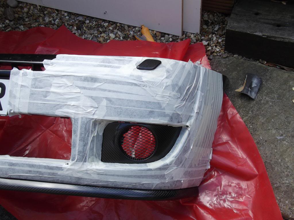

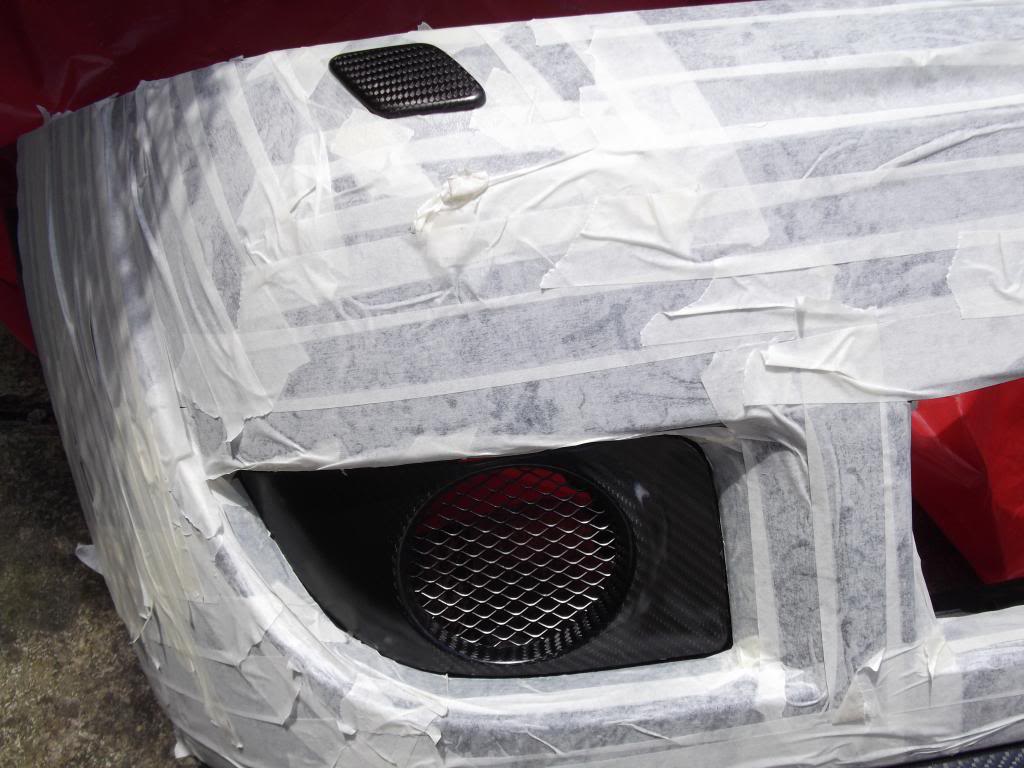

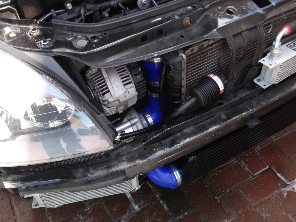

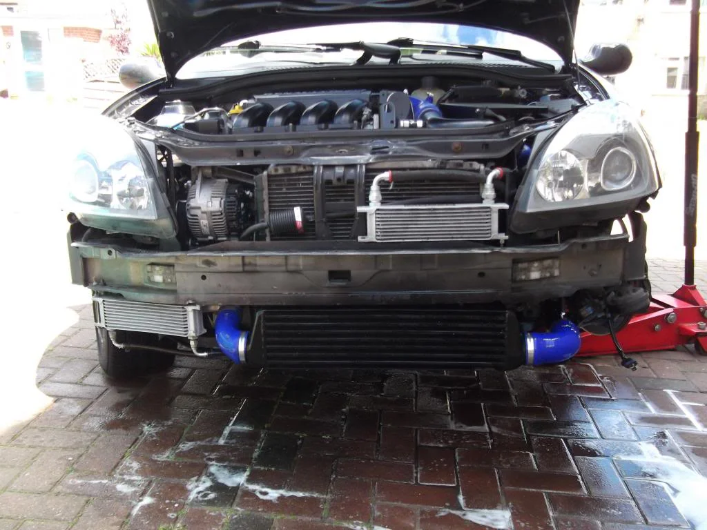

Sorted out my carbon washer blanks, splitter and fog surrounds at the weekend, they were badly stone chipped, got the old lacquer off and rubbed it all down and put some new lacquer on, was a bit of a pain because fogs and blanks are bonded on so had to mask up most of the bumper. Look much better now, just need a bit of polishing.
Took a couple of pics with the bumper off
Also had a bit of a mess about with the carbon bonnet as it wasn't sitting quite right, still not perfect but it is better now.
